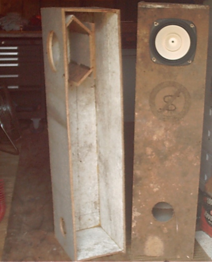

My favourite Fostex 8" is the FE206E. Price is important to me and it is the cheapest. Lots of good designs for it too. So I bought a pair and have them in "break-in" cabinets. Not as nice as your Ob's timolean.
The loaded cab with my avatar drawn on it is the Martin King Project 5. The second cab under construction is a little taller and has a filter chamber and throat sized like the Dallas II.
The material is Barnside, sort of a non-pressed waterproofed Masonite that came from my old shed after hurricane Ivan destroyed it. This wood is so bad my dog won't even fetch it.
