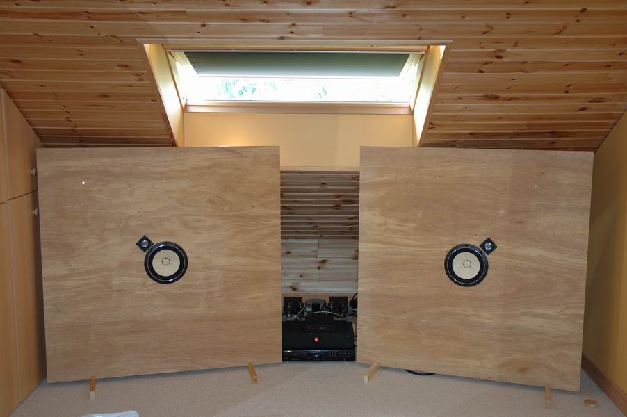

So I went for the FE208E Sigma, coupled with the FT96H.
They are currently playing on OB where they already produce an astonishing result. Amazing sound comes from these things. There is a large difference whether they are fed from SS or from the KT88 tube amp, much more so than with my previous speakers. Bass is certainly acceptable (size matters, no matter what they say)
I will put them in the Fostex recommended BLH eventually, but that may take a while.
FYI, they play in the attic now. The slightly room-friendlier BLH might make it to our living room, but certainly not these. On the other hand, my wife was impressed with the sound.
Gert

hi timolien
wellcome to wonderfull sound of ob
i know that is just your temporary arrangement, but if you decide to stay with ob, you might want to put speakers of center, it helps
the other thing is that further away from the back wall, the better
just one more suggestion, consider ob for midrange and put it on box with subwoofers, kind of like dick olshers basszila
that way ob is lot smaller, bass is definitely better, still you have clean ob midrange plus good looking speaker suitable for livingroom
enjoy
ed

Gert:
Congratulations! You somehow made sense out of all the suggestions
I haven't heard that tweeter, but I think upgrading from the FT17 is the right thing to do. BUT I just realized that I crossed my tweeter/208 MUCH lower than people normally do for the 208 so perhaps that was
putting extra stress on the FT17.
Anyway, you made some good choices and if you ever try to make them acceptable for downstairs, they are very attractive, which might help.
Are you now living upstairs? That was very generous of your wife to only make you live up there instead of throwing you out of the house.
Putting the driver off center can help, but in your case, it is in effect off center because the baffle is on the floor and the baffle is close to a wall. You could probably tune the bass some by putting the baffle up agains the wall on the side, and then moving it closer and further away.
In a small space like that, you should buy some of the eggcrate textured foam and piut squares of it on the sides and back walls of the room behind the baffles.Just a few pieces will help
Anyway, good job- sorry abiut the budget!!

The last 2 days I have been playing lots of CDs through them, and I must say, they image wonderfully.
adason, I will certainly not throw away the baffles after burn-in. While building the BLHs - I definitely want to try them- I have ample time to evaluate them as OB drivers. I have a sub standing there anyway (My HT setup is at the opposite side of from where I took the picture in my previous post) I'll hook it up to the Fostexes (everyone agrees to this plural ? English is not my native tongue). I thought Fostex drivers were not so popular as OB drivers. Is everybody else mistaken in that notion ?
Variac, the tweeter is crossed at 10k now, but I have some other caps and I will try some other crossover points. The space is small, but there's a fairly long slope behind the baffles. At ground level, I guess there's about 1.5 meters of carpet behind them.
Bass is not ultra deep, but the quality of it is very good indeed. I can hardly believe they can get better after break-in.
Gert
Gert
