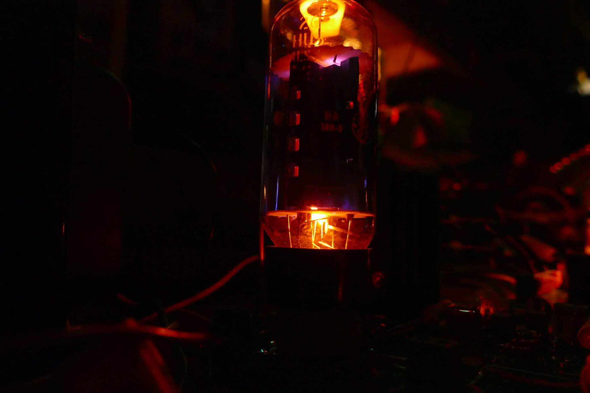

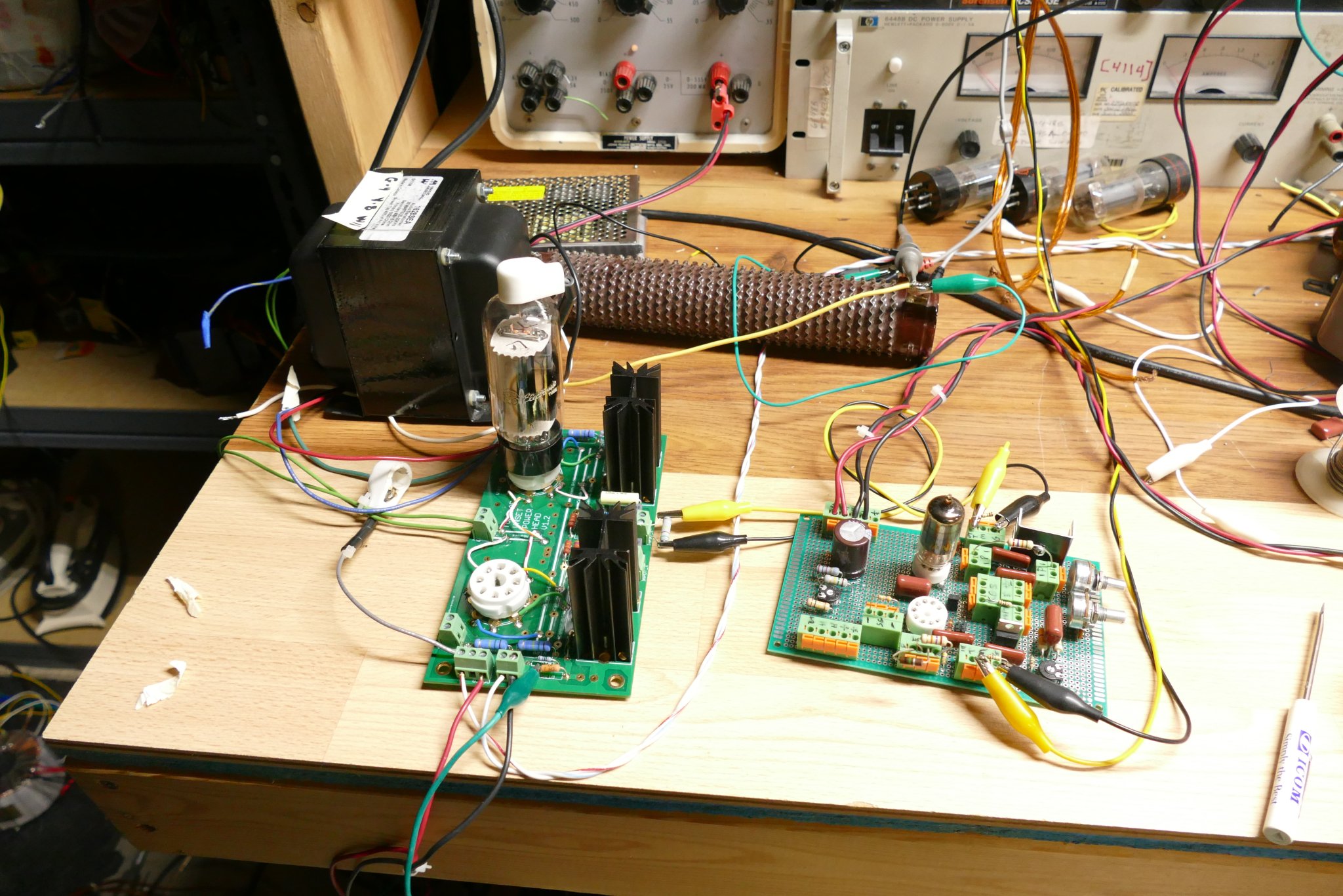

My all time favorite "big power" tube was the 6LW6 and its odd heater voltage variants. Unfortunately, it is becoming expensive and hard to find. My current favorite "test subject" is the 26HU5, which I think is a 26LW6 in disguise. Stan had about 400 of them when he passed away. Wonder where they are? I have seen over 200 watts flow from a single pair in push pull into a 3300 ohm OPT on 625 volts. New experiments in UNSET based SE are underway.

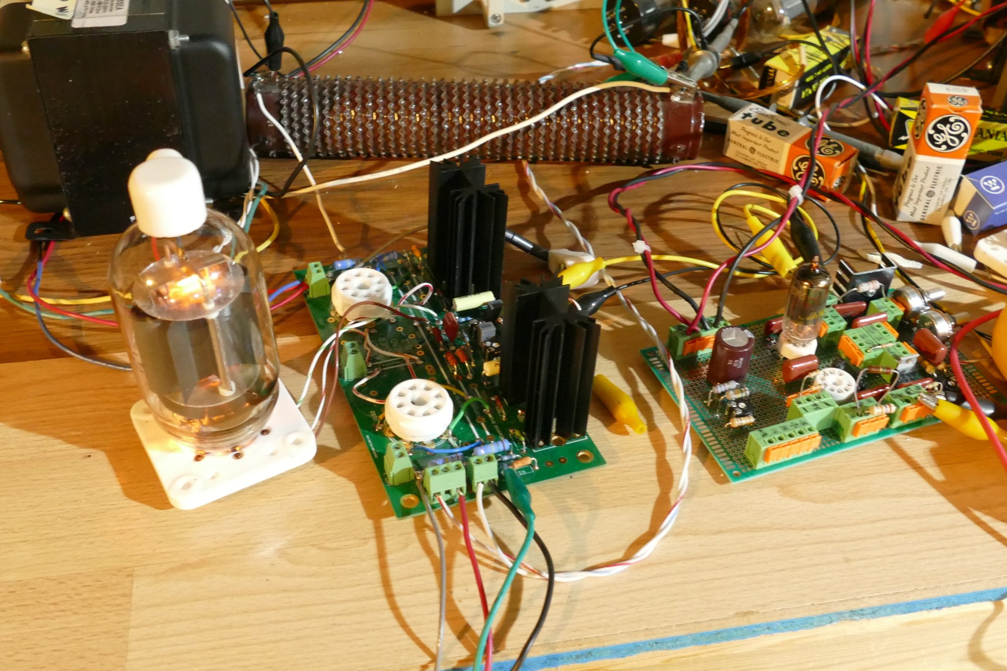

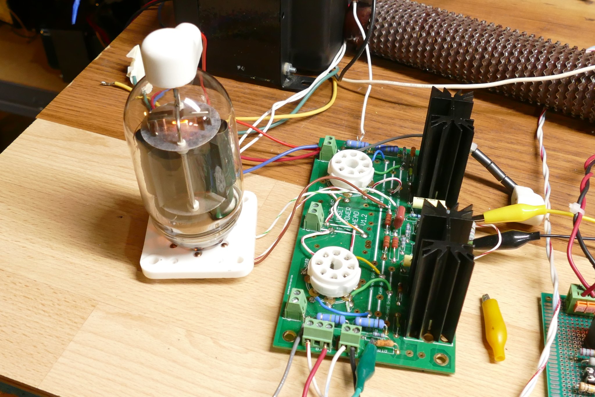

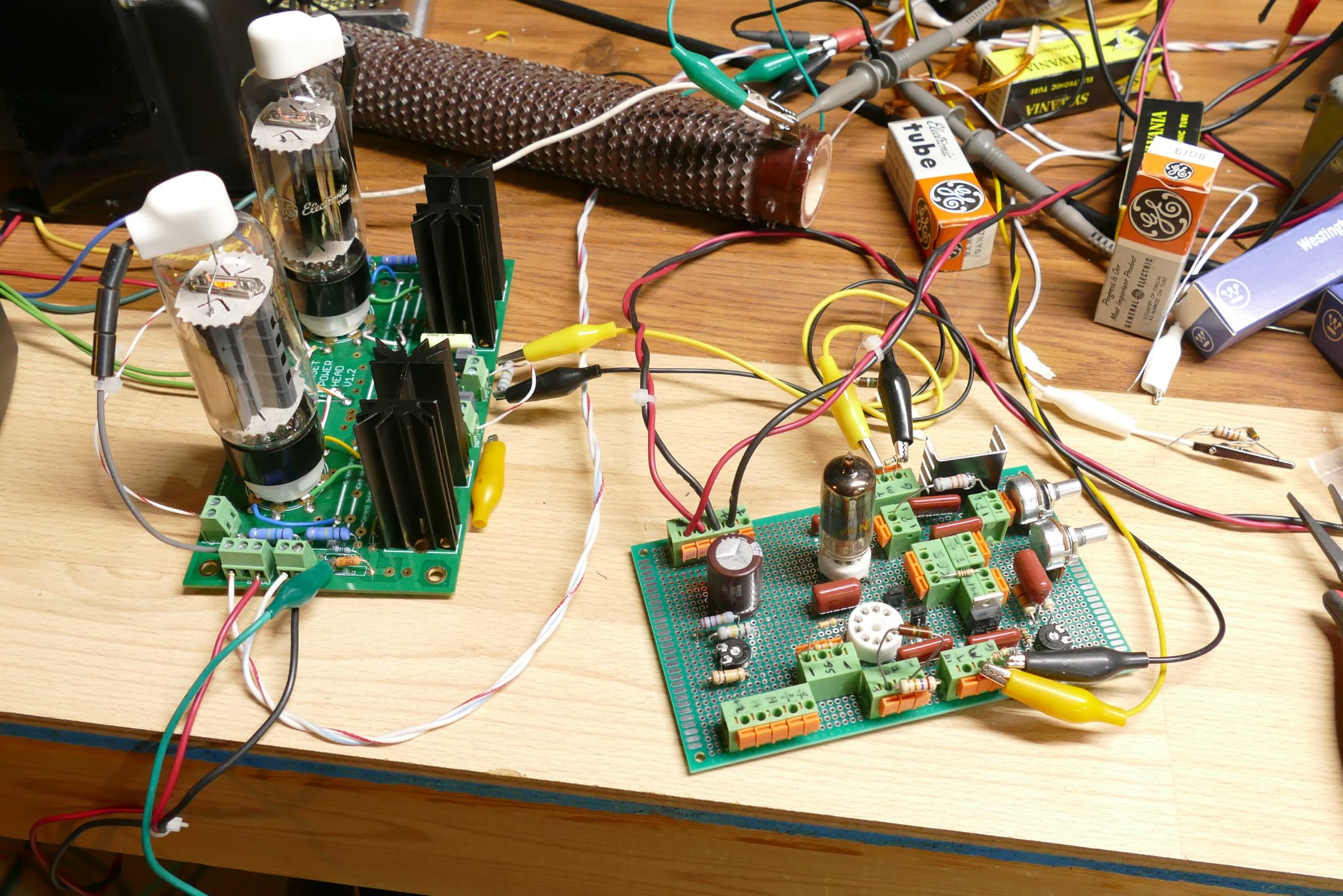

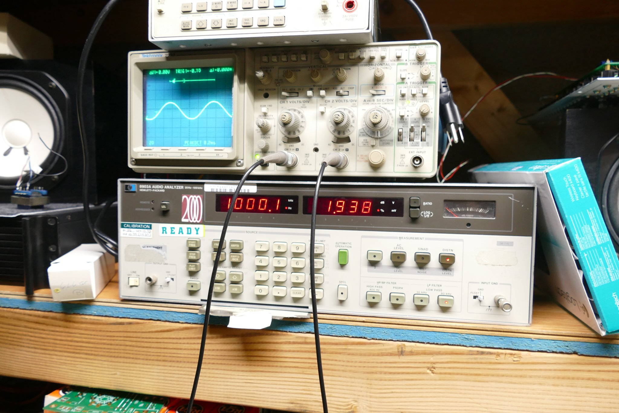

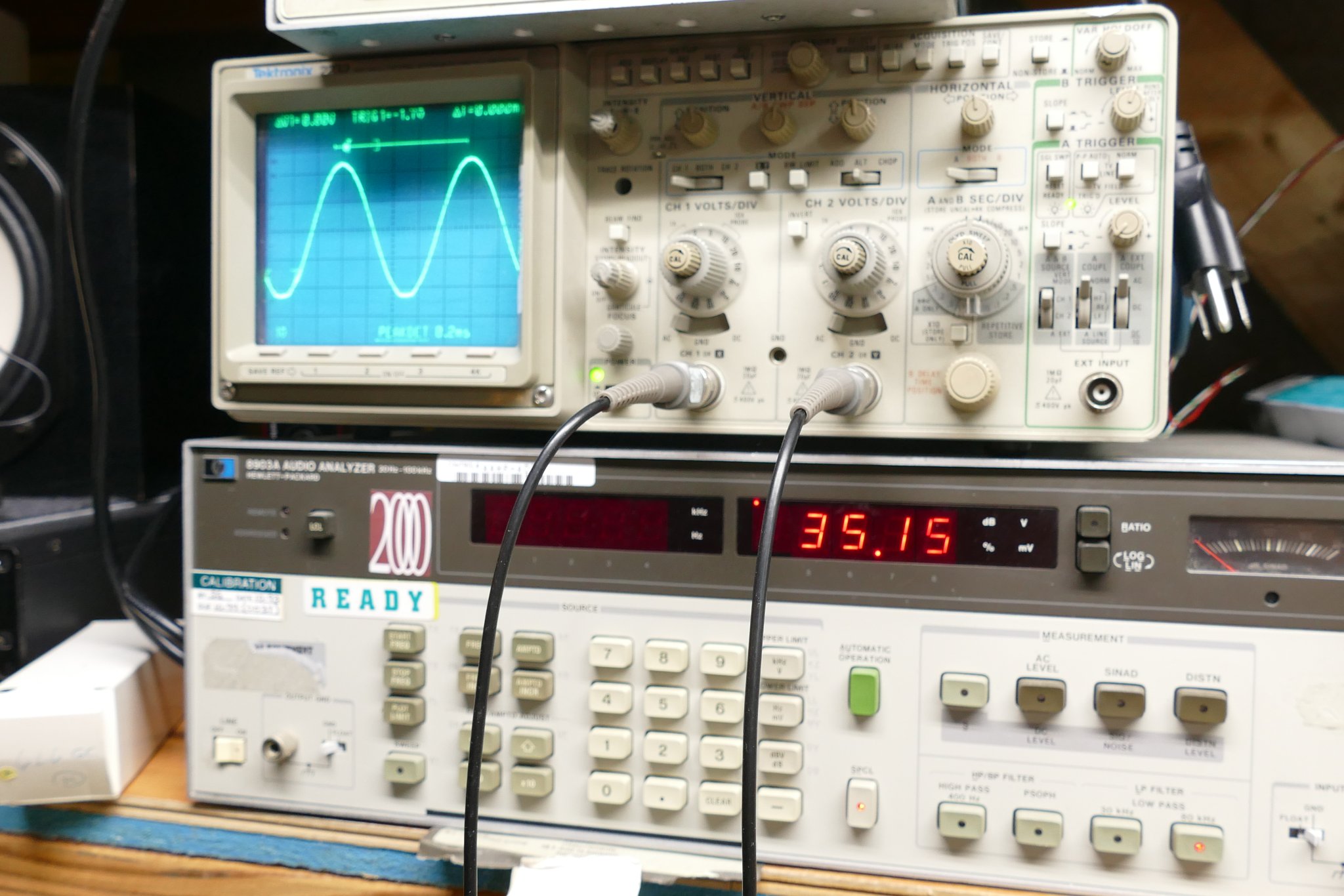

One tube will make 20 watts in SE at 2% THD with a new driver design that's being worked on. A pair in parallel will do 35 watts at 1.2%. Didn't want to push things much harder. UNSET is a topology I developed to get triode curves from a TV sweep pentode without violating its low screen grid voltage rating. UN = no triodes, SET = Single Ended Triode. In this case the UNSET test amp uses two or three TV set pentodes to generate SET sound, and lots of it.
4D32, this reminds me of something I need to try. I have experimented with these in the past. I have a few somewhere, I need to stick a pair into the UNSET test setup.

The driver test board seen in post #41 has both 7 pin and 9 pin sockets so I can try lots of different tube types. Another tube that works well is the 6EJ7 / EF184. It's generally available on both sides of the pond.

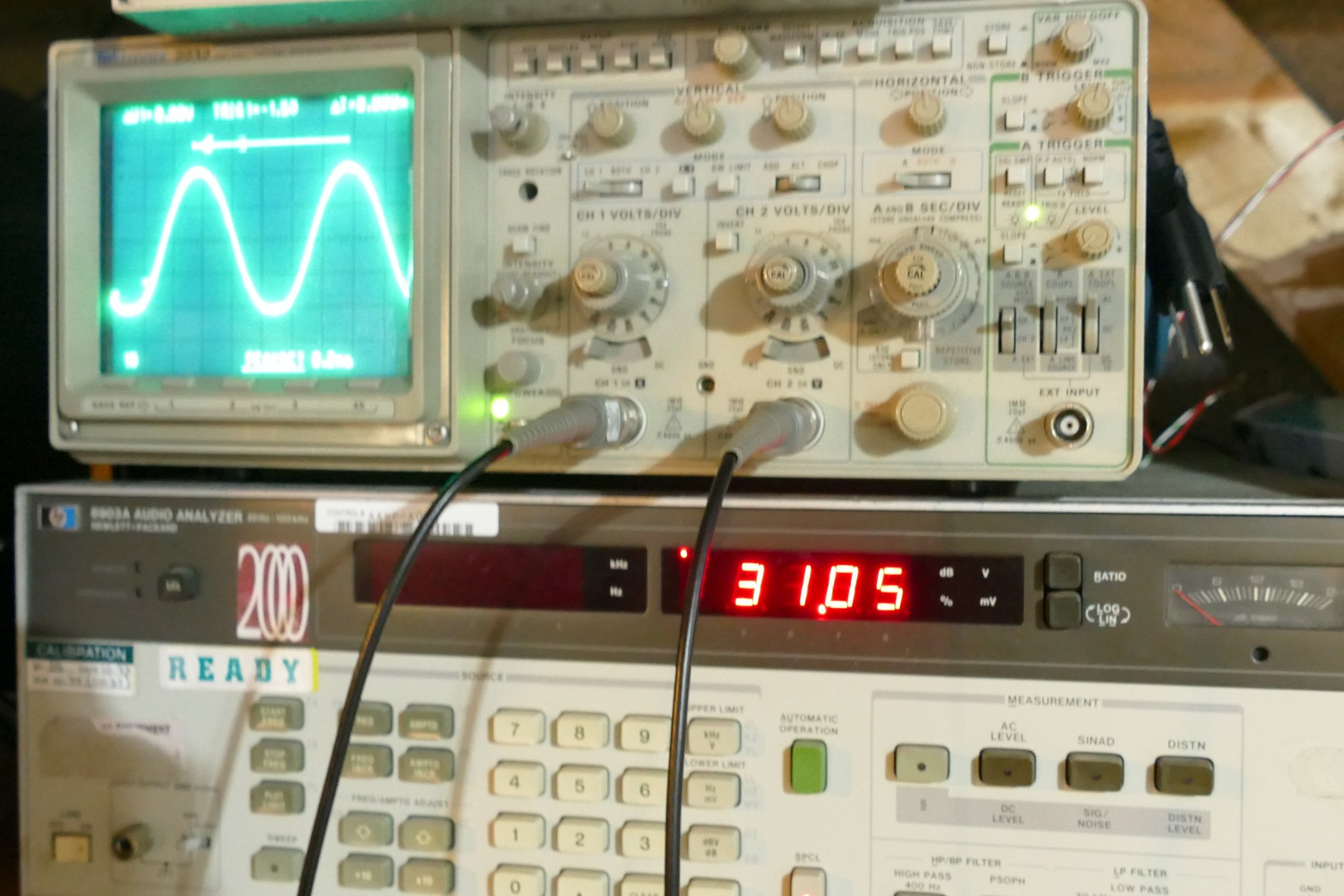

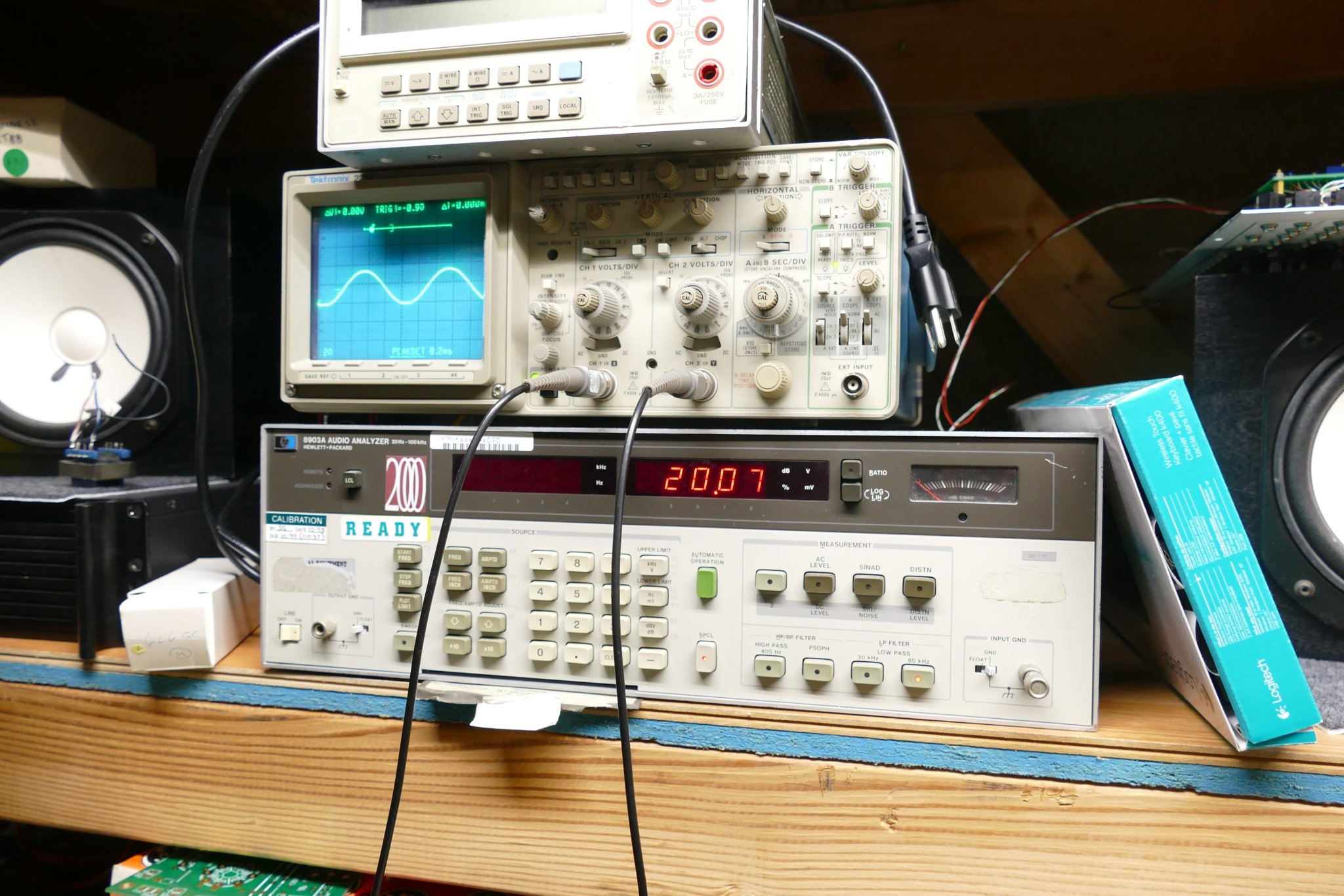

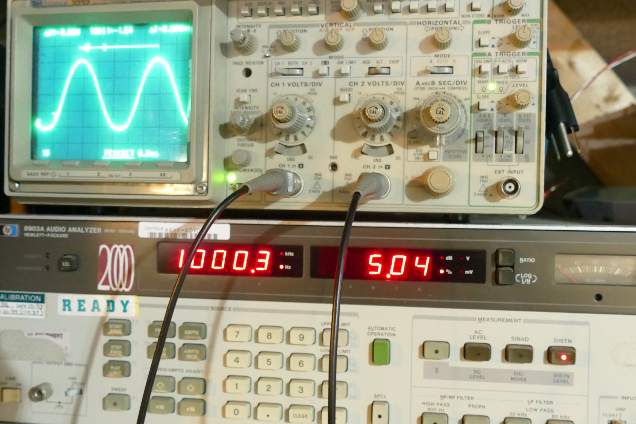

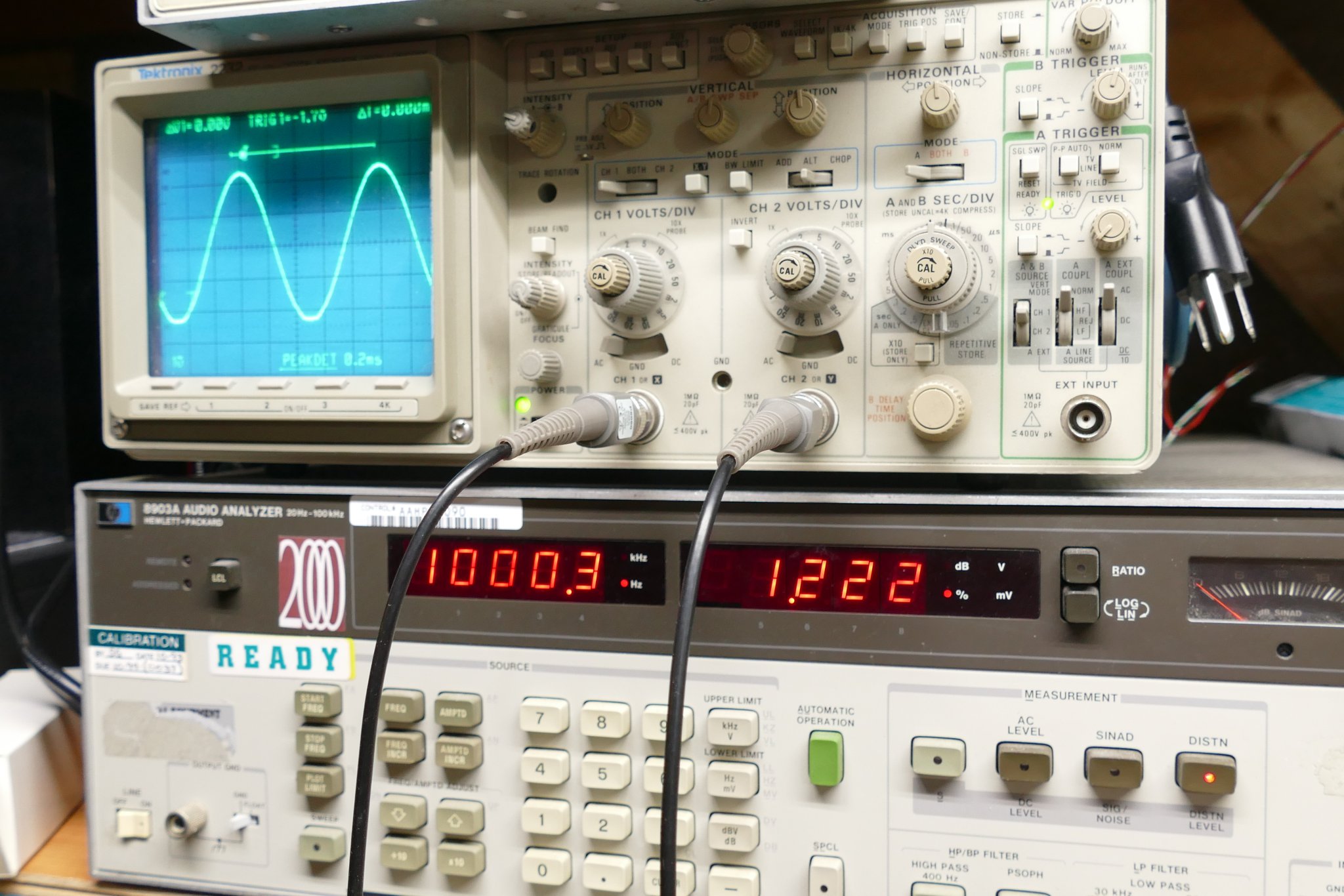

Did someone mention the 4D32? Squeeze one hard in SE and you get 30 watts at 5% THD. Back it down to about 20 watts and you are in the 1.2% region. If one tube is good two must be better, right? Probably not tonight, may not be home.
