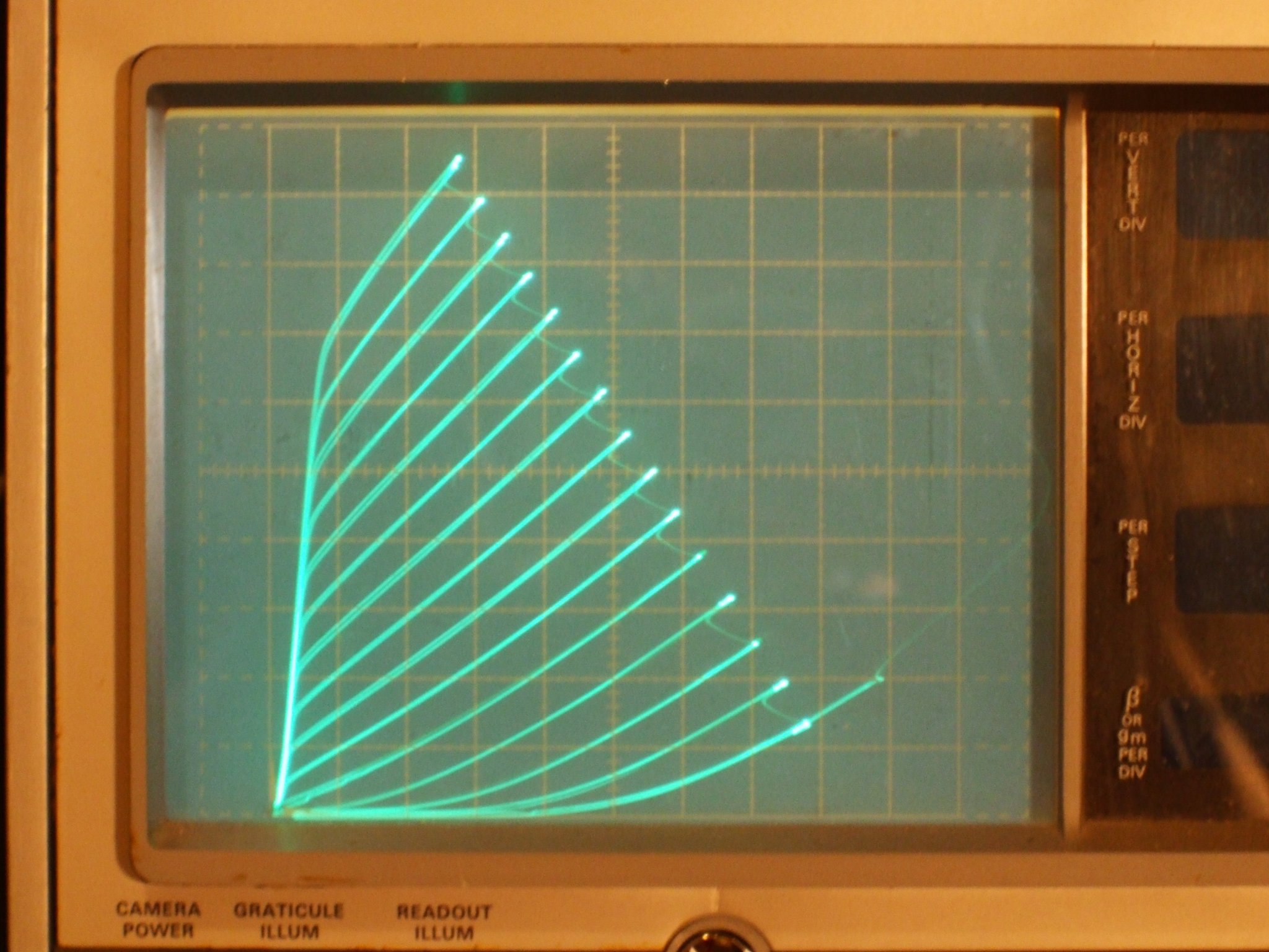

How about a Beam Triode? Here is one that can run on "modest" plate voltage. 6HZ5, 100V/div Horiz., 20 mA/div Vert.
These only have two said metal thingies between the cathode and plate. One with wire, one with flat metal. Not a pentode by any definition. Some are obviously just TV sweep tubes without a screen grid since there is an empty pair of holes in the mica spacers where the screen grid would go. With a GM of 50K to 65K and a Mu of 300 they make real good power oscillators and TV jammers when run continuously, which was not the intended mode of operation. I have a bunch of several flavors and have yet to tame any of them, but I have not tried UNSET yet. I laid out a 12 pin Compactron UNSET board but have not sent it out for fab yet.

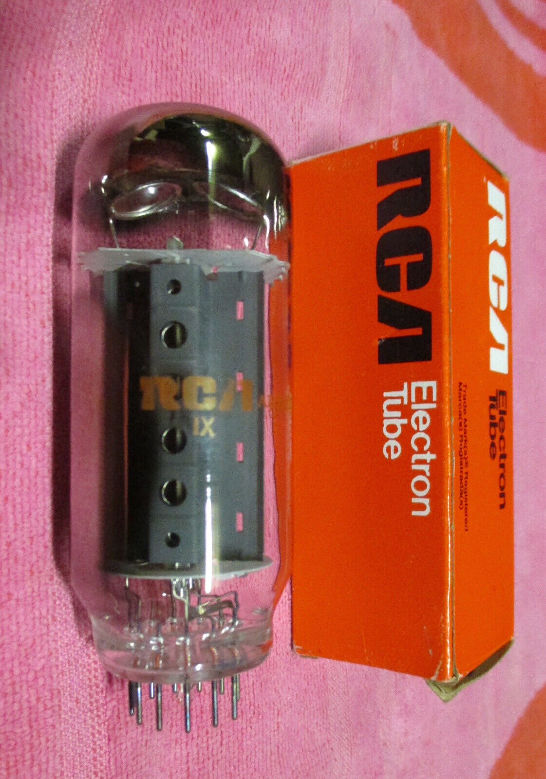

The 6EH4 (not 5) is a big *** beam triode. Probably with the LX6/LW6 guts in it.
"The 6EH4 (not 5) is a big *** beam triode. Probably with the LX6/LW6 guts in it."
The 6EH4 is what became of the original 6BK4 high voltage shunt regulator tube when they tried to kill the X-ray emission these things made. These were short lived as the HV shunt regulator was moved to the primary side of the flyback where it works in the 1000 to 3000 KV range.
The 6EH4 has a maximum plate voltage of 36,000 volts and a typical plate current of 1 mA. The plate itself is a 2+ inch long thick cylindrical tube with the "target" at the far end. The cylindrical tube is for X-ray containment. While not specified here, the typical Mu of these things in in the 1000+ range while the Gm approaches zero.
The newer "primary side" regulators are like the 6HZ5 mentioned and pictured in post #17, a big sweep tube without a screen grid.

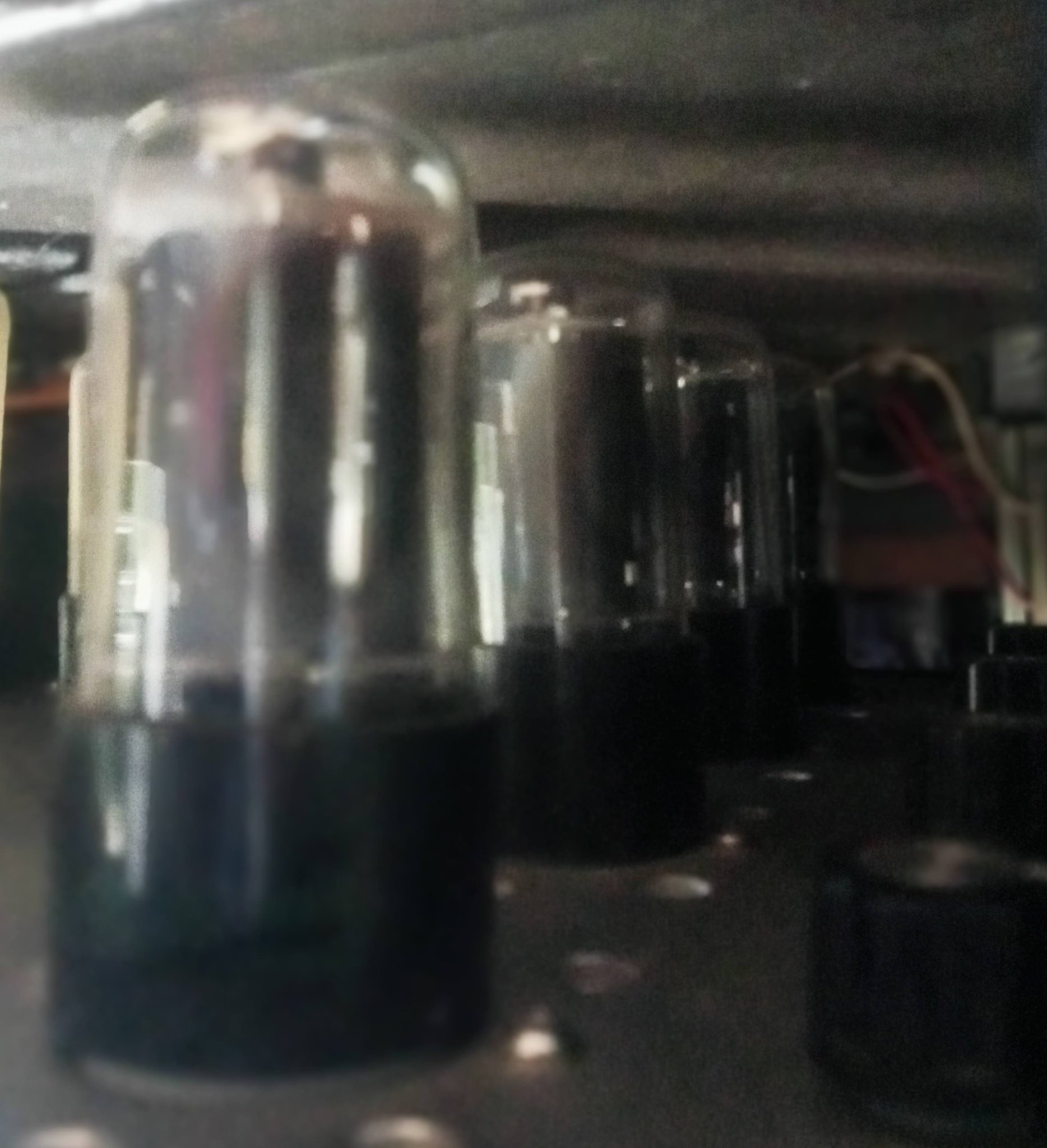

"I like - love 6AU5GT"
Then take a look at the 6AV5 in its various flavors. It has the same pinout, comes in a GT flavor (similar to the 6AU5 but slightly lower triode Mu), and a GA flavor (larger bottle with several different plate sizes that kept getting bigger over time), and the 6FW5 (only the large plate flavor of the 6AV5GA). All have the same pinout, and similar characteristics. All were derived from the 6BQ6GT which is similar, but has a plate cap.

Well, I have only them, in push-pull, stereo.
I saw the ones you mentioned are used by a canadian company, Ideal Innovations
