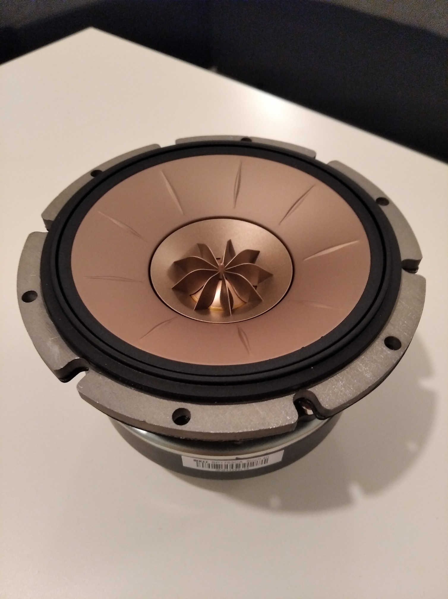

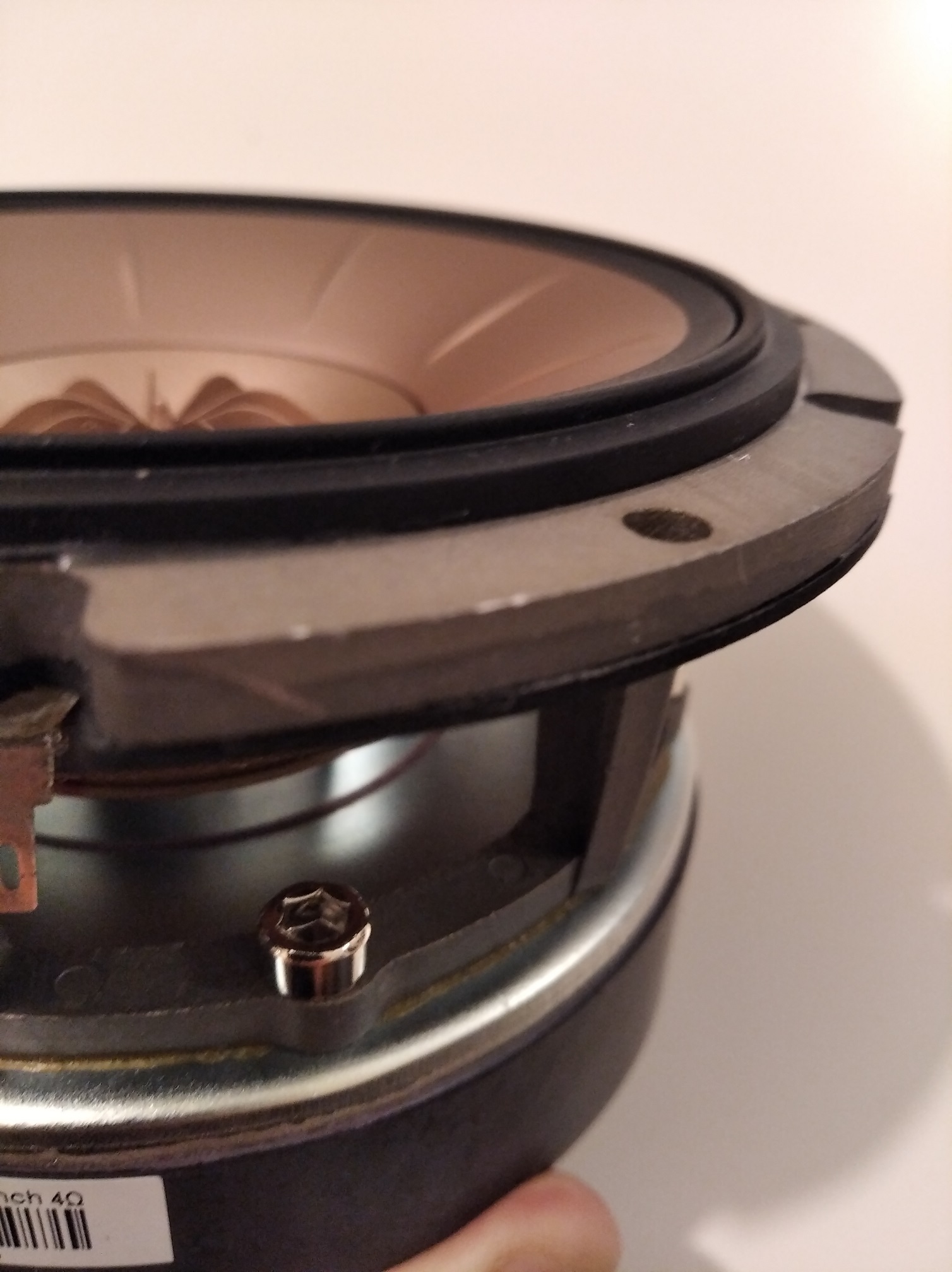

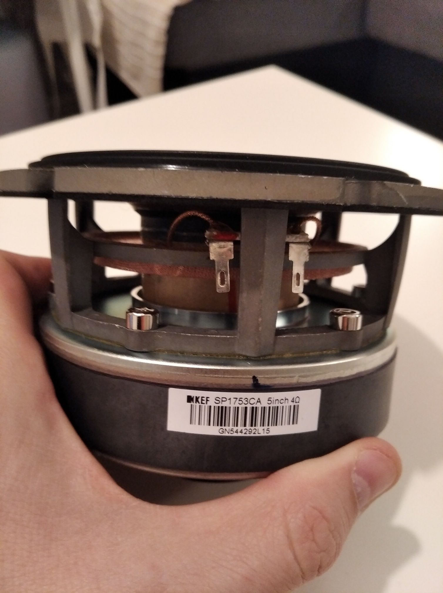

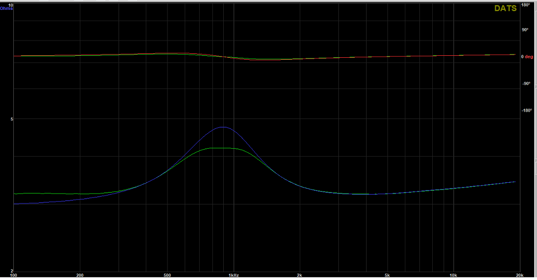

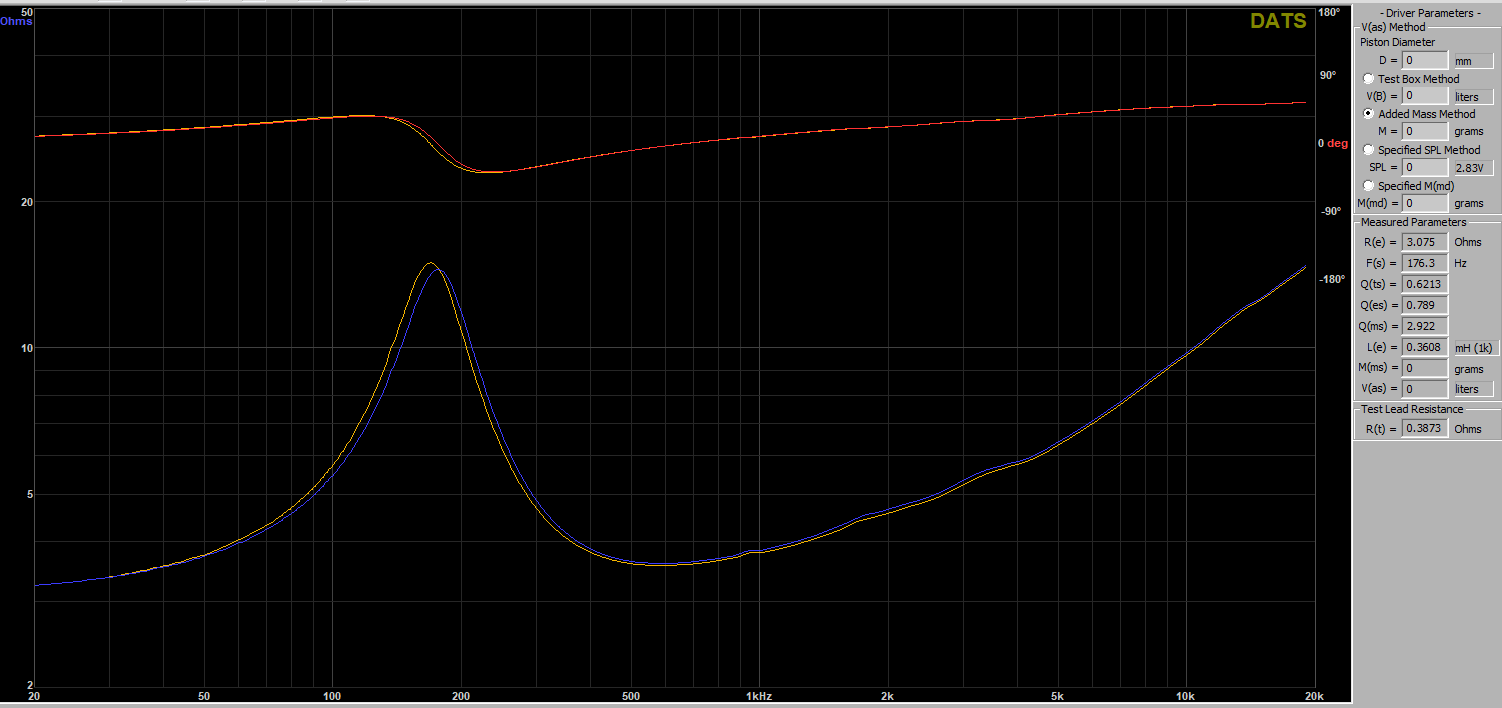

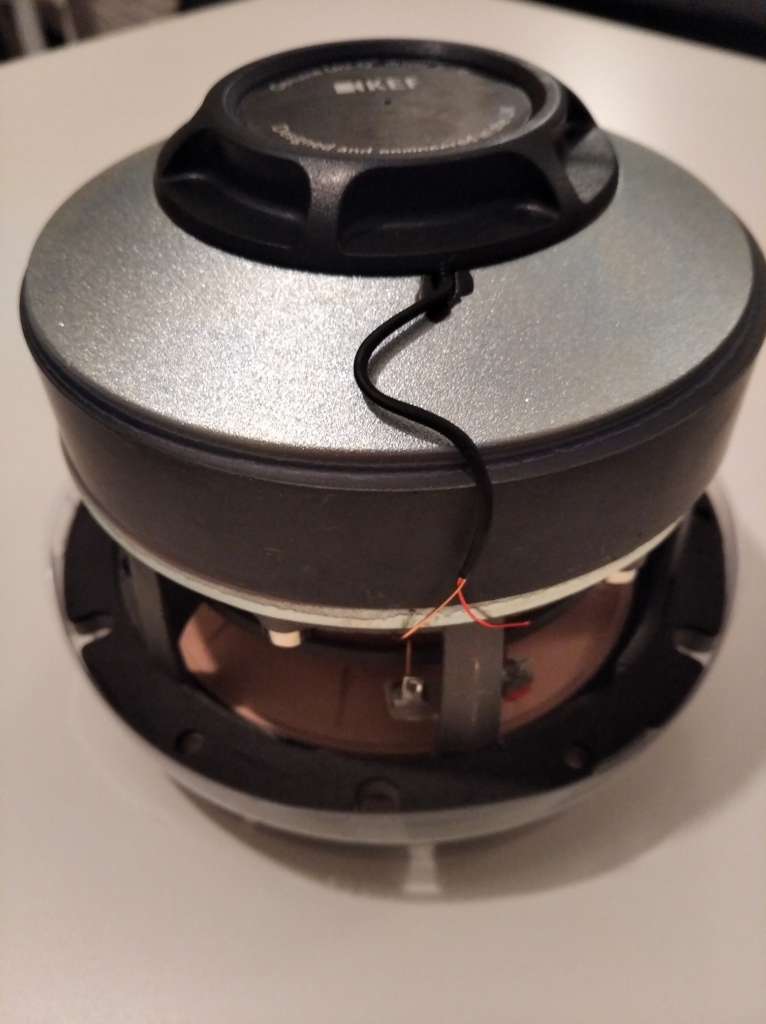

Did you think the R series was a big upgrade from the one in the LS50?
Yes, without a doubt. But not because something is better done/manufactured/engineered per se. Rather because it is specialized for the work it has to do. LS50 uses a midwoofer and R3 uses pure midrange in their dual concentric. I've managed to obtain the new R series dual concentric.
