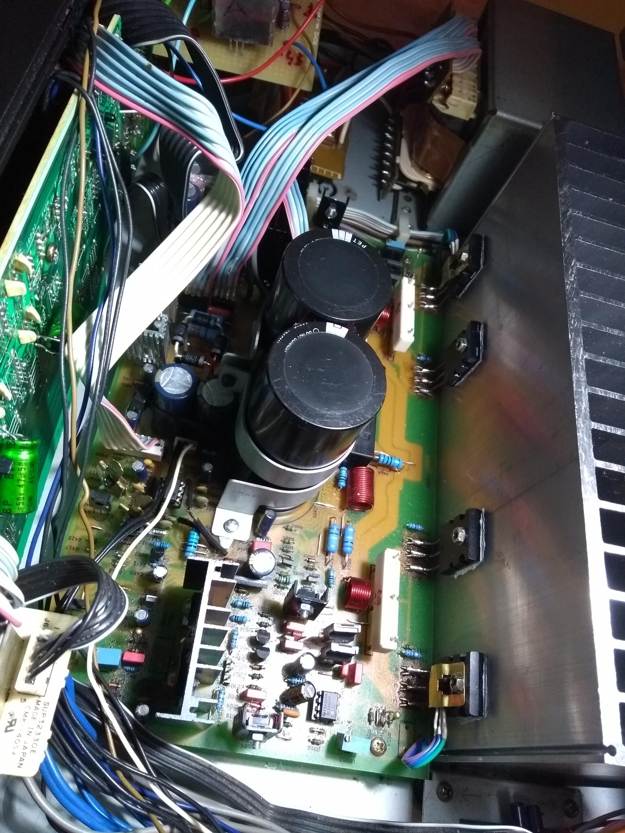

Here's a photo from my amp.It seems to me that your Q553 - 556 transistors are mounted wrong.

I have changed IC401, at the beginning of the repair.The new one is original, from Renesas Electronics.
The oscilloscope tips are placed at the junction point of the emitter resistors on the output transistors.

I was very surprised to see your picture!
The truth is that I would swear that I checked it, but what I'm sure of is that the transistor is set respecting the PCB screen printing.
I have the amplifier at work, tomorrow I'll check it again early
Thank you!
I just checked some pictures on the web, i´m almost sure that mine is reversed!!!
Regards!
Felix
Hello!
Well, I don't know how to say this ... I don't understand how I could make this rookie mistake.I feel ashamed and angry at myself.
It has been putting the transistors in the correct position and everything works as it should.The base voltage of the drivers are correct, and the bias adjustment is perfect. Even the distortion of the left channel has disappeared, no idea ....
I don't know how to thank you, Cosmin, and equally to everyone who has participated.
Your photo has given me ideas on how to update and improve the ampli.I just placed the multiturn order, and I plan to replace Q501-Q504 with MJE340 / MJE350 with heatsinks.
What is Q405, Q406 in your amplifier?
I also like how you put the bias transistors over the output ones.
Once again, thank you very much.
Best regards,
Felix

First, I'm glad everything is OK now - printscreen for those transistors is easily misleading (maybe should have been compared to Q417 - 420).
