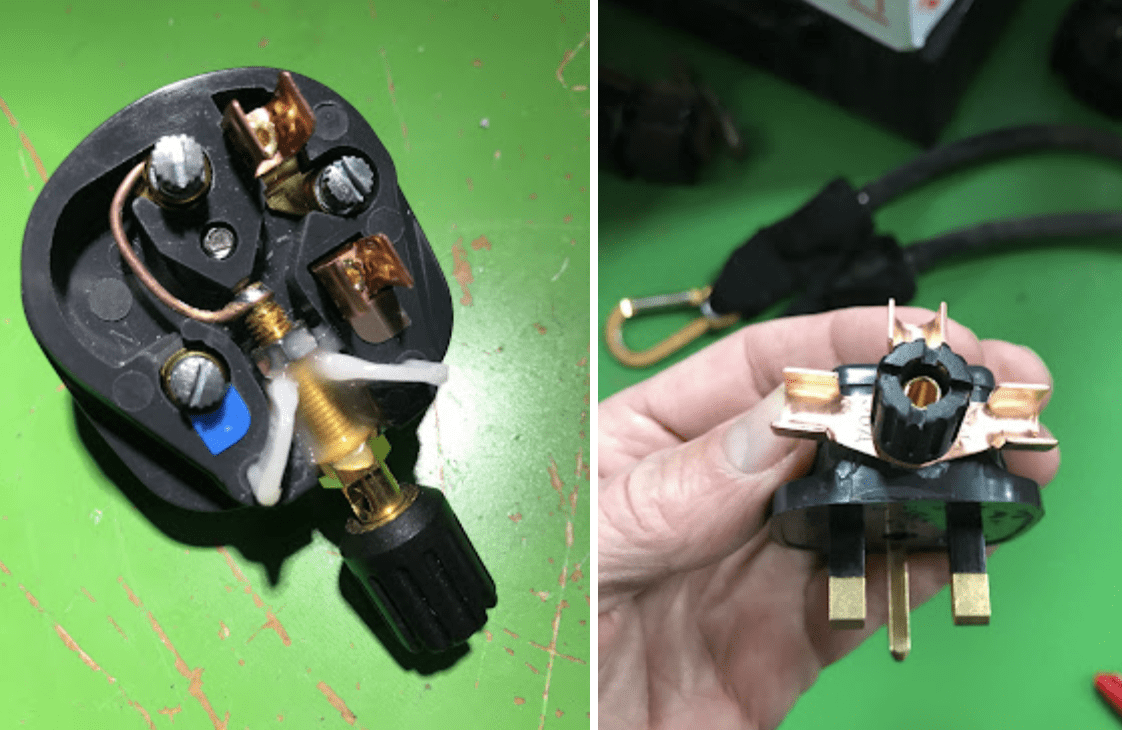

Chris, the grounding approach I have which made a useful improvement on sound quality is:
SP8 pre amp Chassis is connected by the mains power plug to safety safety earth as normal, the circuit ground is not connected to chassis earth, connected via the rear panel terminal separately to a low impedance cable to a separate mains plug that ONLY connects to earth
211 Power amp Chassis is connected by the mains power plug to safety safety earth as normal, the circuit ground is not connected to chassis earth, but connected via a connection separately to a low impedance cable to a separate mains plug that ONLY connects to earth
DAC No chassis earth, but I have added a connection separately from Signal Ground to a low impedance cable to a separate mains plug that ONLY connects to earth
All signal grounds are connected in a star pattern to the earth only plug. The DAC connection to add signal GND does add a tiny humm at full volume, but it still sounds better than when it is not connected, and I have 99db/W speakers and a preamp with 23dB gain so I am nowhere near the volume position that creates this hummm (and it's been like this for a couple of years)

Yes, but where does the earth only plug go? Does it connect to PE? Don't know where you live or any idea about your local mains wiring.
If your situation is like North America, where PE is brought back to panel, then connected to both mains neutral and a ****-poor actual Earth rod, then the solution is easy: stop doing that. It would be deliberately adding long ground loops. If not, then maybe you could clarify.
All good fortune,
Chris

The layout is like the scketch attached. I hope this makes sense.
The house is supplied by a PME system which has no earth spike, as the incoming earth is very low impedance.
The earth only plug goes back to the same consumer unit, just on it's own earth line back as a separate spur, as each plug is on one spur in the consumer unit, and also 1 MCB.

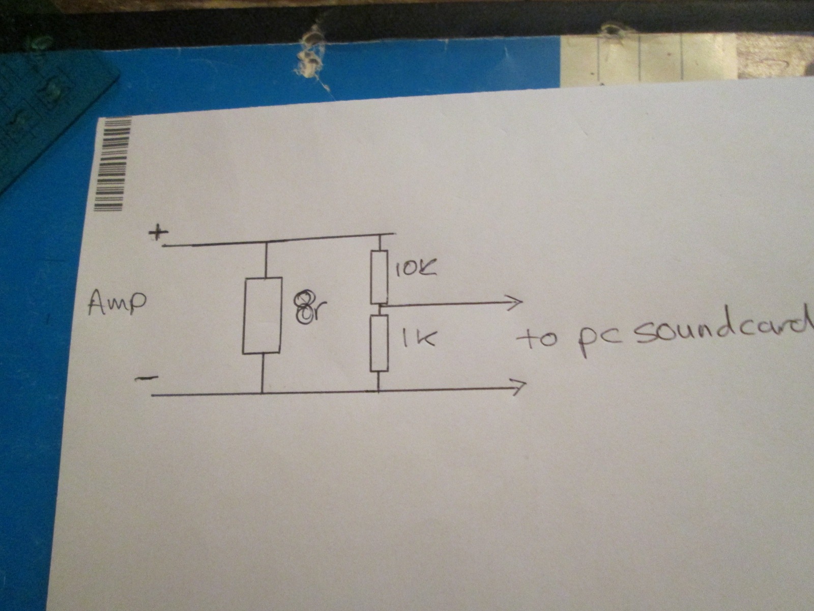

You might be able to measure the frequency of the hum with Audacity which has an FFT function or another bit of free software like Soundcard scope. thing is you need a dummy load, IE a 25/50w 8r resistor in parallel with a potential divider to reduce the voltage seen by your PC's soundcard, see sketch attached.
Andy.
