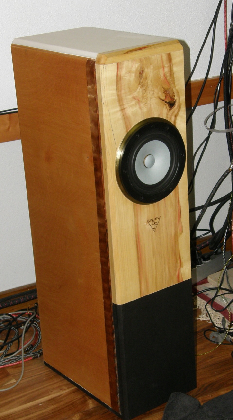

Glad you like my ghetto solution lol.
This principle comes from the constant need of modifications as I am never happy with anything and want to change drivers and combinations and what not constantly.
If I get sick of the horn I can make a new baffle and swap it to a normal midrange or just make it two way.
If I want a new bass hopefully the cutout and the bolts fit, if not I can adjust without having to start all over with a new cab. Also double baffles serves well as a resonator killer.
Maintainability, flexibility, upgradability and modificability are key to me.

I'm guessing that you wouldn't appreciate some of the Harbeth speakers, some have LOADS of bright galvanised screw heads strewn across the front (dark) baffle, why? They'd look so much better with black screws. I think with oak you should use brass because of the acid in the wood, but there's not many oak front baffles.@planet10 While I appreciate your creations and admire the attention to detail, funny thing is, I don't like to see bright colored screw heads on black surfaces. It drives me crazy. Sort of looks cheapened to me.
Yeah, Harbeth is a thorn in my eye. I've owned 2 pairs of them. Loved the sound and the way they convey acoustic space, natural tonal balance and how they integrate into a room. Playing a vocal or instrument solo is shockingly real, like the performer is in your room. No other speaker can do this the way Harbeths do.
Now that being said, i hated their look. I actually painted all the screw heads black, in a way it could be reversed upon resale.
I miss these speakers alot, especially their midrange quality. Just hate the way they look.

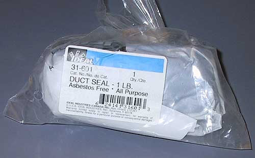

I have press-fitted small drivers with butyl caulk (sold in bricks and sometimes strips/rope for electrical and air duct sealing)
eventually it will harden but not be a permanent bond. it helps to seal the wood baffle with varnish, paint or glue to make a non-porous surface for stickiness.
air duct sealing
The stuff actually called DuctSeal is by far the best i have used.
Sorry, don’t have a bigger picture of the label.
