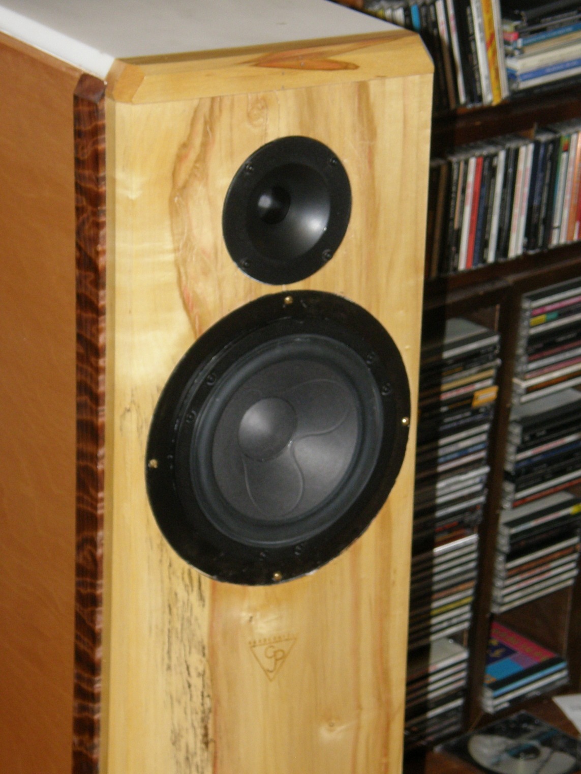

This sort of thing can be so much more work than expected. MDF has plus and minus applications. Another idea if you the space on the baffle is to make a ring of strong material that is larger than the tweeter size. That means you can attach this more reliable quality material permanently to the MDF baffle and the allow yourself to choose a better way to attach the tweeter. I used Corian once for just such an application. In my case, I was able to use T-nuts without incident. Yes, they had to be modified and permanently epoxied to the rear of the Corian, All while keeping the holes of the tweeter aligned by mounting it during this process. To be clear, this is done before the Corian plate is affixed to the baffle. Once done then epoxying that Corian plate to the baffle will yield a stable strong mount for the tweeter and can be removed multiple times without any trouble. It is more work up front that pays off in the end.

My mistake. As it turns out, I have done the exact same thing for a full range 8" driver successfully. It also had a roundover on the backside.

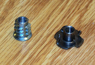

I use threaded inserts (like the one on the left in this pic). They take up less space than t-nuts, so they can go closer to the edge. It's also possible to install them from the front, which can make things easier if the back edge of the speaker cutout is rounded over.

As others, I am not a big fan of TEE nuts or "hurricane" nuts unless I have access to the rear. A failure with these can be fatal. Inserts are a better option in that they can be removed. In my experience, however, they can make a total mess out of plywood and can degrade MDF with all the stresses they create. For small drivers, screws. Don't oversize the cut out so the screws have a fighting chance.
