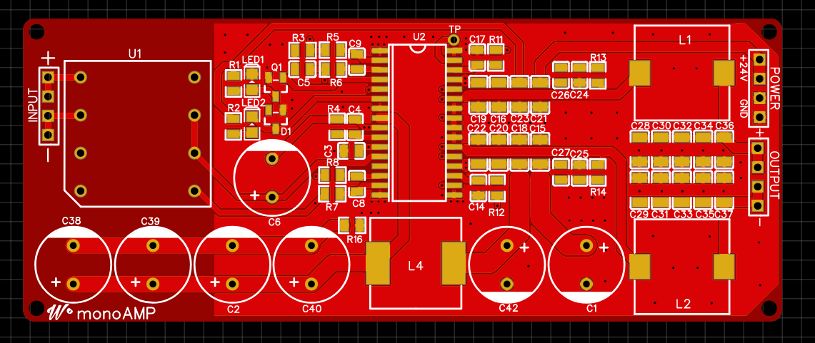

Mono transformer isolated amp board

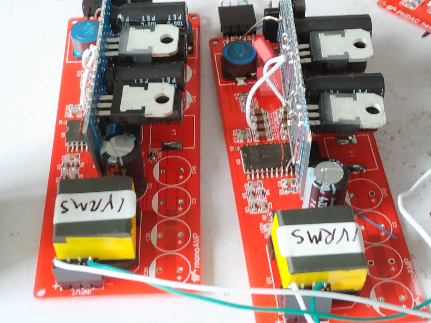

After many years modding and developing amps using TDA8932 I at last made a PCB for a mono implementation of this delightful IC. For the sake of simplicity its using an LC filter on the critical-for-SQ rail on pin8. When I listened to this it was OK-sounding but the bass wasn't quite as dynamic as it could have been and massed voices sometimes sounded grungy.
I put my USB soundcard on the pin8 rail and recorded what was there. Audacity showed nice rejection of noise above 1kHz or so but lots of load-induced noise below that. So I pulled out the LC filter and installed an LM317 regulator instead. A very nice improvement in dynamics resulted along with some improvement in clarify of voices. The USB ADC confirmed a cleaner pin8 supply. So then I figured - what about powering the main rail (pins 20,29) with a regulator too? An LM317 can deliver up to 2.2A provided the voltage drop isn't too high so I figured with my 8ohm speakers I'd be good if the rail was only 16V. The result was a significant lift in bass tightness or tunefulness. So the PCB's going to be modded for regulators on both chip supplies in the next rev. Stay tuned!
I'm also planning to extend the working voltage higher a bit by using a slightly higher rated regulator - LD1085 (3A) so the supply rail can in theory be pushed near to 24V.

Thanks - I'll be putting the gerbers up, normally cheapest to order boards yourself from someone like JLCPCB as their shipping rates are unbelievably low. Most of the SMD is 0805, nothing smaller than that. The transformer is a custom wind on EP17 10k core, you can wind it yourself or alternatively buy from me.
