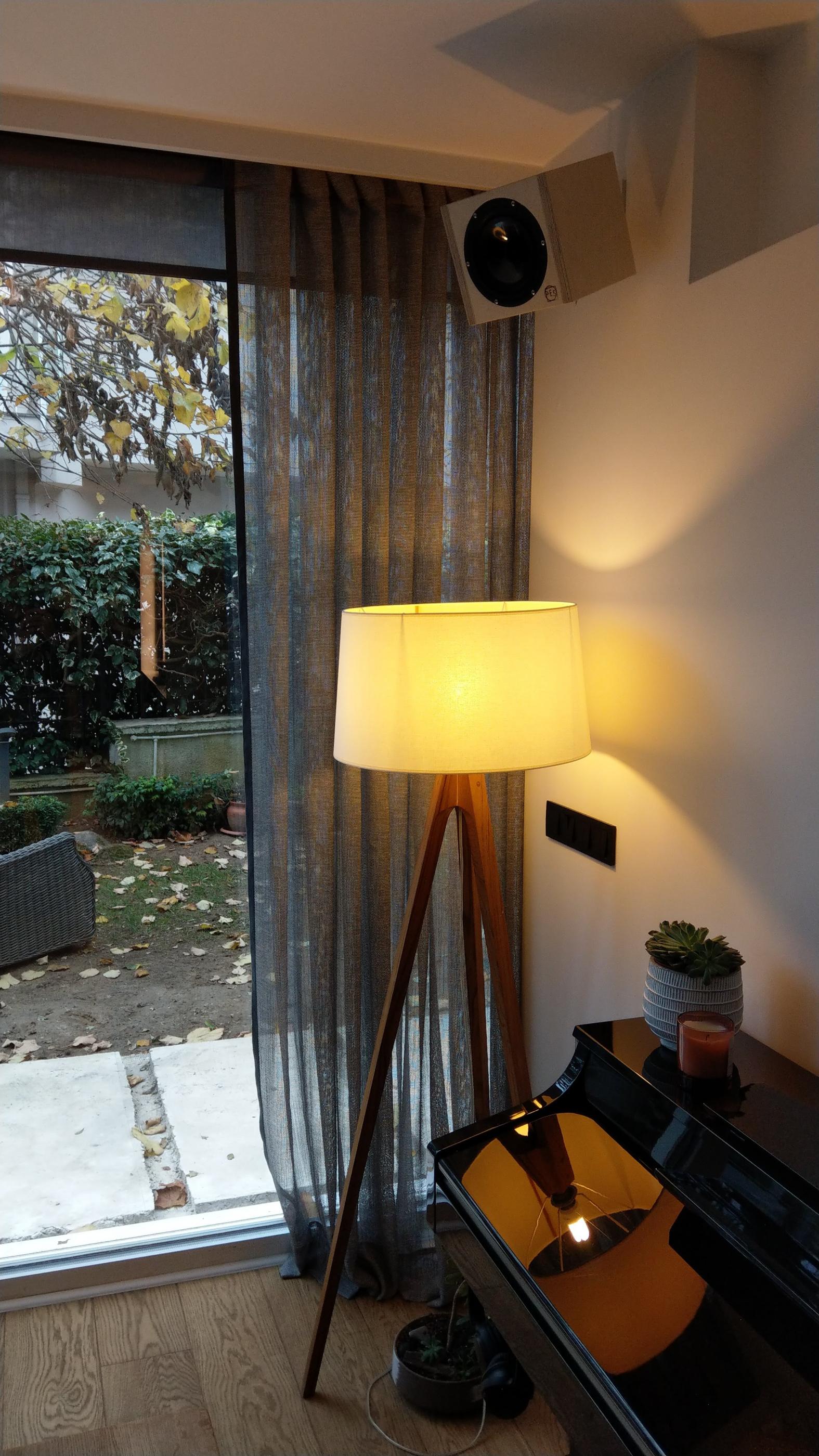

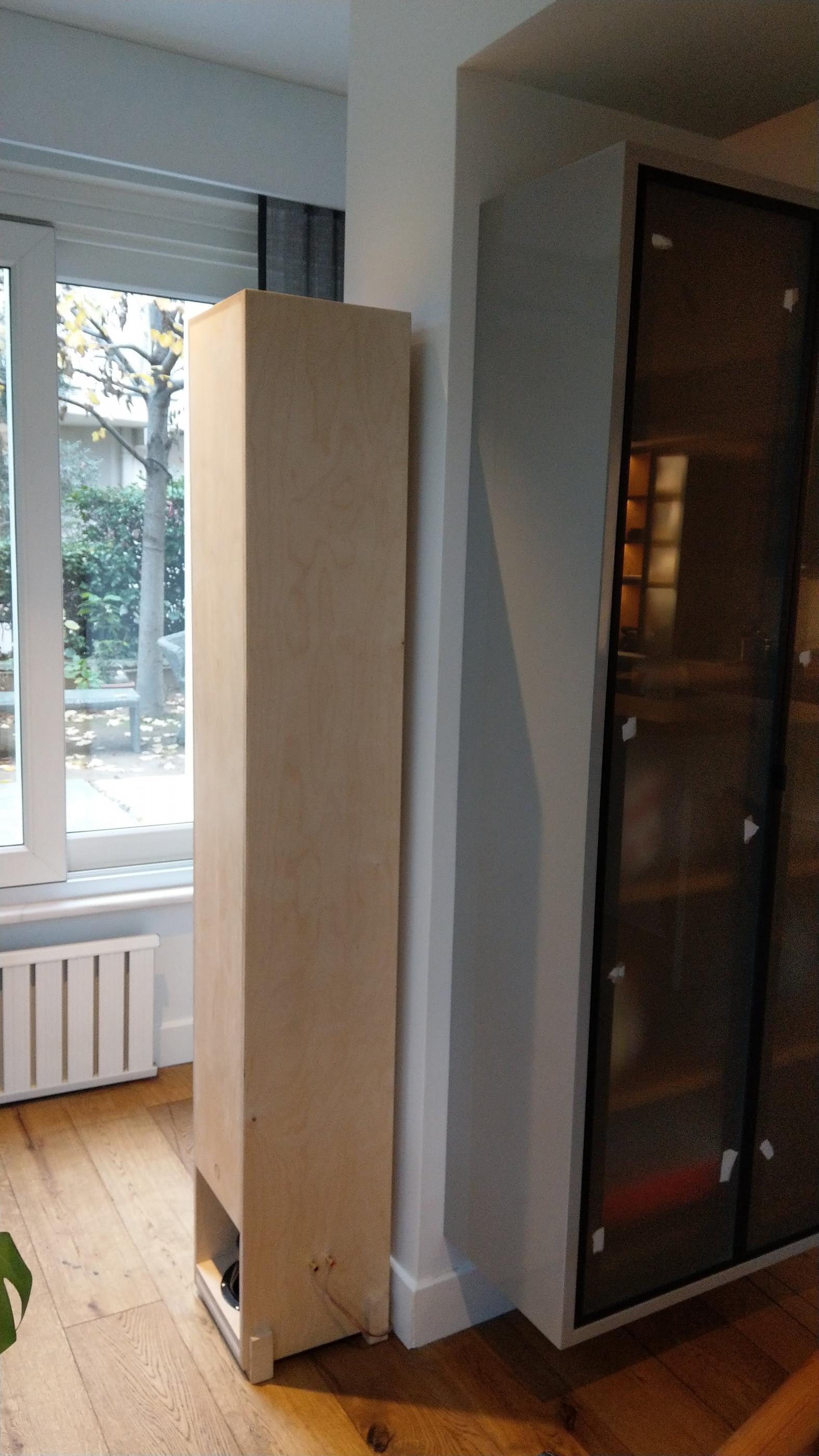

Yep still looking at drivers 🙂. I'm quite new at the hobby and so many requirements, small cabinet, shouldn't beam, point source, 8 ohm etc. etc. I just got an extension 🙂 The kitchen renovation won't be finished until mid september. 😀
Finally it looks like I found the right driver. It has a matching crossover too.
Thank you so much for all your help. You got me thinking about coax's. Thanks a bunch to Dave and Pico as well.
System done and installed.

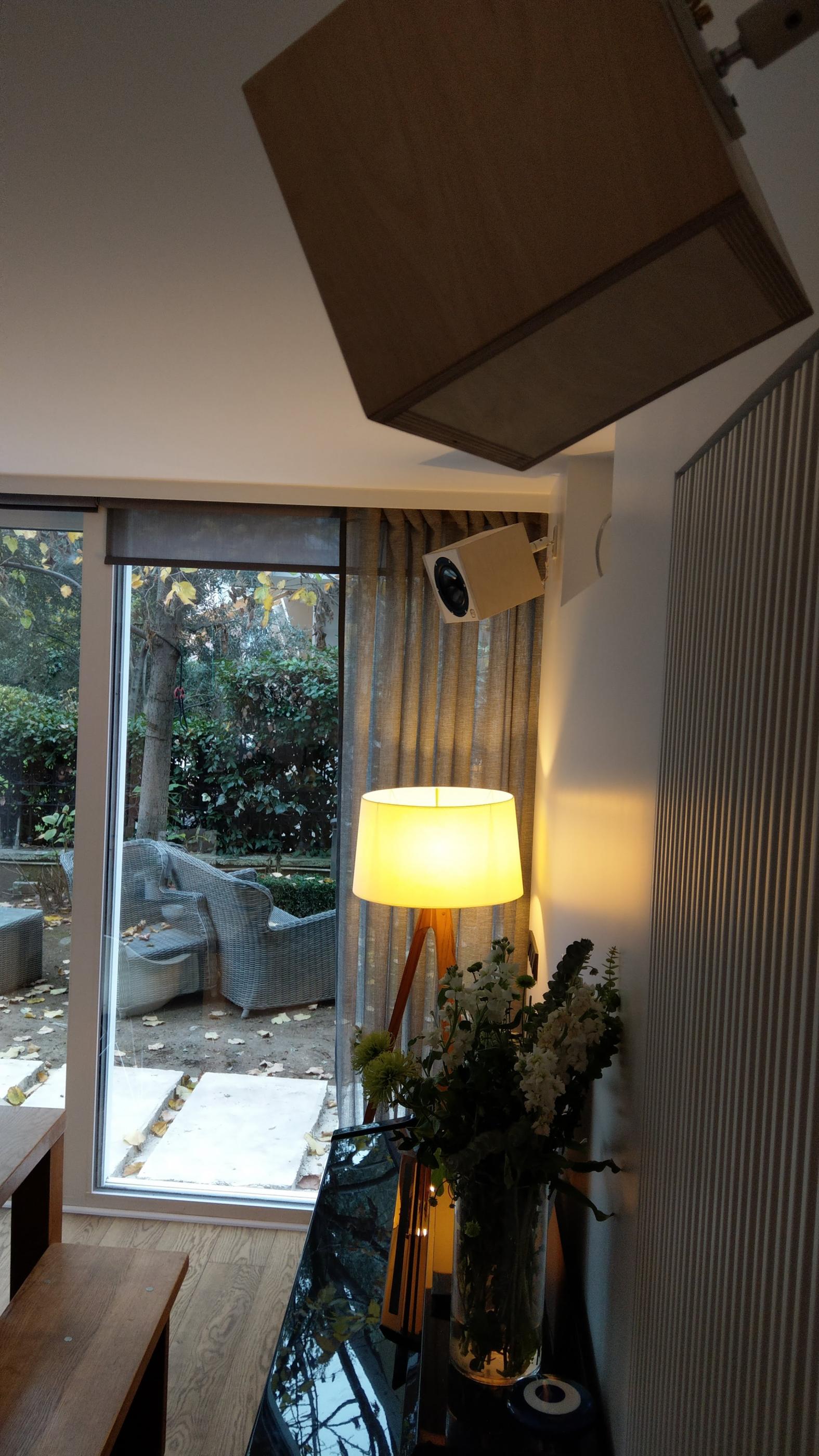

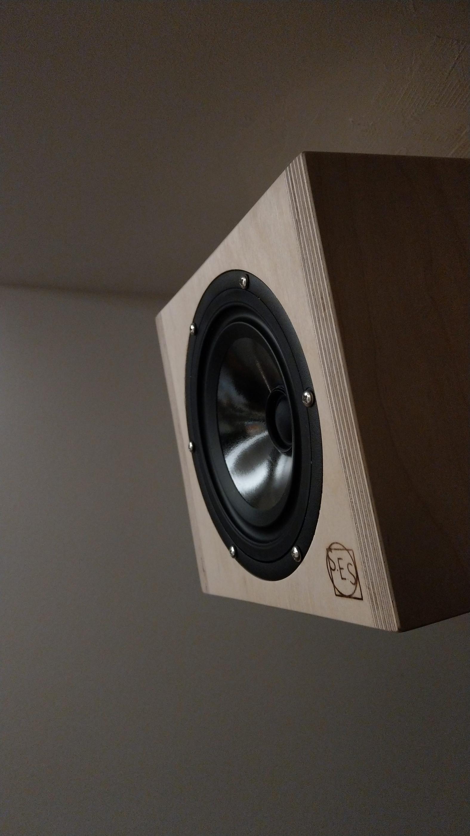

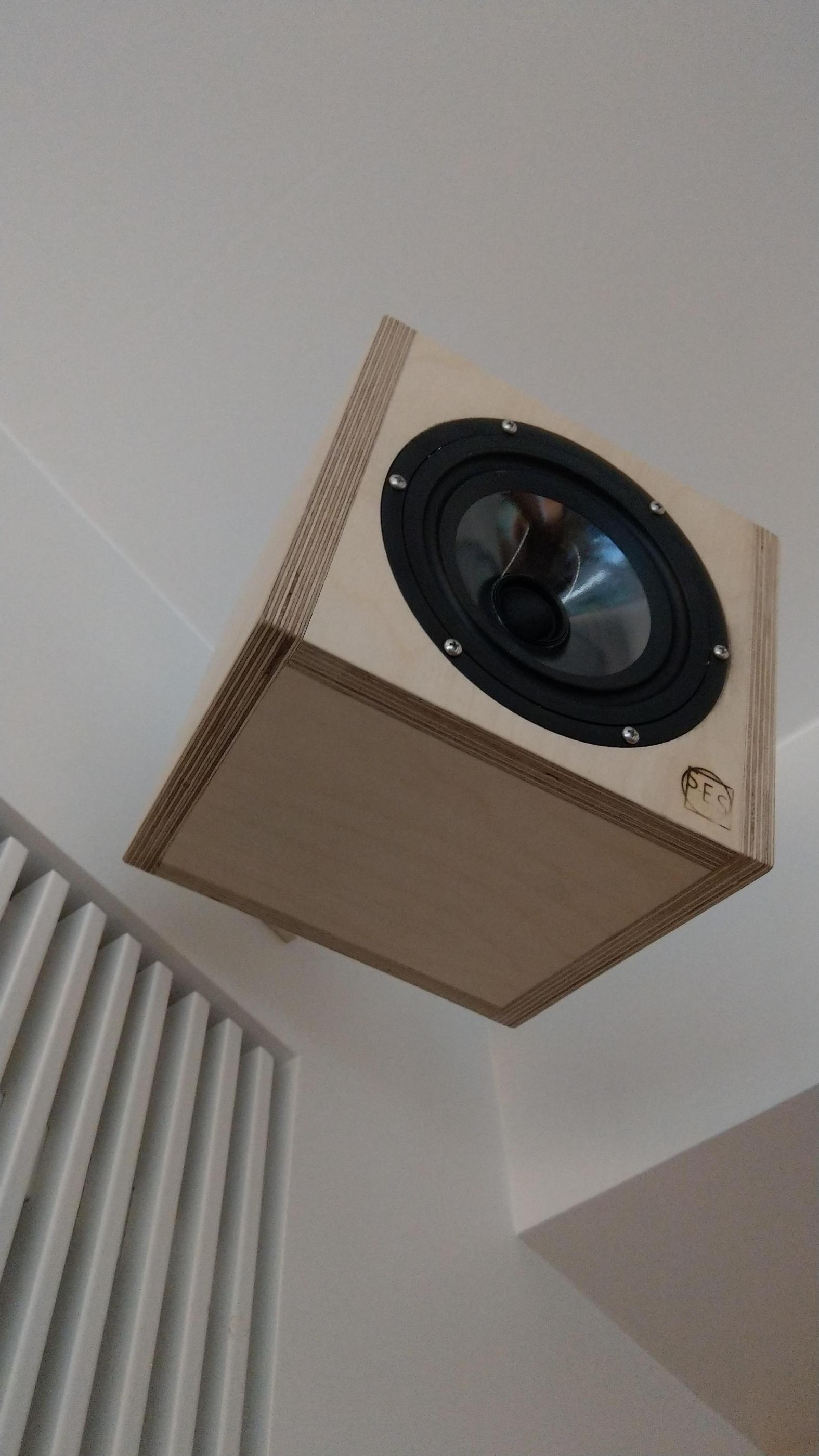

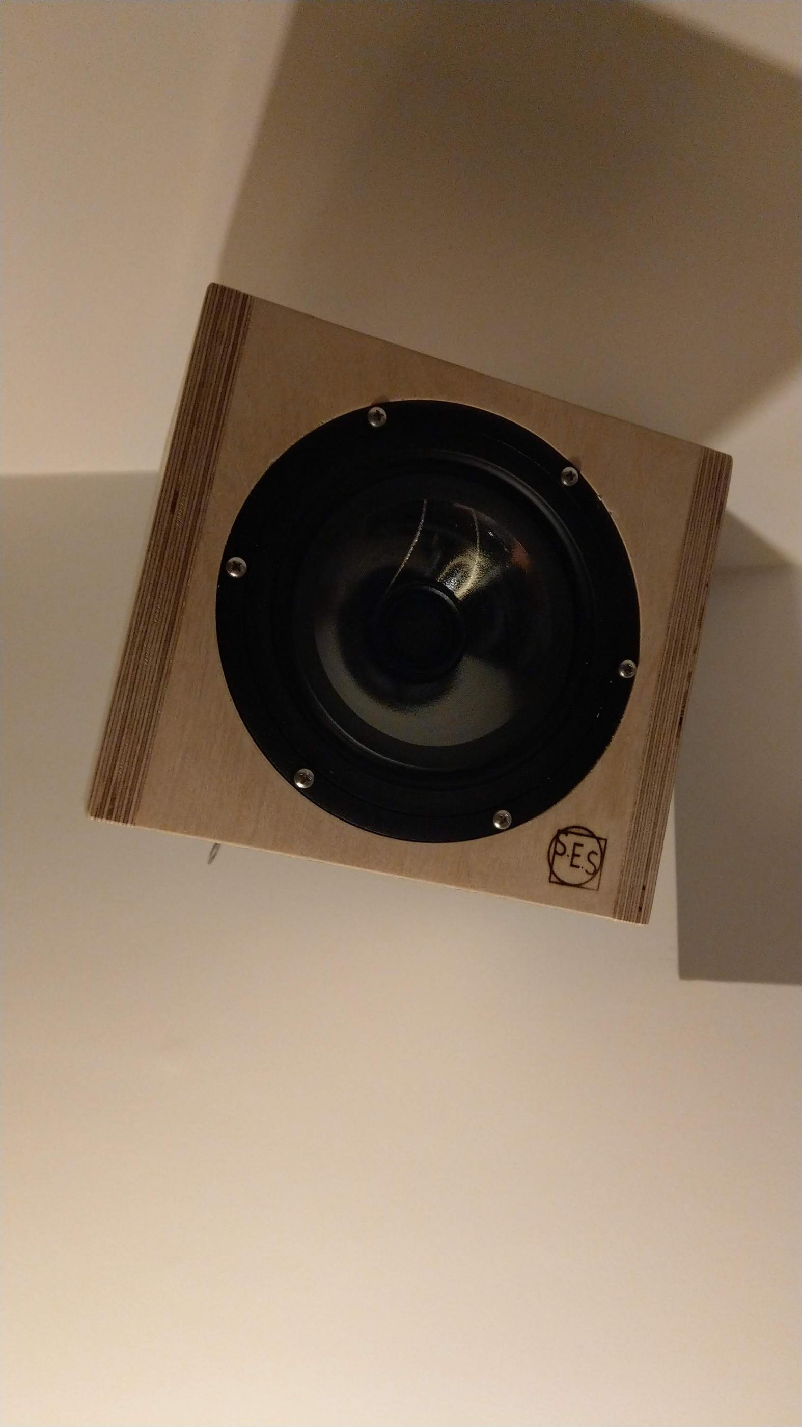

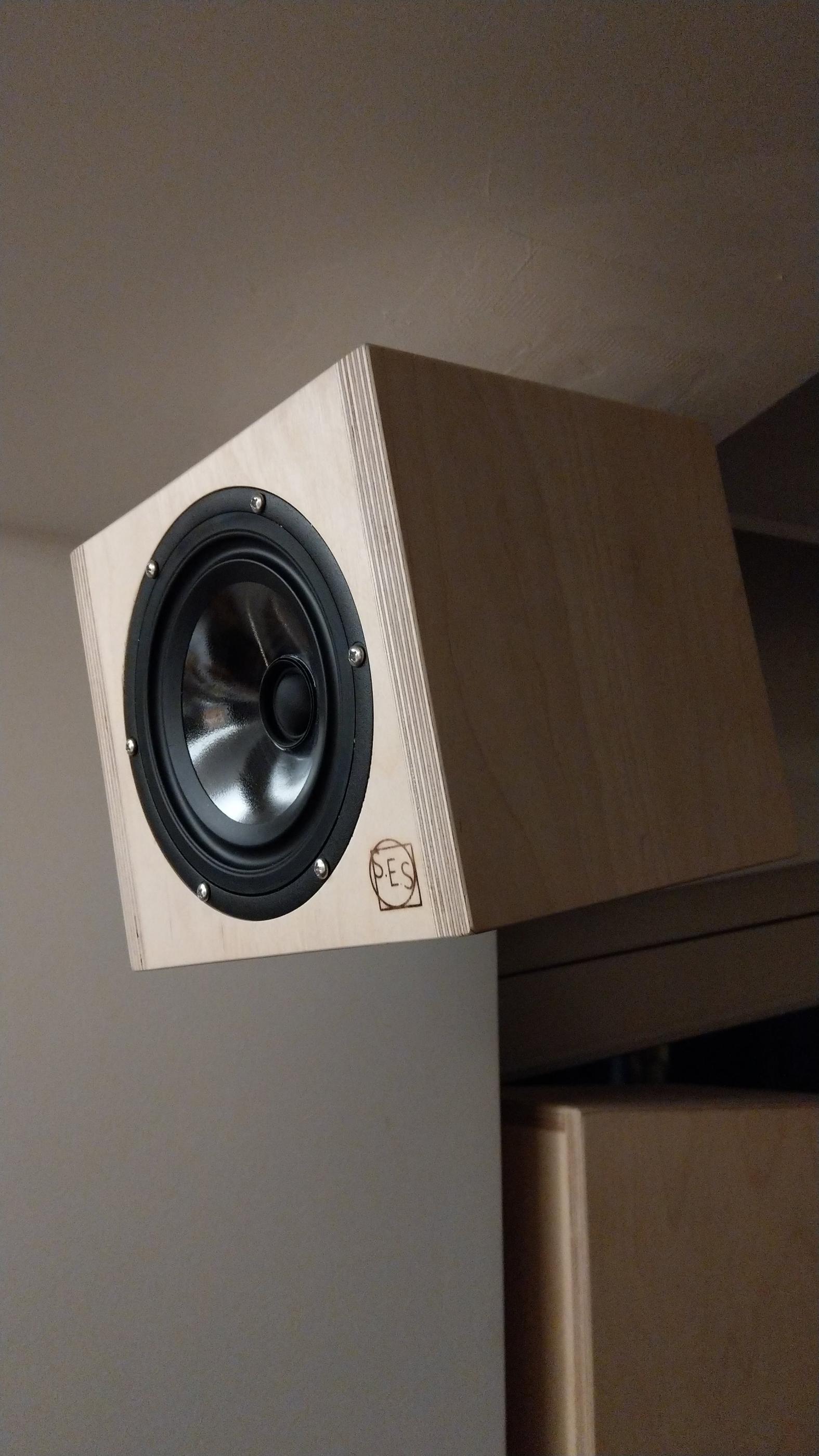

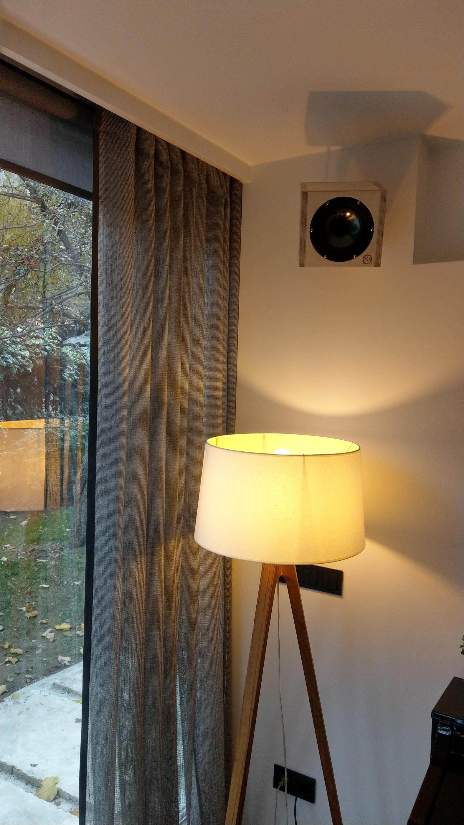

Thank you all for your help. I installed two tapped horns crossed at 100Hz with a miniDSP Dirac. The 4 tops are SEAS H1353-08/06 T18REX/XFC coaxials in 5.4 liter closed boxes. Great results. Here are some pictures. Thanks again!
