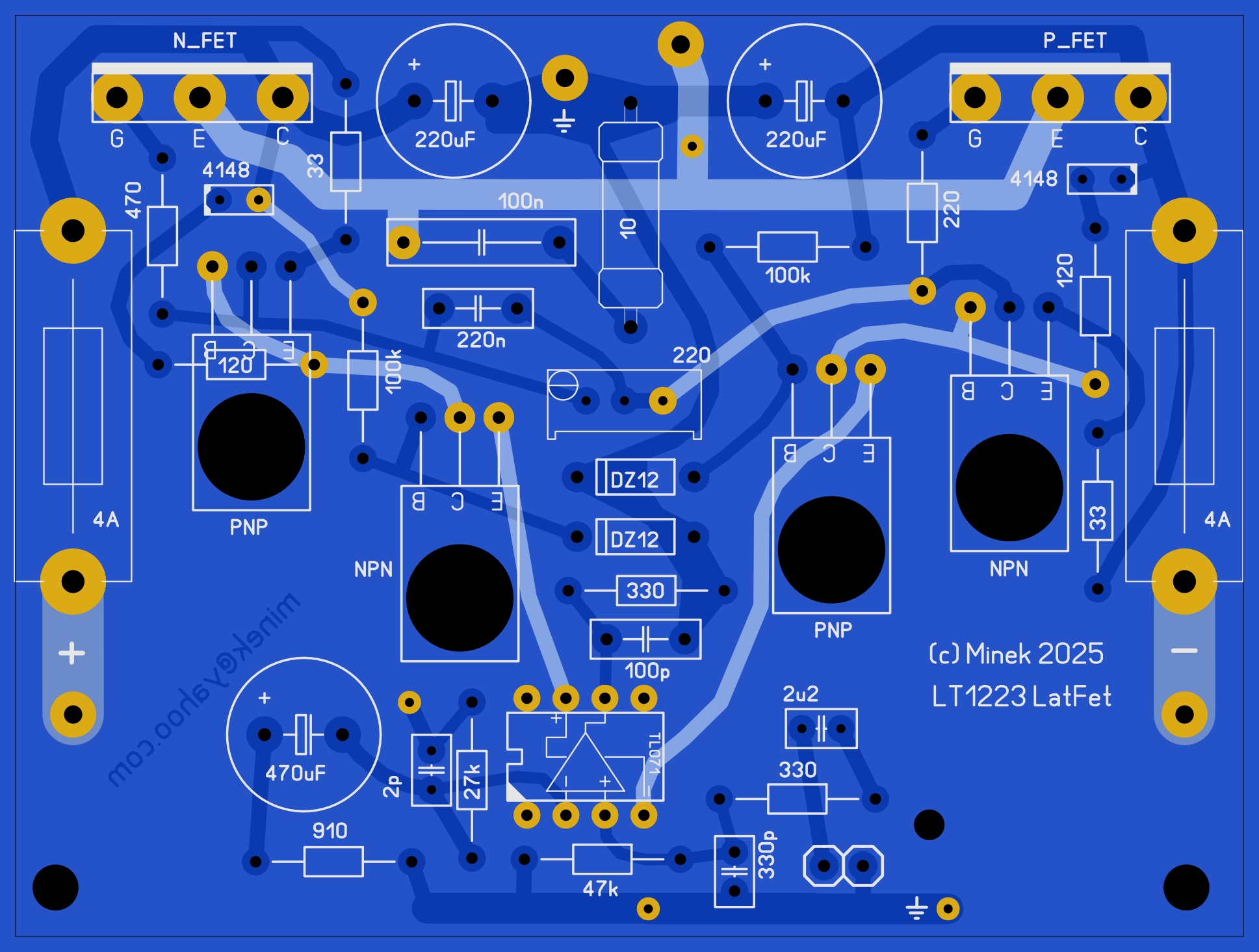

It turns out, that simply removing C4 (2pF, feedback cap) fixed everything when using LT1223 op-amp.
And that the 2nd thing I tried 🙂
First I tried to add 2pF of capacitance to C4 (because it's easier then removing it), but this
was a move in a wrong direction.
So next I tried to lower the capacitance...
I guess the traces on the PCB provide enough capacitance, and together with 2pF cap it was too much....

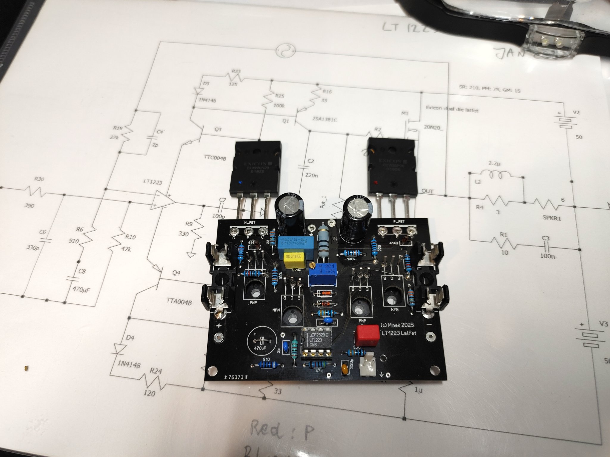

I modified my test bench by using vise, to make whole thing more accessible and stable while soldering..
I guess it doesn't look very professional, but it worked.

2e-12 farad made the difference? Yikes! That's in the range of the opamp's Cin.
But the effective value of Cin is a bit nebulous in terms of the Andersen topology, since the opamp's supply rails are provided by active devices. They have their own frequency-dependent characteristics as well. I'm basically saying that the effective Cin could depend on the opamp's supply rail's AC response. One interesting thing to try would be to add some capacitance between the opamp's Vcc and Vee pins, to prevent some types of shenanigans. Since current variations in the opamp's Vcc and Vee supplies will track, there shouldn't be any bandwidth penalty in doing that.
Have a 2nd channel up and running. Everything the same as the 1st channel.
As previously reported, C4 should be omitted when using LT1223 op-amp,
BUT for the other op-amps I tried yesterday, C4 (2pF) should NOT be skipped.
The following op-amps have been confirmed to work correctly (besides LT1223):
LT1357, TLE2071, TLE2081, AD711, OPA134, LF356.
These other op-amps were not simulated in LTSpice, just confirmed that they seem to work OK in the real amp.
The schematic and sim may not be optimal for these op-amps, so there might be some space for improvement
if using non-LT1223 op-amp.

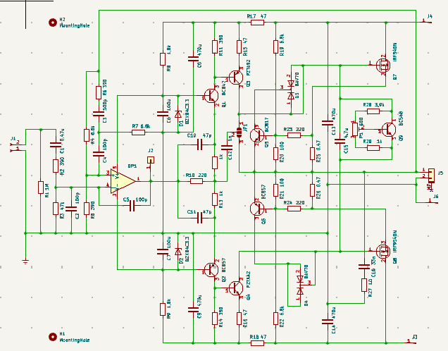

I tried today HexFet version of this amp - schematic posted in post #1.
New PCB arrived very quickly this time, and there was no extra tariffs/duties, so it's still very reasonable priced.
Basically, HexFet version of the amp performs pretty much the same as LatFet version. Very stable, rise time on square
waves in the the same range (160ns - fastest measured).
The only difference is that C4 (2pF) had to be present. If it's omitted, there was a little of ringing present on square waves.
With C4 included, everything worked fine.
From simulations looks like it will work fine with IRFP240/IRFP9240 outputs as well.
Q8 was connected to the PCB with wires, and mounted on the heatsink close the output devices (temperature sensor).
