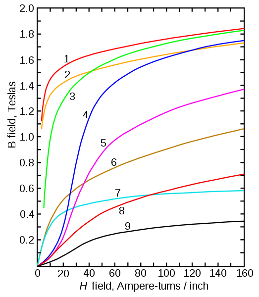

The typical steel alloys that guide the flux in most loudspeaker motors also have quite nonlinear BH curves, and this interacts in series with the BH curve of the magnet itself, especially at low frequencies. At higher frequencies where eddy currents in the return circuit close to the voice coil come into play, I would suppose the BH curve of the magnet contributes less distortion.
Magnetized NdFeB has quite a linear BH curve. I don't recall seeing the BH curve of AlNiCo, but I have heard it is more linear than that of magnetized Ferrite. In the olden days, a happy coincidence of using AlNiCo magnets was that the relatively high electrical conductivity of the material made the magnet itself function somewhat like a giant shorting ring.

I'm no expert either, but my understanding is that B-H linearity in steel loudspeaker motor parts is a relative thing, and it depends on a lot of variables--such as the alloy in question, the flux density it's carrying from the magnet, etc. There can be two ranges of relative linearity in the B-H curve--below saturation under the "knee," and into saturation above the "knee." Under the dynamic conditions of loudspeaker operation, either of these linear ranges are easily violated as VC current alternately adds to the magnet's flux (drives the steel's operating point deeper into saturation) and then pushes against the the magnet's flux, sometimes going as far as to momentarily reverse the flux flow through parts of the steel return circuit.
Steel seems at best a necessary evil in loudspeaker motors.
