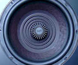

Faraday ring in louspeaker driver, what is it?
