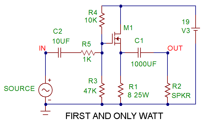

It's a slow day. Time for a little entertainment - a micro project!
Someone sent me a request for a simple 1 watt amplifier.
How could I resist?
My answer:
Assuming that your preamp can put out 2 volts (and it should),
a 1 watt design would be the easiest thing in the world.
Attached is an example.
I will put it up on the Pass Labs forum at diyaudio and see
what kind of suggestions it gets for construction and improvement.
Feel free to post questions.
"Zen Mod" will likely be the first to take the bait.
The following draws 1.5A off a 19V computer desktop supply and gets
1 watt into 8 ohms at about .5% THD.

I would say…...why not the ACA instead of this?
The idle current is the same so efficiency much better in ACA amp?
So if heat generation is the same as the ACA......what is be benefit other than it is slightly more simple?
How does it sound?
How does it sound?

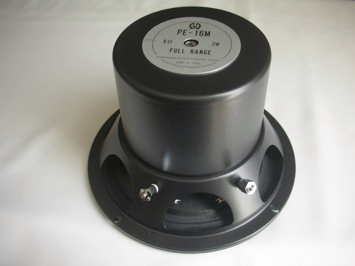

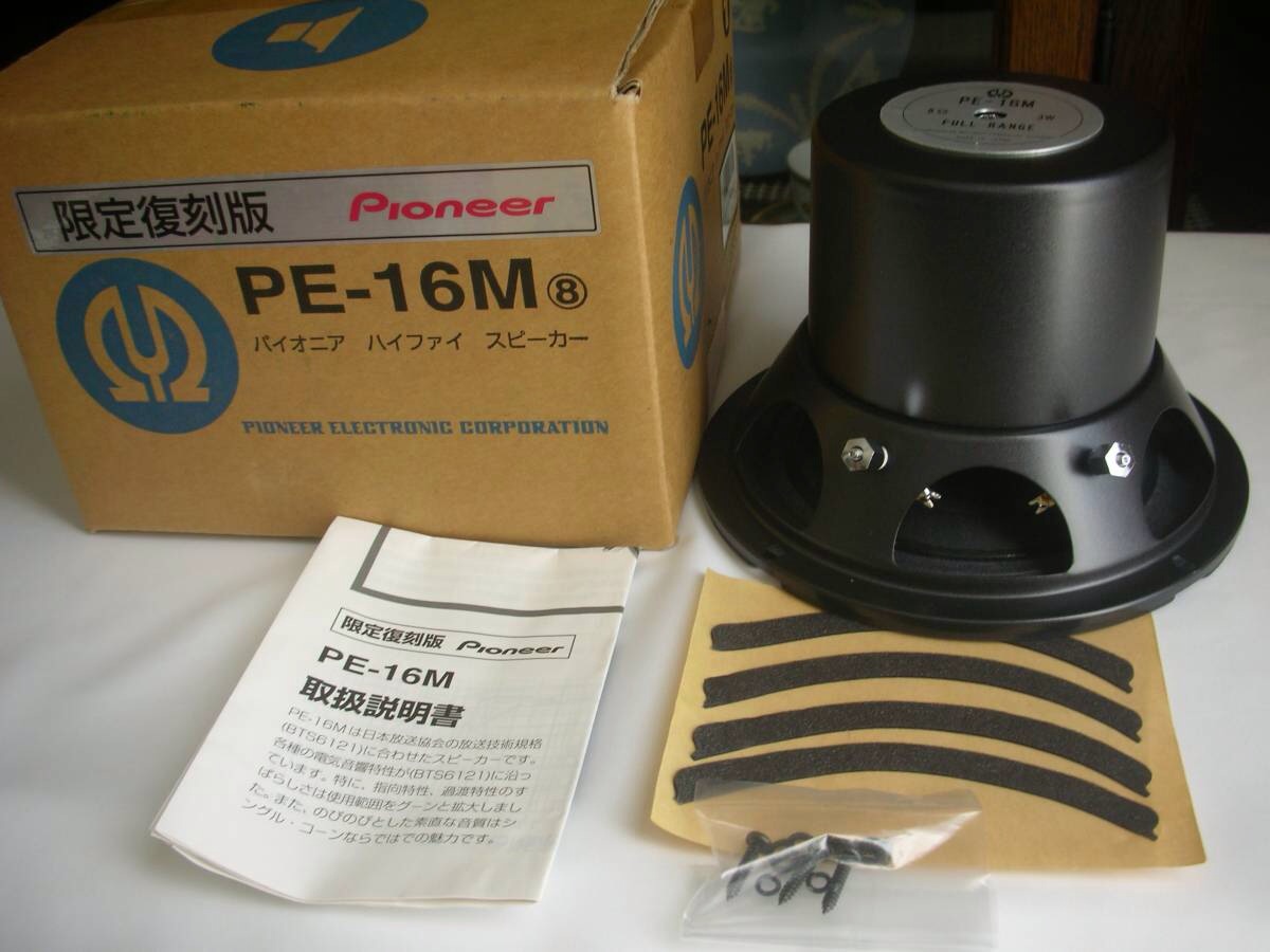

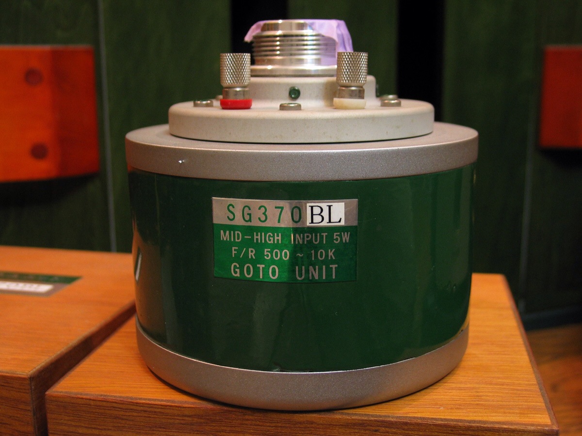

1 watt for mighty drivers rated 3~5 watt's max

Ok....but with 2V in it gives 2V out.....it is only 0.5W in 8 ohm?
So the preamp needs to put close to 3V out to have 1W in 8 ohm.
Therefor I concluded it had a little bit of voltage gain 🙂
For a 115 dB system 1W is more than enough…….if impedance curve is nice.
I wonder how such a small amp sounds. Is it a 2nd harmonic "beast"?
For a 115 dB system 1W is....

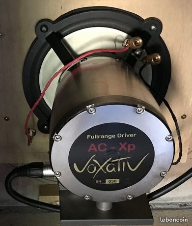

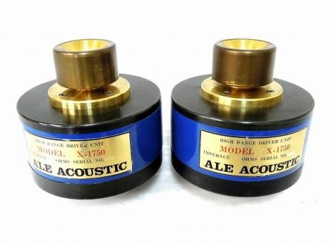

Permandur field coils second hand cost ~ 14K, new pair 27K€
Available in France Large bande Voxativ AC-Xp
A dream for
How many do you have of those?

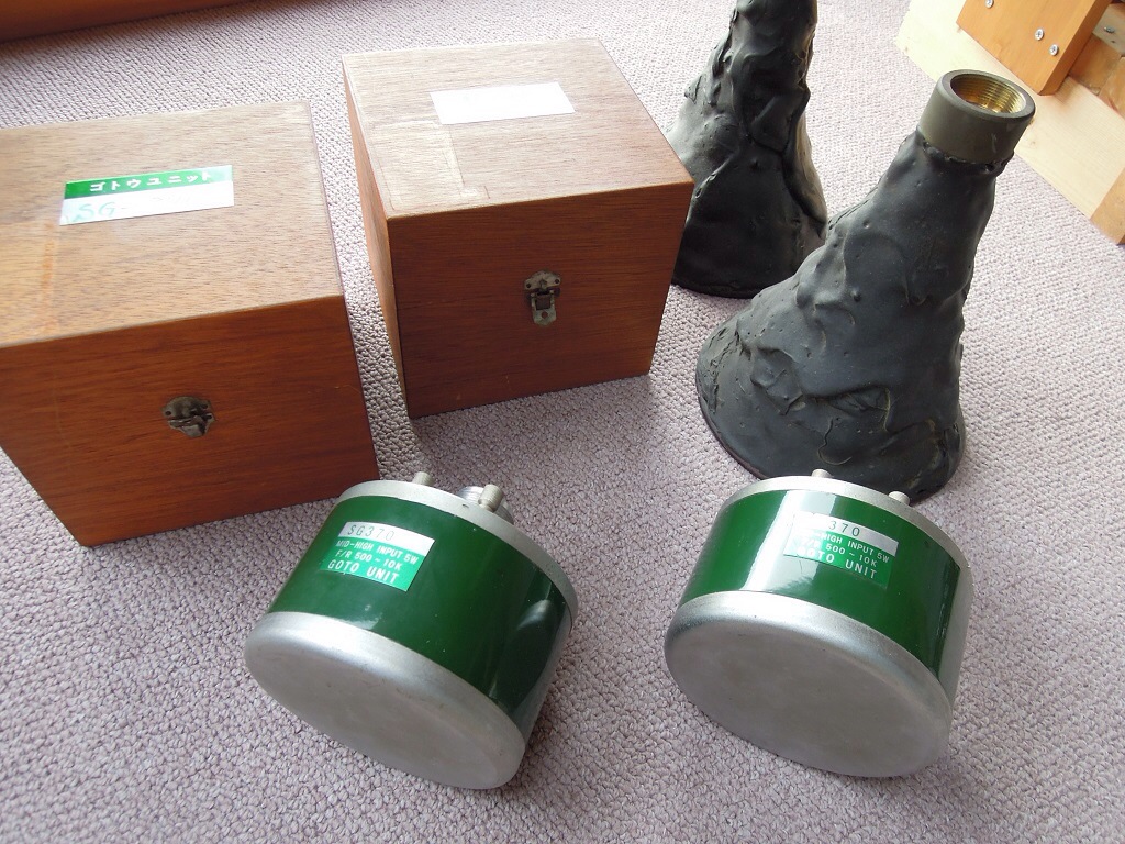

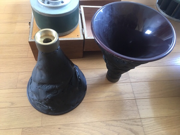

There is also the GIP Lab stuff:
speaker units english
They use drives with field coils…….the big mid horn driver is +40 kg.....and also relative expensive. Think you can build 1W amp systems with those also…..
