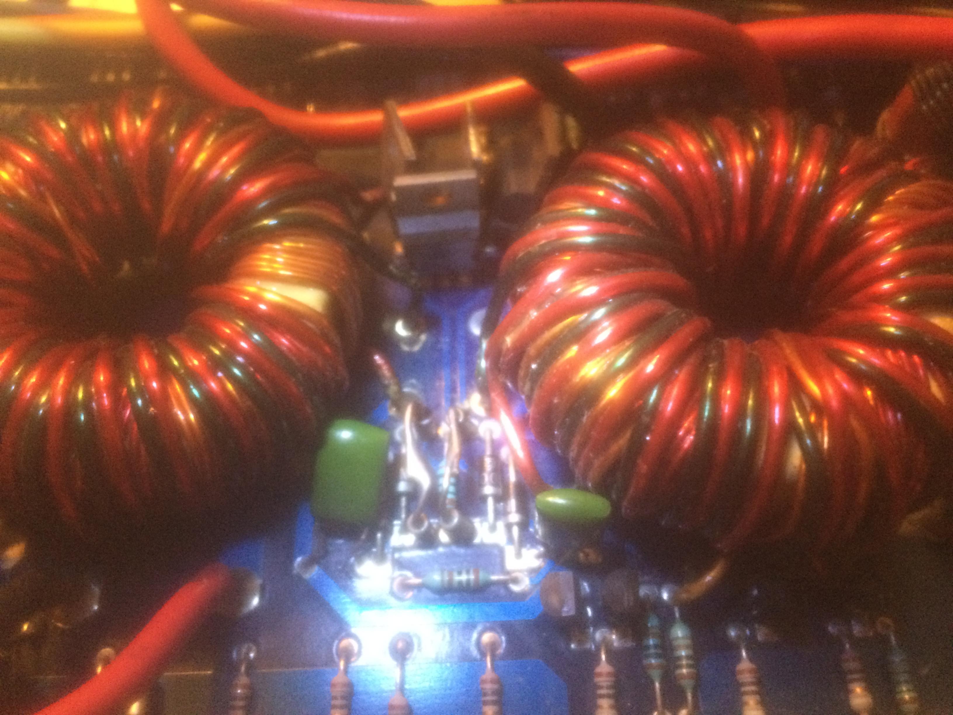

A buddy just bought it (a 2250 SX), and right now I am wondering if someone swapped a 2100 board into the 2250 sink just based on how it plays. Not to derail my own thread, but what would be the easiest way to check this visually? I requested that he bring over one of his 2100s so I can compare.

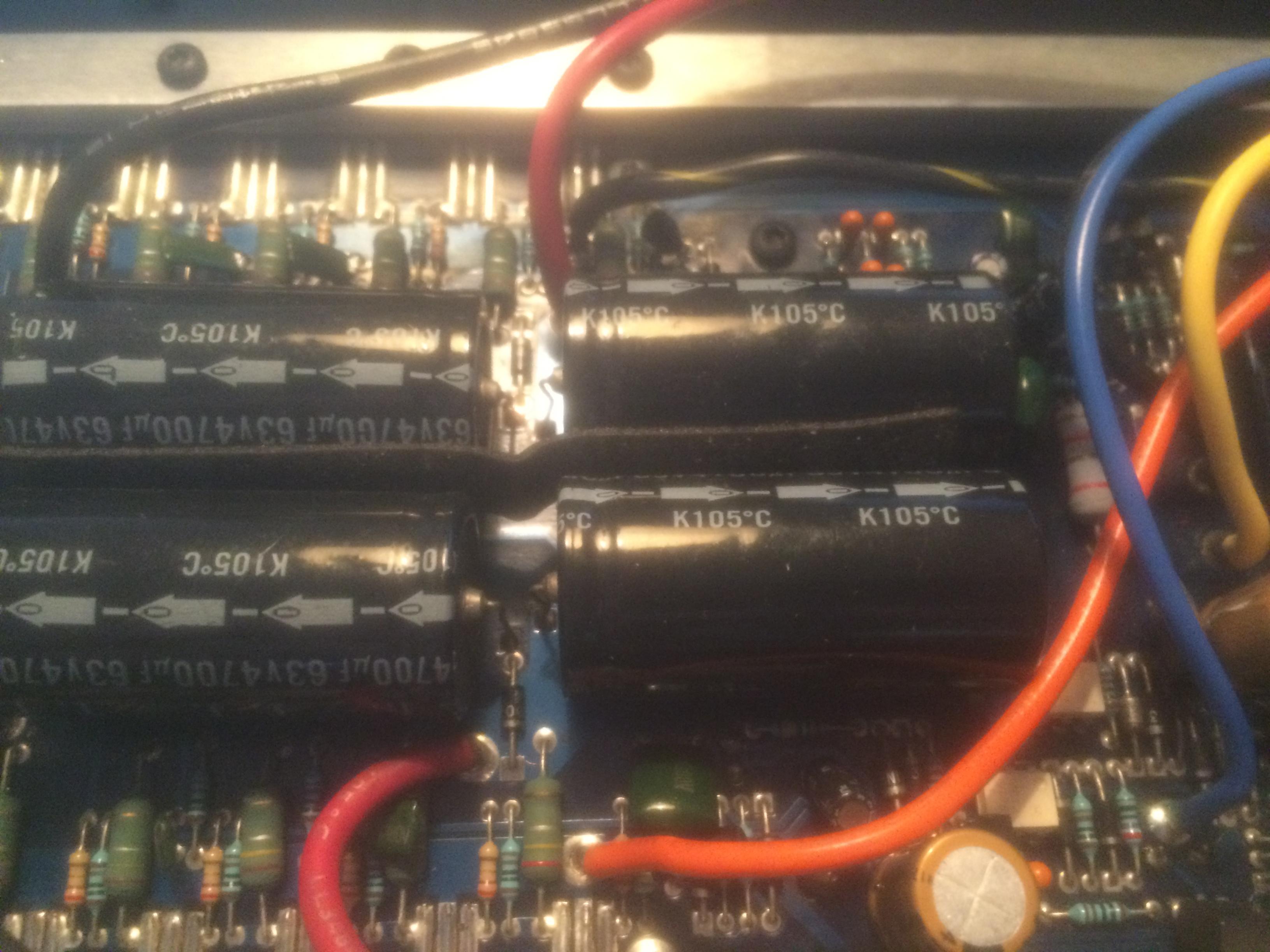

Yes exactly. Do you know offhand what the output rail voltages should be on each? I assume they would be different, with the 2250's being higher, probably at least +/- 50 at least.

I don't know the rail voltage but if I remember correctly, I think Orion used rail voltage for the 2250 was greater than the rated voltage of the outputs. Maybe ±45 or 50v.
Thank you. And the 2100 HCCA rail voltages would have been somewhat lower, correct?
Yes. Probably near ±35v. At or just below the rail cap voltage. The regulation is determined by either 1 or 2 series connected Zener diodes that are connected to the 2N6488 that's standing near one of the transformers. Find those and you'll know about what the rail voltage should be.

I attached some pictures.
I am measuring +/- approximately 51 VDC on the large black caps. They are rated 4700 uF, 63V.

Yes. The thermistor wire for the power supply side is routed under it, and I can see scratches on its housing where the fan has been hitting it. The fan itself seems perfect.
