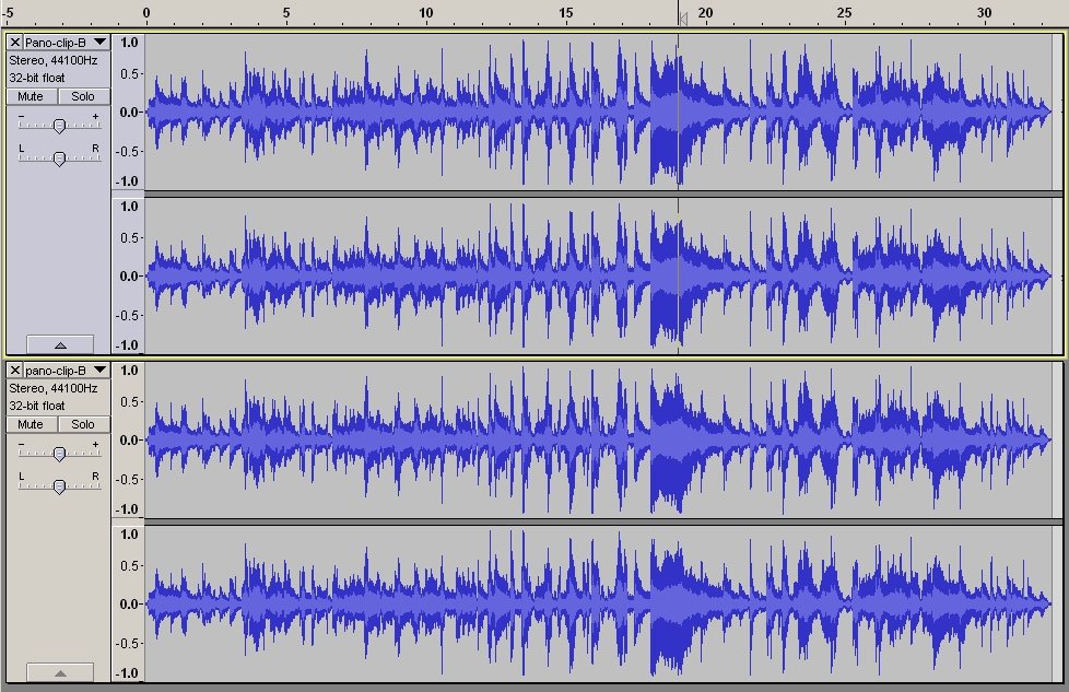

Following up with some investigation into the version B files, flac vs. mp3, some interesting things emerge. The files are different lengths of playing time, so had to be synchronised and the first bit of the mp3 file chopped off. This is the result, top file is FLAC, bottom MP3:

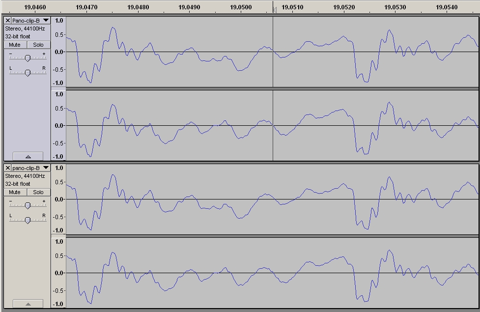

Look pretty similar? Let's take a closer look, zoom into where the vertical line occurs in the FLAC at 19 secs, where it looks fairly busy:
Pretty impressive ... the two versions look to correlate very nicely, nigh well perfect match ... or is it?

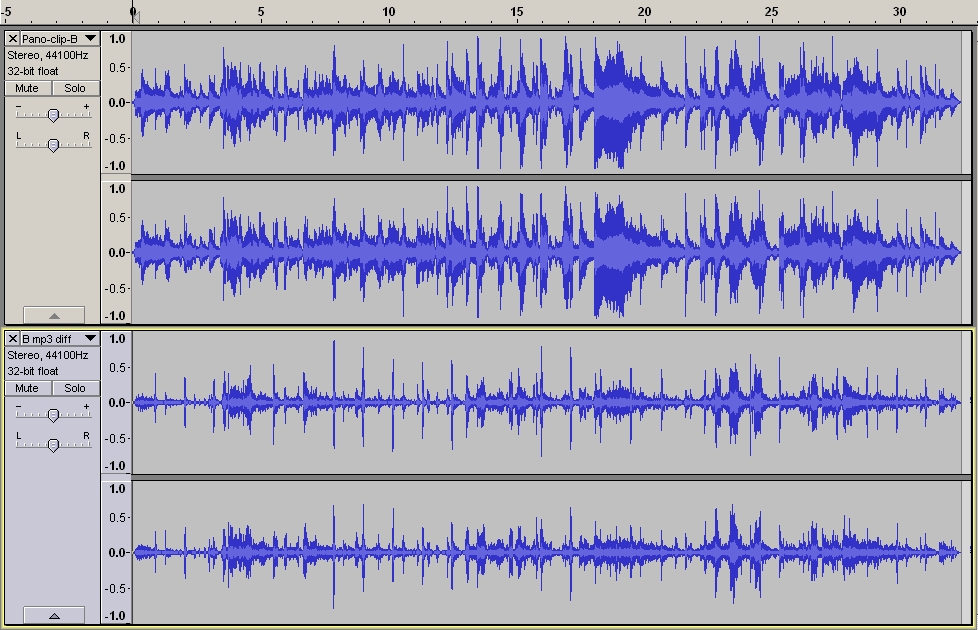

So, next step is to invert the MP3 version, and mix in with the FLAC, see what sort of null we get. At first glance it appeared reasonable using simple eyeballing, but what was the difference in the measurements we know and love? Well, to make it easier to visually pick up what's going on I amplified the 'null' file by 20dB, and this is what we now have - top is original FLAC, bottom the difference, the 'null' file with gain of 20dB:

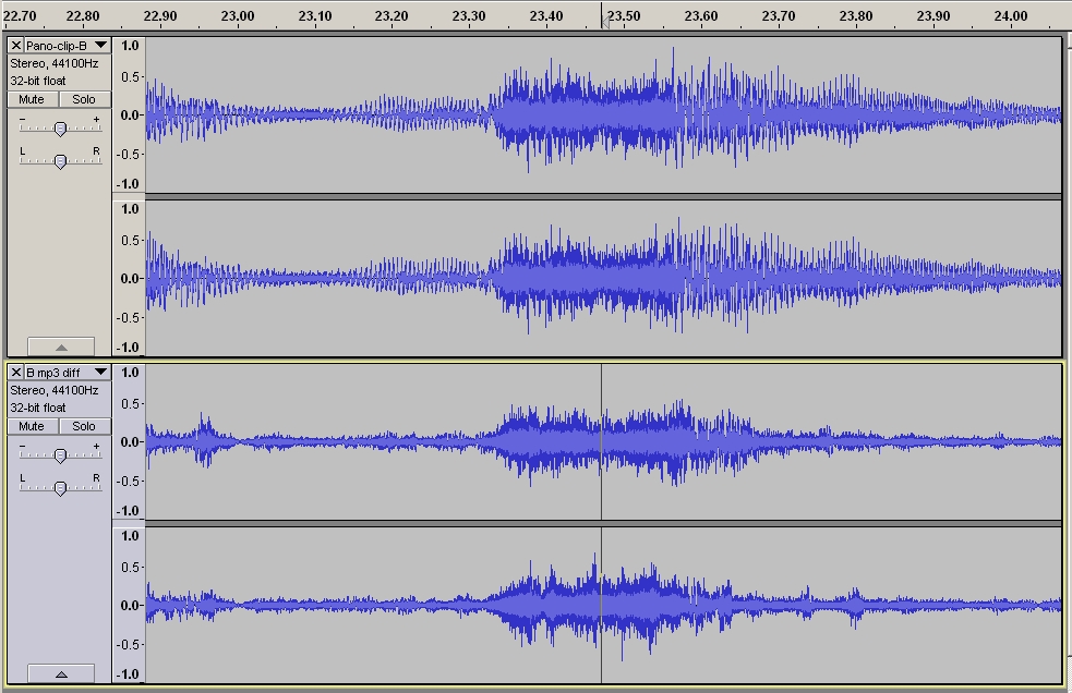

Oh dear! Some nasty spikes in the null file, and plenty of areas where the variation, or 'distortion' is less than 20dB down. Let's zoom into the 23 sec mark and see what's happening a bit more clearly:

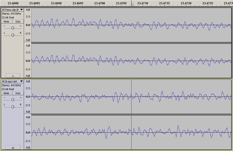

This is definitely not nice stuff ... remember that the bottom waveform is the 'distortion', amplified by 20dB. Let's zoom in yet again, at the vertical line:
Unpleasant to digest ... a whole slab of waveform where the difference component is sitting nicely at a consistent 20dB down ...
I've found that by taking a great deal of care that it's possible to get mp3 versions which largely remain at 60dB or better difference, which should be close to inaudible. But, who wants to bet that -20dB differences will be likewise inaudible ...?

Frank, wrt the nulling I think you would have to mp3 encode the exact same flacs to get a reliable result. can you be 100% sure that when you cut down the mp3 that you have it starting at the exact same sample as the flac? any tiny difference in start time will affect the result.
I think pano said they were 320kb you could try converting with default options and see the result. would also be interesting to see the difference between different encoders, which are set to the same settings!
Tony.
