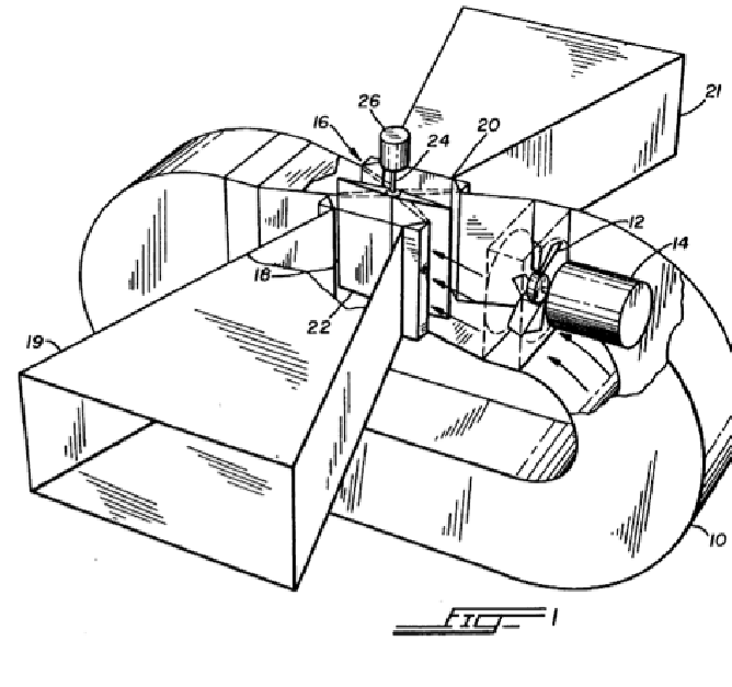

More Tom Danley quotes:
"I chose the speaker division although it was a hard choice, it turned out to be a wise choice because not that much later the first shuttle blew up setting back any more work for 5 years at least.
It turned out one of the companies strongest suits was taking on the exotic jobs other companies would refer to us.
One of those goofy jobs, was to build a sonic boom simulator for the NASA space plane.
What your looking at is 1/3 of the below 30Hz portion of the system.
These were a push pull valve assembly, in the system in the photo, one has 4, 5HP fans to move the air.
Like this;
http://www.google.com/patents?id=HLo...age&q=&f=false
The system, with it's other speakers, was set up two meters from the outside of an OLD house outside of Atlanta where the research took place.
The system, when we turned it over, could produce a sine wave + - 2 dB from 5KHz down to 3Hz, at a pressure of 132Db at two meters distance."

What kind of dimensions are we looking at with that device? Do you think one could prototype something like that with RC car motors and servos or are we talking about washing machine size motors?
Edit: Sorry, didn't read it closely enough. That looks reasonably easy to duplicate, have you tried it?
No, I have no desire or use for a huge machine that uses what sounds like 12 five horsepower fans to achieve 132 dB down to 3 Hz.
Washing machine motors are generally less than one horsepower (756 watts IIRC).
I'd guess the servo to control Tom's blower driven LF machine may be in the the 1 HP range, RC car servos are usually no more than a few watts.
Well, what I was thinking about was drawing up something that could achieve the same things a rotary can...only without the $20,000 price tag.
Maybe not 12 5hp motors, but something a little more reasonably sized.
That design looks like it could be implemented a little easier than the fan blade pitching system used in the rotary. I've been very keen on some of these designs where you're basically bringing the whole room up to some amount of positive pressure and then "shaking" it to produce notes.

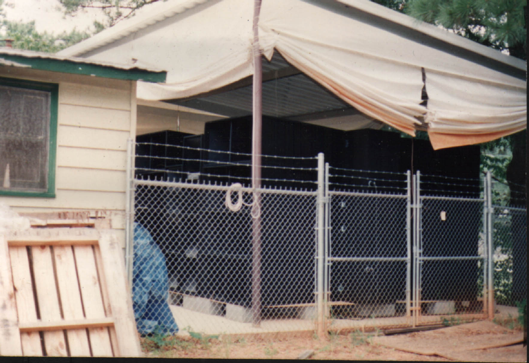

Hi Guys
Art is not pulling your leg and this is not a fish story.
The sonic boom simulator was set up outside of an old house for work studying the effects of the NASA space plane they were going to build. As this was a large craft, it would have a lower frequency sonic boom that fighter planes make.
http://pdf.aiaa.org/preview/1993/PV1993_4430.pdf
This system could produce 132-133dB at two meters on the wall of the house from 4KHz down to 3Hz and in use would produce an “N” shaped wave front which is the trademark of a sonic boom in general.
With such a large signature in time, the sonic boom had a distinct two part KAA BOOM, the pressure first rising rapidly and then a nearly straight line decay through zero to a negative value and then a recovery to zero.
This signal could make things fall off shelves inside and certainly startle people but the wall moving was in testing.
Consider for a moment why a concrete wall doesn’t pass sound well.
It has a huge acoustic impedance mismatch for one but sound can also make concrete or bricks fail. Sound is an alternating pressure but at a low frequency each pressure has time to act on a mass. That pressure causes acceleration which causes motion, which can cause tensile or compression failure. The lower the frequency is, the lower the SPL is required to move something heavy.
In the case of the wall, to be clear the entire wall didn’t move (although it shook the house) only the lowest mode was excited where the edges are clamped. I was deliberately teasing the house with sine waves and found the lowest mode to be around 4.5Hz. So, given the resonant frequency of the diaphragm mode and the size of the wall and that 132dB = + - 2lb per square foot of alternating pressure times the wall area, it really was possible to make the middle region of the wall and window on the old house move a frightening / impossible looking amount. To be sure, this was not good for the house either, I stopped teasing after this.
The best / most fun part though was standing against the house wall with the pickle button and experiencing a sonic boom over and over. After ten or twelve booms, it was breathtaking but also a relief to stop.
