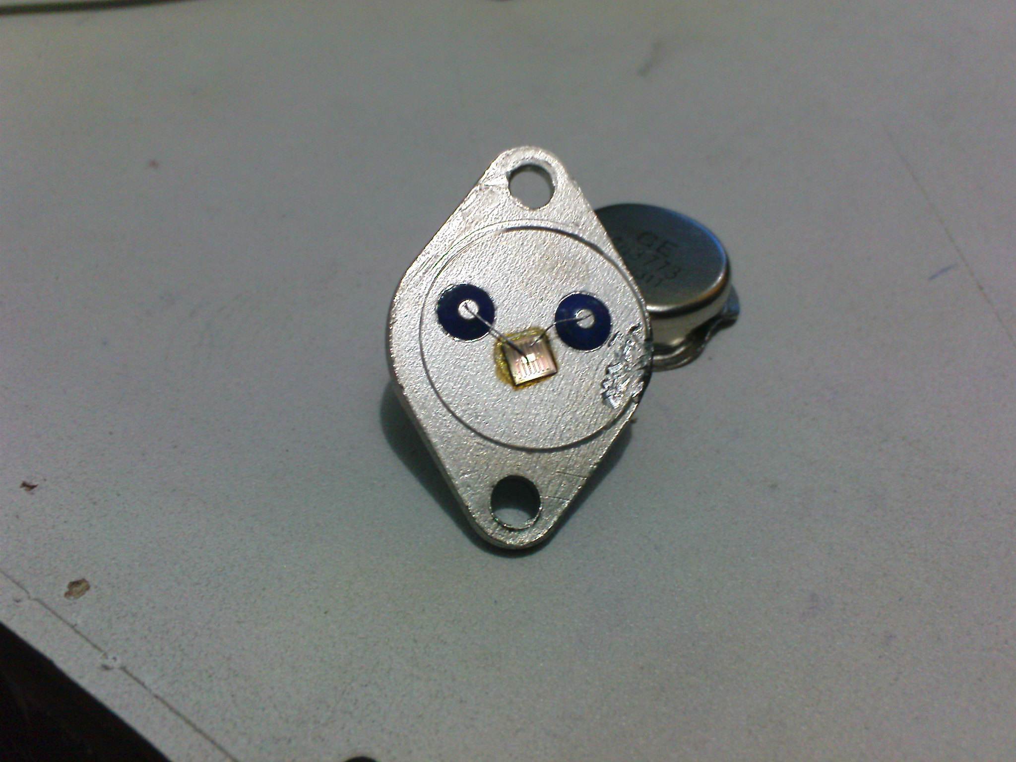

Fakes Toshiba 2N3773 photos ?
Only RCA i got is 2N3055, will test them both in last "quad 405 clone" ...
Also got me some old "JPS" 2N3773 and some "Toshiba" 2SD424 ...
All are NOS, never mounted, will see what brand - model will perform the best ...

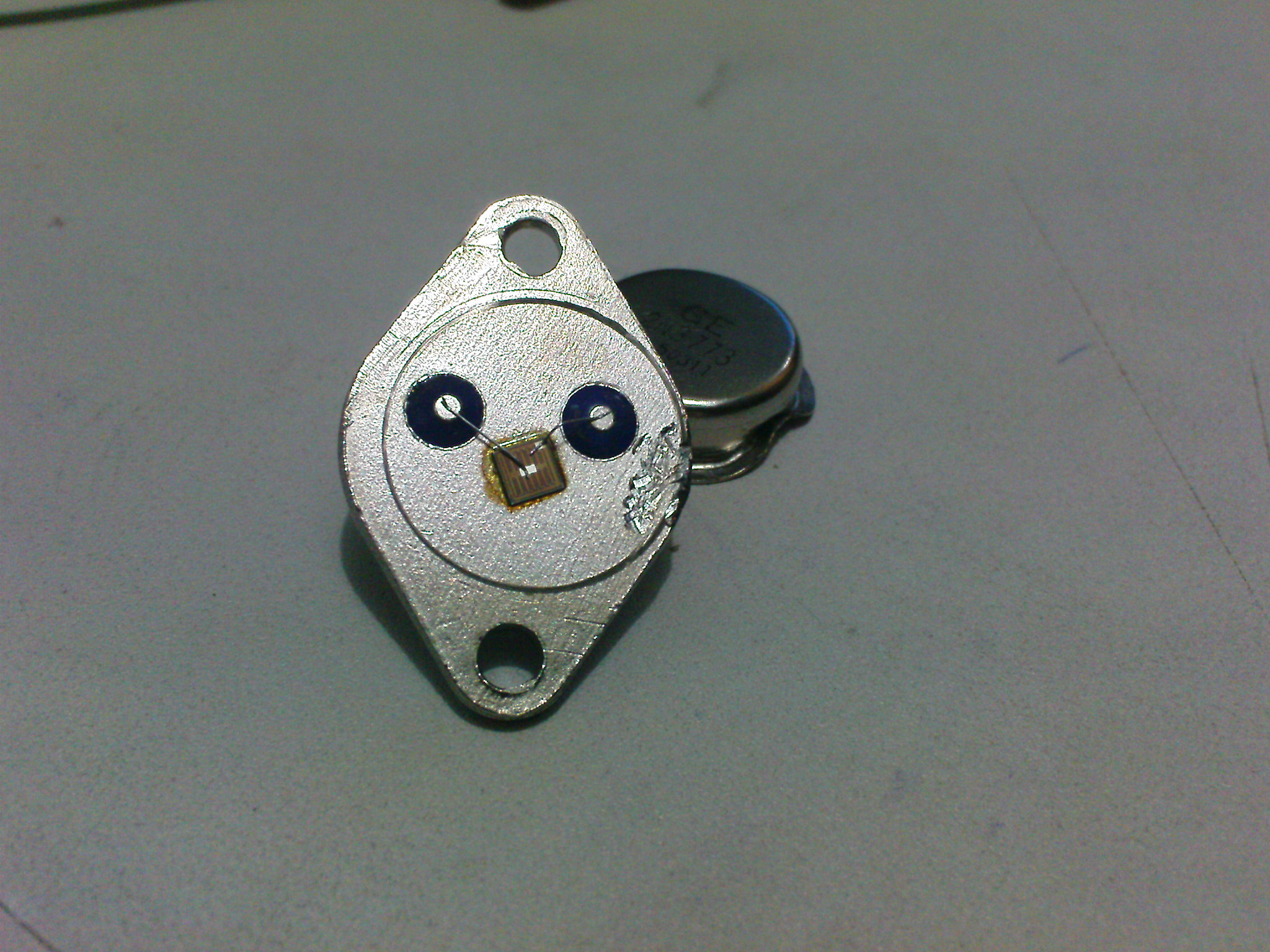

I got this set in in my pyle of parts for about 20 years ...
Dunno if Chinese guys make fakes back in time ... !

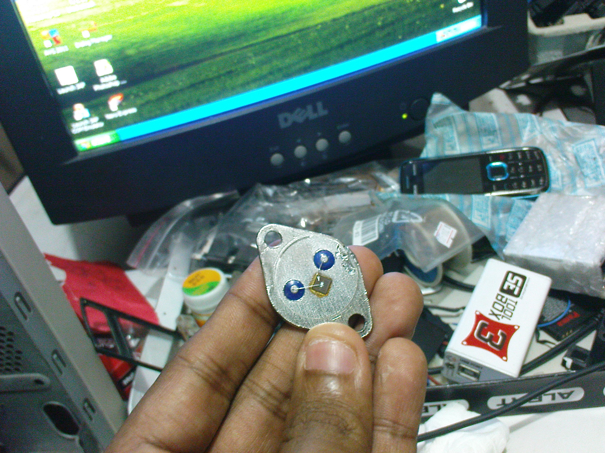

Seems like 100% real;😎 if it's 20 years old. still it holds the marking even after kept as pile🙄
The second puched circle with plug confirms the heat spread plat mounting. (making a punch hole and metal plug(rivet) requires more workmanship which counterfeits wont do happily😱
Vijay
Well, since these transistors are vintage and I doubt komigenie will use them in future (he kept them 20 years on the shelf!) so I suggest him to grab a hacksaw :mallet: and take off the cap so we can see what the heck is in there! 😀
Edit: correct me if I'm wrong, did Toshiba actually ever manufactured 2N3773? :scratch1:
Oh, I'm gonna heat'em up with soldering iron all right ...
