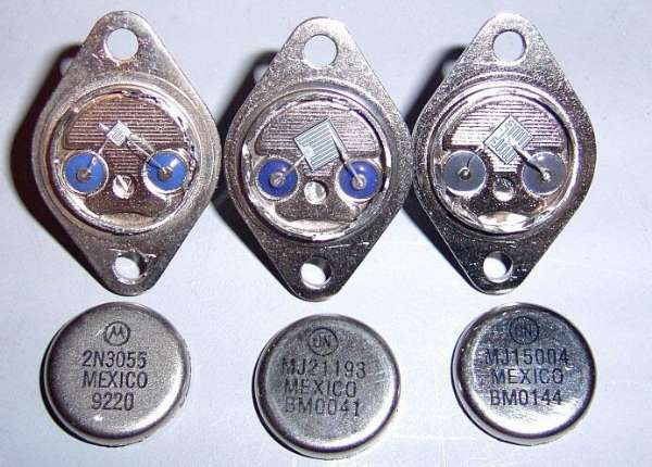

jacco vermeulen said:so what did you crack open ?
Isn't the 2N3055 chip a bit small ? lol

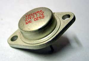

jacco vermeulen said:TAEC, since 1965.
Here's another number

burbeck said:hi
30 years old at least, Toshiba transistors
Now those are the real deal. I've aquired a few over the years and used them with no trouble. The real one are old (25-30 years is about right). Flip them over and you'll be able to tell easily. They should have the copper heat spreader coin that the D424 and other devices from that era did - and with the Jap units you can see from the bottom side where it's bonded in.

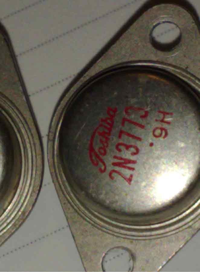

I got this set in in my pyle of parts for about 20 years ...
Dunno if Chinese guys make fakes back in time ... !
"Dunno if Chinese guys make fakes back in time ... ! "
I was getting fakes back then on 2SD555/SB600. I also got some Toshiba branded 2N3773 from the same distributor. Fake or not, they didn't hold up like a Motorola or RCA.
... Fake or not, they didn't hold up like a Motorola or RCA.
Only RCA i got is 2N3055, will test them both in last "quad 405 clone" ...
Also got me some old "JPS" 2N3773 and some "Toshiba" 2SD424 ...
All are NOS, never mounted, will see what brand - model will perform the best ...
And yes, got me some old 2n3055 marked wirh bold "Beta" - "β" ...
- Fakes Toshiba 2N3773 photos ?
