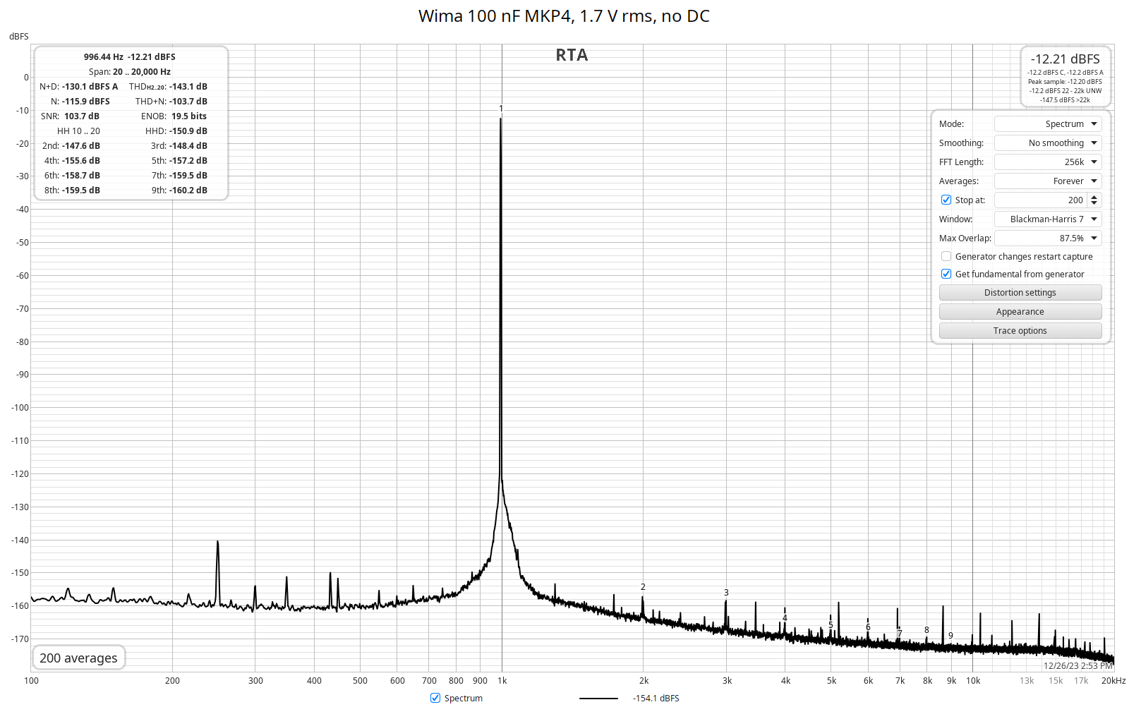

It takes a very sensitive test system to measure any film capacitor distortion, especially at what is far below the voltage rating
Spoke too soon. One probe clip was at the wrong position.
Here is a proper measurement. Still, difference to OP measurements is large.

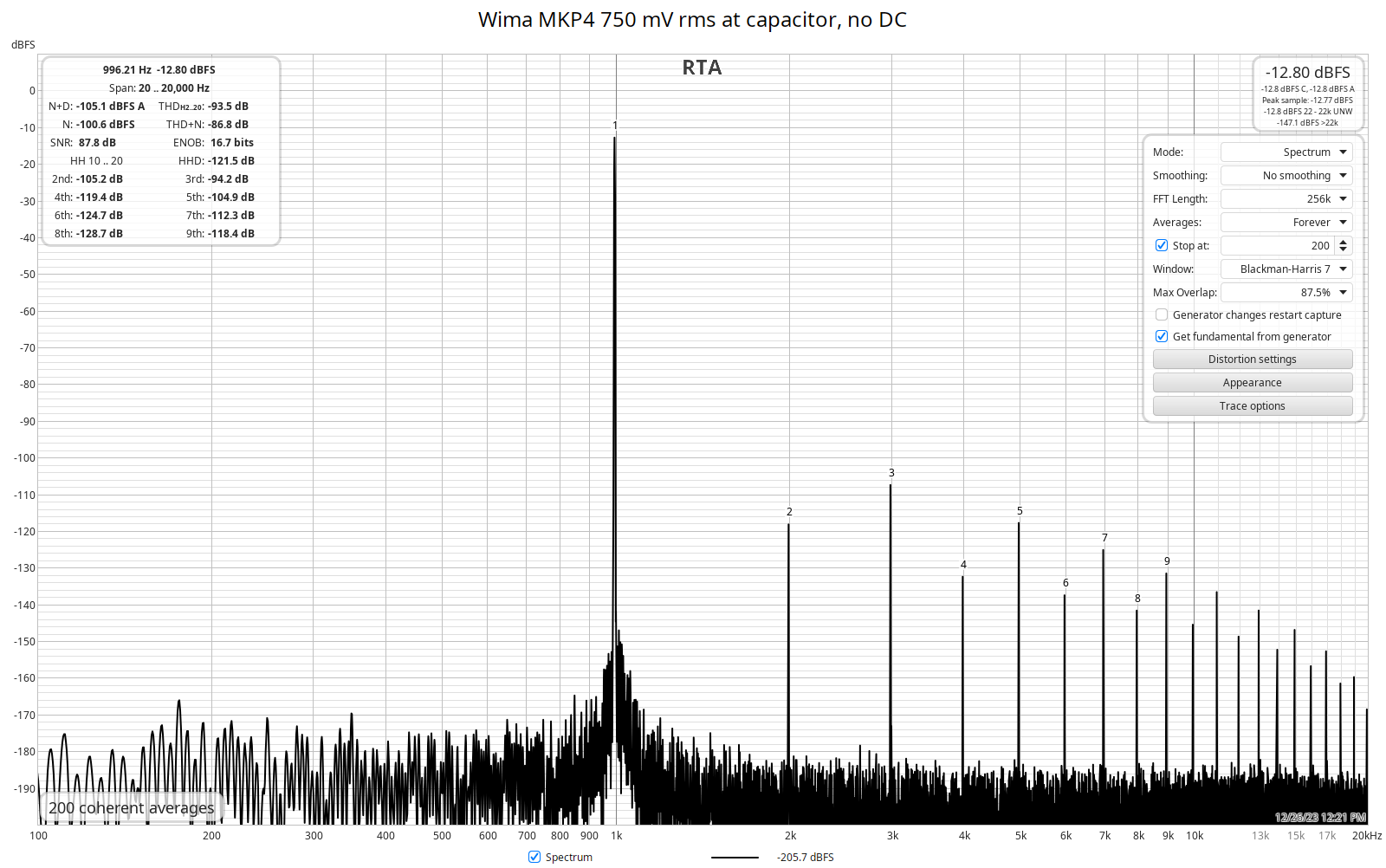

No, the 50Hz peak is well below the cap distortion - this is clearly some sort of MLCC inside the fake film cap body, and the residual shows little evidence of 50Hz or 150Hz. 100Hz peak is the tricky one as its the 5th harmonic of the test signal and 2nd harmonic of the mains...To me, all that harmonics in your measurement look like 50 Hz harmonics (despite low pass), not like a capacitor introduced distortion.
What was the voltage rating of the WIMA? Can you repeat the same test with a resistive divider? I am surprised the MKP should generate -94 dB 3rd harmonic. If this were true, I wouldn't know how we can have audio equipment with -120 db THD using MKP caps.Spoke too soon. One probe clip was at the wrong position.
Edit: what did you use for DAC, amp, ADC?
You wee right to be suspicious. So was I. 🙂
At first, result didn’t rise alarm as OP had similar distortion. But, measurement setup with resistor is, in principle, the same as was used by C. Bateman for his famous article about capacitor distortion.
I found that used signal generator was at the too low temperature and went to high distortion. It is EOSC10KV3 signal generator which has about -150 dBc at < 3 V output. Used ADC is Cosmos + active notch filter.
Repeated test has shown distortion at -130 to -150 dBc. I will make an update after lunch.
