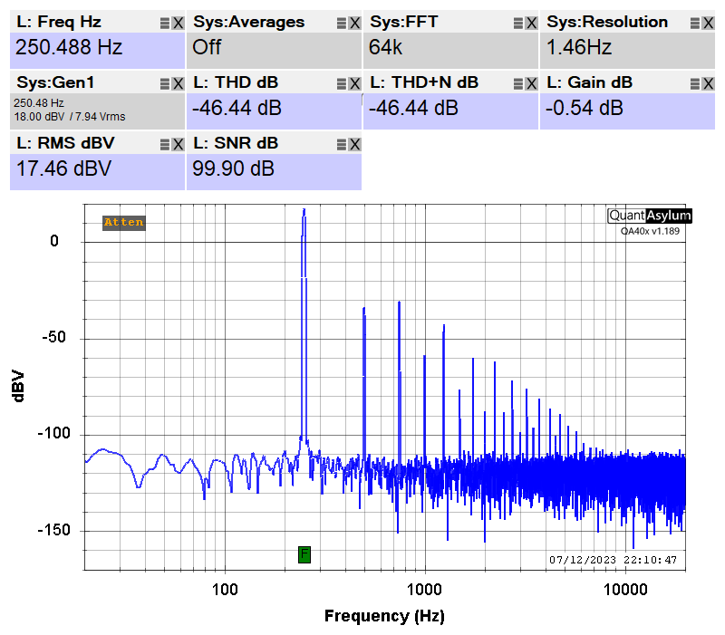

Having recently acquired a QA403 audio analyzer I looked at the linearity of some film caps I have, all ostensibly PP 100nF. I found 3 kinds of distortion profile among them, making me wonder if these are routinely being faked with cheaper dielectrics. The test setup was a divider, 100nF cap on top, 6k8 metal film resistor on bottom. This has a high pass response with -3dB point around 250Hz.
The responses I see from the three types of cap are:
Clearly cap1 is a high-k ceramic cap with high amounts of distortion evident. caps 2 and 3 are clearly different dielectrics, or very different film thicknesses (unlikely as these are all 100V rated). Only cap3 type seems to actually be PP with its very low distortion.
Here are the 3 tested samples, cap1 at top (its poor printing registration is further evidence for this being a counterfeit part):
Since these are all from my 100nF bin I don't have records of where each came from, alas, but its quite possible some are eBay, which would account for the rogues - so now I'm faced with the task of testing all my film caps...

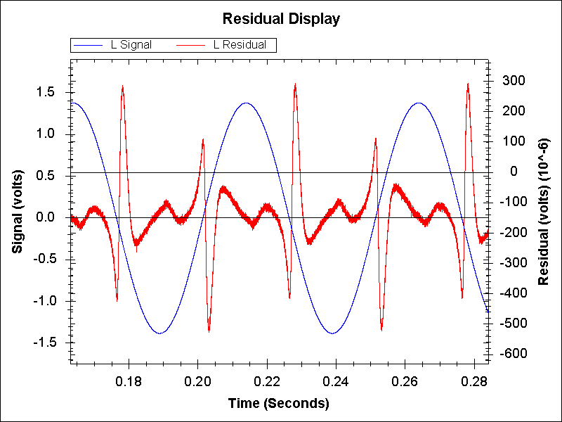

Interestingly I looked at the residual for cap1, and its very similar to cross-over distortion, which accounts for the large numbers of harmonics generated.
Compare for instance to some of the plots in https://sound-au.com/articles/crossover-distortion.htm - clearly most of the distortion is to do with the point at which the electric field reverses, not some sort of smooth but non-linear response curve, though that's no doubt also present. This is more dramatic that some of the articles about ceramic cap hysteresis tend to suggest
Here's the harmonics for a 250Hz tone for instance:
That is very strange, because the high dielectric constant MLCCs show high levels of 3rd harmonic as the capacitance plunges at higher voltages. At low voltages, they are reasonably linear and there is no obvious crossover mechanism. Is your waveform shifted 90 degrees by the current and voltage on a capacitor?Interestingly I looked at the residual for cap1, and its very similar to cross-over distortion, which accounts for the large numbers of harmonics generated.

I would expect the dC/dV Variation being max at low voltage. Explaining most non-linearity around zero crossing.

Ah, that would make sense - I suspect there's a complex mix of different grain sizes in the dielectric leading to similarly complex behaviour.I would expect the dC/dV Variation being max at low voltage. Explaining most non-linearity around zero crossing.
I used low frequency stimulus to ensure the relative phasing of input and output was close - not entirely sure of the latency of the QA403, but with a 20Hz signal and 192kSPS I'm confident the phase error is pretty small between waveform and residual.

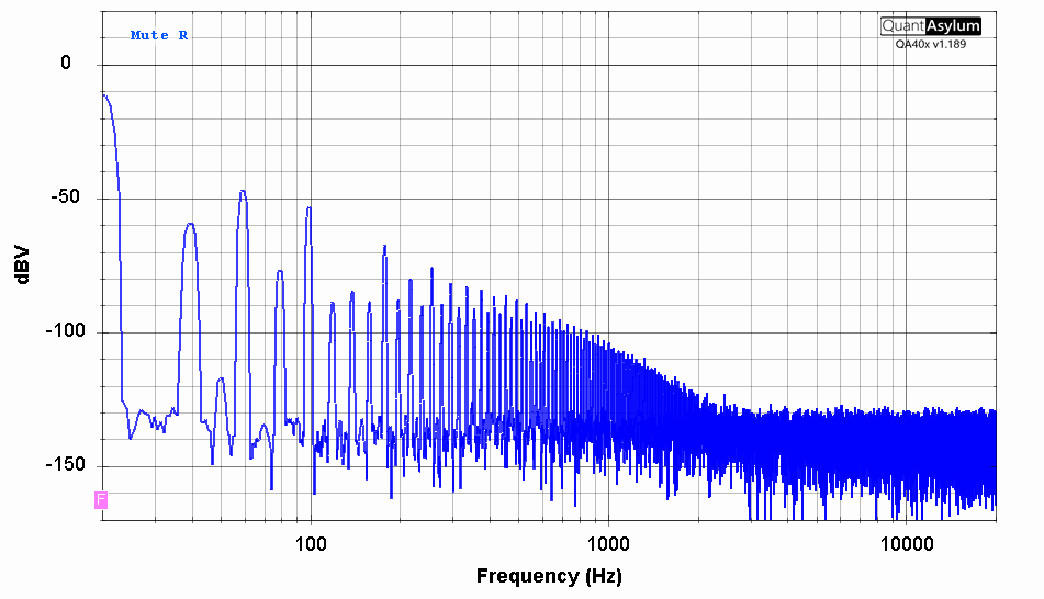

The previous measurements were with the divider being RC, however using an CR divider the residual is more complex, presumably as the signal across the capacitor is smaller and within the worst performing region:
and the harmonics more notable (as the circuit isn't low-pass filtering them):

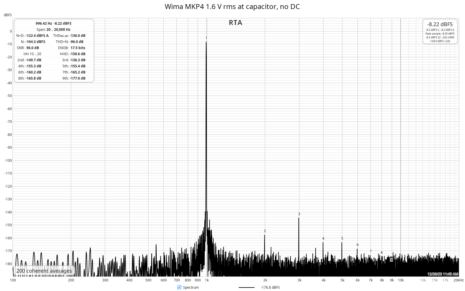

Shockingly high distortion. I got worried.
Here is what I get with 100 nF Wima MKP4 + 6K8. Introduced distortion is only H3 and rest is signal generator + ADC residual distortion. Increasing AC voltage results with rising H3.
To me, all that harmonics in your measurement look like 50 Hz harmonics (despite low pass), not like a capacitor introduced distortion.
