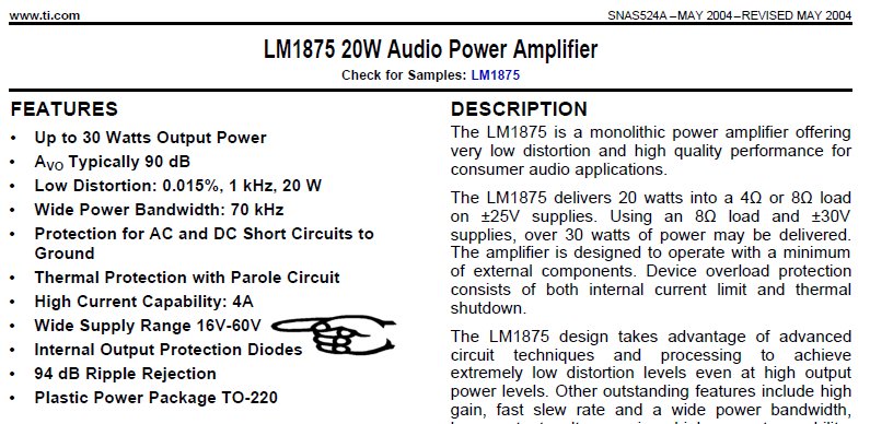

I'm just curious from which local dealer you bought from, usually I am quite skeptic of most of them here in Finland (Partco, Bebek, Starelec etc etc..) they may be ok for hobbyist level stuff as long as one is aware these shops don't necessary adhere to strict quality standards, one have to ask them strictly if they can assure the origin of the part, some semiconductor parts may not necessary be relabeled but counterfeits meaning they may or may not work quite similarly to original brands, and as jmfahey mentioned some components may be rejects etc..
There's no mention of heatsinking in this thread nor do I see any picture of one, I hope you have it mounted onto one.
And btw 60V is a bit much for a chip that can't handle more than 20W.

1) even buying locally instead of straight from AliExpress does NOT guarantee you got a real 1875 🙁 because you don't know where HE got them from.
He may be a good faith buyer or seller but HIS supplier may deal in rotten goods.
Unless he bought straight from TI or Mouser ... no guarantees.
I was burnt by TDA2050 bought from a local "respected seller", go figure.
They are visually perfect.
How do I know they are fake? (or substandard/factory rejects/whatever)
Because they burn with supposedly acceptable supplies.
Same as yours.
2) voltage is not the only parameter.
You are trying to replace one "60V" with another "60V" one?
Ok, BUT:
besides it being fake or not, original Philips uses two TO220 packages while now you use only one.
Dissipation can not be the same.
Now LM3886 case is exactly two TO220 side by side.
I can trust that
About current:
1875 can supply 4 A peak ... period.
Original Darlingtons can supply 8A continuously and 12A short term
Again 1875 falls WAY short compared to what originals can
Check 3886 datasheet, it must supply at least 6 to 8 A
Meaning: LM1875 is marginal at best, if not straight incapable, sorry, go for it's big brother 3886
3) and not sure about your AD5060 woofer, there is /W4 and /W8 versions
If it's W4 LM1875 will explode trying to drive it.
Even 3886 will be just enough.
4) can't you try to repair original woofer amp board?
It might be the safest way.
Oh, and you posted the mid/high section schematic; woofer must be different ... specially because it incorporates motional feedback.

@Rampo
Yes, I already saw that 60V max, that's valid only for genuine parts bought from a reliable source such as Mouser, DigiKey etc.
Now your turn, how about reciprocate a bit and answer peoples questions, thanks.
ps. I made a mistake in previous post, power rating should be 30W.

Even better, amplifier can only deliver what comes from the power supply.does not realize power from the amplifier is controlled by the voltage input.
That 57 V supply allows maximum 49 Vpp (Darlingtons have around 4 Vce loss each) so maximum possible V RMS out into speaker is 17 so some 36 W RMS.
Perfectly possible for two TO220 Darlingtons or an LM3886; way too much for an LM1875, even if original
I would try again to repair original amp.
It is not a problem of "wrong Darlingtons" per se, in fact I would use higher rated TIP142/147 if they fit the heatsink (TO218/247 case instead of TO220)
Distortion heard may come from having other bad components or lack of biasing but in principle that amp should be quite repairable.
Darlington problem is in it's inside resistors values, impossible to find totally suitable equivalent types.
