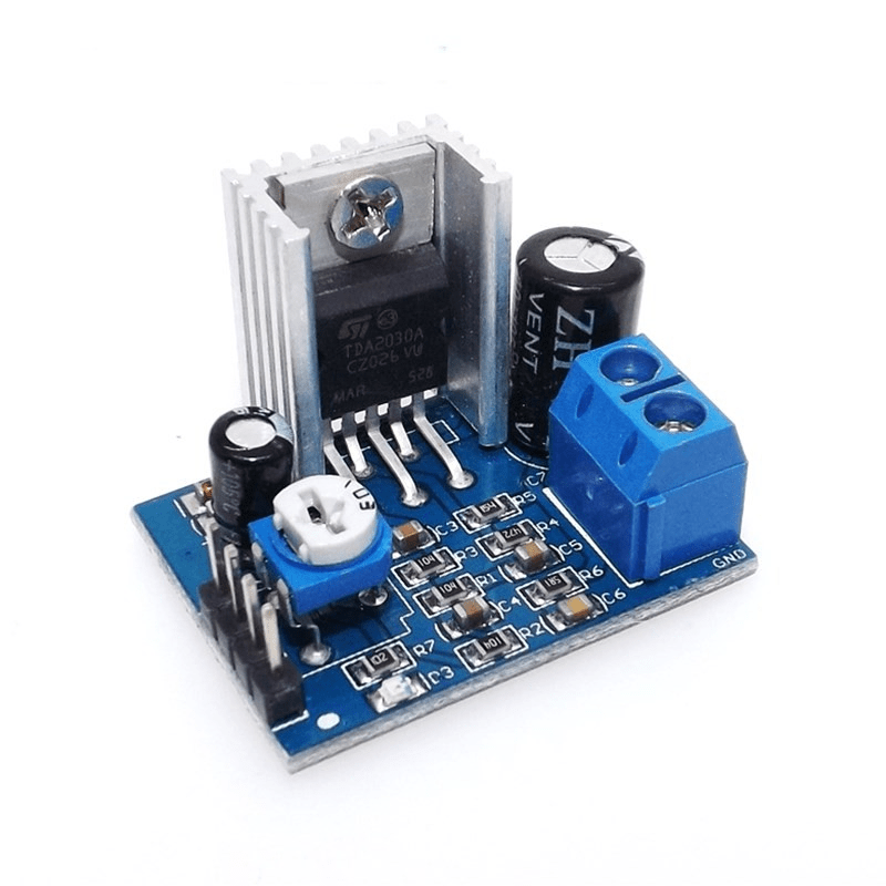

I bought Chinese LM1875/TDA2050 with 3 different labels, inside they are the same rectangular chip. It is unity gain stable, temperature protection 85°C but no short circuit or current limiter. It has more bass than LM3886 or TDA7294 using the same supply +/-27v max. It has higher drop out than 2050 but lower than the LM1875. The sound has a particular high frequency grain that many Asians, Russians and those who appreciate fine female voices love such sound as it make the voice, golden. It seams, they TDA2050 with a triangular shape logo has high OLG rendering slightly drier bass and more pronounced high frequencies for extra cost.
What I don't understand, why the OP doesn't buy a TDA7294 amplifier board for $4 as,
https://aliexpress.com/item/1005005753876111.html

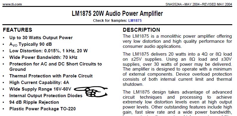

Look at the data sheet for safe voltage ratings, stay within typical rather than max. ratings...+/- 25V for 1875.
I would play safe and go about +/- 20V, that would still give a decent power output.
If you go higher, you will go near the danger zone, close to the limits of the device.
And way too loud for most users.
Wrong way, I speak using single power supply. Data books say; max is 60 Volts.
The spec sheet for 1875 says typical +/- 25V, or 50V single supply.
That is the real world practical value to be used in working designs, the higher value is the never exceed value, as a limit if something like a high voltage spike happens.
So you are taking the part to above the practical limits.
And then you are complaining it burns!

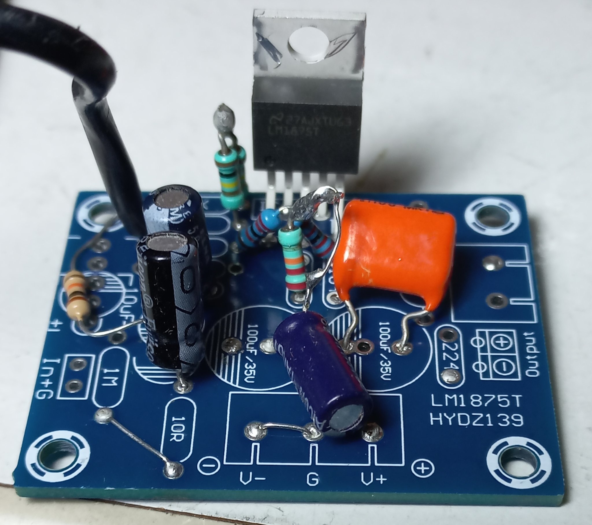

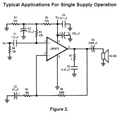

But why are you stuck on 1875?
Because:
I try to put LM1875 instead
to philips MFB_ Speaker_22rh532 to drive middle and high speaker, system works with single supply 57 volts.
I dont put more power supplys into active speaker box. In stuck I am, because hard to find working audio amplifier, which last 60 Volts.

I have an observation. If irrelevant, just ignore it. The 1875 singleton outputs a vicious surge through the speaker when power is applied. I think there is a race condition on the input pins which can be mitigated by increasing C3 to about 200uf. Otherwise, feed the speaker through a resistor which has a bypass switch. Procedure: open the switch for a few seconds while power is applied. The speaker cap will be partially charged when the switch is closed. This will reduce or eliminate the thump.

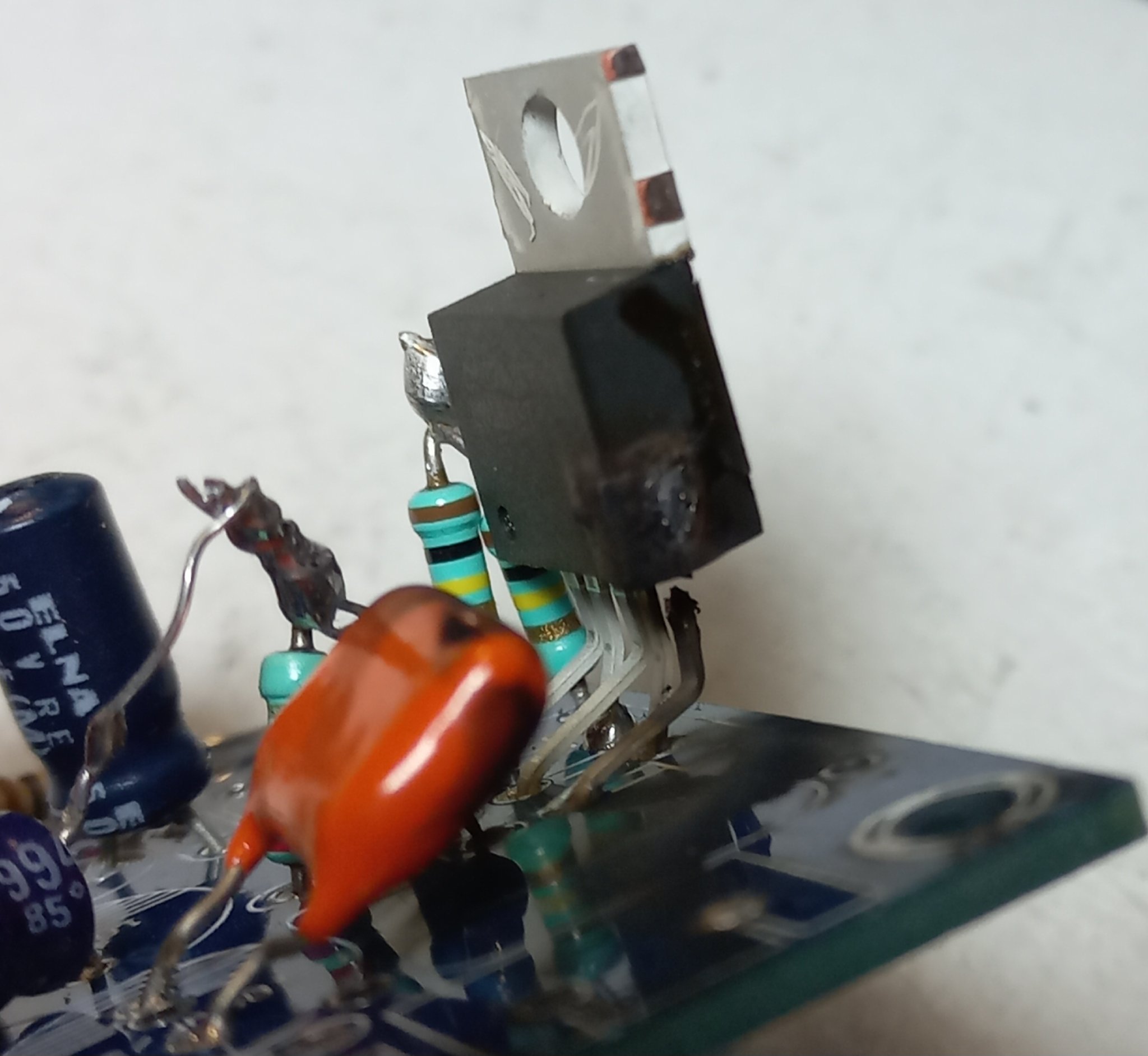

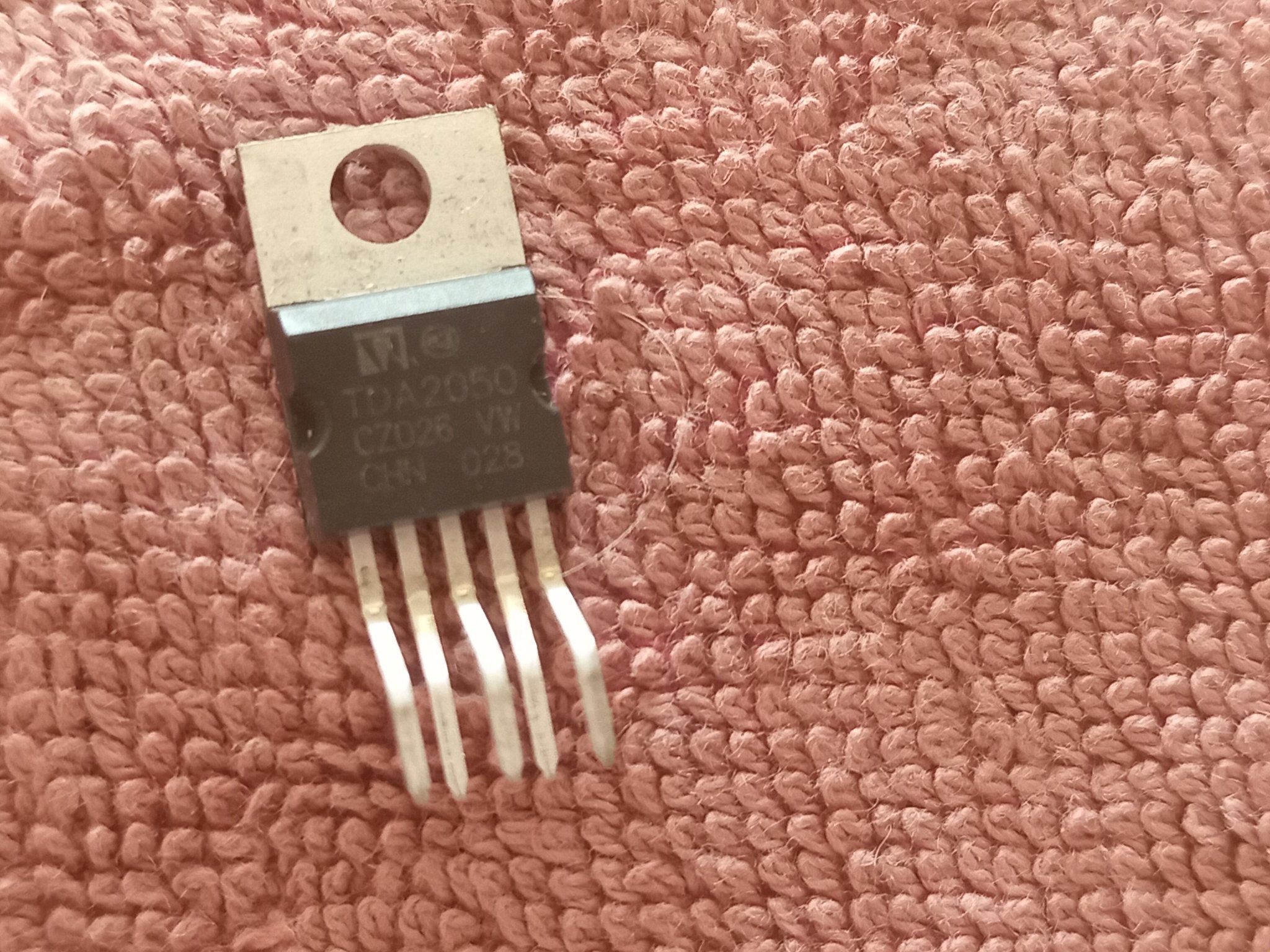

1) even buying locally instead of straight from AliExpress does NOT guarantee you got a real 1875 🙁 because you don't know where HE got them from.
He may be a good faith buyer or seller but HIS supplier may deal in rotten goods.
Unless he bought straight from TI or Mouser ... no guarantees.
I was burnt by TDA2050 bought from a local "respected seller", go figure.
They are visually perfect.
How do I know they are fake? (or substandard/factory rejects/whatever)
Because they burn with supposedly acceptable supplies.
Same as yours.

Rampo,
That lm1875 chip looks real to me,
I have a feeling that you made a mistake when you modified that board to work with a single voltage power supply.
Instead of using that board just try to wire connect the components according to the TEXAS Instruments datasheet
