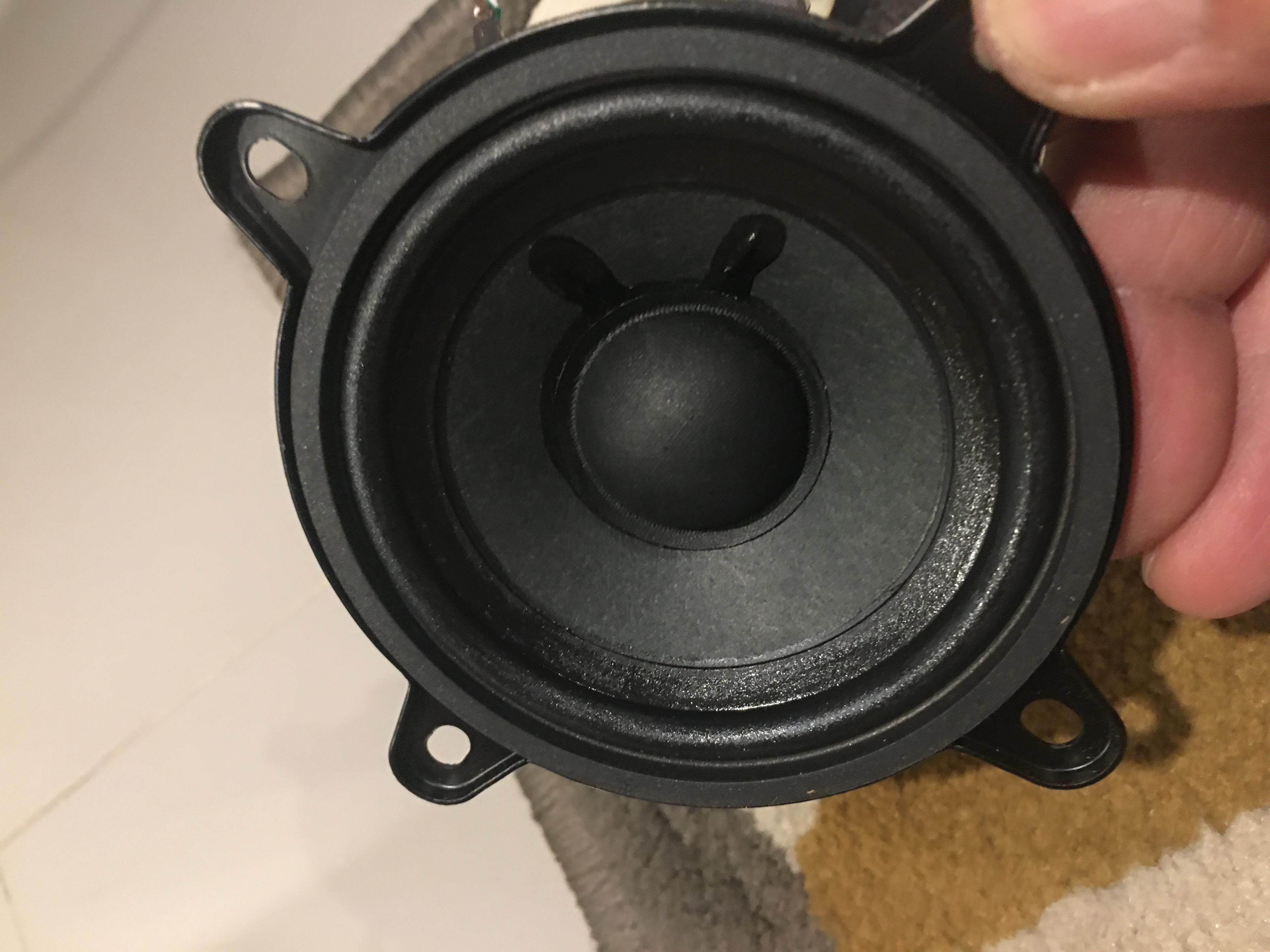

I damped the surround as per Troels way. Off course the secret is the compound.
Not sure if you can get it. Im into ship interior design & construction. It is a water base latex
compound that we use for flooring work. If you've got friends in shipbuilding I'll be glad to tell you what to ask for. It's white & milky when applied it's blueish but dry transparent.
Surprisingly effective.

The reason is be cause this compound comes in gallon packaging only Oon
All that's needed in so so little to paint the surrounds.
Btw how can I post music clip here. I can record some & you guys be the judge.
Not clear to me if such coumpunds full the nasty notch or if it works like a pass band notch itself ???
Yes I have a pair of Audax 130zo aerogel drivers Diyiggy.
Will find how to attach some musics clips. For sure the shout/peak
is gone with no listening fatigue. Will continue to test some damping on the cone & dust cap but have to find a way to be reversible.

Makes me think about what Planet10 is using himelf but can be found in tools stores or internet, it's in the thread.
For me it's just a flash idea as I got a huge bottle at home & knowing its properties I thought that I should give it a try & surprise surprise Lol

Too bad you don't measure your drivers before and after...
In the SS 10F/84 : its a wooven poly material with a very thin very aero coatings , I ask myself if someone even tried to tame what's above 1.5 k hz with such coatings ?
