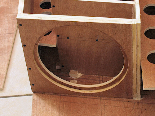

the driver doesn't take up the full space of the basic loft I created, it is made from the driver's rim diameter to the magnet diameter & depth

You don't want to start recessing the drivers into the baffle. Make S3 bigger instead.

Recessing is not bad if it's planned for in the design. It definitely helps to center the driver over the hole if a bit of recess is accounted for in the design of the baffle. As even a minor leak at this point will greatly reduce LF output, recessing the driver a bit can minimize if not eliminate the possibility of this happening. For my POC3 I just bonded two 1/2" ply panels together to form the baffle, and made the cutout in one slightly bigger than the other to allow the driver to be recessed. It worked out very well.
