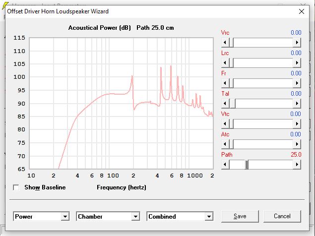

A question, why I ended up with a 43Hz tuning instead of 63Hz as calculated?
Line not filled but lined with 1" thick noise reduction felt

Wonderful idea! Nevertheless, even if it is somewhat flawed, it can be a platform to learn why the slipped tuning, to avoid the error in another project, perhaps with a more fitting driver.
None, just rules of tumb. High QT: tune 10 Hz lower than Fs, Offset 1/5 the lenght, reasonable total volume, reasonable line c/s, and so on.
Fortunately the 6FE100 can eat gobs of watts w/o bottoming.
I see, I should have kept the tuning at Fs and the aperture somewhat larger. Thanks for the sim.
I'll try to reverse engineering the object allready built using SpicyTL, and see what comes out, even if It will take a while until I learn ho to correctly use that software.

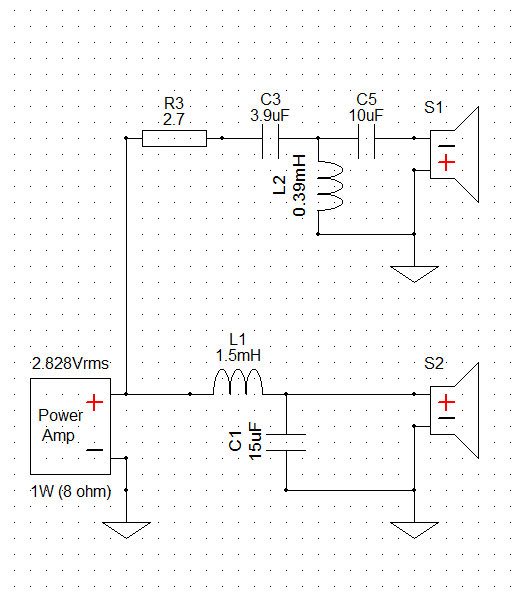

Can I see the schematic of the crossover?
A bit late to the thread, but since it hasn't been mentioned, your TL tuned lower than its length suggests because it tapers down and has a restricted terminus. The opposite holds; an expanding line will tune higher than the linear QW frequency, unless its terminus is restricted.

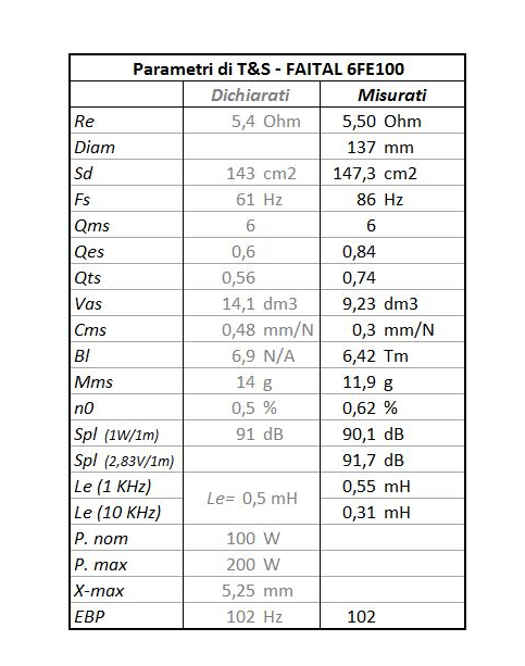

I'm not alone then, to have measured the 6FE100 with differing parameters versus the spec sheet. Here's one of my pair below, the other being similar enough.
Thiele-Small parameters
fs 90.3 Hz
Qms 8.039
Qes 1.000
Qts 0.889
Fts 101.5
Mms 12.92 g
Cms 0.241 mm/N
Rms 0.911 kg/s
Vas 6.98 litres
Bl 6.329 Tm
Eta 0.50 %
Lp (1W/1m) 89.15 dB
Dd 13.49 cm
Sd 142.9 cm^2
Cms is half what the spec sheet states (0.48 mm/N). You are right in saying they can take a lot of power though. 🙂

Hi, I'm using them: Dell laptop Topping DX3 DAC Proton AM2 amp, with a moderate eq down the 150Hz zone exces. I use measured specs, not the factory advertised, see attachment.A bit late to the thread, but since it hasn't been mentioned, your TL tuned lower than its length suggests because it tapers down and has a restricted terminus. The opposite holds; an expanding line will tune higher than the linear QW frequency, unless its terminus is restricted.

sure thing: Just R3 is after C3 in the actual buildCan I see the schematic of the crossover?
Yes, tapered TL tuning is lower than based on length alone, but is the tapered TL is best for nice tight bass. You can adjust stuffing to bring peaks down and this will reduce group delay. Too much and it sounds dead. The impedance sweep is the way to check though. 45Hz is a nice spot if you can deal with the baffle step loss. You will have to drop system efficiency quite a bit to match the treble with the bass.

I know, but I do prefer to preserve the 90 /88 dB level and eq down the 150 Hz excess via signal modification. Any other eq is embedded in the filter, that deviates from the textbook Butterworth 2nd and 3th order for this very reason.Yes, tapered TL tuning is lower than based on length alone, but is the tapered TL is best for nice tight bass. You can adjust stuffing to bring peaks down and this will reduce group delay. Too much and it sounds dead. The impedance sweep is the way to check though. 45Hz is a nice spot if you can deal with the baffle step loss. You will have to drop system efficiency quite a bit to match the treble with the bass.
