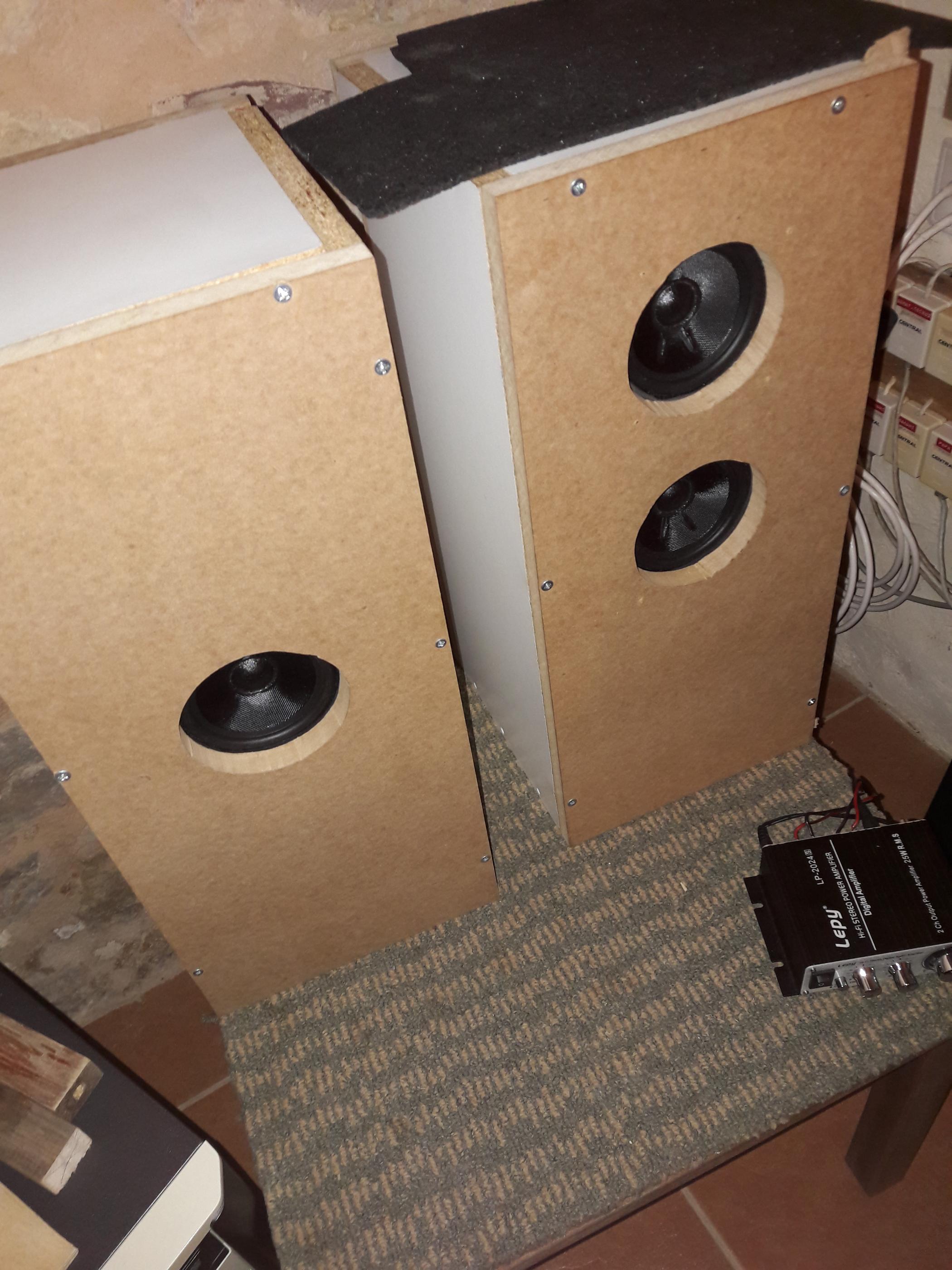

I have 4 of them.
I made one pair in 7 ro 8 lit box with no filter they are very good but need more bass. Need large enclosure but still the low frequencies are poor.
So I am looking for a mid-low or a low woofer (10 inch) to to put them together and make a 2 way simple system.

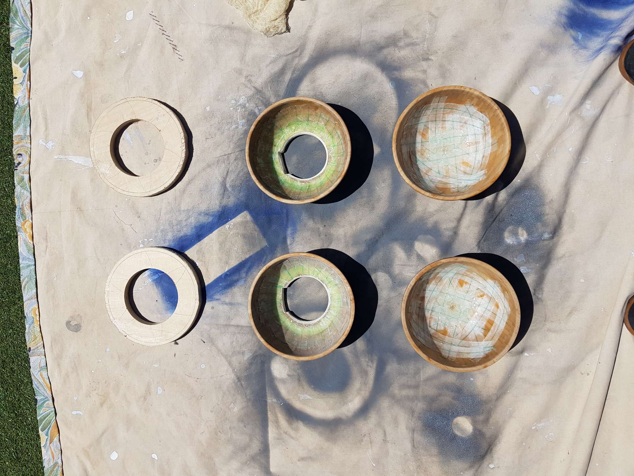

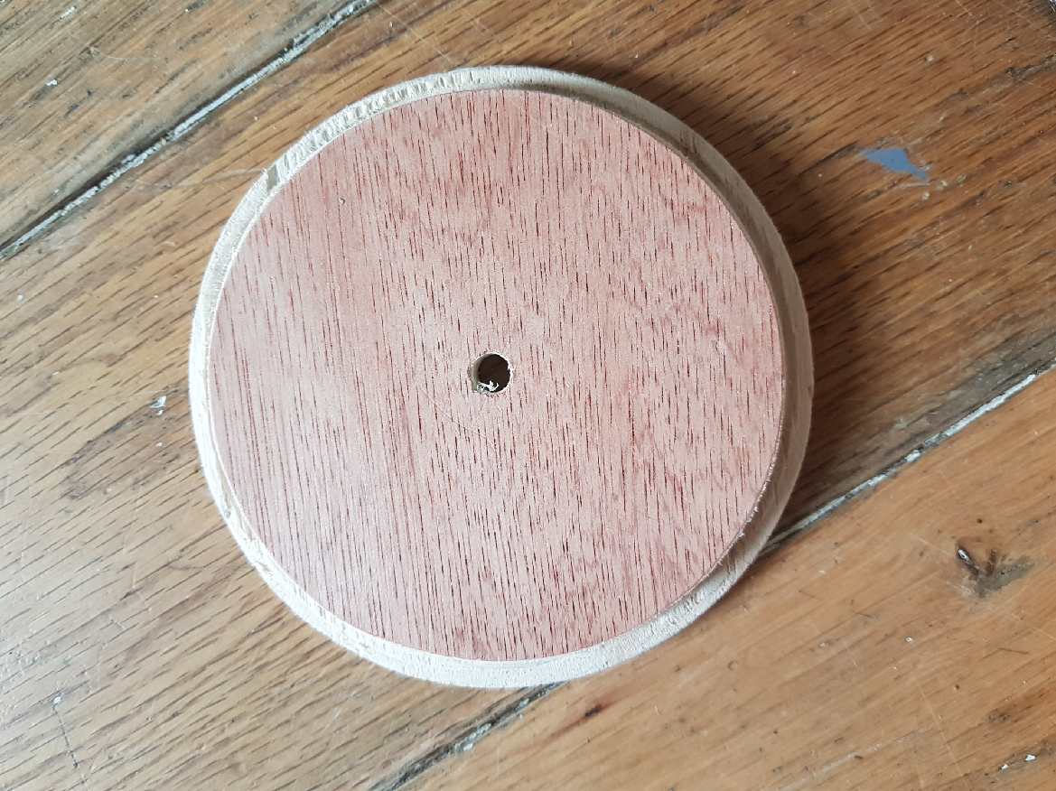

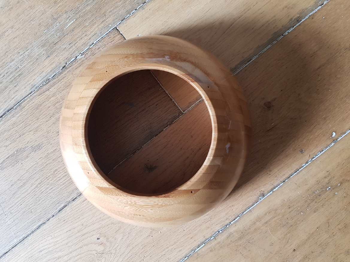

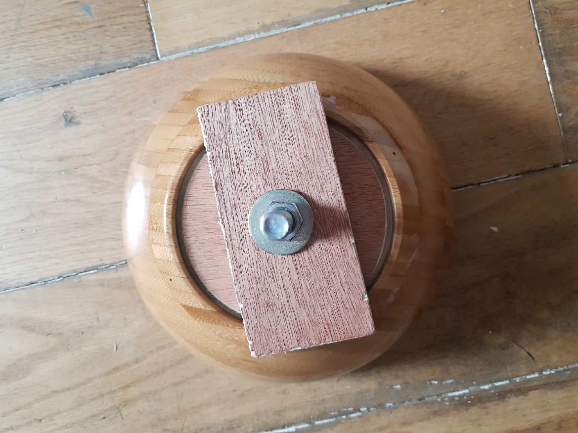

I have some photographs of the building process at different stages.
1. Cutting 105mm hole.
2. Cutting baffle insert using 105mm and 115mm hole saw.
3. Clamping baffle while gluing with epoxy putty "Milliput"
4. Reverse of baffle showing putty.

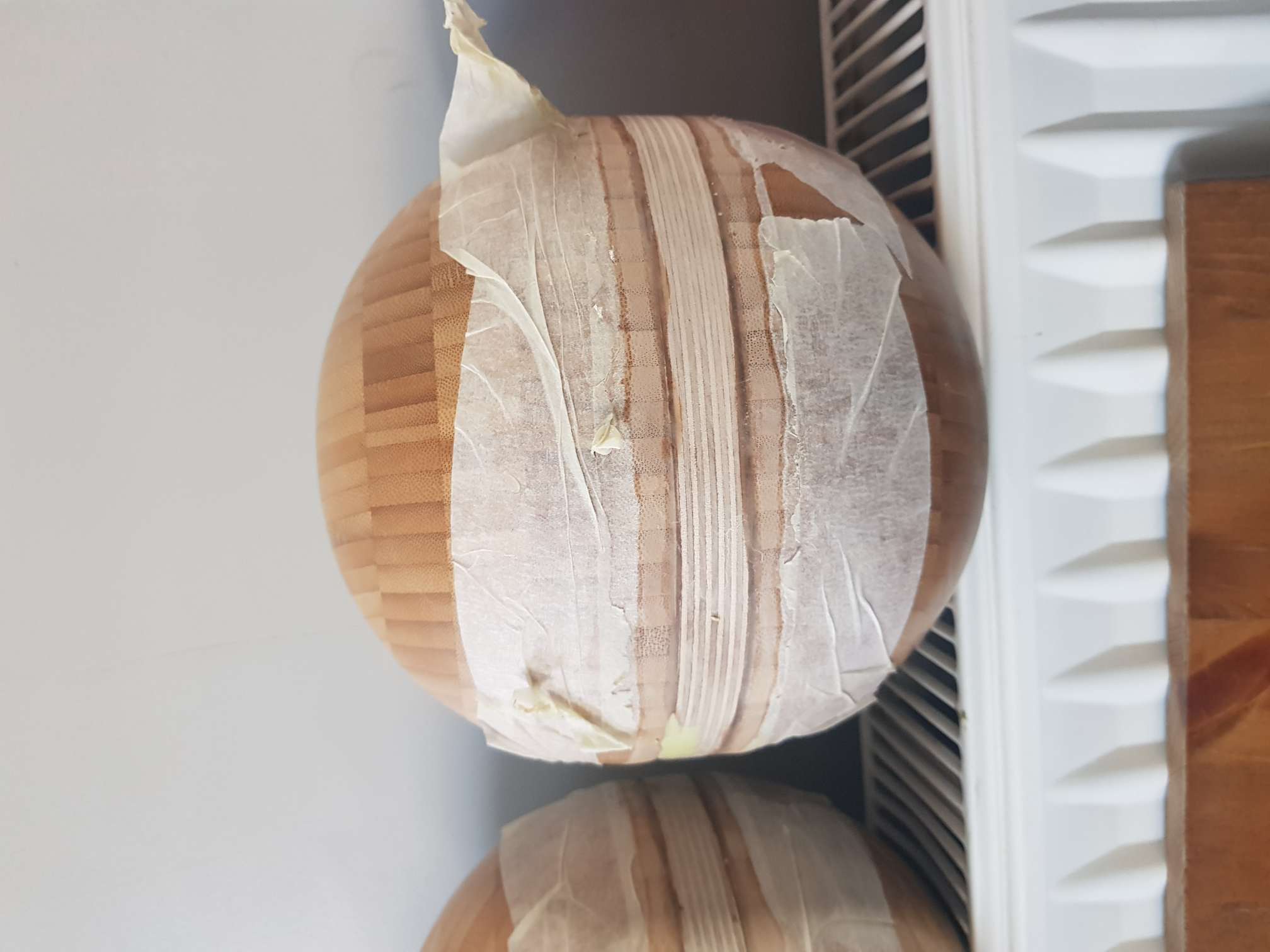

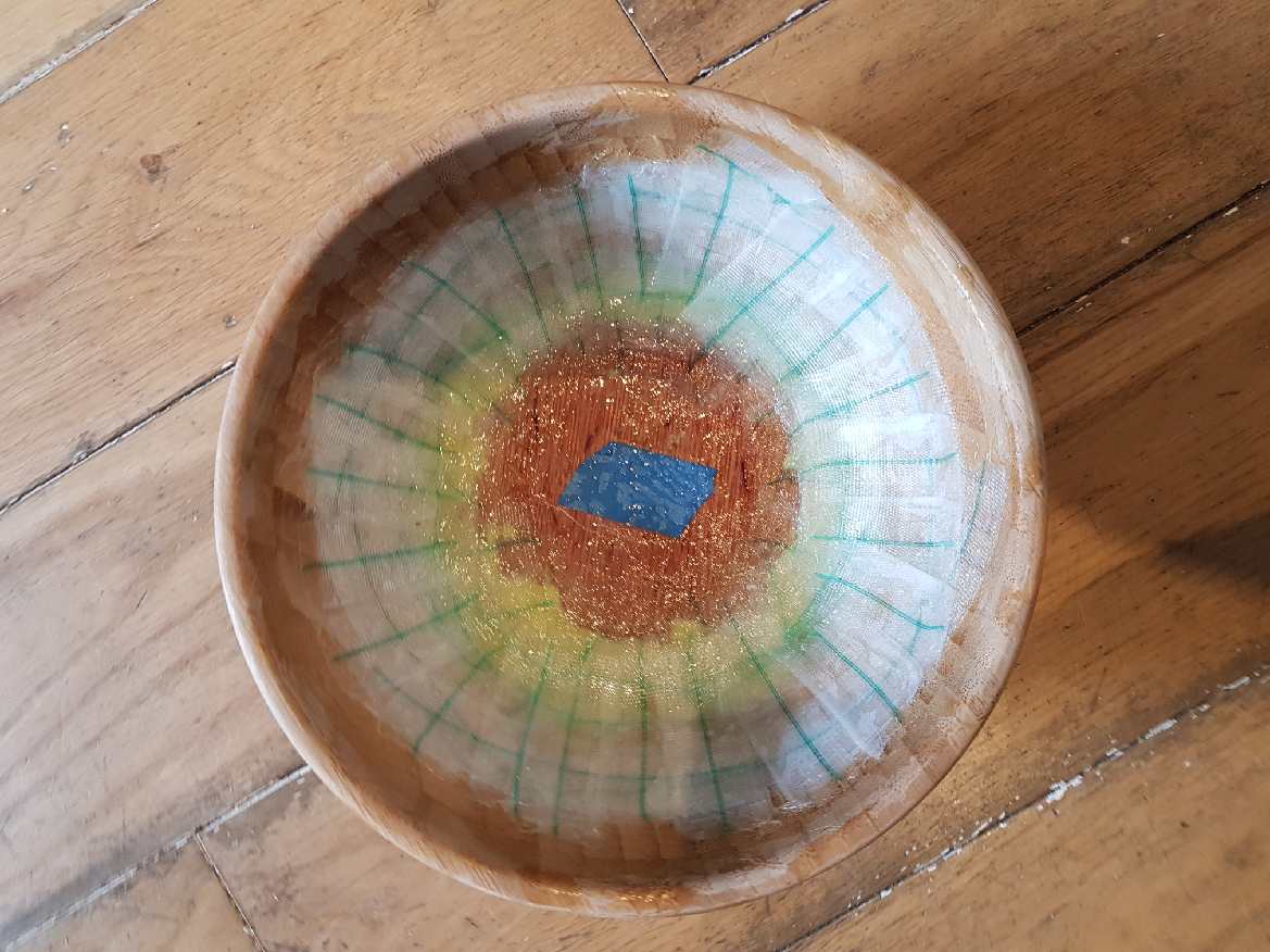

5. Adding woven glass tape and epoxy resin reinforcement.
6. Laying out all the parts, front bowl, middle ring of Birch ply, and back bowl.
7. Glued and assembled, sanding and finishing the joints. This is where I decide I might have to paint at least *some* of the outside (to hide the mistakes I made).

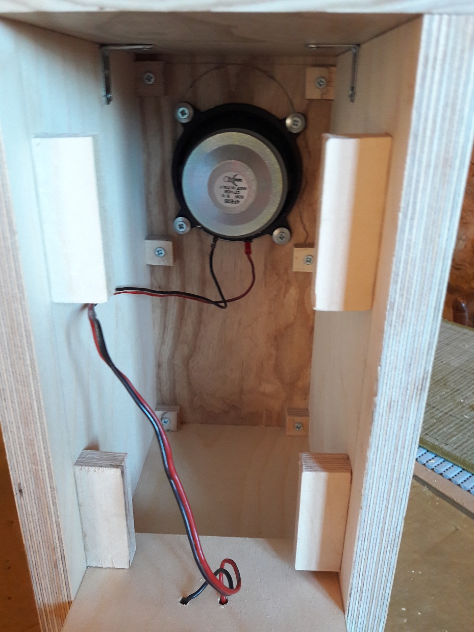

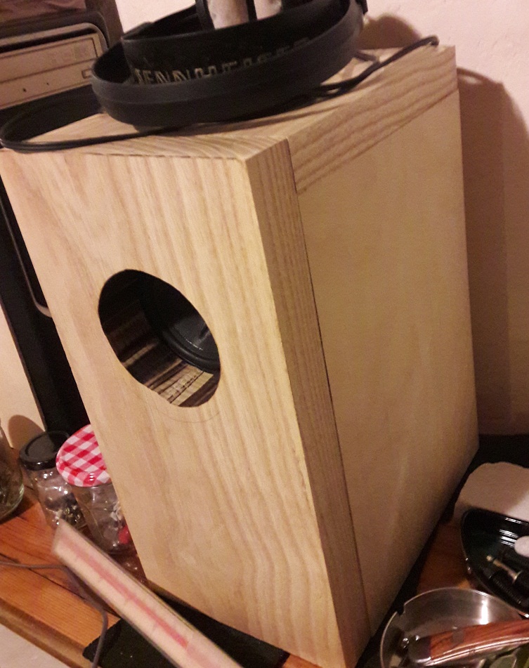

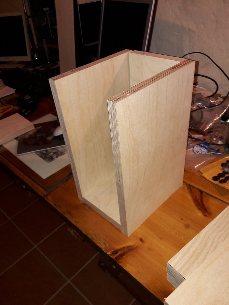

1. I was testing in separately 2 in one box and one in one box. and I finaly decided to use one in one boxe see next picture
2 to 3. sealed enclosure
I dont have many tools so I had to cut the round hole for the driver manualy with a wood cuting machine
I still have one pair and want to use them with a woofer. (can also combine 2 of them and a woofer!)
Thanks VHA, very kind of you.
The Blanda bowls look less perfect than the photograph!
I have a few tools but little space to build - most of the wood work was done in the garden, in between rain (UK weather!)
Mostly I have used a jigsaw/sabre saw to cut driver holes.
This time I was lucky and found an easier way, for those with few tools.
Hole saws. I used 105mm for the driver cutout, then 114mm and 105mm for the baffle insert.
The rest of the work was a lot of epoxy to glue the halves together and seal/fill any small voids in the joint.
And a lot of sanding!
After working with this bamboo ply or laminate, I prefer working with Birch Plywood. It looks nicer too!
