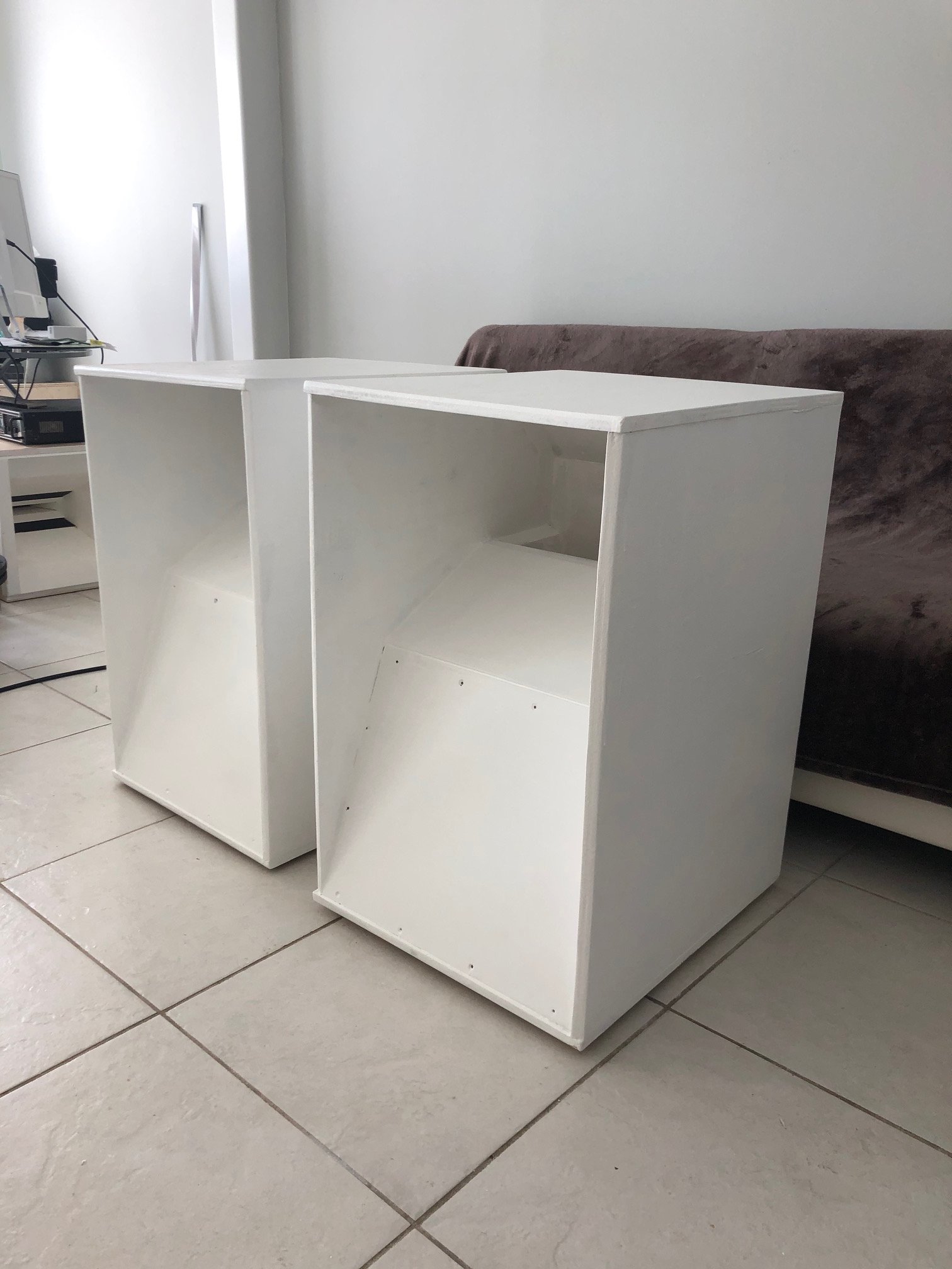

I wanted to build bass towers and got my self eight B&C 15NW76 Qts 0.21. Before build the towers I A/B tested 15NW76 with 18Sound 15W700 Qts 0.3. Same box, same 40 Hz tuning. Not even closed! In home environment and limited wattage , even thought it was extremly loud,15NW76 sound tiny, like huge midrange. 18Sound prodused nice tone and a lot of bass. I try it in different variants , even add resistors to raise Qts for B&C - but still - no bass, you need a lot of power to make them work. I change 18Sound for JBL 2035HPL and they produced even more articulated bass and kick. 2035HPL Qts is 0.34. In the end I put the B&C in basshorn and then... they kick like a mule. Crystal clear sound with huge impact. But again - power hungry. Not for home. IMHO
