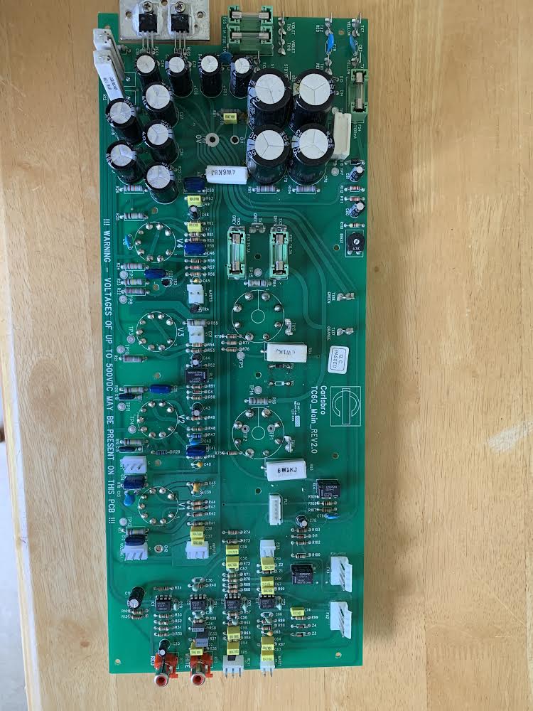

Oh just found a faulty diode on EL34 screen, this has a resistance of 6 Ohms in either direction… but does not explain the path to ground (fuse blowing) when no tubes are inserted. I have some components arriving this week. Will start to investigate…

Post #1 also says that this is not amplifier I am have, but the reissue version 😉
I am trying to get a schematic... silence so far from Carlsbro. I am tracing it will post when I have something useful.

Yeah I got some things from Carlosbro, not too sure they were identical to the version I have. Post some pictures. What’s is your PCB version?
I will re-look at what they gave me a bit later.

my pcb is v:1.2 -- TC60XXD01 - You got further with carlsbro than i ever managed , also if you have the amp still - would you know the resistor on pcb edge around the p10 and p9 supplies - thats whats frazzled and i cant begin to measure it - this thing could end up in the bin !! Chris

Here is the version 2 PCB from my amp when I had it on my bench.
These are the only files that they had. It’s the version 1 PCB as far as I can tell.
I’m not too sure what you mean P9 and P10, maybe because I have a different version.
Thank you so much but unfortunately totally differant from what i have - my amp has only 4 tubes in total - el34 2 off and 12ax7 2 off - total headache this thing !
The version 1 PCB schematic has two 12AX7 and two EL34. Might give you the value of the BBQ resistor.
yes it does make some sense - but with variations - the pcb was burnt and i cant even read what resistor it is - we'll get there

Actually ive just looked this over again and i think its correct - your a bloody star my friend - yes version 1 , the amp is at my workshop so looking at a pic i have on phone and it makes sense -- happy days
