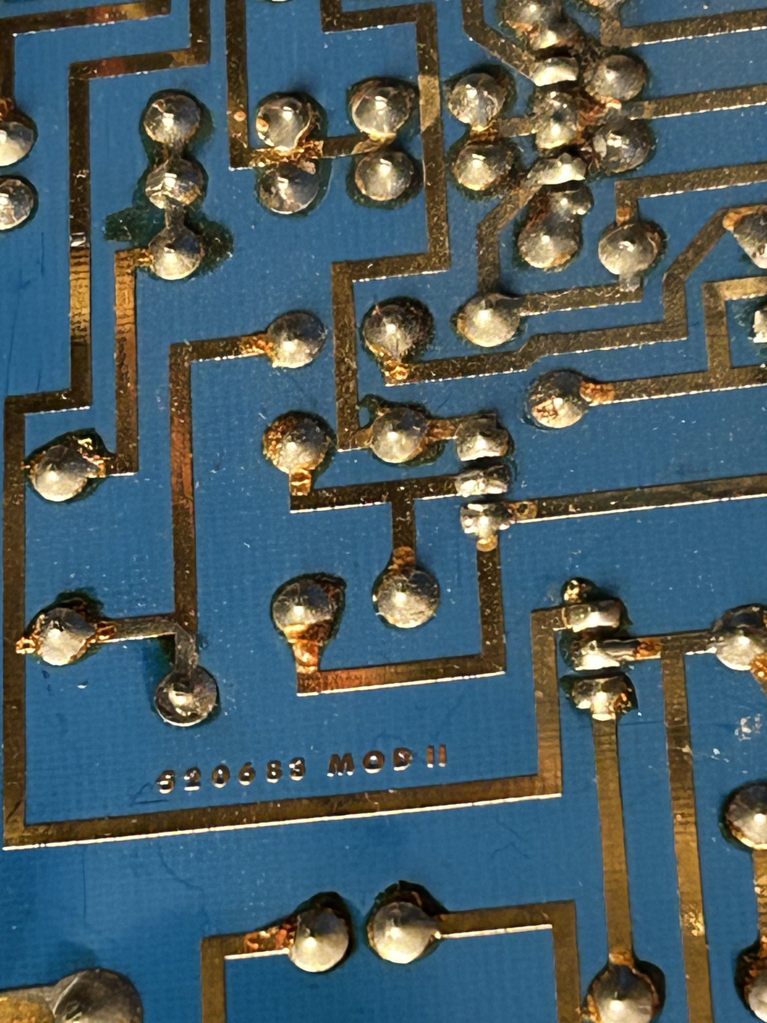

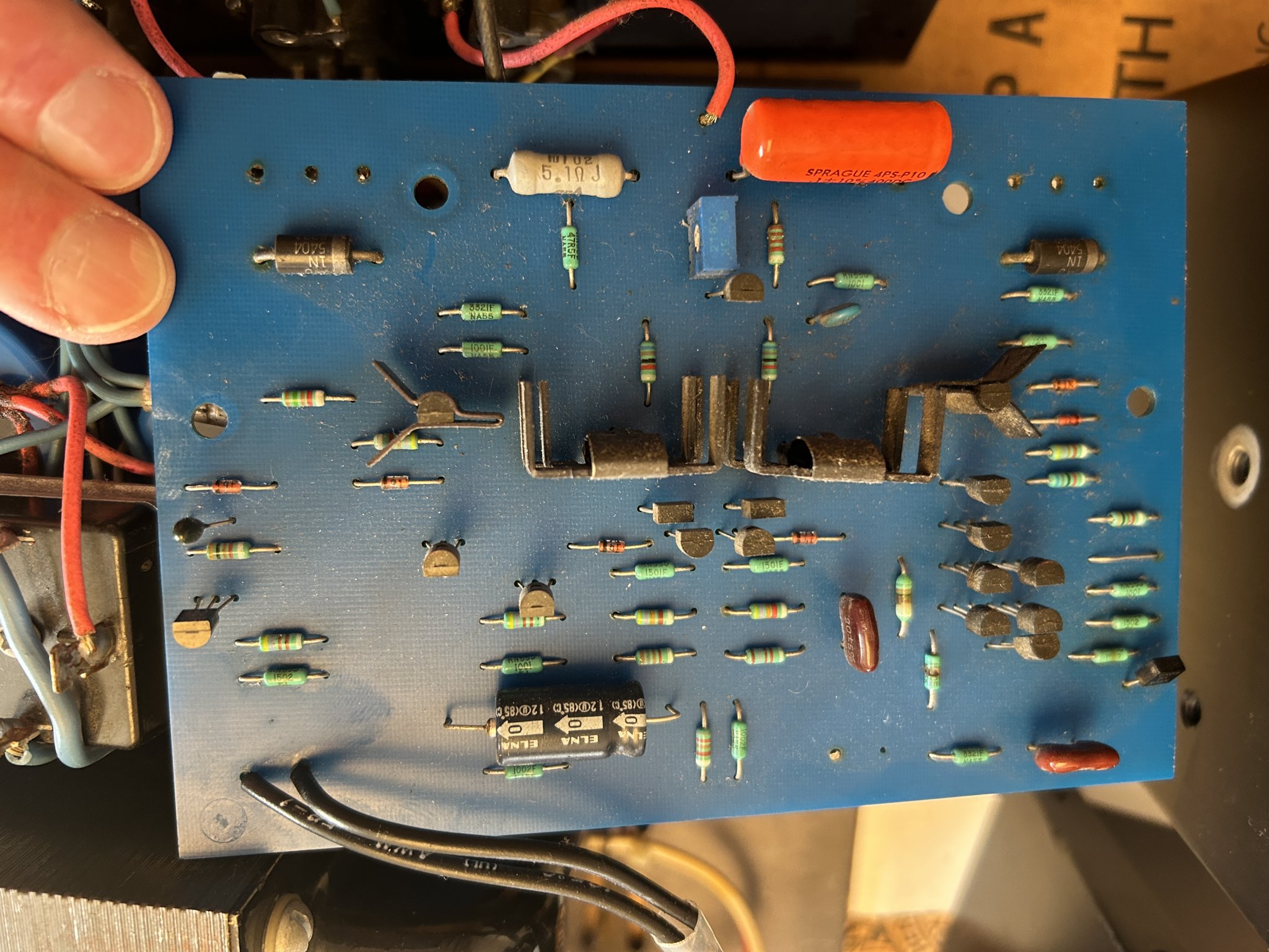

When I got it home and began a parts inventory, I noticed this amp has driver boards which don't agree with published 400A schematics
and are labeled “520683 Mod II”.
I've been searching high and low since then for info about the mod, and I did find that Threshold offered upgrades to their older amps to the Stasis technology at some point.
The only other thing I found was a reference saying it could have been upgraded to a S-300.
I tried creating the schematic of the board I have, but that quickly became quite a chore.
I did find tracing the initial input seems to agree with the schematic of the S-300, but there are differences too. (or maybe I'm just interpreting it wrong)
Long story short, this amp is a good candidate for the new Stasis FE, which I'll pursue, but I'd like to play with this first.
I'll post some pics.
I've been looking at the input's resistor values (3.3K) a 300pf cap followed by a resistor which at 820 ohms, agrees with the S-300 schematic.
It lacks the 4.7K resistor at the base of the 6251 transistor and the RCA input's ground has an 82 ohm resistor in series.
I've also noted there are U10 & U60 devices where the C2592 & A1112 driver transistors are.
I've made inquiries to Threshold, but they have no records.
So, has anyone come across such a beast? I'd like to rebuild in this iteration, then proceed with the New Stasis FE later.

I have been involved in 3 Threshold rebuilds now (with some help from ZM), and all three had the new Nelson Pass Stasis front end boards installed with existing Output stages - usually upgraded with new output transistors, and all three have worked very well for the three owners. As ZM says - go for it. These amps are worth upgrading. At least the existing FE board you show is not damaged by heat or burnt components like many are.
Jon Soderberg at Vintage Amp Repair in Utah might be able to help with the existing FE board as he was the tech at Threshold in the glory days.
Thanks all, Jon verified it's Stasis upgraded, but not E-line. S-300 similar.

OK, I took some pics.

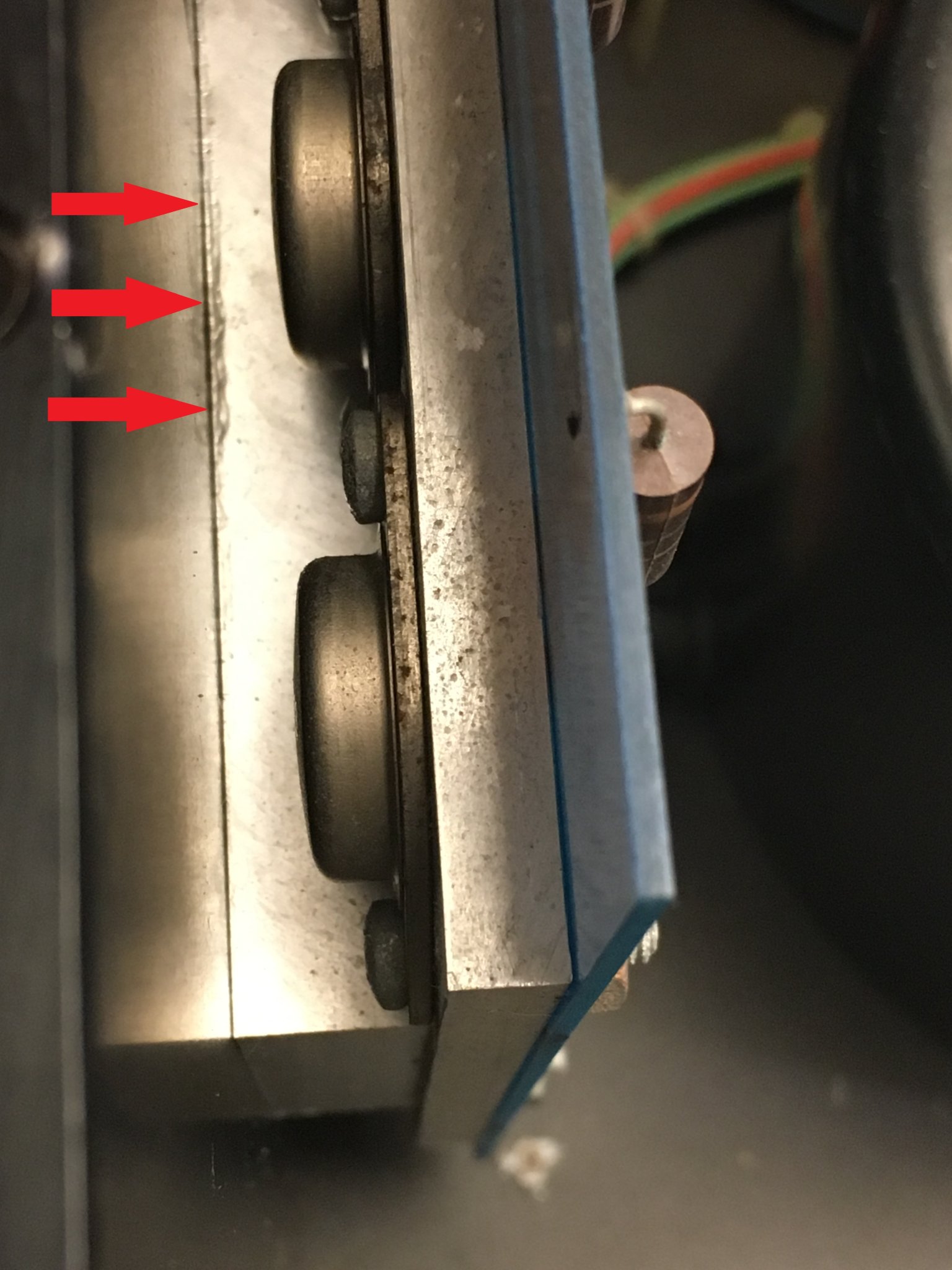

In the 1st pic, is clear heat sink gel where it's smooshed out from between the spreader bar and the black finned heat sink on a different amp.

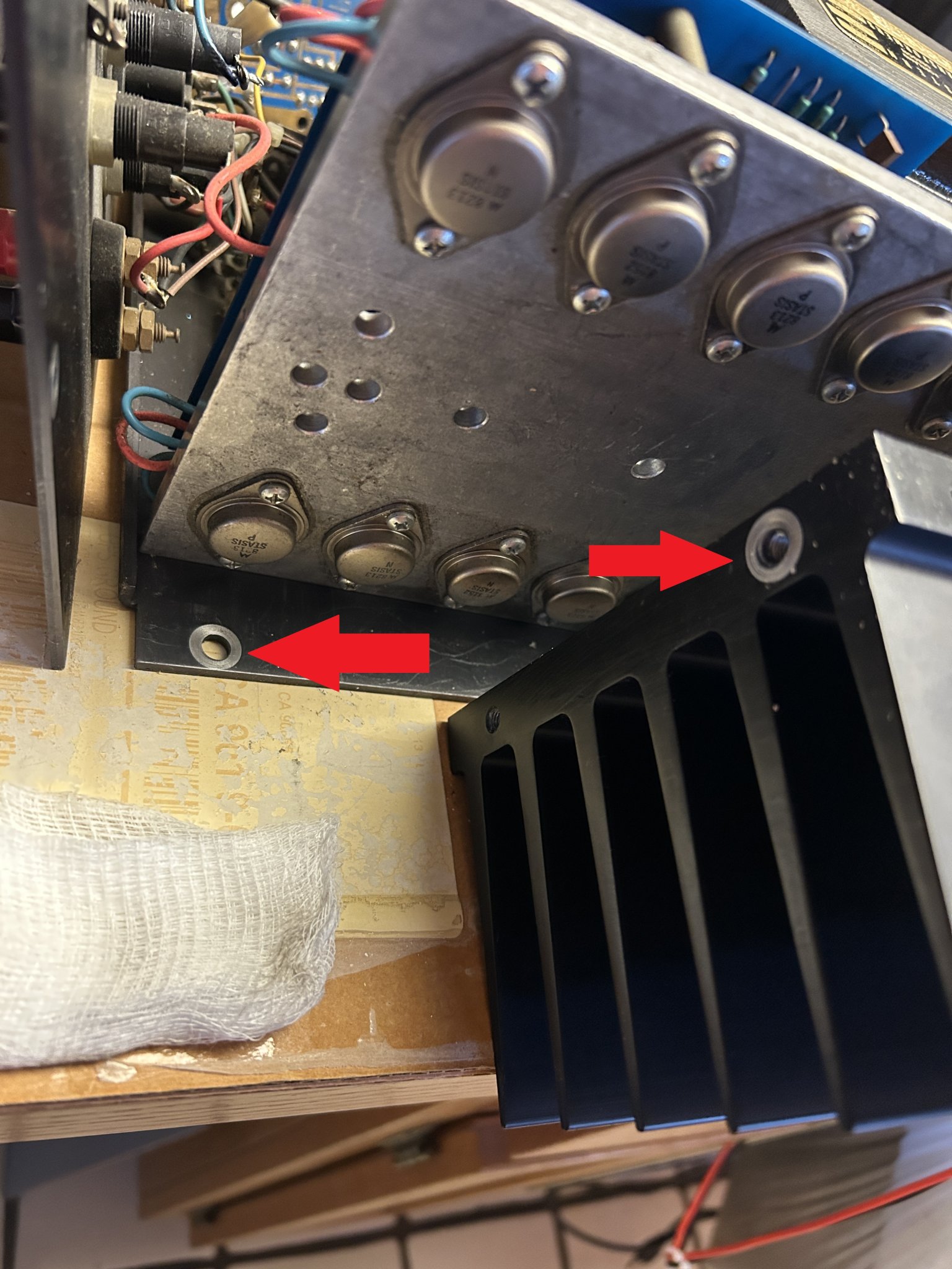

In the 2nd pic, you can see un-anodized rings around the bolt holes with the heat sinks oriented in their normal position.

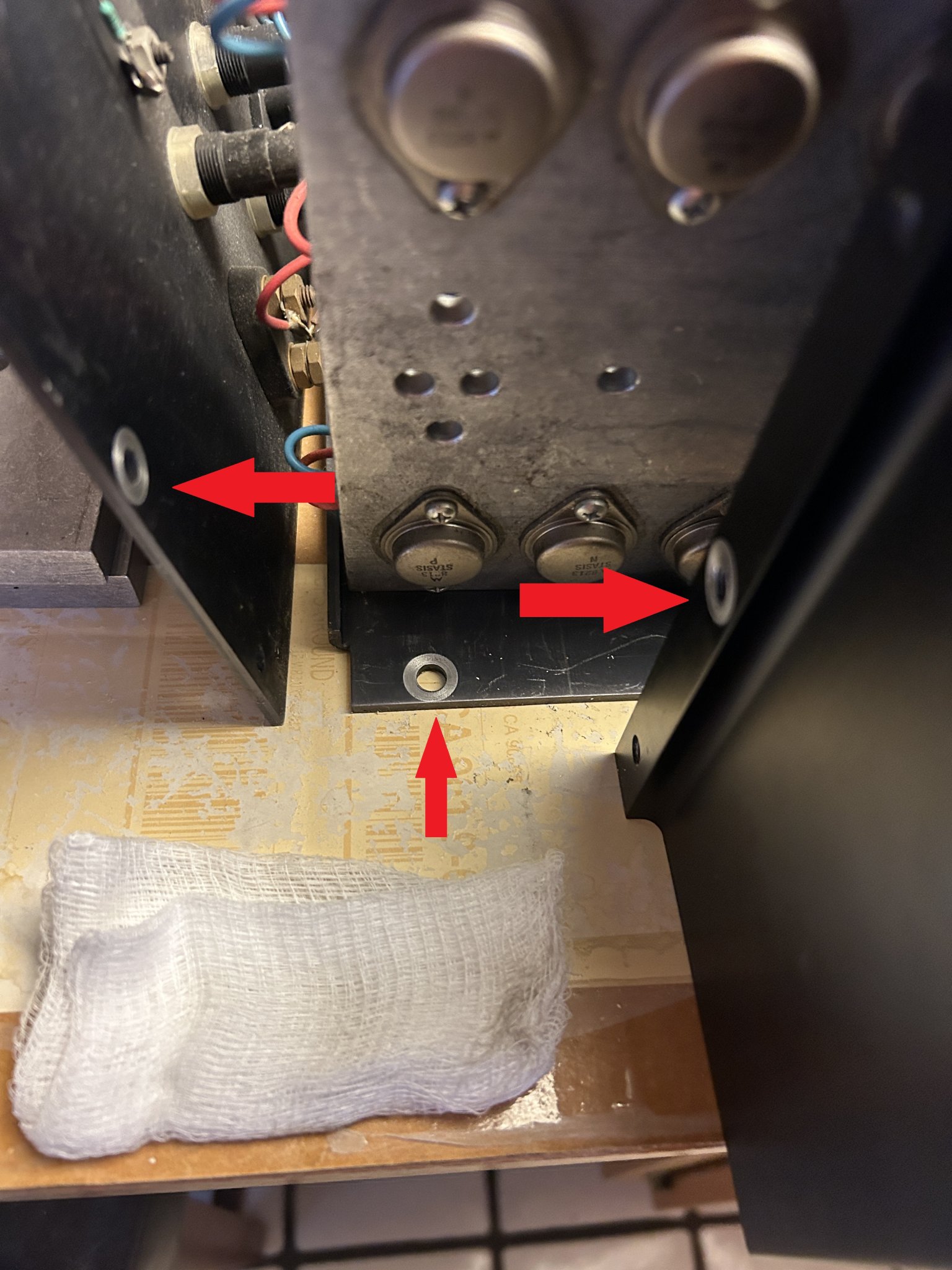

3rd pic I've turned it on it's side to show the un-anodized ring on the finned heat sinks bottom where it will meet the bottom panel of the chassis.

OK, as I suspected.
The through-bolts from the internal heat sinks/spreader bars to the big black external sinks ensure good contact there, but the chassis plates to heat sink junctions would just be flat to flat and there's no sign of any compound there (clear or white).
I'm just concerned there could have been small washers/spring washers or something at those junctions to ensure the earth continuity.
Anyway I can easily apply regular white heat sink compound at those junctions to allay that concern I suppose, but there's no tell tale white residue anywhere if it was used before.
The clear gel compound is still a mystery.
Heatsink compound is only required between the aluminium heatsinks and output devices and spreader bar to heatsinks and any other ally pieces - no heatsink compound is used between any aluminium to mild steel chassis plates connection.
I always use flat washers and spring washers on all chassis screws.
