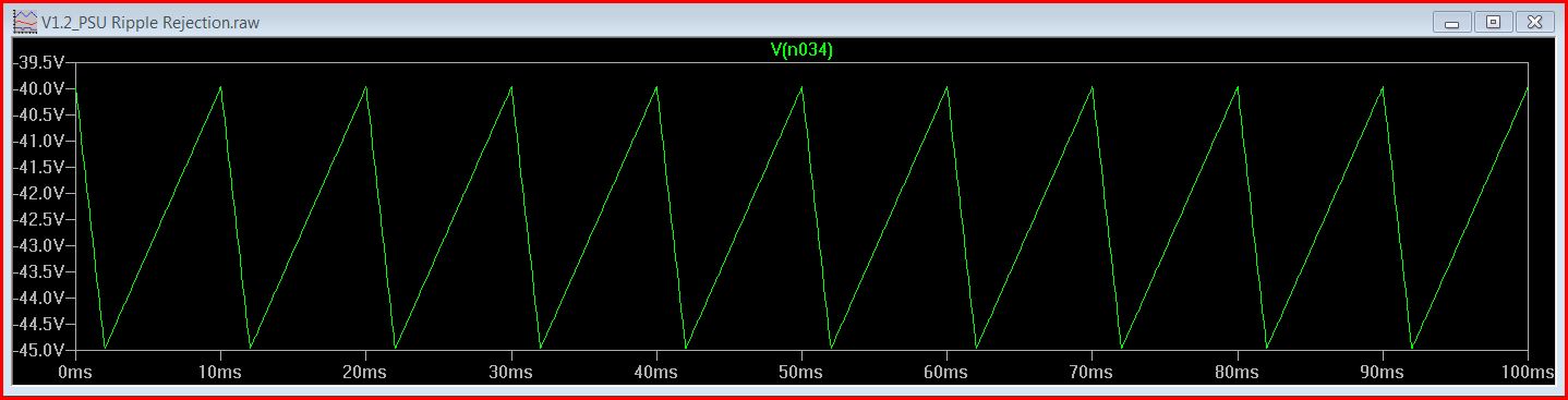

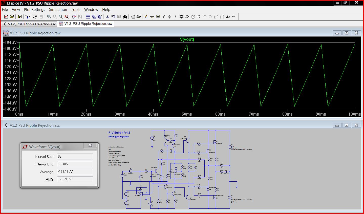

Some further testing with evaluation of PSU ripple rejection.

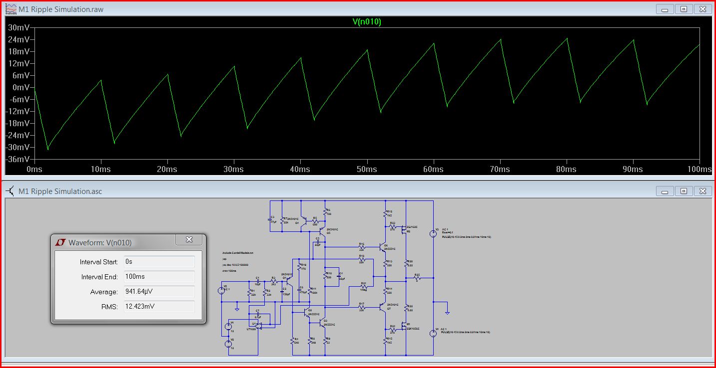

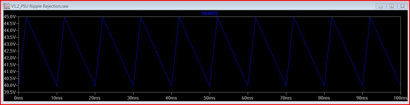

This was a potential problem area in the M1 and an area that needed to be improved. The new design uses two rails, a higher voltage stabilised supply for the input stages and the normal unregulated feed for the output stages. As the current requirements are low for the input stage a voltage double and regulator could be used to obtain the higher supply.

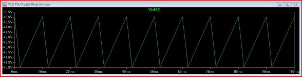

The test here is severe with 5 volts pk/pk of 100hz ripple on each rail. For comparison I have included a plot of the M1 under the same conditions. 126uV versus 12 mv. The two smaller pictures are the rail ripple.

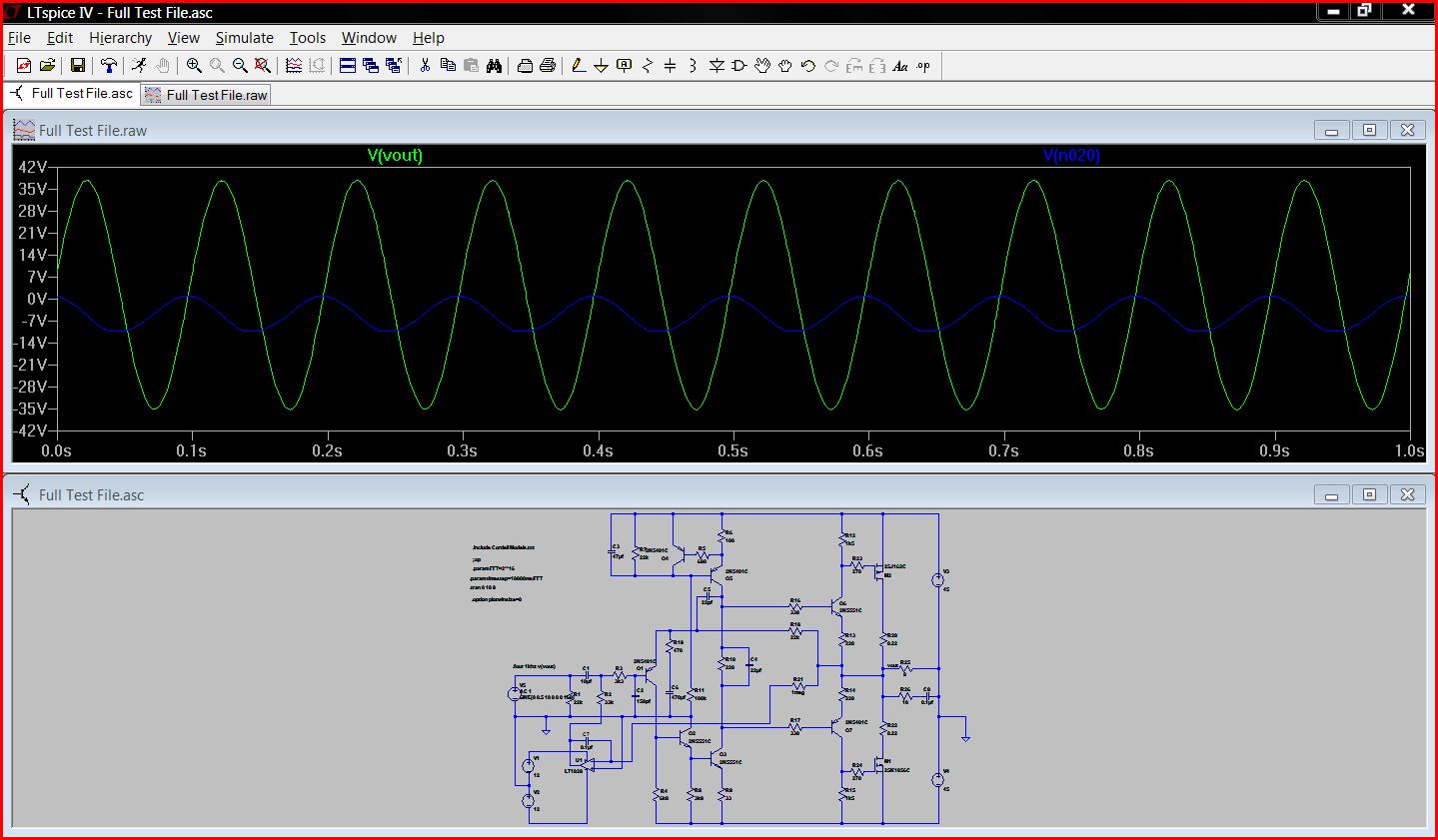

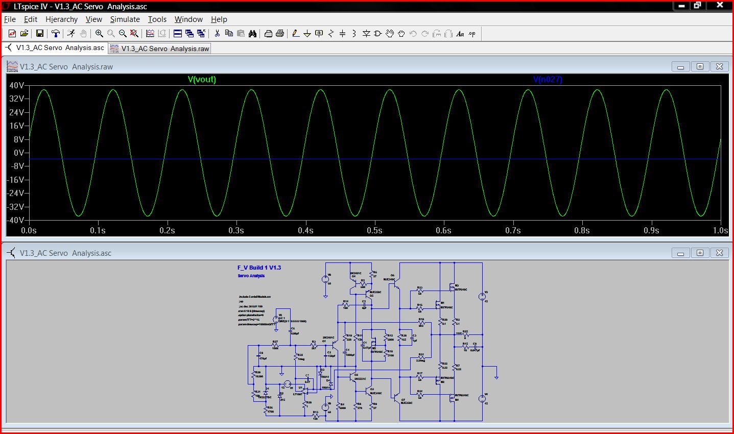

In the F_V I have looked at a "fixed" bias scheme with a very mild servo input that does little more than trim and maintain the offset at the zero point. R29 and 31 derive a fixed bias from a zener reference. R29 would be a 22K multiturn trimpot and used to initially adjust the servo output to some suitable value (the output of the amp proper will snap to zero volts when the servo is working within its limits hence "setting the output of the servo to some suitable level"). That level should really be a point that allows equal offsets to be compensated for. Looking at the minute details another thought arose. Is it worth biasing the opamp into Class A by sourcing or sinking a current into the output pin. Although the audio present is miniscule is it a detail worth attending too.
At this point I find myself struggling with LTspice. Notice the 0.99uf input coupling cap. Any value up to and including 0.99uf works in simulation. 1uf and above and the simulation doesn't run (well it does but at around a few ns per second of real time so it would take years). Similarly even a 100K from the opamp output to the -15 volt rail does the same. I have no idea why that should upset the simulation, maybe someone has some insight on that.

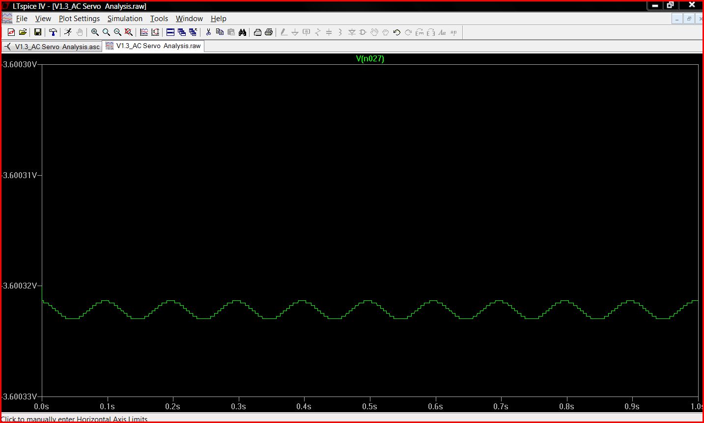

So for comparison here are the plots of the two amplifiers at 10Hz and maximum output. Notice the high output from the servo in the M1 which is just going into clipping at this point. The output from the F_V is minimal as can be seen in the detail shot.

The output of the DC servo at subsonic frequencies, below the filter attenuation, will show the phase shift of the filter with respect to the input signal, summing it to the input signal. The servo filter low pass Fc should be about 2 orders lower than the amplifier input filter high pass Fc for a single order servo filter. To start with I generally shoot for 200-300mHz and then vary the values a bit and record the results. Have you tried simulating a 2nd order filter for the servo? If the servo Fc is higher than a few hundred mHz a second order filter may help to prevent an overlapping responce at the very bottom end of the audio spectrum. The amplifier input filter should block frequencies lower than 20Hz so these frequencies should not be an issue, theoretically.:D

Beyond trying a passive filter at the opamp output I haven't experimented further.
I'm also getting a bit out of my depth with spice (it's such a steep learning curve from zero) and trying to see what the settling time is like and how it all behaves. There are a lot of time constants in there one way and another.
For anyone interested in the servo it's here,
Edit... I don't understand why changing some parts by a fraction stops the simulation. For example shorting out the 1 ohm in the opamp supply lead (which I put there to measure current consumption). Also reducing the 1 meg on the opamp output to 910K allows me to go above 0.99uf for the input coupling cap. These are all things I don't understand about spice.
