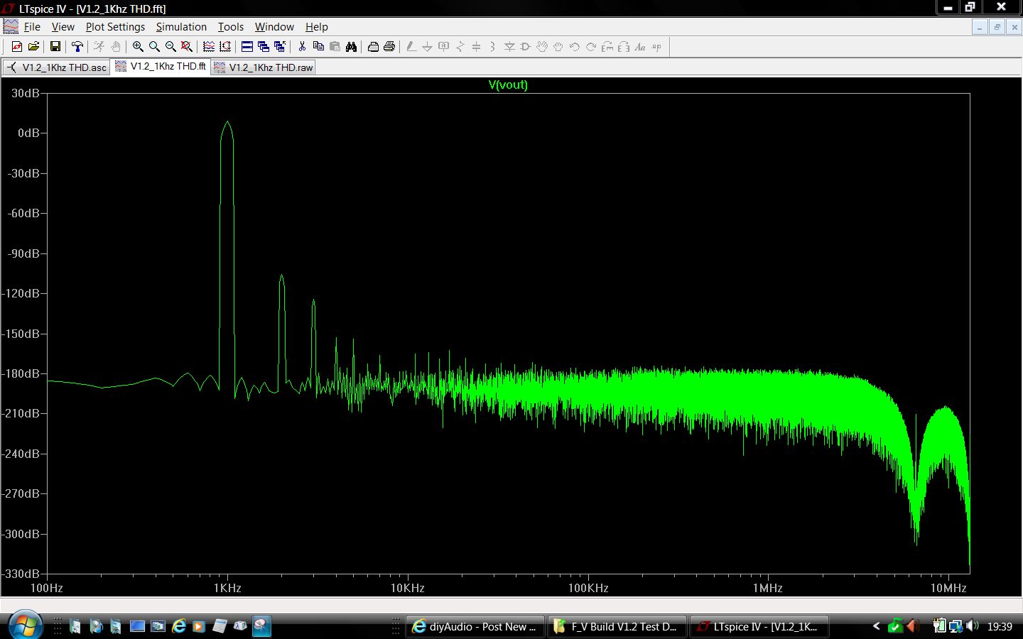

Some further testing with evaluation of PSU ripple rejection.
This was a potential problem area in the M1 and an area that needed to be improved. The new design uses two rails, a higher voltage stabilised supply for the input stages and the normal unregulated feed for the output stages. As the current requirements are low for the input stage a voltage double and regulator could be used to obtain the higher supply.
The test here is severe with 5 volts pk/pk of 100hz ripple on each rail. For comparison I have included a plot of the M1 under the same conditions. 126uV versus 12 mv. The two smaller pictures are the rail ripple.

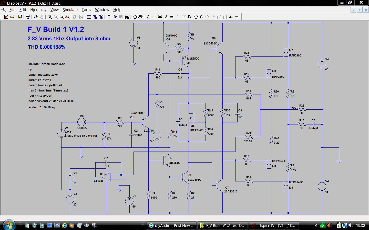

In the F_V I have looked at a "fixed" bias scheme with a very mild servo input that does little more than trim and maintain the offset at the zero point. R29 and 31 derive a fixed bias from a zener reference. R29 would be a 22K multiturn trimpot and used to initially adjust the servo output to some suitable value (the output of the amp proper will snap to zero volts when the servo is working within its limits hence "setting the output of the servo to some suitable level"). That level should really be a point that allows equal offsets to be compensated for. Looking at the minute details another thought arose. Is it worth biasing the opamp into Class A by sourcing or sinking a current into the output pin. Although the audio present is miniscule is it a detail worth attending too.
At this point I find myself struggling with LTspice. Notice the 0.99uf input coupling cap. Any value up to and including 0.99uf works in simulation. 1uf and above and the simulation doesn't run (well it does but at around a few ns per second of real time so it would take years). Similarly even a 100K from the opamp output to the -15 volt rail does the same. I have no idea why that should upset the simulation, maybe someone has some insight on that.

Mooly I did a quick sim of your design but Im kinda worried. You have about 24 ma through ksc3503 at first 45v and now at 60v. I dont think they going to make it. Why this abnormal high vas current ??
You had me looking at the data sheets on that 🙂
The 2(K)SC3503 is 300 volt 100ma 7 watts (cooled). Worst case I guess they would see just over 3 watts if they has the full 120 volts across them.
Am I missing something ?
In the later versions I switched back to MJE340/350's after my little senior moment on slew rates with the MJE's and me not believing they could be that bad in simulation.
The main drivers run at 50ma and see around 2watts.
I agree the VAS current is on the high side and there was no real master plan to that initially. I just wanted to be sure there was sufficient drive for all my experimenting.

I havent got experience with the fairchild parts but with the old sanyos I needed quite a big heatsink when using at 20ma 140v.
Some builders of ostrippers amp are complaing that they cant touch the vas transistor at 140v 12ma .....? Thats with no cooling but it makes me wonder how big heatsink is required.
I think you are chasing the THD figures a little too much, very low figures here are going to come at the expense of other factors. I think you could easily live with a bit higher THD which is what would happen.
I also noticed that you run your input at only 300 ua, which is very low. You can get away with it and is beneficial relative the noise for bjt input but you should really look at using a diffrent input transistor then. The 2sa1381 is sluggish at that current, there is very little voltage swing accross it as it functions as the transconductor so I suggest a low noise small signal Bjt ie mpsa18 is perfect. At the current is will be 5 times faster, its much higher hfe will help with offset and its lower cob will lower high frequency distortion.
I do have some genuine 2SA872A which could be a good choice with a low Cob of <2pf and high hfe.
I have played around and reduced the VAS current to 12 ma and the driver curent to around 35 ma with no obvious issues showing.
12 - 15 ma is more managable, would be great with a small heatsink. What influenced the decision to go with mje340 instead of the vas transistor complementary ?? As for the small signal 2sa872 would do nicely, one could even use bc560, its a pity mpsa18 are not so widely available its a excellent transistor.
