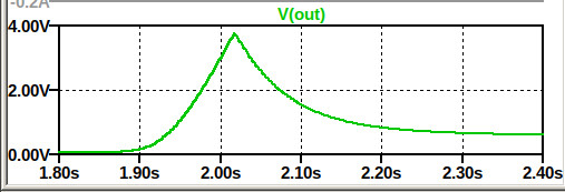

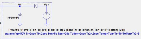

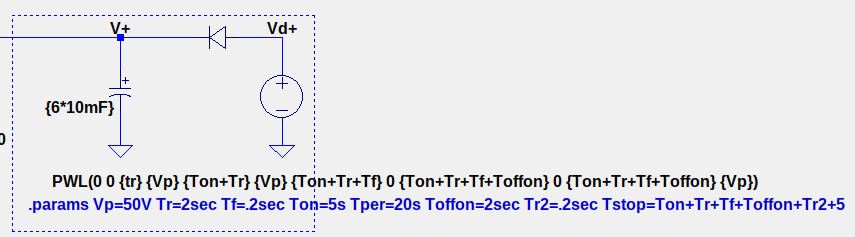

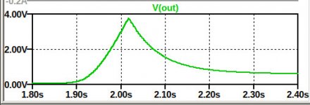

I used an oversimplified power supply simulation. The rectifier and capacitors are used as a simplistic model for the voltage decay when the power is turned off. The rise time Tr is a simplistic ramp for the power on voltage, including effects due to the CL-60 inrush current limiter on the transformer primaries.

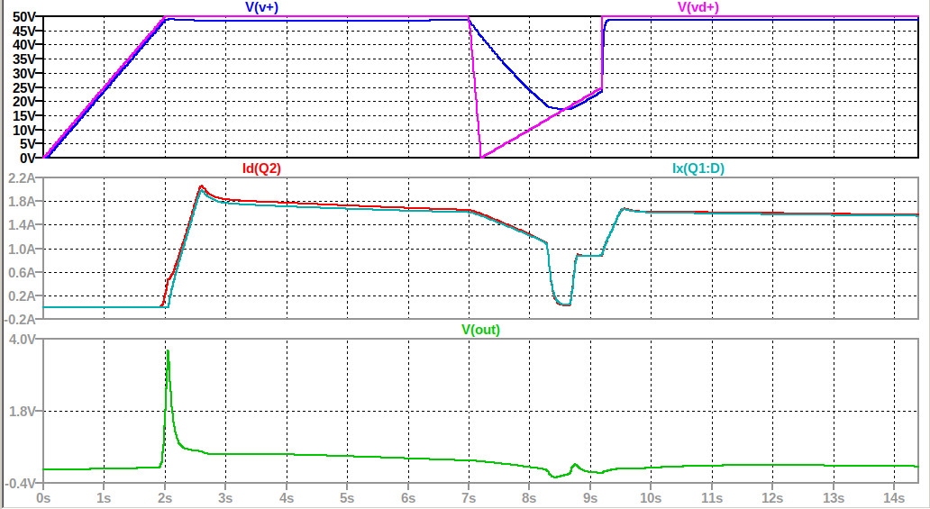

Maybe showing more plots will help.
- The top plots are Vd+,the output from the PWL voltage source, and V+ the rectified/filtered voltage.
- The second plots are the FET currents Q2, the IRFP240 and Q1, the SemiSouth R100.
- The third plot is the output voltage.
