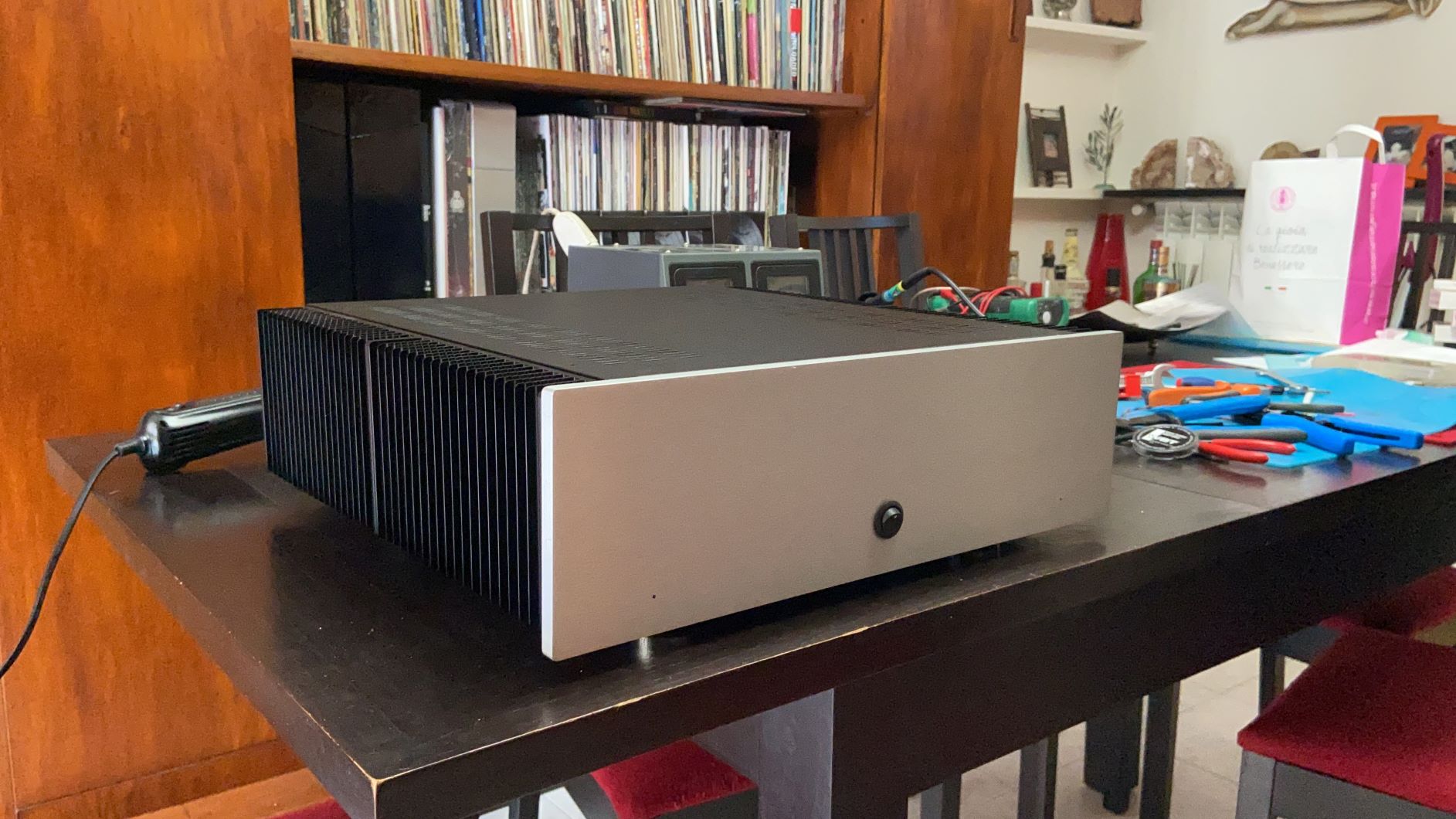

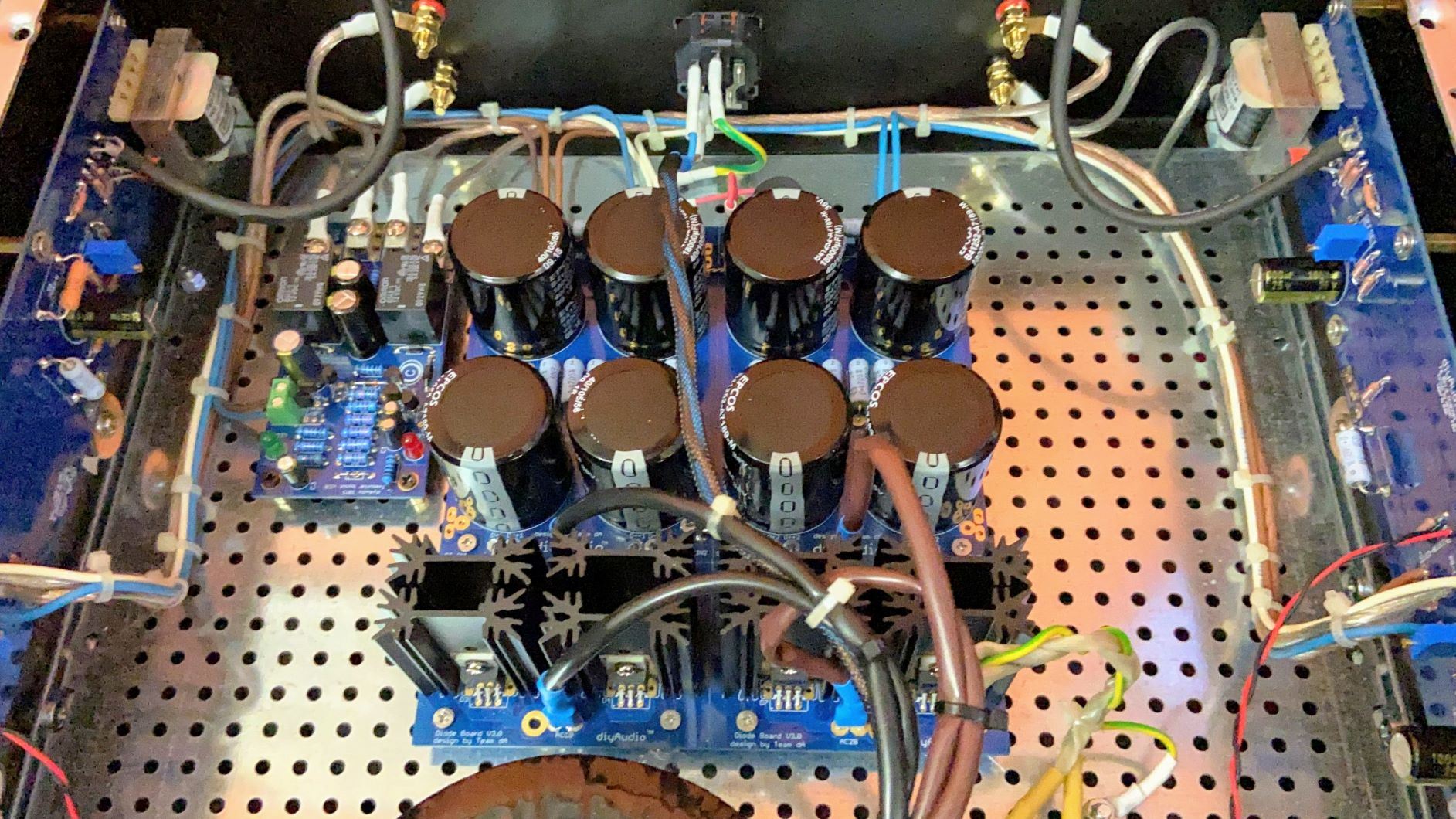

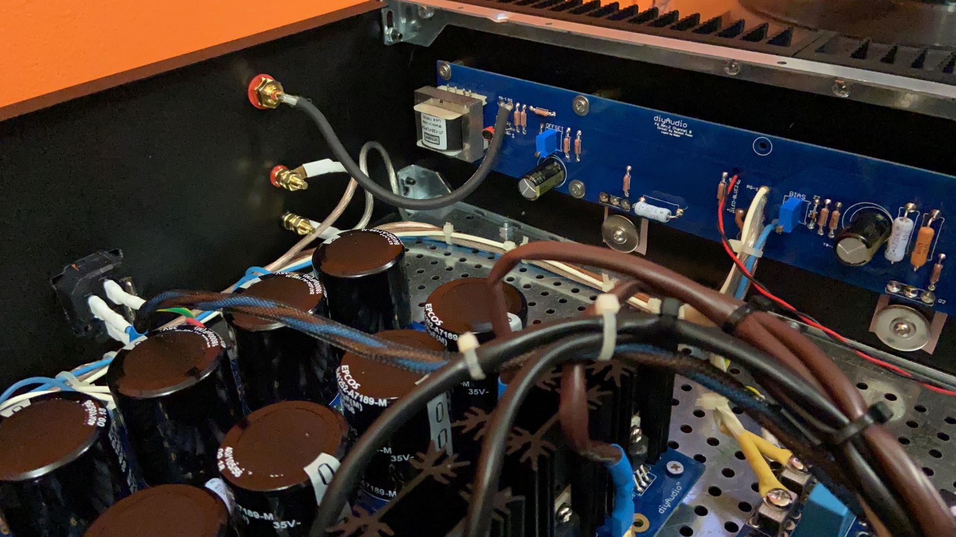

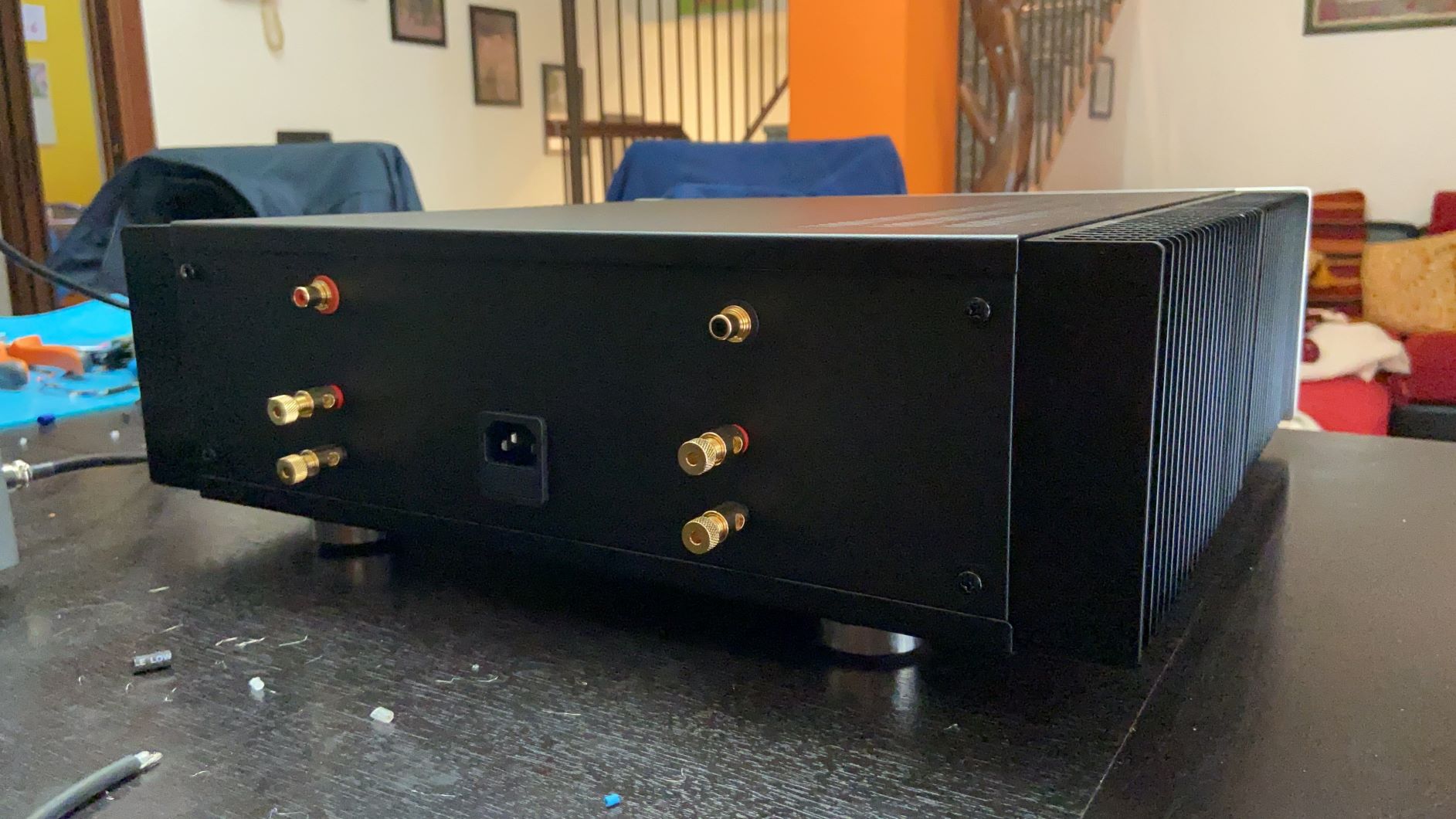

Hi everyone, in these days of quarantine I have taken advantage of it to make the Firstwatt F6.
My realization is exactly as in the manual, without any modification or improvement, that is, as thought by its designer, Mr. Pass. The PCBs are those of the DIY Store and I decided to add the soft start & Speaker soft start and dc protector also on diyaudio store. The components of the amplifier are those of the kit while those for the PSU and the protections come from Mouser, the transformer is a 400Va toroidal produced by Toroidy.
The construction was easy and did not present any problems, thanks to the fantastic guide of 6L6 and to the comments of all of you, frequenters of this great forum, specifically I found two comments very useful as a neophyte, which removed me from the only doubts that I faced:

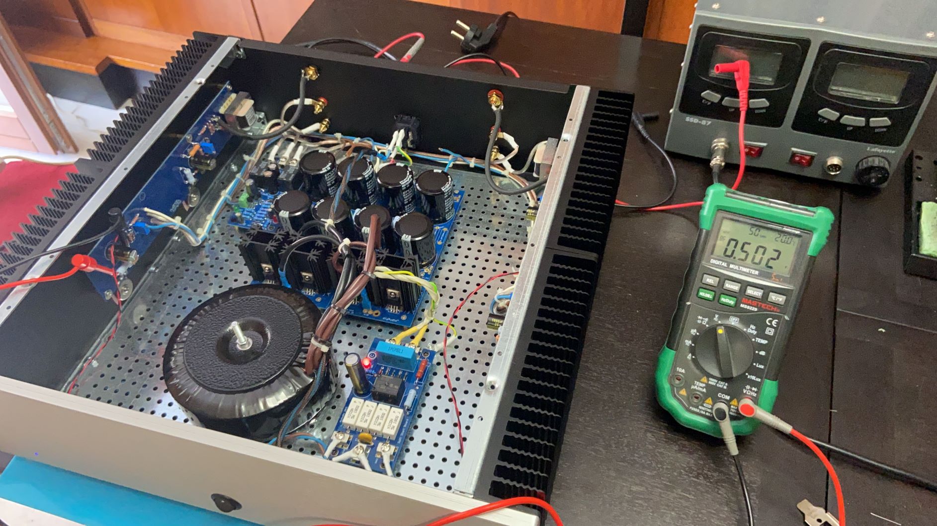

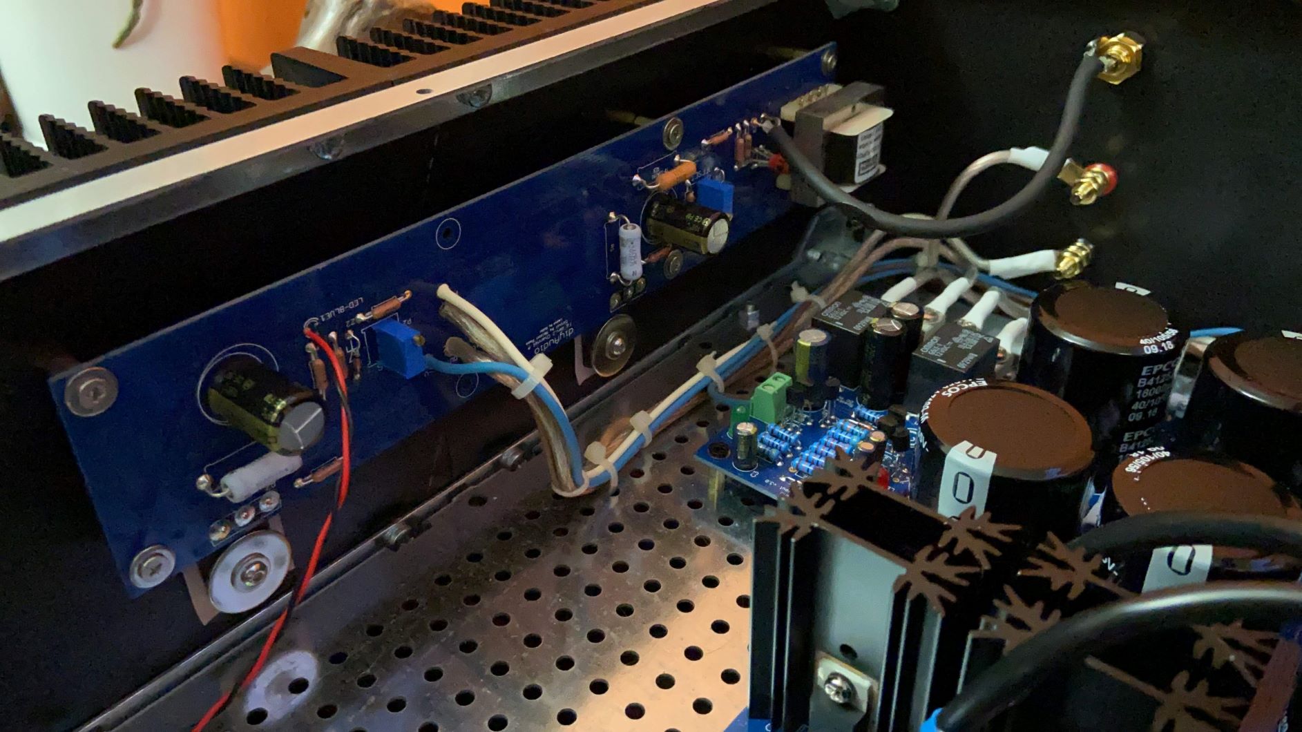

- During the calibration of the bias, measuring the voltage across the resistor R2 I had 0mV and I thought I had done something wrong, but reading in the forum, thanks to the BruceInOz message # 1633 I understood that the mosfets need a certain voltage on the gate to make them start working and in our case it must be around -23V, a value that I reached by acting on the P2 trimmer.
- Always trying to reach the bias value of corca 500mV at the ends of R2, I realized that I did not reach this value, but only 280 / 330mV, always reading on the forum (thanks to kbergsson and 6L6, messages 1123 and 1125) I understood that I had to use 6.1 / 6.8V zener, changed which, I calibrated the bias correctly.
A tip for beginners like me is that the calibration must be done in sequence first the bias, then offset, then bias again and then offset, so on until the two values are correct, because one adjustment affects the other.
It has been working for a couple of weeks now and I am very happy with it, the sound amuses me a lot, the music has taken on a thickness that it did not have before, I sincerely thank Mr. Pass for giving me the opportunity to replicate one of his projects and 6L6 for having drafted this guide and all of you for helping me, by giving me the container and for your comments from which I took the advice.
I am attaching some photos of my realization.
Thanks again to everyone and enjoy!
