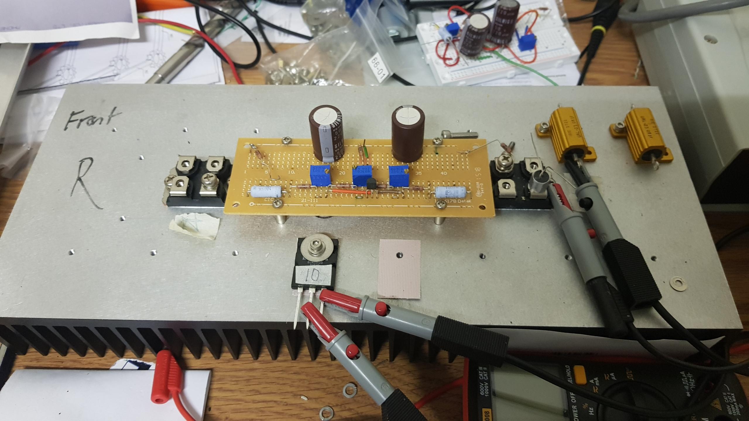

Last February, I had these boards running but then found that the case was too narrow to fit them (the Aliexpress/Ebay Weilang Audio case from a few pages back) and never found a home for them. It's a sad sad story
That is a really excellent job for a test bed.

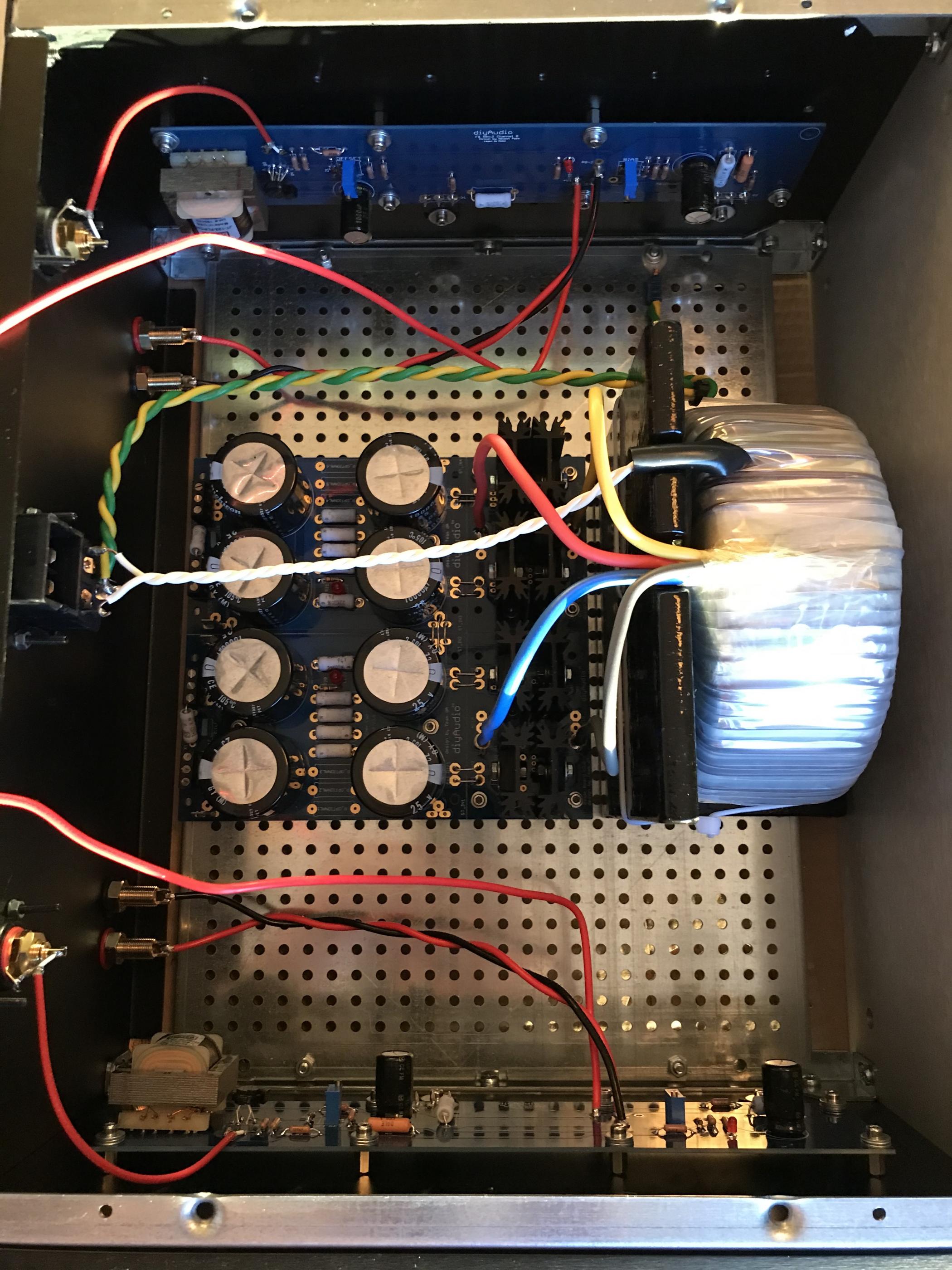

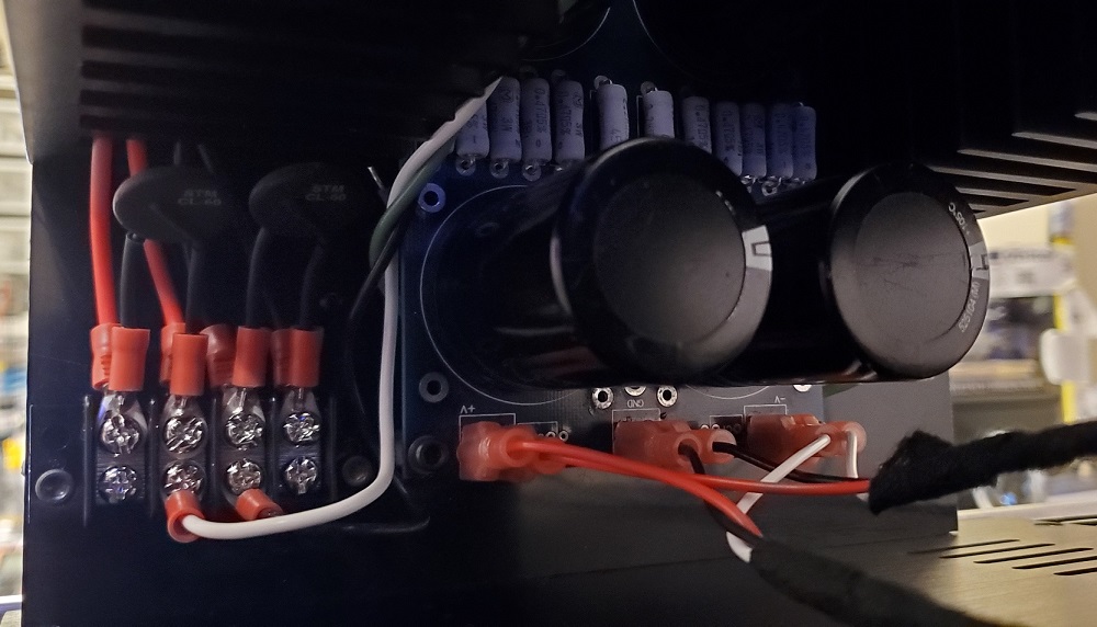

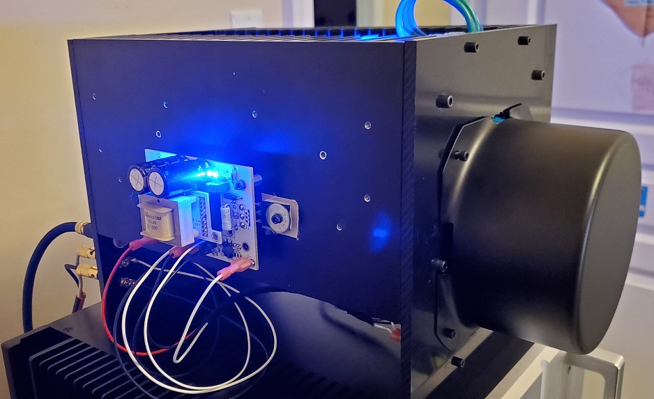

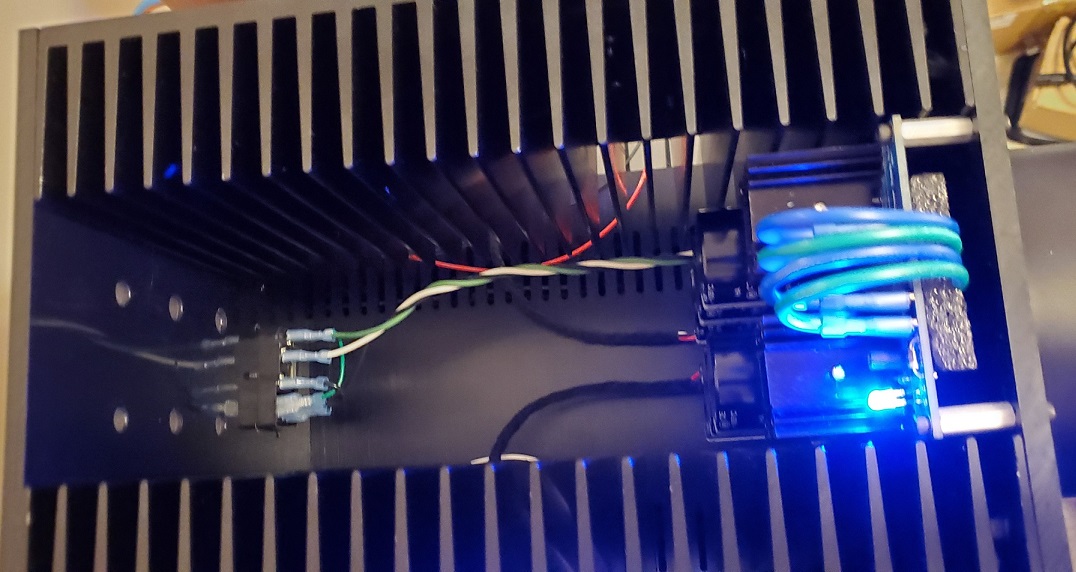

Hi I have an idea for my 2 largely identical first watt chassis one of which has an F6 the other an M2 located within. I am planning to swap over the right hand boards and heatsinks and place TPST switches on the power supply of each board and heatsink combo for both amps, a total of four switches.
This should allow me to run two mono F6s (or M2s) each with their own power supply and audio circuits and for easy comparison if I wish to do so. Will this work? I can't see why not. I plan to locate the switches on the top plate near the front keeping wiring short and simple and an easier job cutting out on the top plates.

I have also done this a while back but without switches, I just use Deans plugs to connect the amp I want to use

I did it and posted about it at the below link. Works great!I turned my two stereo amps into mono-blocks for 10 dollars

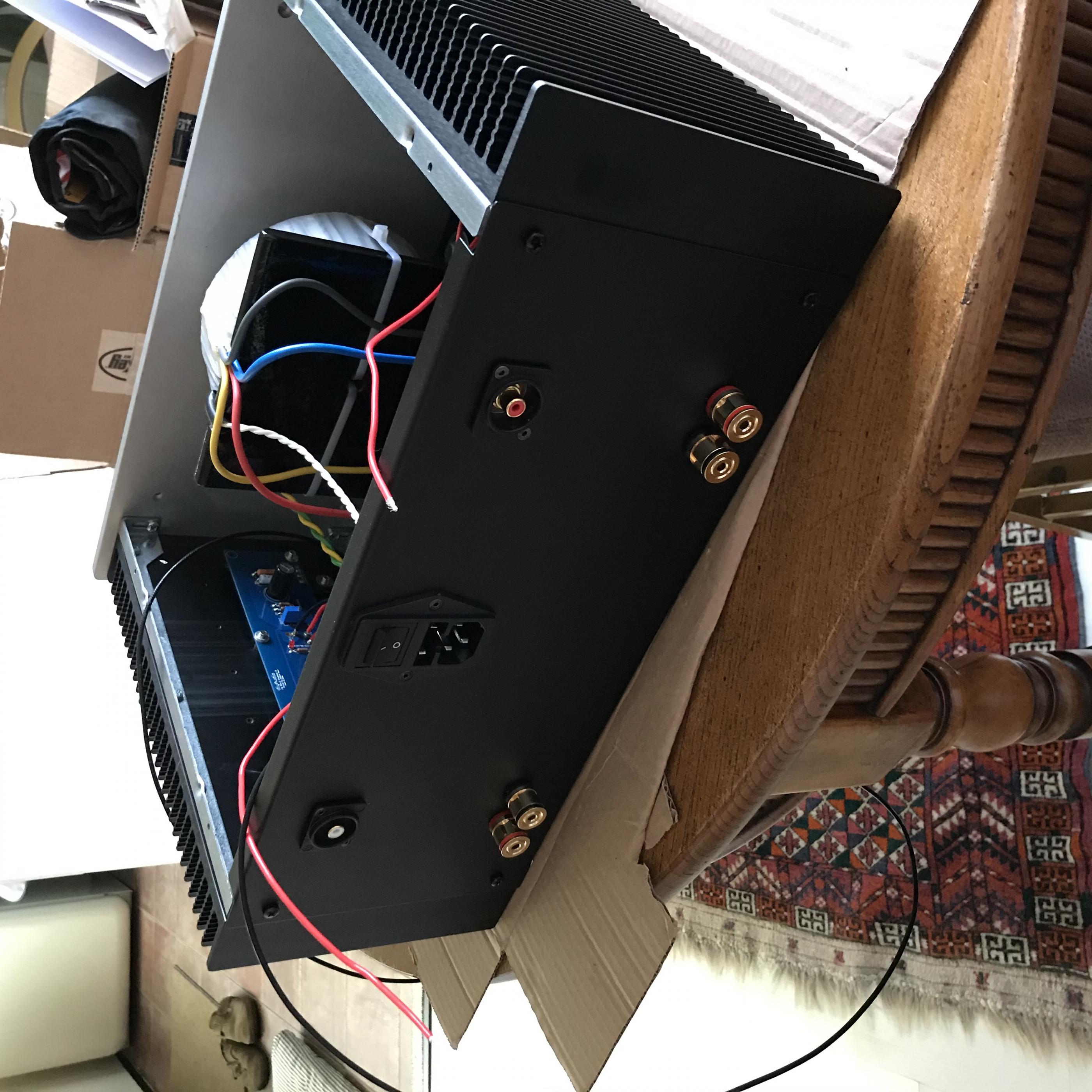

I have been busy the last week building the First Watt F6.
As this is my first DIY amplifier I learned a lot during the build, and I am very grateful to the diyaudio who gave me advise. With their help I was not able to end up where I am now, enjoying my first diy amplifier (better than any commercial I have heard before!).

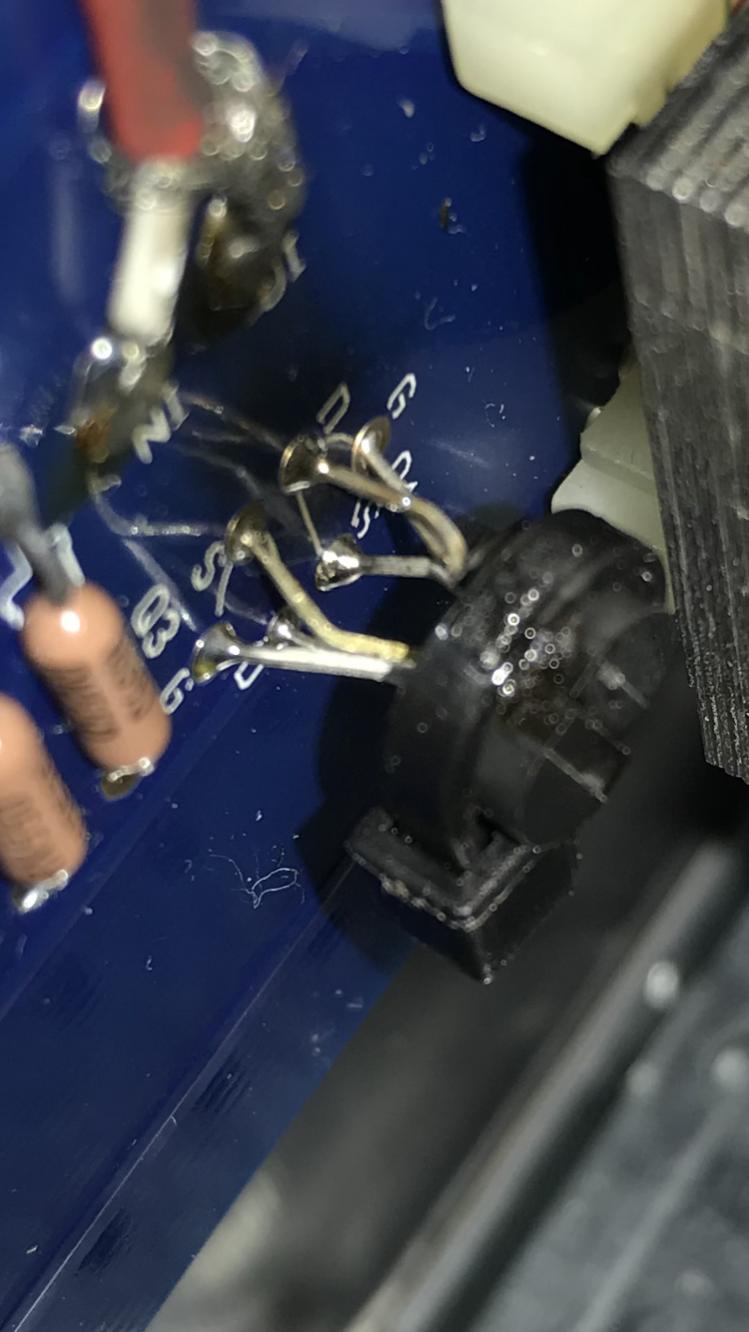

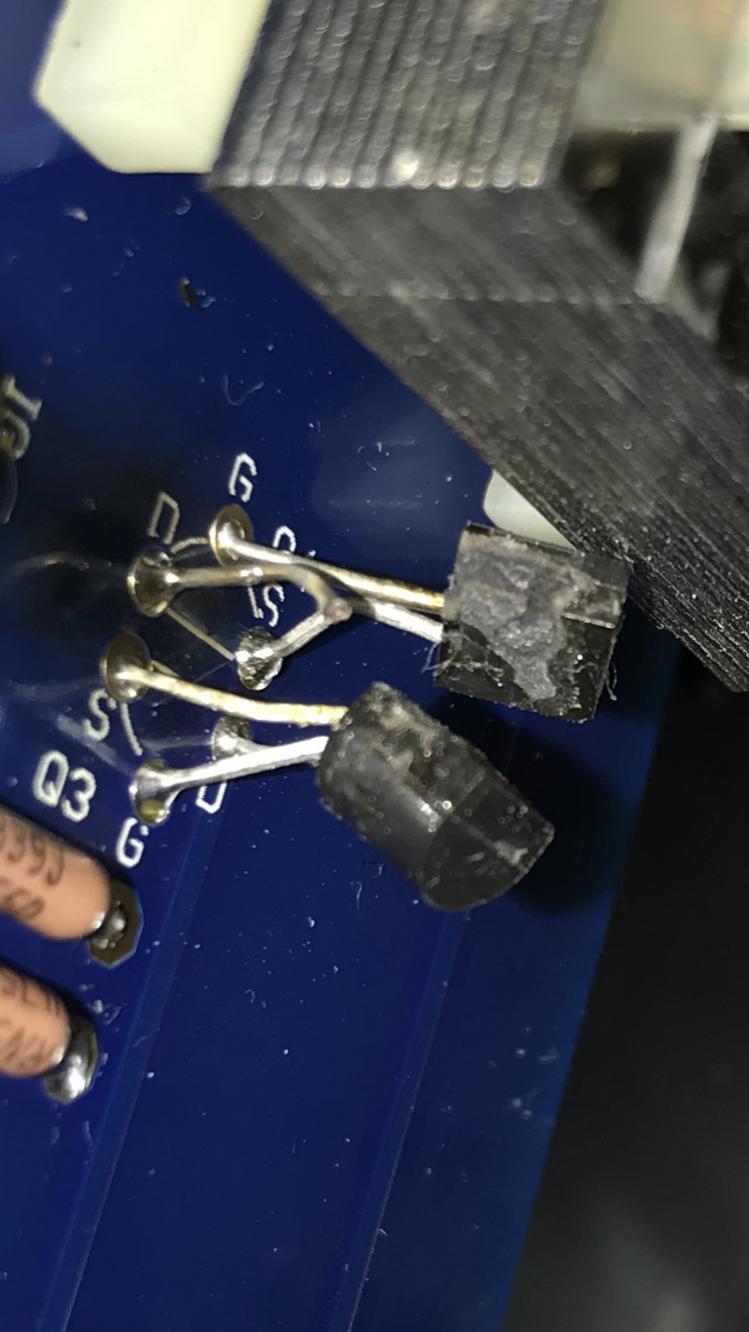

At the same time when the first notes came out of this magic amplifier, there was smoke coming from one of the channels. First I thought it was the Jensen Transformer. When I looked closer I saw that it was the FET at Q4 😡
I knew that it was damaged during the installation of the board (I hit it by accident), and when I looked closer after the smoke came out I saw that one of the legs was actually broken which caused a short.
For now my question is, how to proceed? Since this broken FET is one of a matched quad, should I buy a new matched quad or can I just replace this one by one new FET?

new pair
Thanks for quick reply! 🙂
So, just to confirm, I will only replace the 2 FET’s at Q4?
Koos
you need to replace just broken one,so to have matched pair,you must replace a pair
Copy that. Thanks for the clarification. 🙂 I will order a matched pair of LSJ74B.

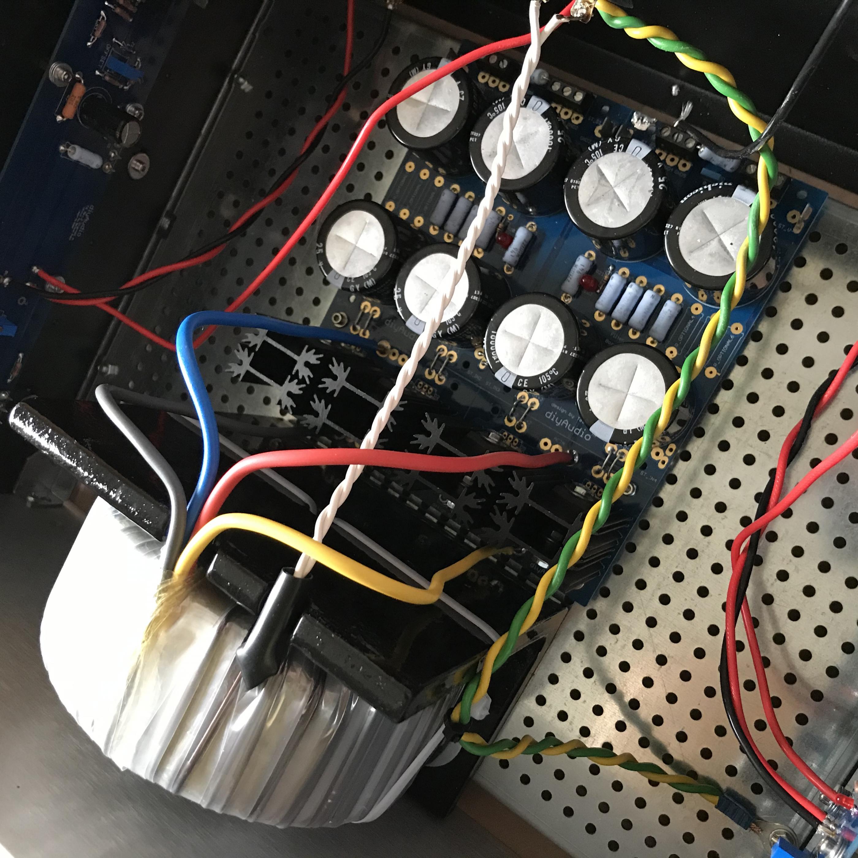

I added some photos of the build so far.
