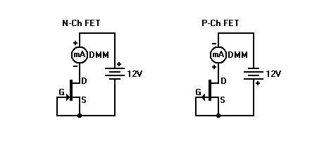

check them with Idss matching jig
feel free to use 9V battery as voltage source

I tested the jfets using a 9V battery and 47 resistor. So these are the results:
Lsj74 #1 -0,02V/47R=-0.42mA
LSJ74 #2: -1.34V/47R=-28.5mA
LSK170 #1 0.43/47r= 9.1mA
LSK170 #2 0.22/47r= 4.7mA
Seems like one has survived no, (lsk170 #1)? If that is indeed the fact I will be ordering a new set of matched jfets from the US.

I don't get it how you check them with resistor ( I have an idea but can't be sure without confirmation)
however - if you test them simply as I show in previous post , and you don't get normal values ( say 6 to 15mA , dunno which range you have) , part is simply toasted
better wait for real deal
I measured according to your previous post and all values are below 5 mA. One N-ch is even 0. I'll just have to be patient then! Thanks for your assistance. I will be exploring this forum for a nice source to build. DDDAC from my fellow coutryman looks interesting too! will get back of course when all is working, or not😉
