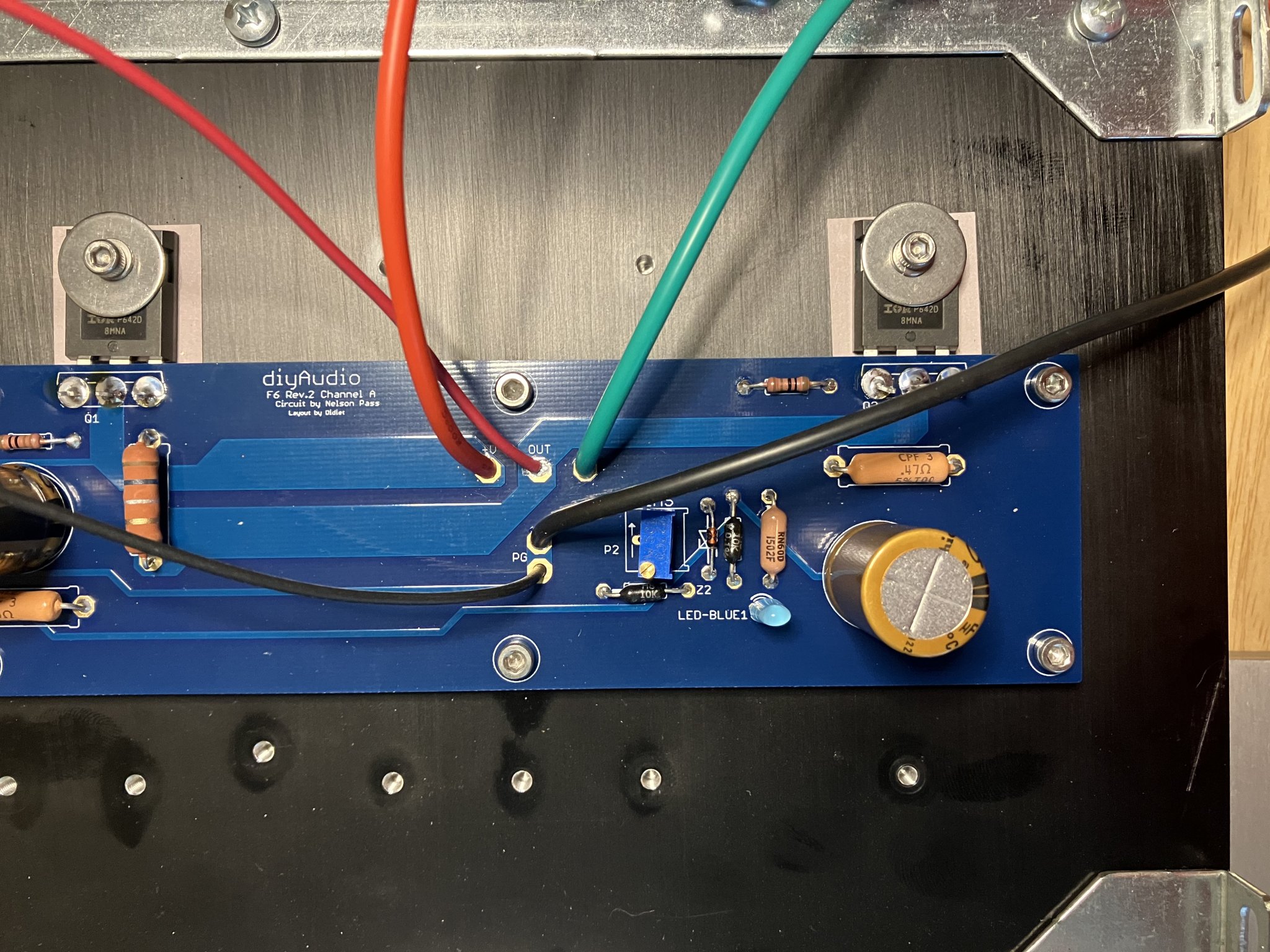

Is there a scenario where the voltage on the source resistor would switch from positive to negative?

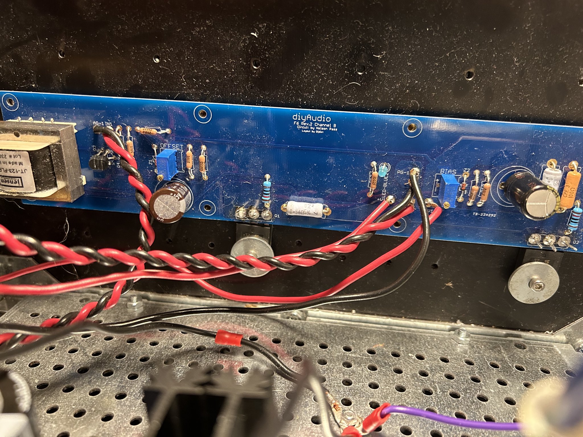

I had everything set last night but the leds were not working. I switched them this morning, adjusted the bias again, it was still pretty close to last night, then I left it for about 5 minutes. When I came back, my meter showed -.505, both channels. I backed the bias pot all the way out until it started clicking, then screwed it back in and now the values are positive again?
It’s when I switch the leads around, it gives me the same value positive and negative. I didn’t know it would do that.

re: LEDs, one of the LEDs (can't remember which board is which)... is on the positive rail, and one is on the negative rail. You're definitely not alone installing one of them backwards.
However, if one of them was working the previous day... and then stopped working... that is a slight concern, unless you switched the wrong one around, and now both are not working.
What (if anything) did you do in the middle?
Yes, if you swap the leads around, you should get an equal and opposite reading. It sounds like that is what you did. Nothing changed in the circuit, but you swapped your black and red probe. You can do that with any DC voltage reading. In the case of the bias voltage reading across the resistor, just use the absolute value. The current (I don't think unless there is a big problem) will never go in the unintended direction. Bias it back up if you haven't already.

I had them backwards, they’re both working now. Thank you for the suppport and encouragement.

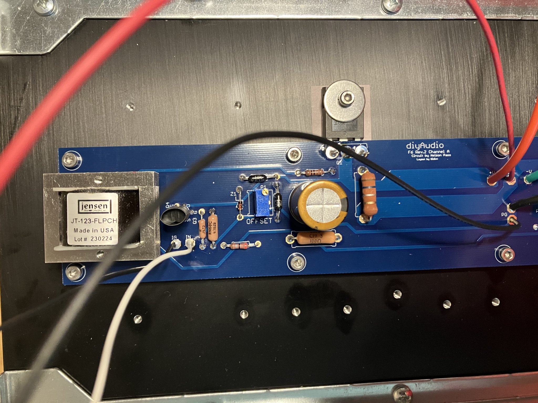

I'm looking for help troubleshooting my F6. It's pretty much a stock build, No diode changes or LED mods.
Q1 on one of my channels heats up to scorching hot if I allow any amount of current to go through the amp. Meanwhile Q2 stays cool and passes the signal happily. I've replaced Q1 with a known good IRFP240 with no luck, same issue.
Something has to be wrong somewhere else and I feel like I've checked every component value I can with my multimeter and all are in spec and matching the opposing channel as far as I can tell. Signal looks good at R11. I replaced the capacitor at C1 no help there either. Can someone help me troubleshoot this?

Both offsets are at 2.7k. Here's a pic, apologies for the dust, it's been sitting on the bench for a while and i'm finally getting to it
Have you checked (measured) your offset pots?
Do not assume which direction they are adjusting, or even that both are the same.

Your pcb looks to be very close to the heatsink. Are there standoffs between the pcb and heatsink. Be sure that there are no shorts between the pcb and the heatsink.
Measure the Vgs of the mosfets with the power on and DBT in place. Is the Vgs around 4V at both mosfets when the voltage across R1 and R2 is 130mV?
Turn the pots until the voltage across R1 and R2 is zero. Are you able to zero the voltage? What Vgs at the mosfets?
If the voltage across R1 and R1 can be zeroed, set them at zero and remove the DBT and power up. What are the voltages across R1 and R2? Vgs?

No observable shorts to the heatsinks, Using the standard standoffs that come with the kit.
Was able to zero both Resistors.
Off the DBT I got the following:
R1 30mv
R2 40mv
Q1 Vgs 3.7v
Q2 Vgs 3.8v
Current climbed up to 100W before I put the DBT back in line. Much slower this time though.
