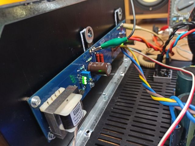

Hey Arthur,Now the amp won't turn on
Please post some pics of your work in detail from different angles to show as much as possible. Also, note whether you built the amp to the stock schematic etc.
I would try taking the channels off of the power supply and run the amp on a dim bulb tester first. Check voltages etc. Then install one channel, test, confirm functionality. In your case, it may be a good idea to do one channel at a time confirming their functionality. Take pics first though if you are able.
Best of luck!

@Roosterwing, I am a neophyte like you but based on good advice I recently received I would disconnect both channels from the PSU then start the PSU on a dim bulb tester, if things look normal then I would connect One channel at a time well still being on the dim bulb. This way you can isolate where the short may be. Assuming your wiring is all as it should be I would guess that there is a possibility you could have blown a MOSFET or two and this would be the cause of the short. Those with more experience please feel free to jump in and correct anything that I have said.Hi folks,
Had my F6 up and running since last weekend (biased beautifully to about 0.6v, 0v offset) with the transformer simply plugged and resting outside the chassis while waiting for an L bracket to arrive. The amp sounded amazing (so much better than the Prima Luna I've been listening to...).
Yesterday, upon receiving the L bracket, I drilled the baseplate and fixated the transformer vertically after trimming its secondary leads. Things went very bad from there: turning the amp on I noticed the PSU and amplification LEDs kinda wavered strangely before shutting off. Then went back on very brightly... Before shutting back off. Now the amp won't turn on (guessing the fuse is out, have to confirm tonight).
While the amp was on, I managed to check voltages across PSU rails and things looked rather normal. AC on these was a good bit higher than when I measured the PSU unloaded, which seems like expected behaviour.
My intuition tells me it's a short, do you have any recommendation as to how to start the troubleshoot? First time builder here.
Thanks in advance 🙏
Arthur

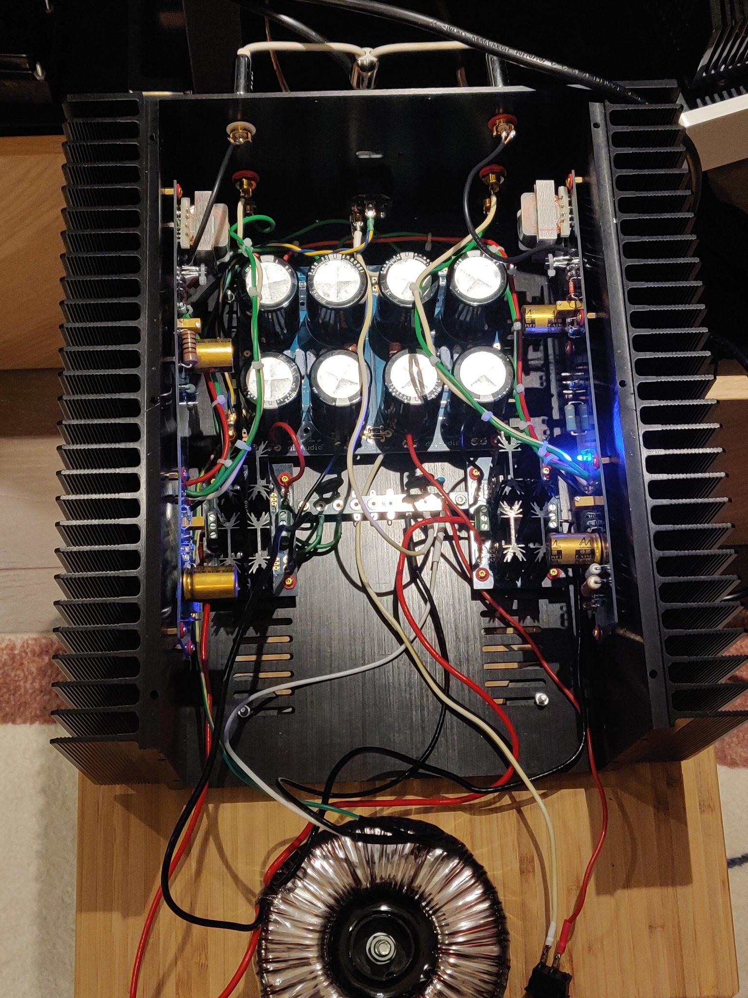

Hi everyone and thank you all for getting back to me with advice.
First let me state that the amp was built religiously following the values indicated in the build guide. I got JFETs, MOSFETs, Zeners and boards from the DIY Audio shop and followed the schematics as closely as I can. Only difference is that having only one set of primary wires on the 400VA transformer, I connected the single CL60 in series (running on 230V here). It was advised to me on this thread last week.
Now to be honest I feel extra shameful with regards to how things went after my post yesterday. As I was taking the chassis and boards apart for proper inspection, a stray screw fell out from under the the filtering board. I think I've found the root of my short...
Unfortunately I don't have either variac or dim bulb tester. All components and all connections showing no sign of damage whatsoever, I chose to put the unloaded PSU back together as orderly as possible (as seen on attached messy picture, chassis is too small). I powered it and voltages were the same as they'd been before the incident. Only changes were:
That's when things went south. After powering off I prepared to connect the second amp board to check it as well, and touched the IEC socket with the pliers I was holding. It was late, and being a tired and forgetful idiot I had not removed the power cord. I got my pliers a big spark that blew my spare fuse. Now waiting for the ones I ordered to arrive and once again connect and test things one by one, in a more careful way this time.

Well, I don't think you're screwed yet. Get that new fuse in there and see what happens. Maybe disconnect the channel again since you have the screw terminals. I think it is supposed to take a while for the bleed resistor to drain the caps without the channels as a load on the power supply.

My F6 lives! after getting my new fuse in, putting things back together, and testing, the amp is back to normal and sounding great. I love this first diy amp, and enjoyed building it so much I am already planning for a pair of M2 monoblocks

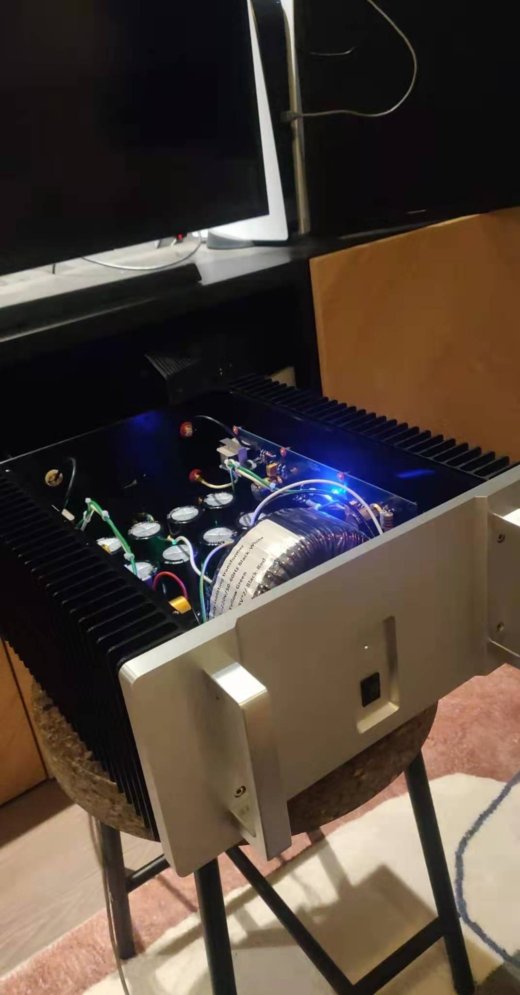

Quick question regarding amp layout:
as you may see on the attached picture, my chassis is small and there's not much space in between the different elements. Fortunately it is completely silent on my 96Db speaker. My question is: although it is silent, can the proximity between the toroid and the Jensens still affect sound quality? Or as long as it's silent, it means it's not interfering in the signal?

As long as it is silent, you are good to go. The Jensen transformers seem to be less susceptible to interference.
Congratulations and enjoy!Quick question regarding amp layout:
The way you have them set up, will not affect sound quality. You've got them as far apart as they can be without going to a separate PS chassis.
