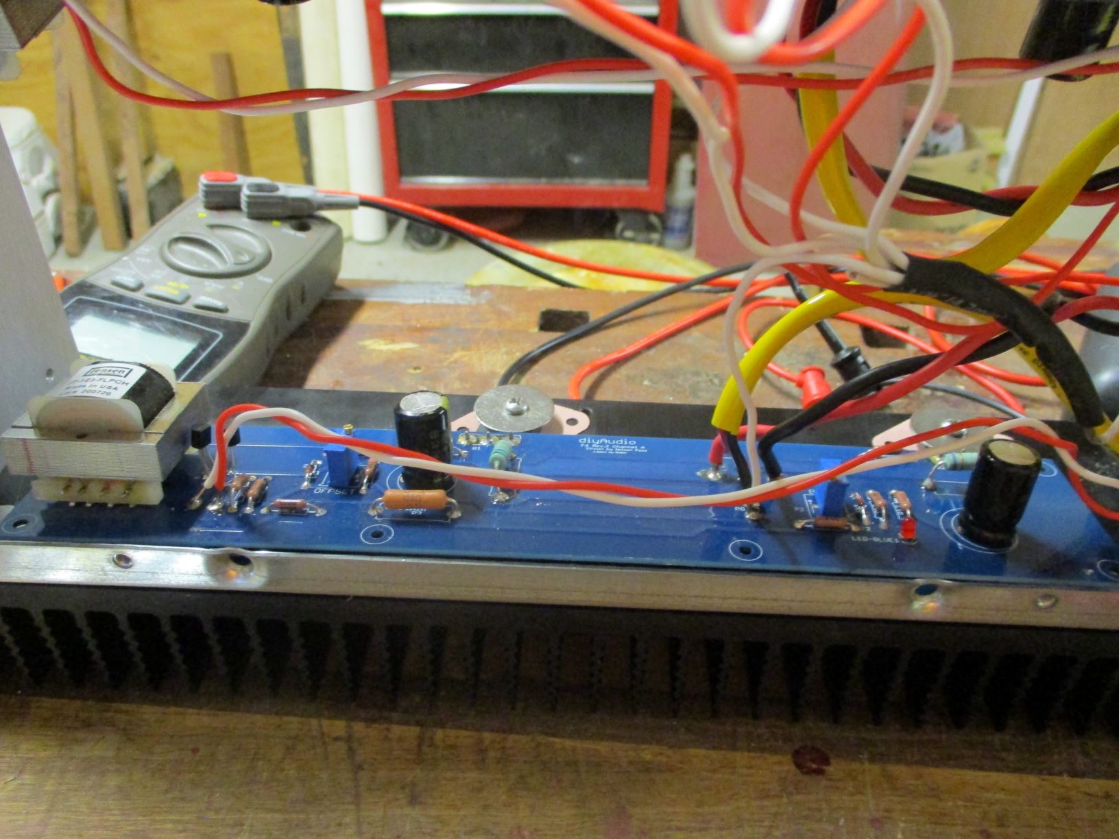

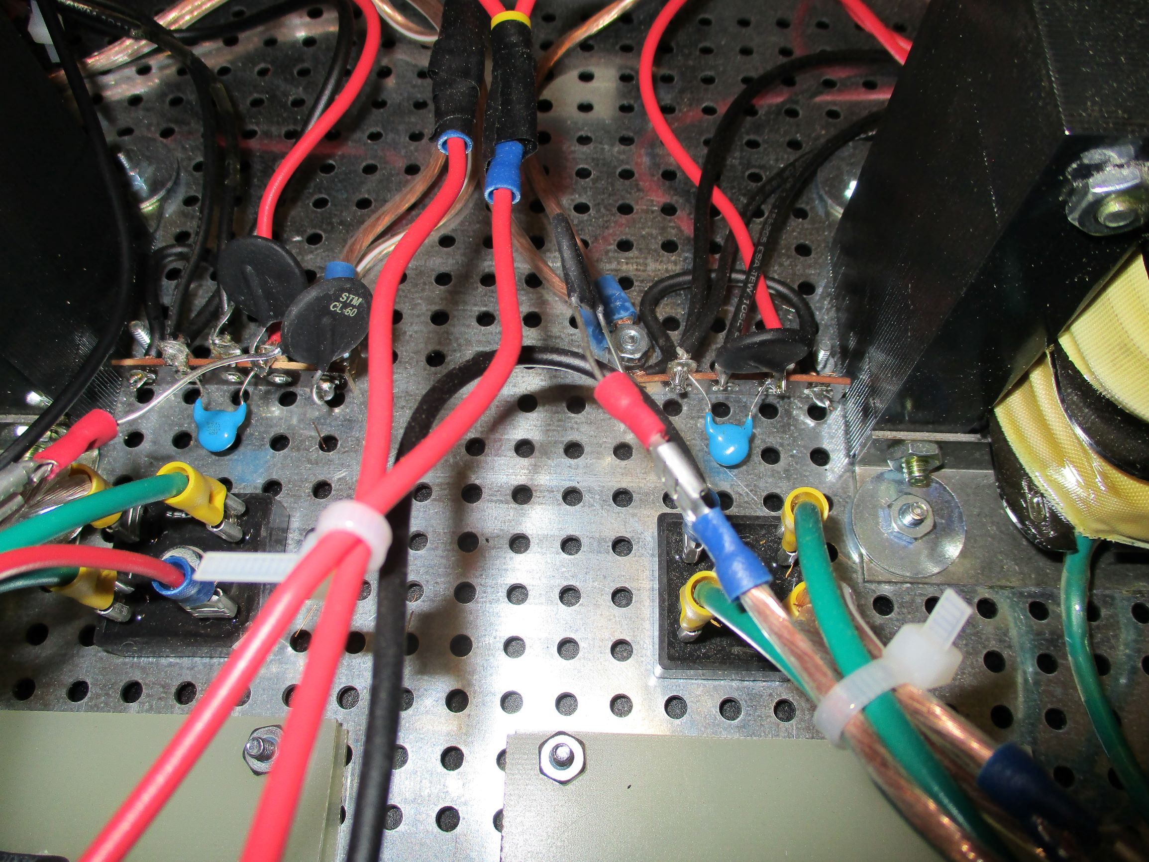

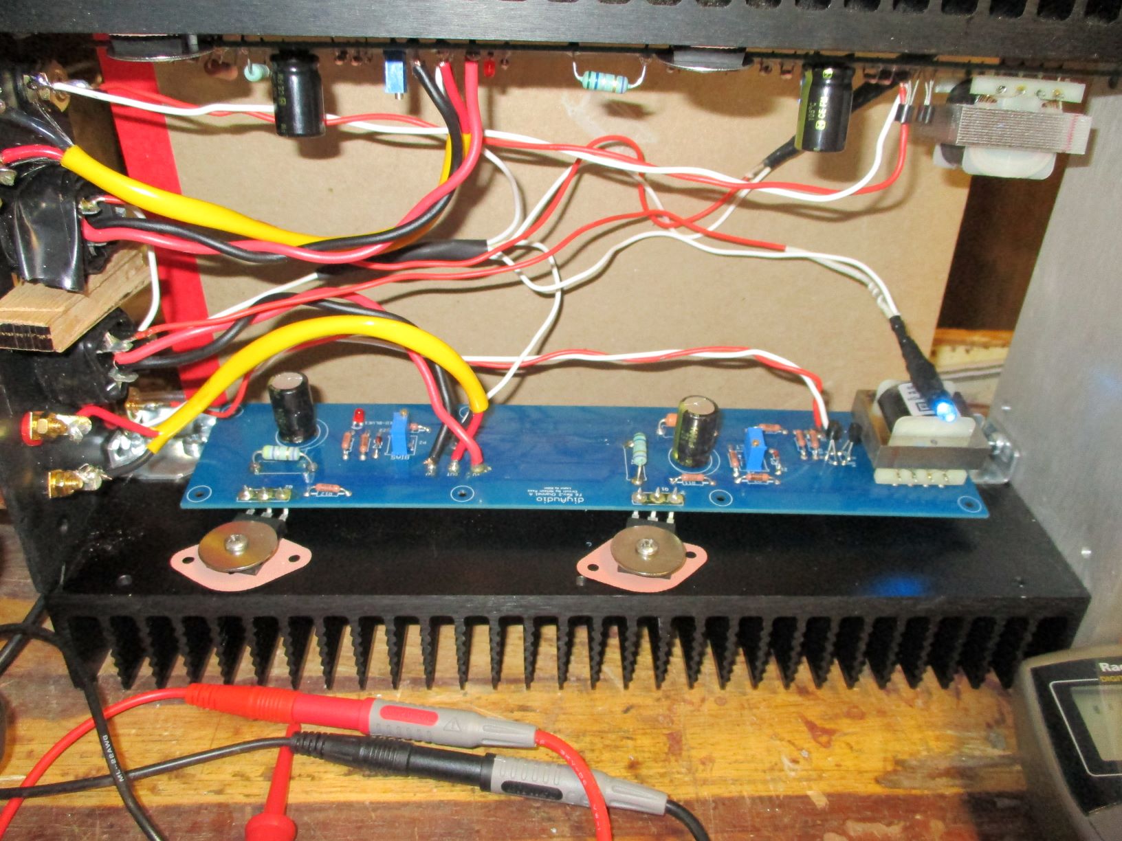

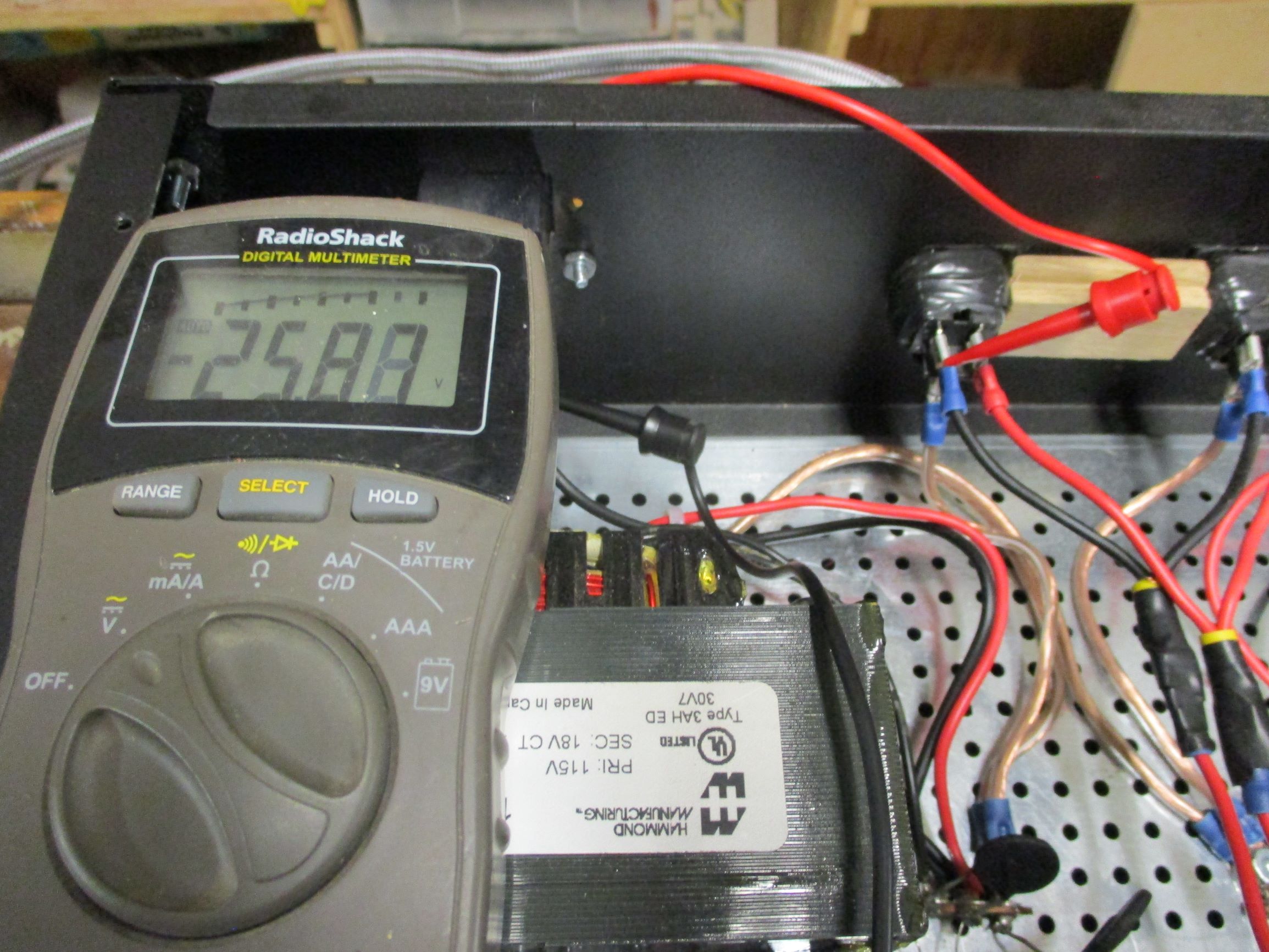

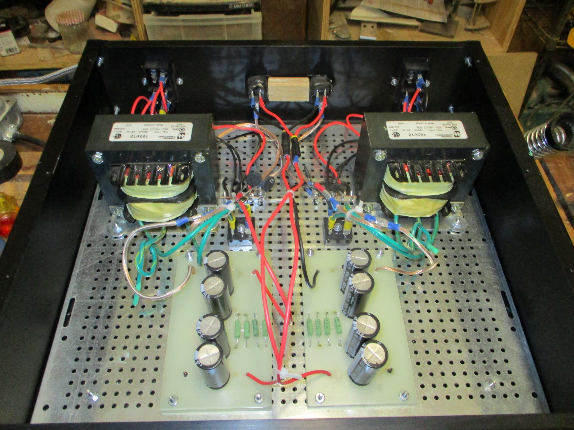

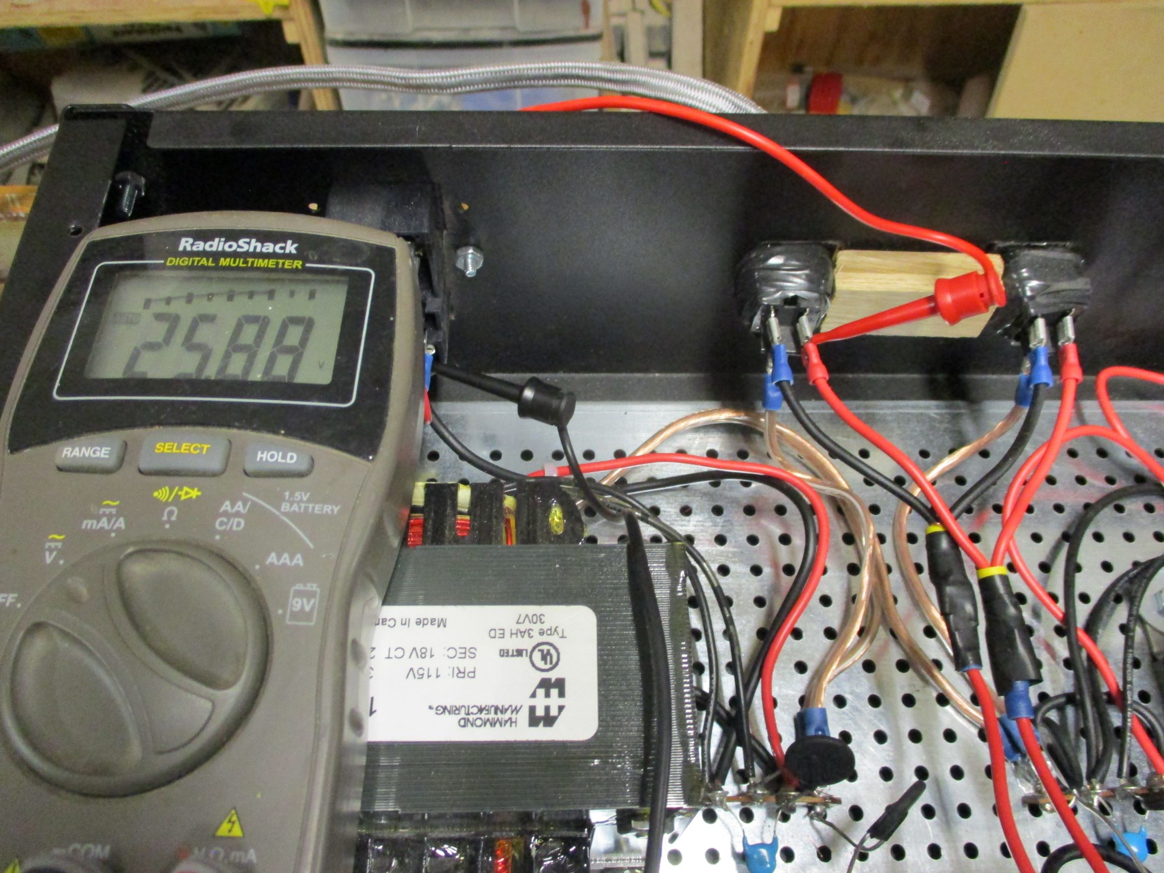

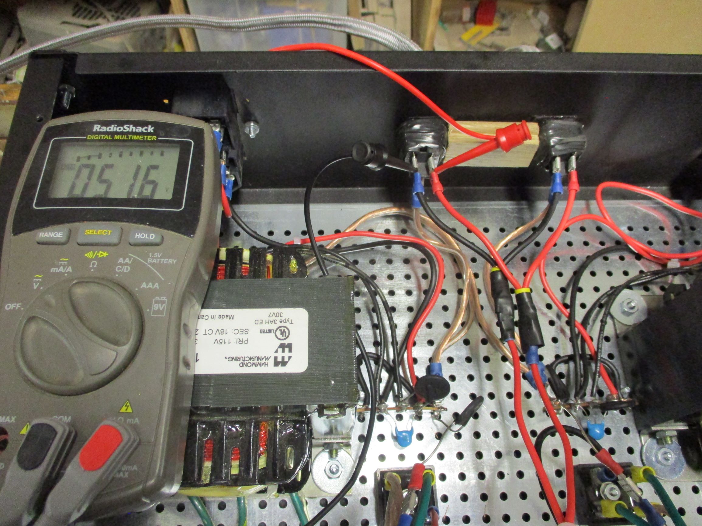

Thank you for the pointers. I am attaching pictures of my powersupply. Note that I am using two Hammond transformers as I could not source the nice toroidals everyone here seems to be using. See the attached link here for pix.Facebook
Also, I checked to see that none of the MOSFETs were grounded . . .check.
Voltage at Z1 = 4.45V
Voltage at Z2 = 5.9V
But the transistors for Q3 and Q4 are both LSK170s!! I think I found the problem. . . . and this is for the channel that could not get the offset to 0.
Trouble shooting F6 bias/offset . . . powersupply pix first
Anand:
Okay . . . perhaps this will work better. I could not source the nice toroidal transformers that other builders have been using, so I opted for two Hammond trannys. The first picture shows the entire powersupply in its own separate chassis. On the left we have the side that produces +26 VDC and on the right side the circuit that produces -26 VDC. Each side has its own thermistor/cap elements to deal with the soft start on the primary side of the transformer. Pix are shown. Also shown is the voltage on the output connections, with 25.88 VDC on the right side of the connector, and -25.88 VDC on the left side of the connector, for a total voltage difference of 51.6 VDC.
At least ONE of my problems is that the JFETS I used were ONLY the 2SK170 types. I ordered a new matched set of 2SK170/2SJ74 quads for the store. As soon as I get those in they will be installed, and we will see where we go from there.
I so appreciate your help so far!!
rolf

Rolf,
I always like to see different implementations of Pass builds. Nice work. The toroid transformers most use here are from Antek. Here is an example for your future builds:
AS-3218 - 300VA 18V Transformer - AnTek Products Corp
Your power supply DC output voltages look great. The chassis ground appears visible to my eyes. What value are each of your PS capacitors? 15,000uf? You want roughly 60,000uf/rail in a CRC supply as I am assume you have done. It's not a hard rule, but you do want ripple to be low to minimize PS induced hum.
Yes, you will have to address your Q3/Q4 issue before we can continue. I figure your high offset will resolve once Q3 is a 2SK170 and Q4 is a 2SJ74.
Best,
Anand.

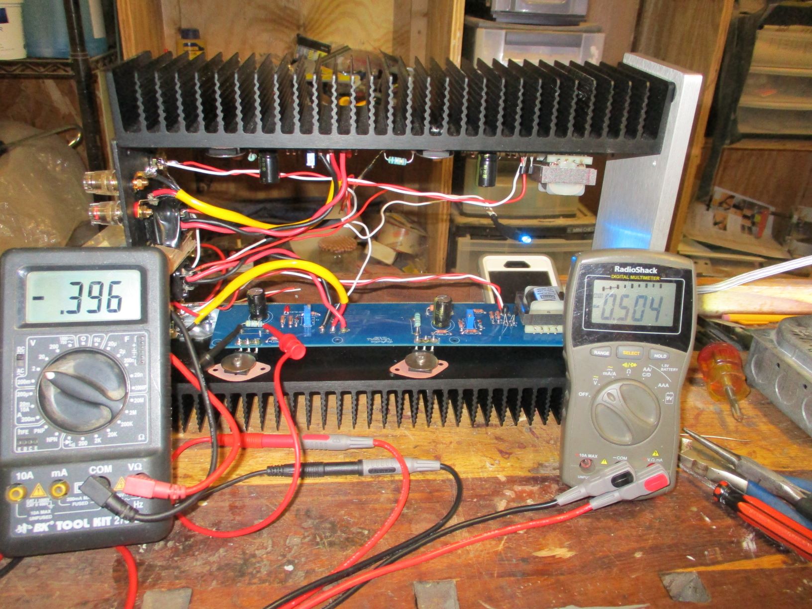

Hi Anand:
I received my new JFETs and installed the Q3/2SK170 and Q4/2SJ74 as my prior JFET installation was incorrect (just used 2SK170s). I still have the same issue in being able to set the bias but not the offset. I have enclosed pictures of this particular problematic channel. (The other channel has issues as well, but we will deal with that after this channel is working properly). Also, I took the liberty of measuring all the voltages at each resistor lead relative to ground, after the temperature of the amplifier stabilized and the bias remained at 0.5V.
all measurements in volts unless otherwise noted:
R1 -0.44, 0.157
R2 -21.7, -22.2
R3 -0.44, -0.037
R4 -0.038, 0.0 mV
R5 0.4 mV, 0.4 mV
R6 0.4 mV, 0.0 mV
R7 4.4, 22.0
R8 4.4, 4.4
R9 0.0 mV, -16.1
R10 -17.4, -17.3
R11 4.4, 4.4
R12 -17.3, -17.3
R13 -22.1, -22.1
Z1 4.4, 0 . . . across Z1 4.4V
Z2 -22.1, -16.1 . . . across Z2 5.9V
Q1 voltages at each terminal relative to ground: 0.16, 22.2, 4.4
Q2 voltages at each terminal relative to ground: -21.7, -0.45, -17.4
Thank you so much for your trouble shooting help so far!
rolf
