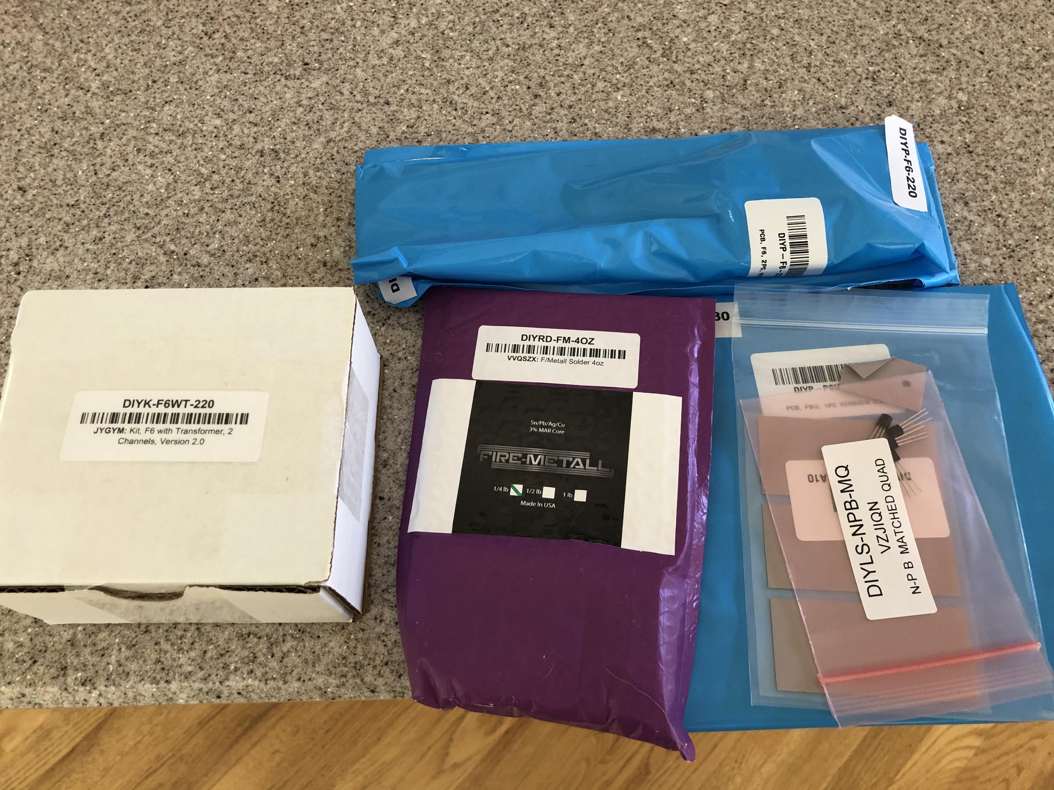

Check over your shoulder. I am on your heels. Must still get my speaker connectors. Drilled and tapped my heatsinks yesterday. Building in 4U/400 case cause it gets hot here. PSU and PCBs are done. Wiring next.
