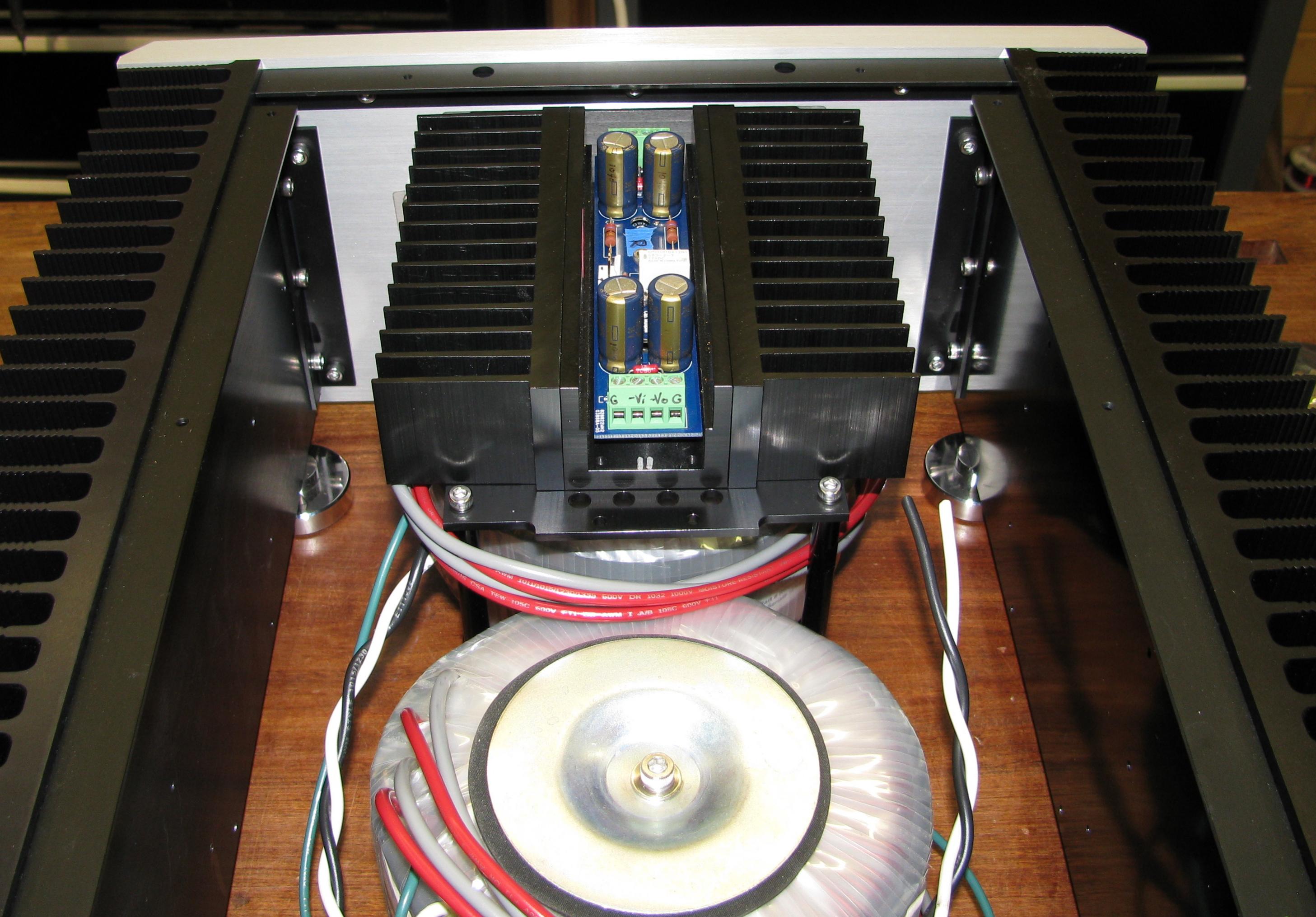

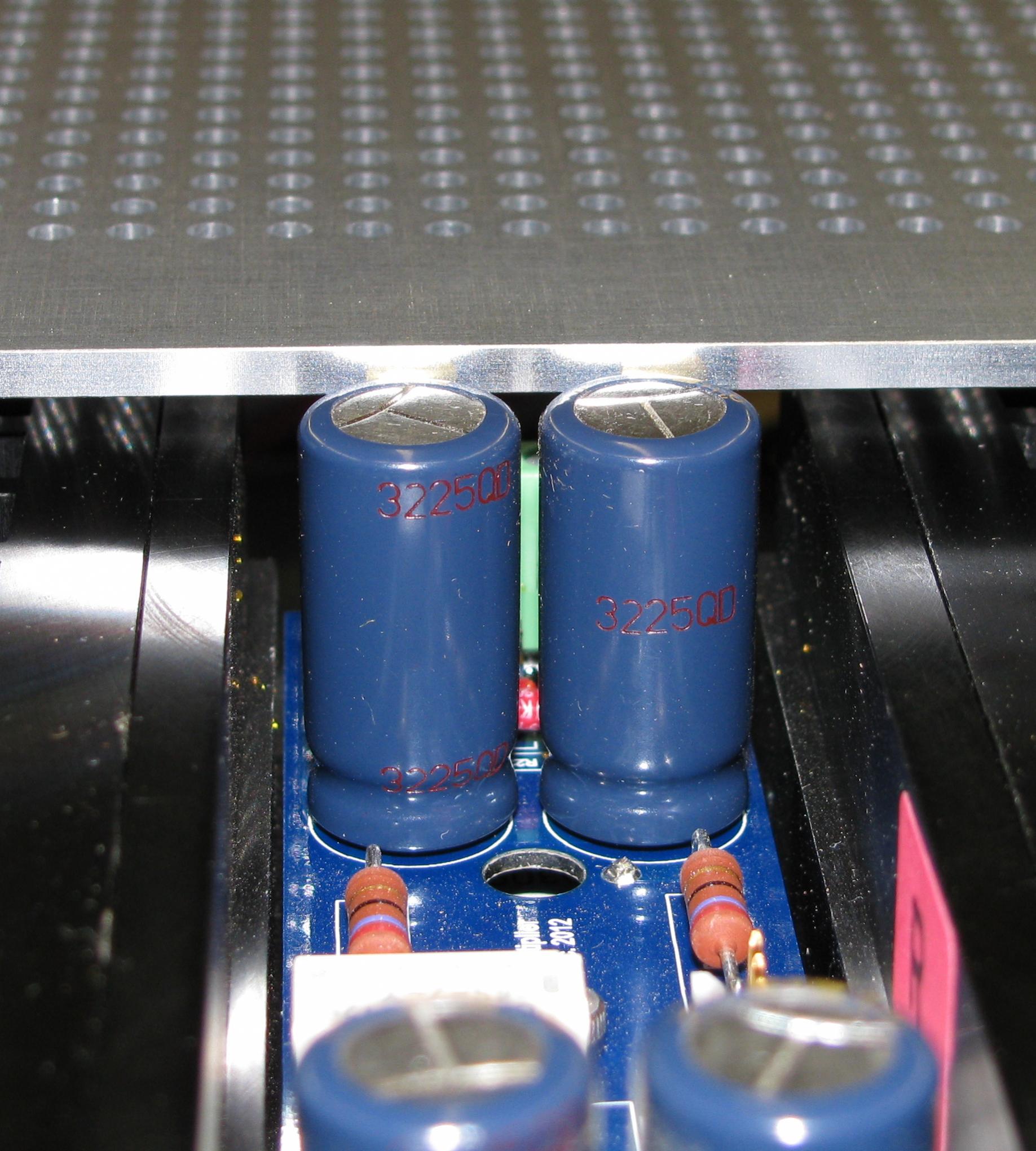

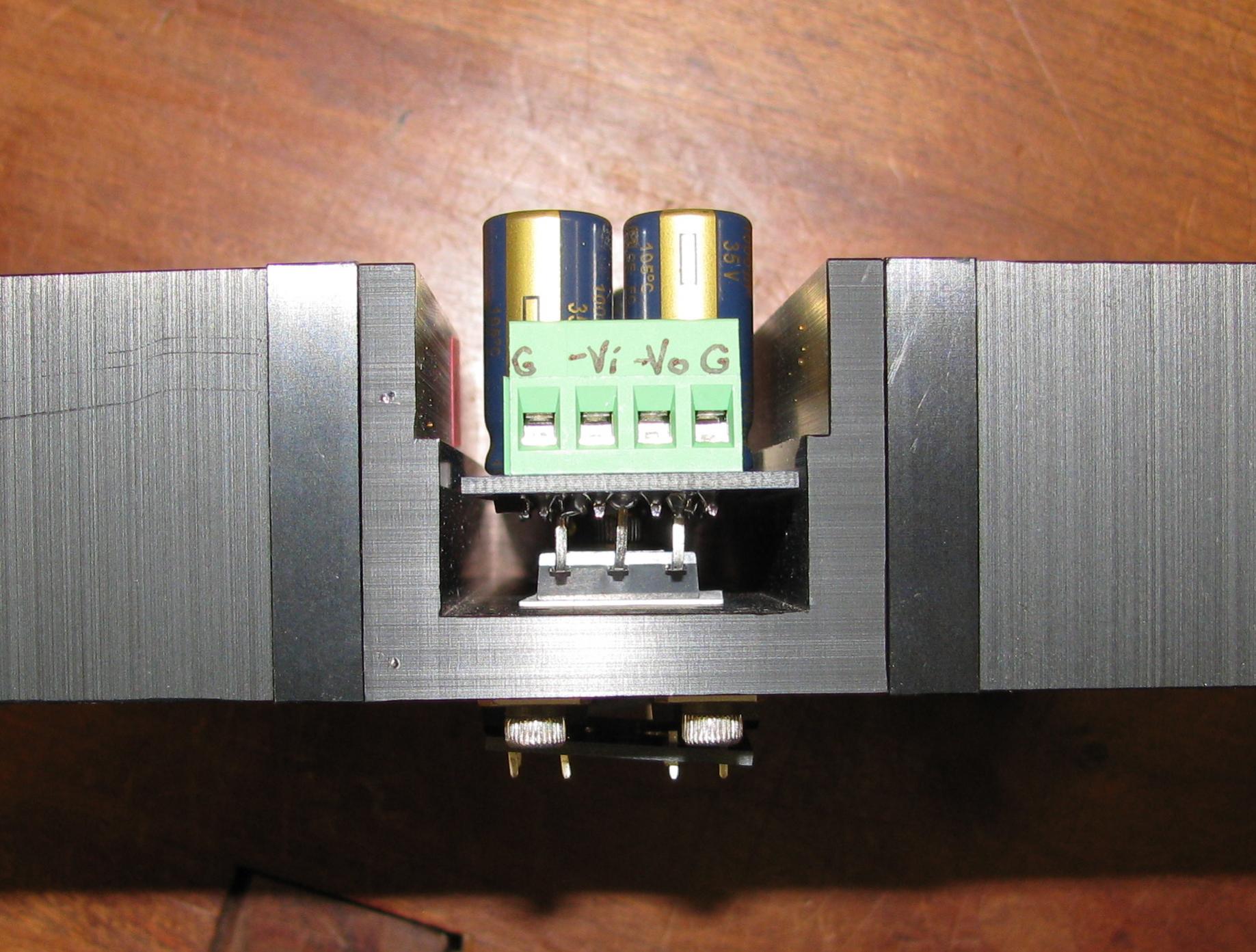

As I have been working on my power supply and deciding on how best to wire things up, I noted a couple problems.
First, there are jumpers that I almost missed on the capacitor doubler boards under C2 and C22.
Second, with the 25mm tall 1000uf caps called out for C1,2,21,22 on the boards and using 10mm tall standoffs supporting the boards on the heatsinks, there is not enough clearance to close the top of the amps, even with the cradle in the down (float) position. It would not be possible to raise the cradle to the shipping position.
I looked at using a 5mm tall standoff for the board on the heatsink, but that puts the board right down on the mosfets and allows leads from other components to stick into the mosfets.
Another option was to shorten the vertical posts from the cradle to the heatsinks about 5mm. Certainly can do that, but might be tough for others with no metalworking equipment, taps, etc.
Another option obviously is using 20mm tall 1000uf 35v caps.
Digikey has the following 105 degree C caps:
493-1322-nd nichicon VZ 1000hr / 105 degree C. Ripple current 810mA
1189-1295-nd Rubycon YXJ 10,000hr / 105 degree C. Ripple current 1.43A
Panasonic caps are all 85 degree C in the 20mm height to fit the board.
I will likely go the easy route and get new caps, unless there is a compelling reason to stay with the Panasonic caps.
Matt
My fault again. I used 1000uF 25V FC myself which would fit (20mm height).
But I do not want to risk the somewhat marginal voltage with public project.
Your suggestion is good. Use Nichicon UVZ1V102MHD as you proposed.
On top of that I used 8mm standoff's, just as info.
We'll update the BoM later when WK is back in action.
Not sure when. 🙁
Apologies for the inconvenience,
Patrick
thanks
Thanks, EUVL, will go with the Nichicons and recheck 8 vs. 10mm standoff.
Matt

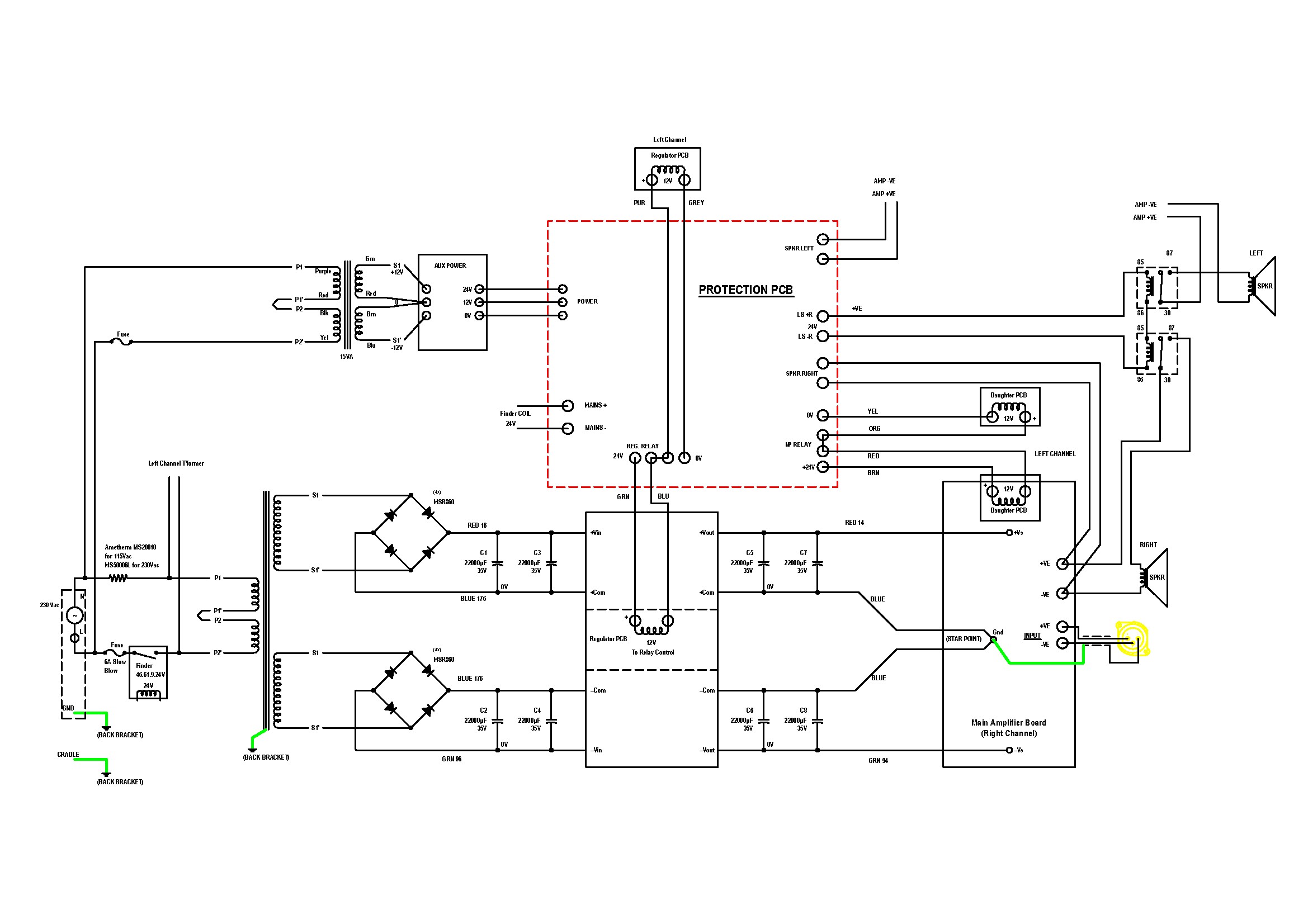

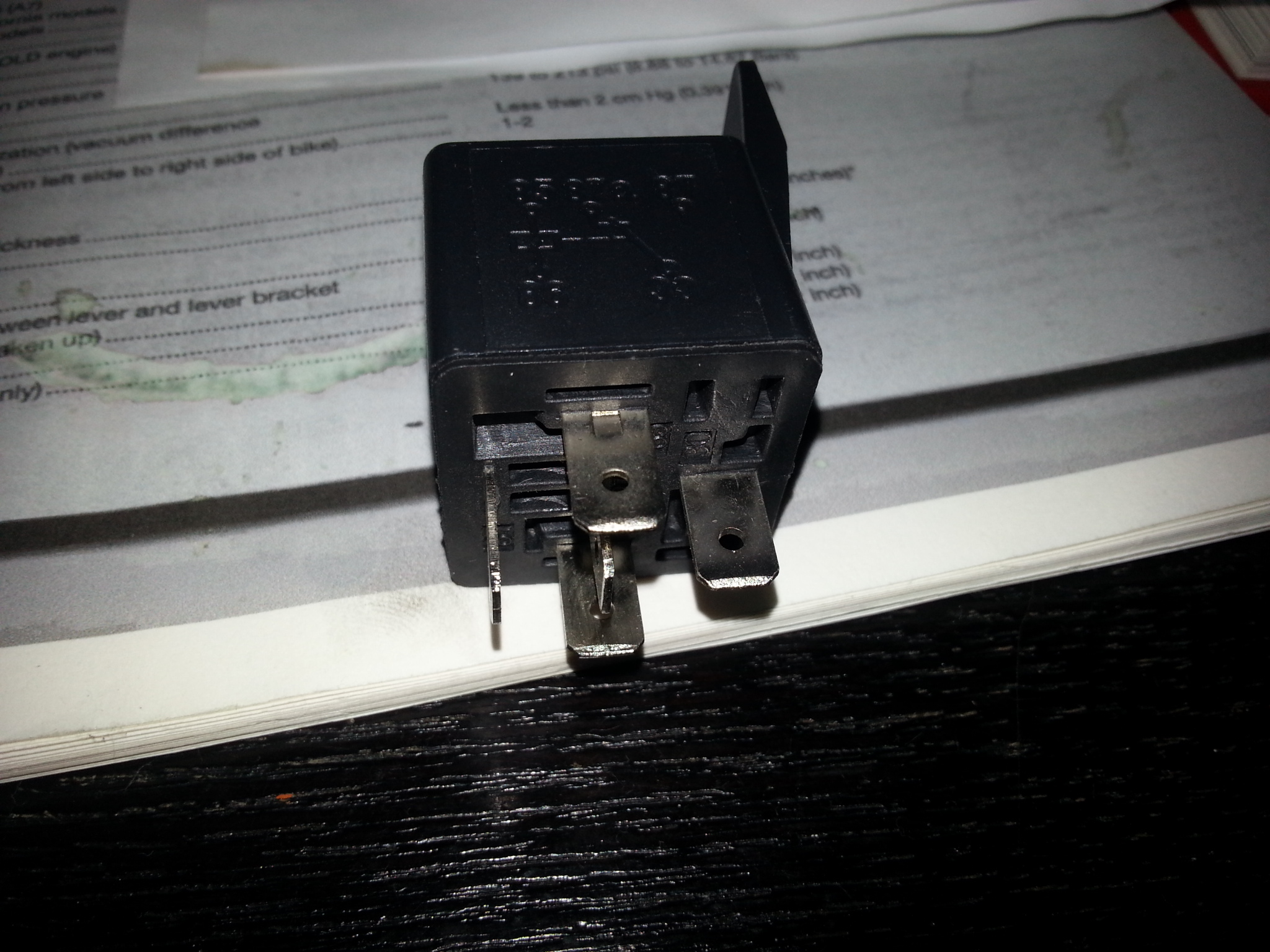

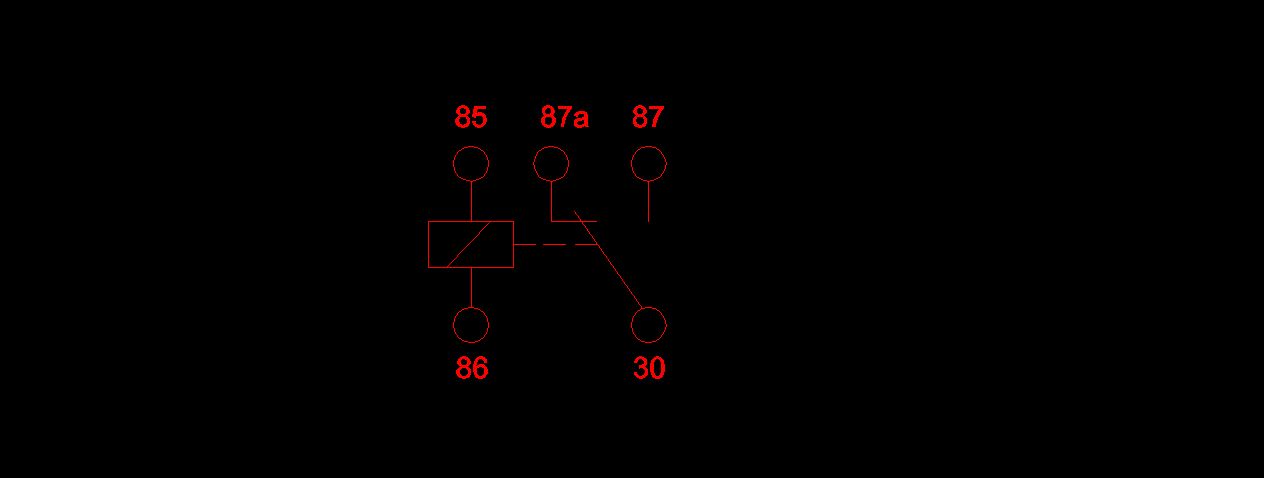

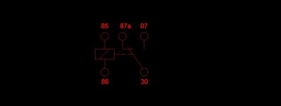

Few questions :
1) will this relay work as well in the protection circuit?
2) the protection board just need a couple of resistors change as in Patrick's write-up and we don't have to cut the board as in what Nic has done. Is this correct?
