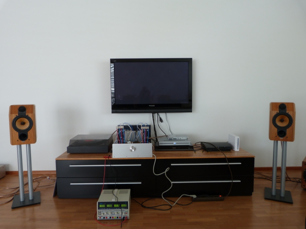

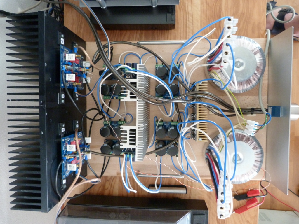

F5X proto II, first living room test
After building a first F5 proto (lab power supply, 1 amplifier board, 2 x single ended configuration) in winter 2011/2012 and subsequent listening we where enthousisatic enough to sign up for the F5X batch 2 GB. However, we dediceded not to go straight for the final version with everything nicely intergrated in the housing, but taking an intermediate step by building a second proto as breadboard version.
Patrick was kindly supporting our plan by making some sample boards of the batch 2 GB available to us upfront for testing.
So we build 2 x fully decoupled mono blocks, balanced output, floating X, with the same supply and power amp boards and devices that will later go into the cases. Since we were not patient enough to wait any further with the listening tests the protection board was not intergrated yet. But this has to follow next.
Last monday all pre-tests where completed and we moved the amp to the living room for a first listening test (two people were needed for lifting )
Source: Linn Sneaky, single ended output,
Transducers: B&W CDM1 SE
Well what should I say? Unbelievable!
Pure music, an enourmous level of detail that I have never recognized before, rigid sound stage, in no case any sign of uncertainty.
Although we did not do an one by one comparison with proto 1 we all agreed that proto 2 has substantially improved w.r.t. proto 1.
So fully separated supplies (instead of one common one) and balanced amplifier operation (instead of single ended) makes a clear difference.
Well that´s obvious most of the DIYers would say. Frankly, I did not dare to hope for such a clear difference. But now we have evidence that investiments in component cost and power dissipation pays back.
This is more than enough motivation to keep the speed up even during summer time. 🙂
Markus & The Ulm 5FX Build Team

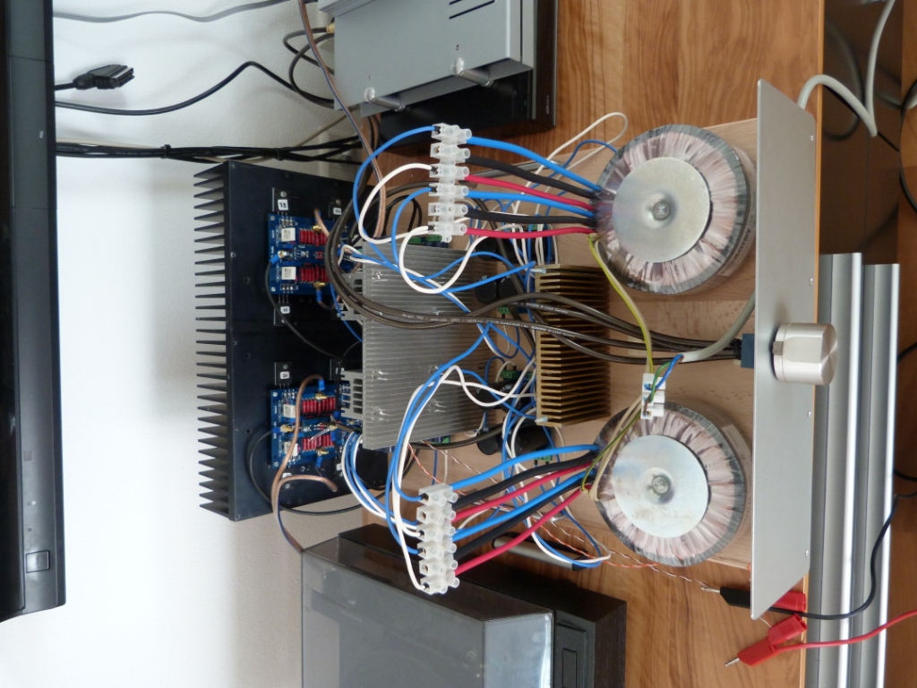

Power supply wiring questions
I was wondering if anyone has photos of how they have wired their power supply in their completed amplifier?
I am mostly wondering about wire runs from the back panel to the two power transformers, and from the regulators to the cap banks.
I certainly have an idea how I will do my amps, but always like to check to see how everyone else has theirs done.
