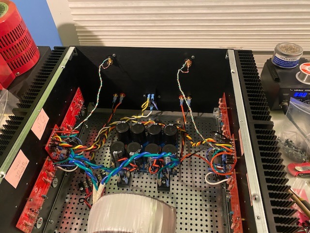

Hi-I finished my F5T. With 28V DC I have about 65W into 6 Ohm on my monoblocks. Please see attached pictures.
Great help from 6L6!!!! Thank you 6L6 a lot.
Still waiting for the front “half-moon shape” brass pieces, but it is cosmetics…
It is sounding very good to me. I tried to adjust P3 to min distortion and I used some local audio repair shop since I do not have distortion or spectrum analyzer.
My Bias is set to 1A (470mV) and MOSFETs are Toshiba 2SJ201 / 2SK1530.

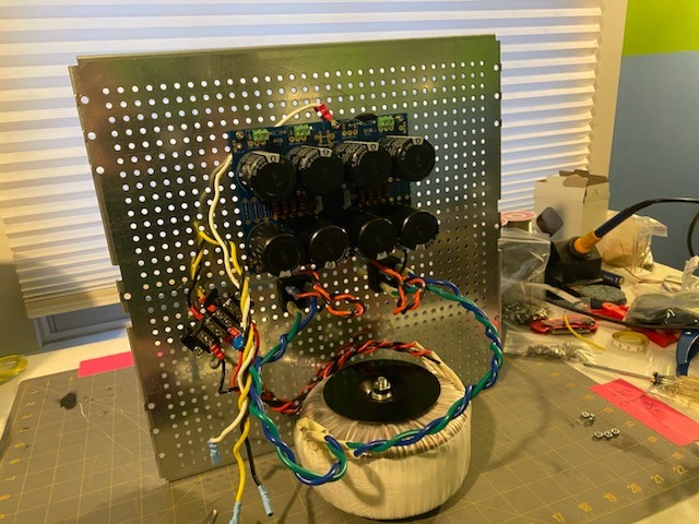

So it’s been about a year since I finished my monoblock f5tv3 (Not balanced). They are the only amps I have been using, have performed absolutely flawlessly, and personally I Think they are the best amps you can build in the diy Pass arsenal (I built/own a few). I use a 625va 35v transformer with 63v 18k caps using diy audio store power pcb. My rail voltage is about 47v with about 350mv across source resistors. heat sinks about 52deg. I would like to squeeze out some more wattage. I read 6L6’s note where he said that Nelson swayed him against 65v rails but I’m not going that high and that was very early in thread before idea of no-diodes was mentioned.(I do not use the diodes). i would like to ask the collective intelligentsia two questions. Can I simply replace the transformer with 1000va 40v secondary for an extra 40-50w power with no other hardware changes? i would use fans to help compensate for reduced bias to try and keep it close to where it is now. I calculate the cascoded jfets would see about 18v with the existing 10k/4.75k resistors so don’t think anything needs to be adjusted here. The 63v power cap rating gets a bit close to calculated 56-57v rails that I should get with trafo change, but this should still be ok I think. Can this change be safely done? Second question is there has been some discussion of Antek not rating their trafos according to industry standards. Does this mean that for US 120v application the secondary voltage tends to run higher than stated or lower? Thank you all. Alex

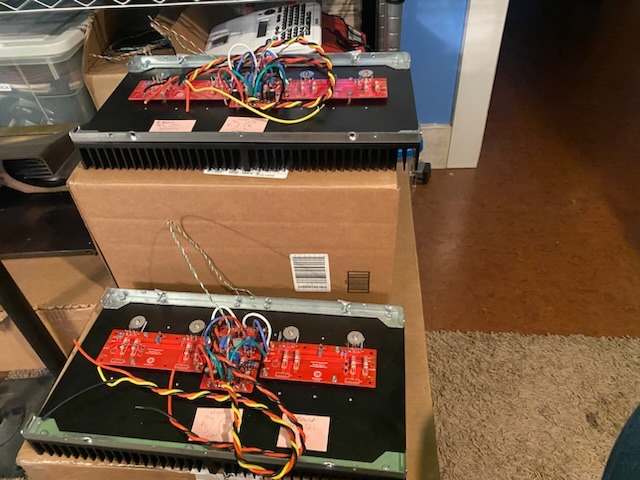

I biased up and welcomed a new F5Tubo V2 to the world this morning.
It took a long time to build, but I was pacing myself. A step here, a step there, order some overlooked parts, call it quits of an evening. It's not a complex build, but there's a lot to consider and reconsider and research from this thread as time has gone by, parts have changed, approaches have settled in, others have been there, done that. Thank goodness for the Search tool!
It's the usual configuration: 5U deluxe case, Antek 6224 transformer yielding ~35v rails, cascoded, no turbo diodes, and replacing R5, R6 1k with 2.2k resistors to help biasing.
I'll put the covers and feet on it to bring it downstairs and give it a few days in the main room, letting it burn in hear what it does. My initial listening in my home office / electronics assembly workshop this morning did show it to be more pronounced in the upper half, yet controlling the bass.
Until then, thanks for this build thread as a knowledge base of how to build it.

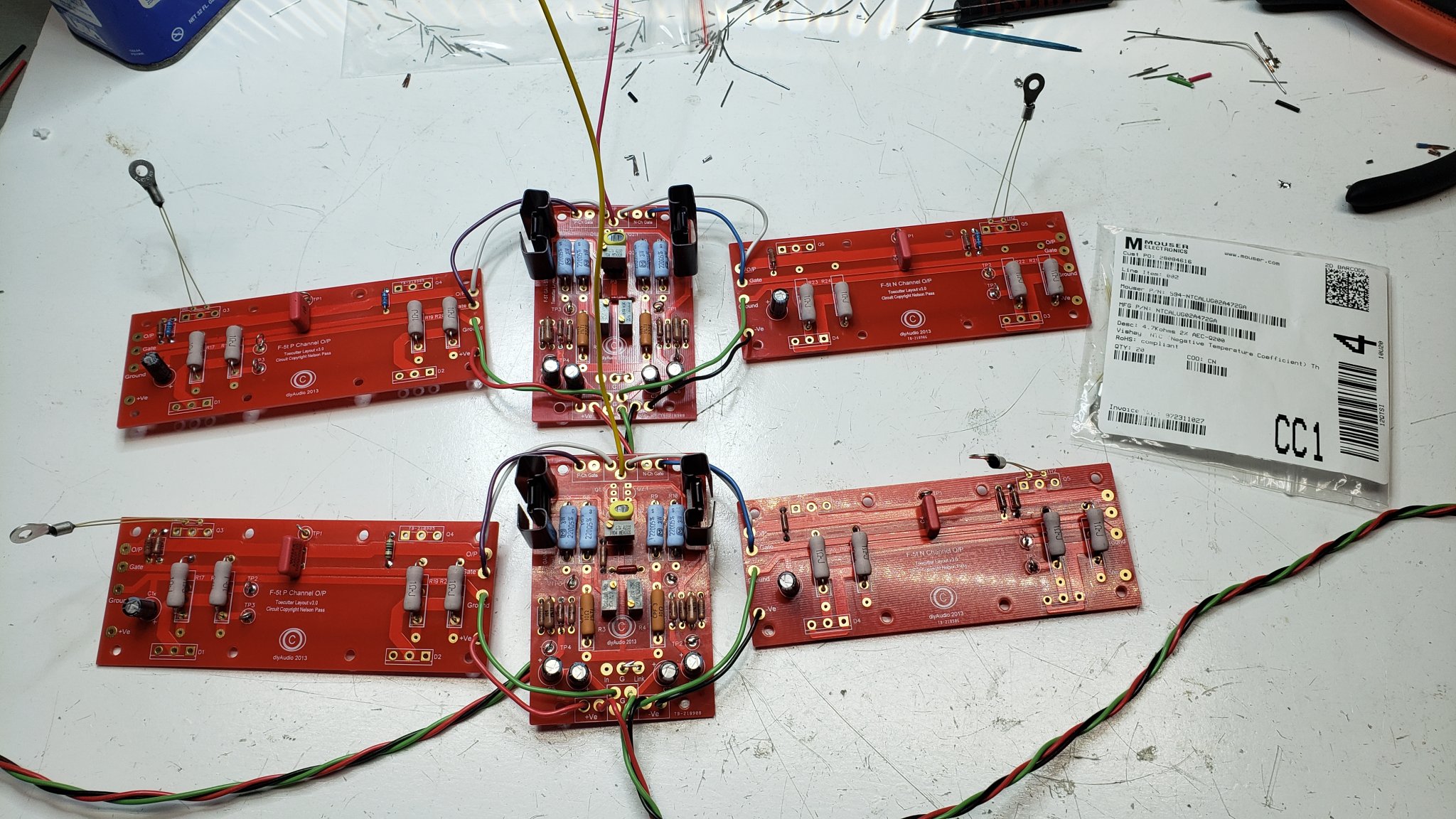

Boards are just about ready for installation. Note: P3 is in a socket Q1 and Q2 are wrapped in heat shrink for thermal bonding. The thermistor came from Mouser P/N 594NTCALUG02A472GA.

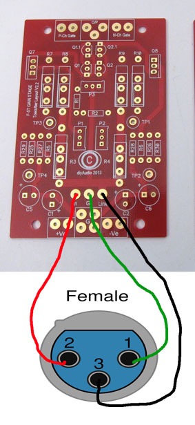

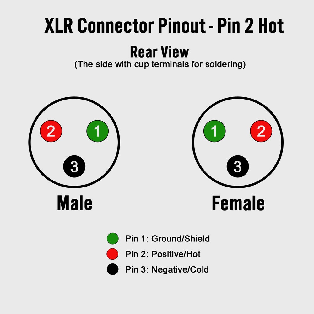

I can't understand what you mean,No, that is not correct.
Edited to add... assuming you are building a balanced amp and that the XLR is wired per the norm.
I use xlr inputs and wanted to know the sequence to follow in the pairings.
Pin 1 xlr is the ground
pin 2 xlr is the positive pole
pin 3 xlr is the negative pole.
On the gain stage board
In = positive pole
G = ground
Link = negative pole.
Is this correct?
