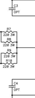

I was talking about C3, C4, (the ones that keep it from oscillating to death) on the mosfet boards. Always use. I will go back and edit that into my post for clarity.
C1, C2, on the FE board are just local PSU decoupling. So are C1x C2x.
Actually my question relates to the c1x/c2x on the output boards. I see the caps on the fe board and on schematic and those make sense to me.it’s the ones on output boards that I simply cannot find on v3 schematic. I’ll look again. So for a 4pr device v3 monoblock, (2 n boards on one sink and 2 p boards on other sink), I should populate c1x and c2x on only one of the n boards and one of the p boards? Does it matter which board, ie, closer to fe or daisy chained one? Thank you both for helping me understand. Happy and healthy new year to all.
also, what cap value are c1x and c2x? i thought the 1000pf c3 and c4 were the anti-oscillation caps. thx

I thought (unless I am using the wrong schematic, so please forgive me) that C3 and C4 in the snip of the schematic below were for the oscillation. Listed as optional, but strongly recommended.

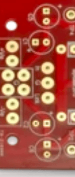

C3 and C4 are (I think) in line with the center of the N and P boards close to the TPs. I just can't see well enough on the pic to post it, nor do I have a board to trace.
C1 and C2 (as noted on the schematic in the first post and on the V3 boards) are here... along with their neighbors C5 and C6.

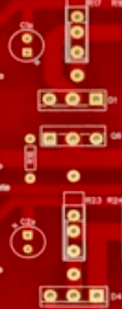

C1x and C2x are on the N and P boards here.

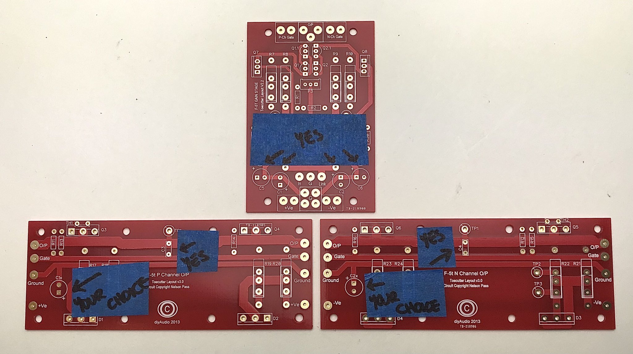

Everything for everyone, should be prefaced with a big ol' fat, I think. B/C I am not near a set of boards and don't have a decent display to work with at the moment.
Perhaps, @algg could post some pics that are much better than my attempted grabs.

Oh jeebuz, I really need to look things up before posting… My apologies…
On the Mosfet boards, the anti-oscillation caps are C3, C4. Always use.
C1x and C2x are repeats of C1 and C2. Look at the schematic, they are electrically in the same position as C1 and C2, but since the PCB is split into 3+ pieces, they are repeated on the mosfet boards. In my opinion C1x C2x are not needed, since they are on the mosfet boards, and C1 C2, on the front end board, is where they should be.

That's what I had thought, but really needed confirmation on. I could not see the back of the board in any pics to confirm if C1x and C2x were going to be electrically identical to C1 and C2. Also, thank you for the note of preference for placing them on the FE boards. Into the notes that thought goes.

Lol!! I love you guys! I chuckled when I scrolled down and saw the post-it notes on pcbs. Now you are talking at my level. Everything is very clear and i can’t thank you both enough. Can’t wait to start building. Thought I could get started over the holidays but dontcha know, holidays never work out the way you plan. Best,
