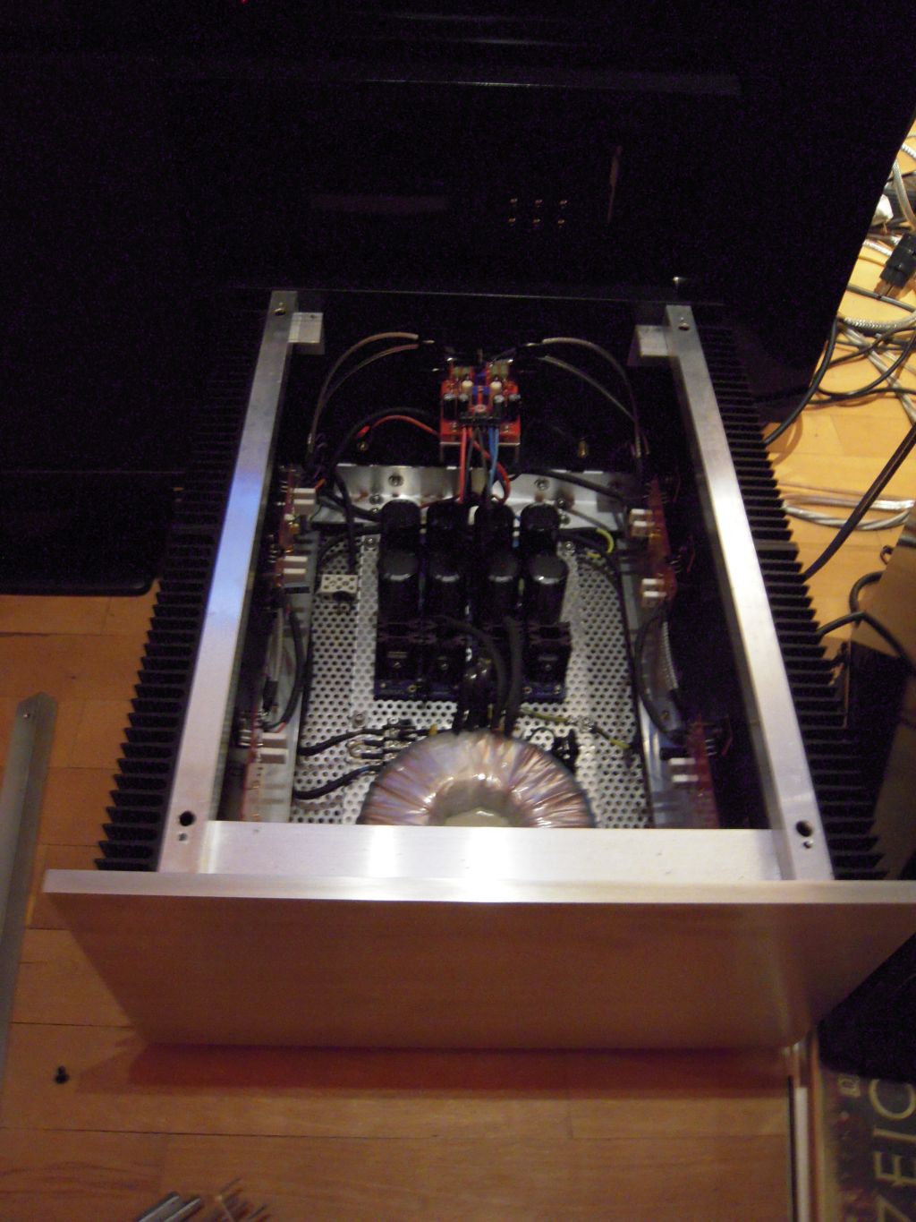

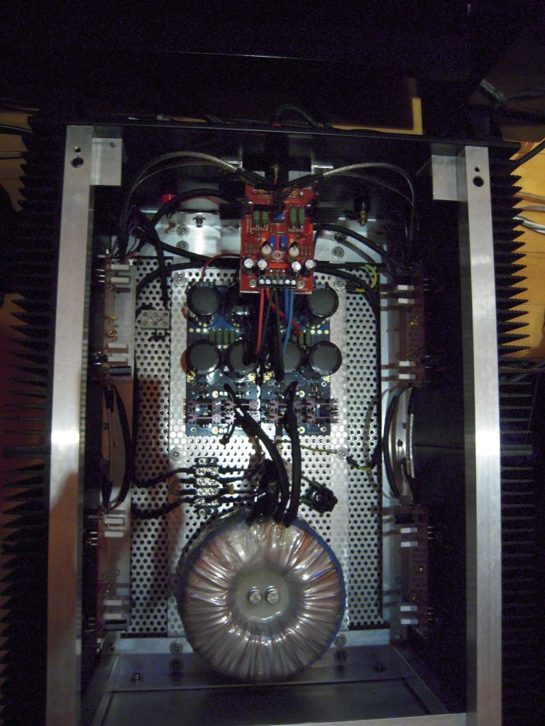

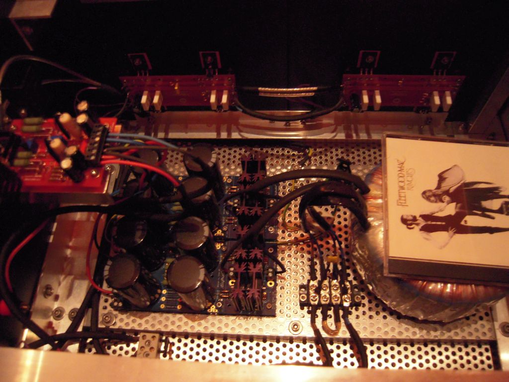

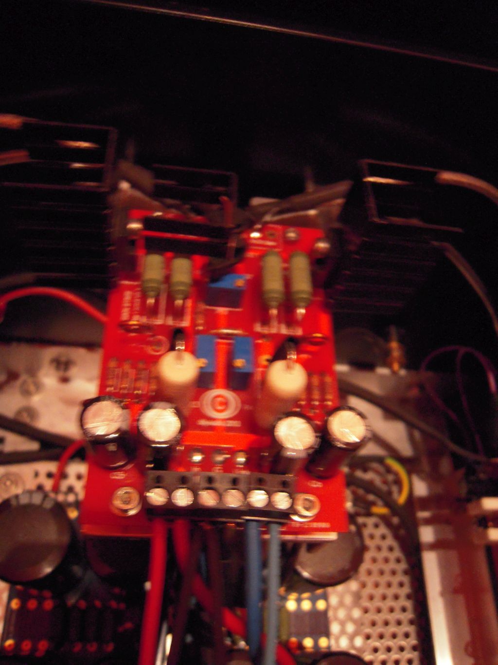

F5Turbo - Monoblocks
Hello F5T-builders,
a member asked me for some pics of my F5T-monoblocks. Although this is the
F5T build guide thread - some pics...
Sedlbauer toroids 1000 W, sec. 2x30V AC
railvoltages: +-42,7 V
50° - 55° C on the heatsinks
JFet -quartet (matched) + cascode -BJTs in the frontend
4 N-ch- and 4 P-ch-MosFets (matched) per monoblock
I've built these 'babies' a few years ago.... and I still like them a lot! 😉
Cheers
Dirk 😀
