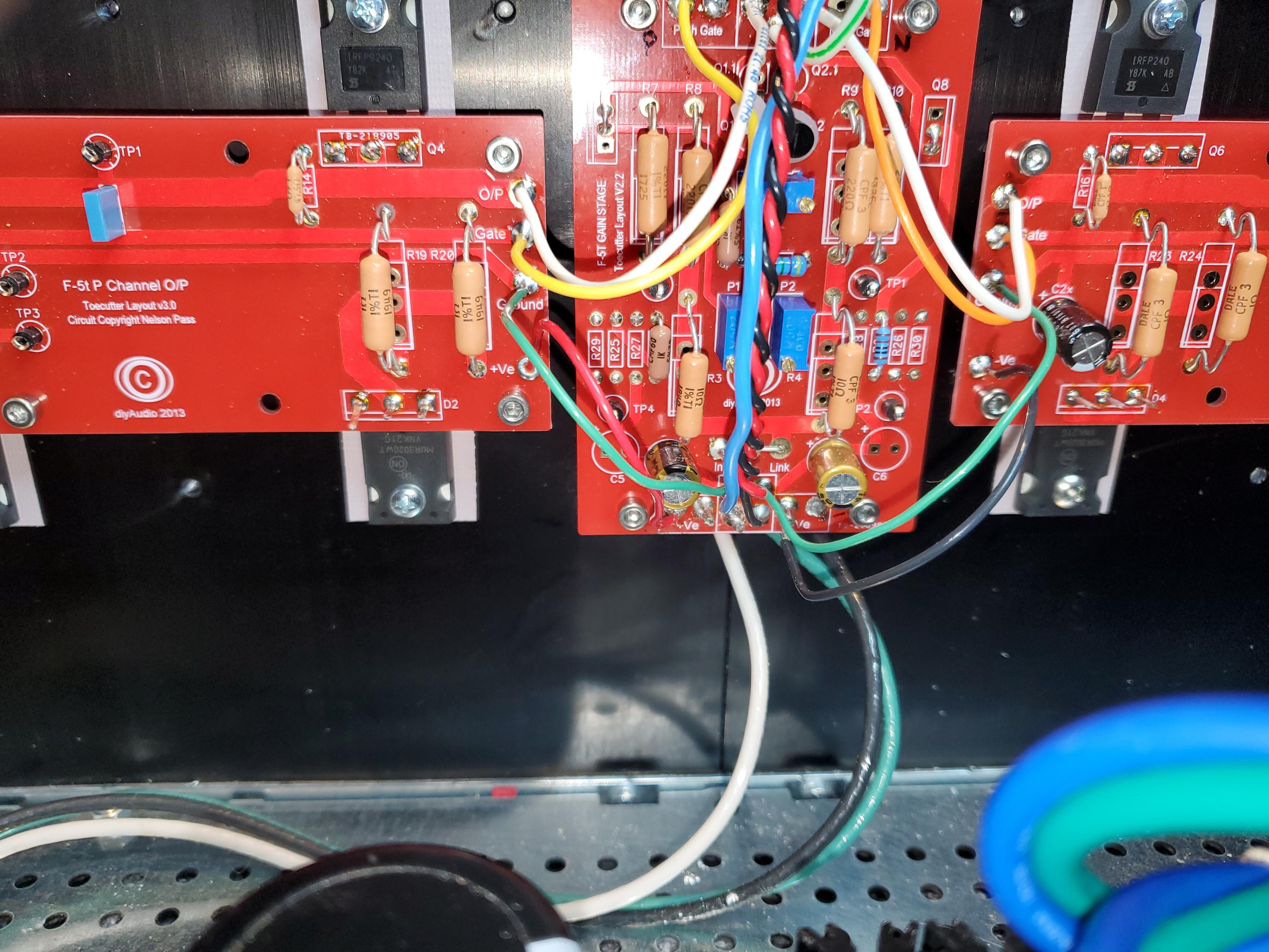

One channel has 35mv of dc offset (the one that i got some bias reaction) when the pots are zeroed.
Oh for sake of speculating the short was before it got to driver board so i tend to doubt it had any negative effect on boards (thinking a build error. At line voltage rails are + and - 33.55 +/- a couple of hundreths of a volt.
Like i mentioned earlier, i wasn't the original builder. That said, i notice something that might be at issue. On my front end boards, R25 and 26 are 1K (which matches value in F5T article , V2 schematic).
Reading this build thread, It is mentioned these should be 10K (which would match the schematic of the V3 shown at beginning of thread) . Based on location I'd guess this may be at the root of my problem. Any thoughts?

I read that wrong. They were R5 and R6 which are in fact 1k (which is correct) The other 6 resistors weren't installed 25,26,27,28, 29,30
So i went ahead and installed but at least on one channel no change as far as bias setting goes. (the one that did nothing).
Not cascoding, Don't need those resistors.
I can pull but still leaves me where i started. why i'm not able to bias. It'd be nice if there were a schematic marked up with voltages to see where i'm off and why.
Please measure the voltages across R3, R4, R5 and R6.
The voltages across R5 and R6 need to be 4-ish volts for biasing. If you can't
bias, it's possible because these voltages are too low. That can happen from
a combination of high Vgs output mosfets/ low Idss jfets. If this is what's happening,
increasing R5 and R6 should solve the problem. (You'll have to turn P1 and P2 back
down before powering up again so you don't accidentally start with too much current.)

Reading 0v on R3,4 one FE board
Reading 69mv and 2.9mv on other board
I turned down the pots to near 0 ohms after the no bias issue
R5,6 read zero like that

Don't change your R5 and R6.
Your R3/R4 voltage values suggest problems with your jfets.
Only the 69mV reading is good. The others basically mean your jfets are 'off', which
explains why you can't bias.
Can you please check your parts against the schematics to make sure you have
the correct parts installed.
Also, it may help others to spot potential problems if you can post photos of your pcb.

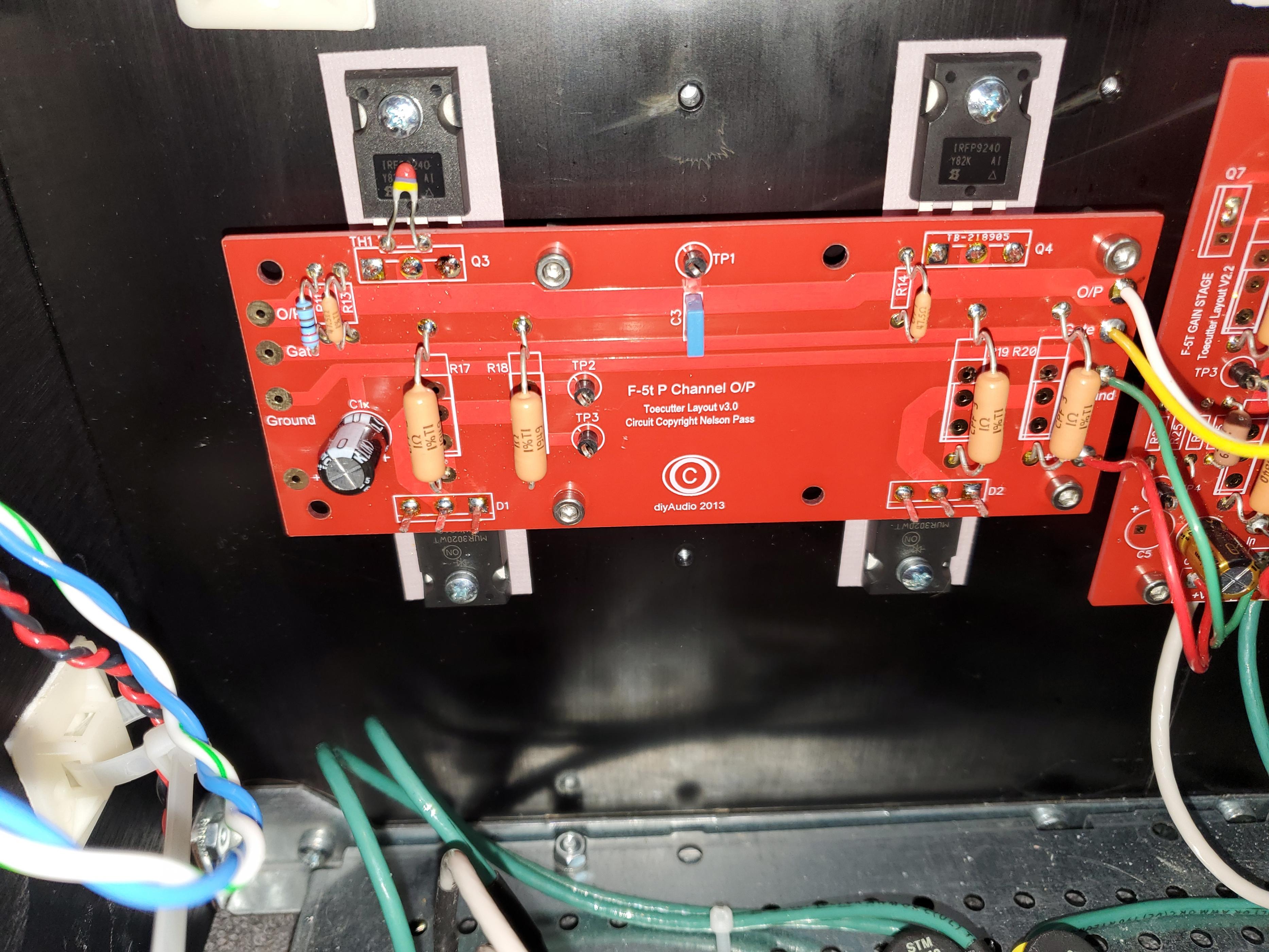

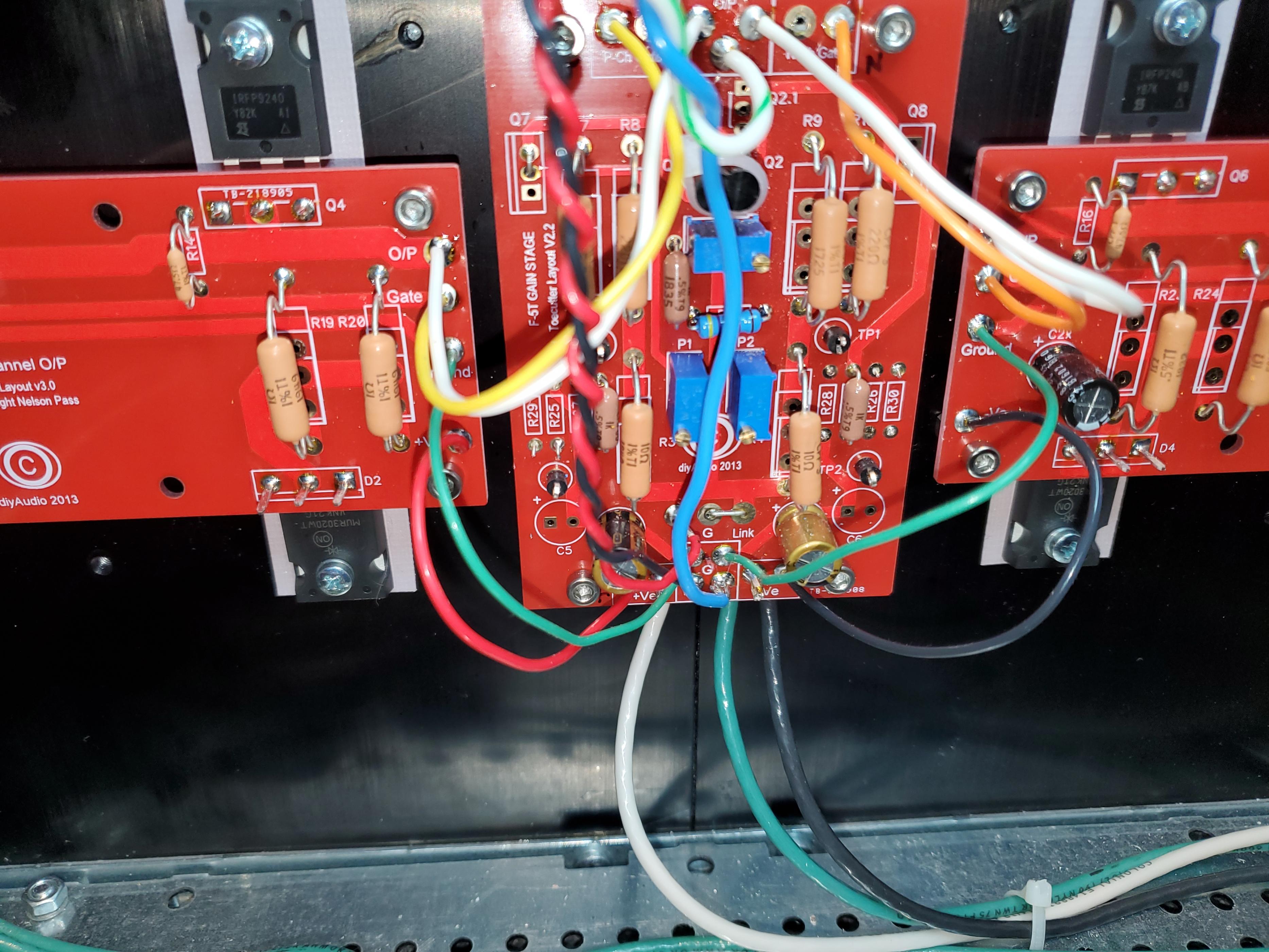

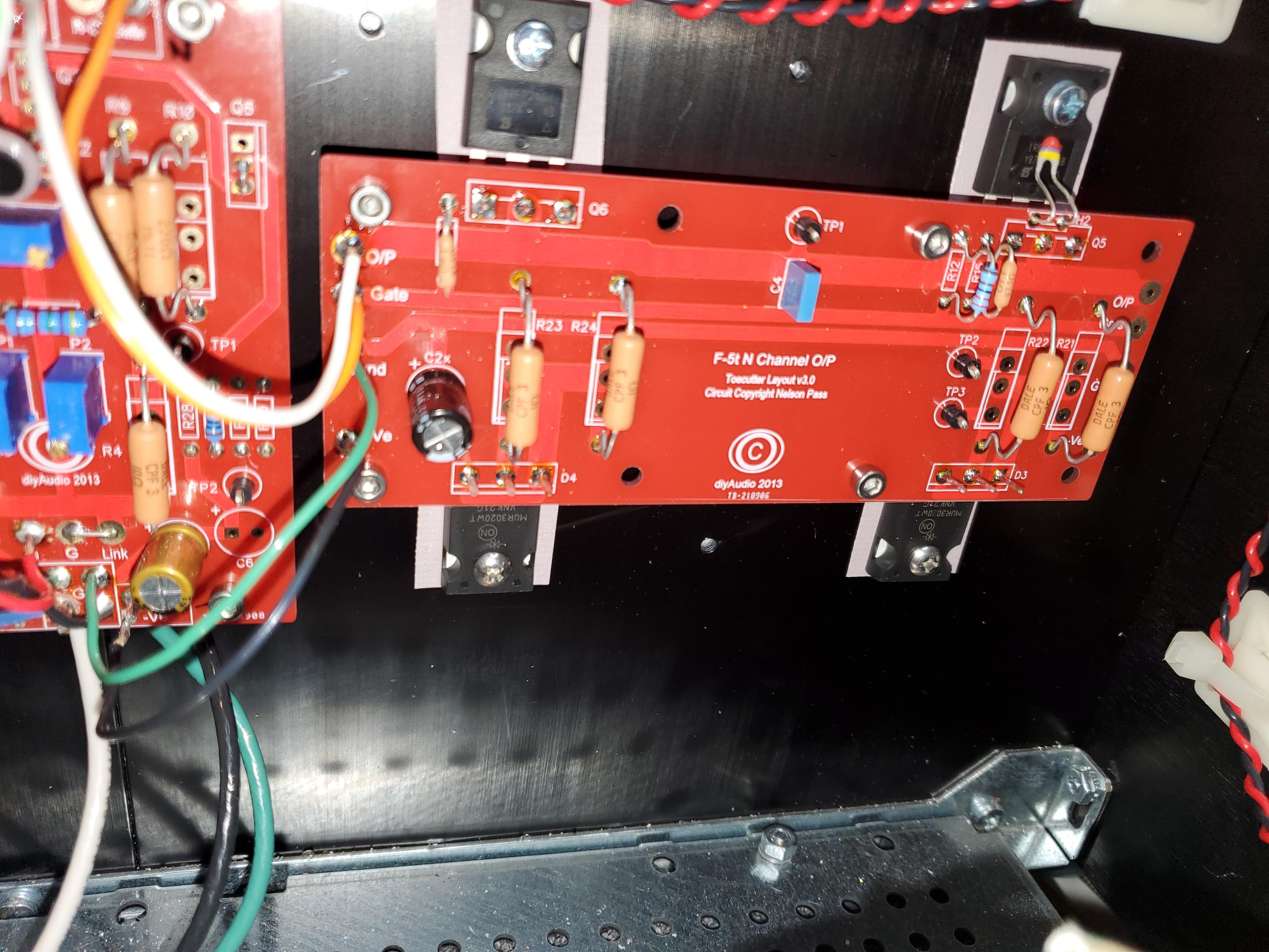

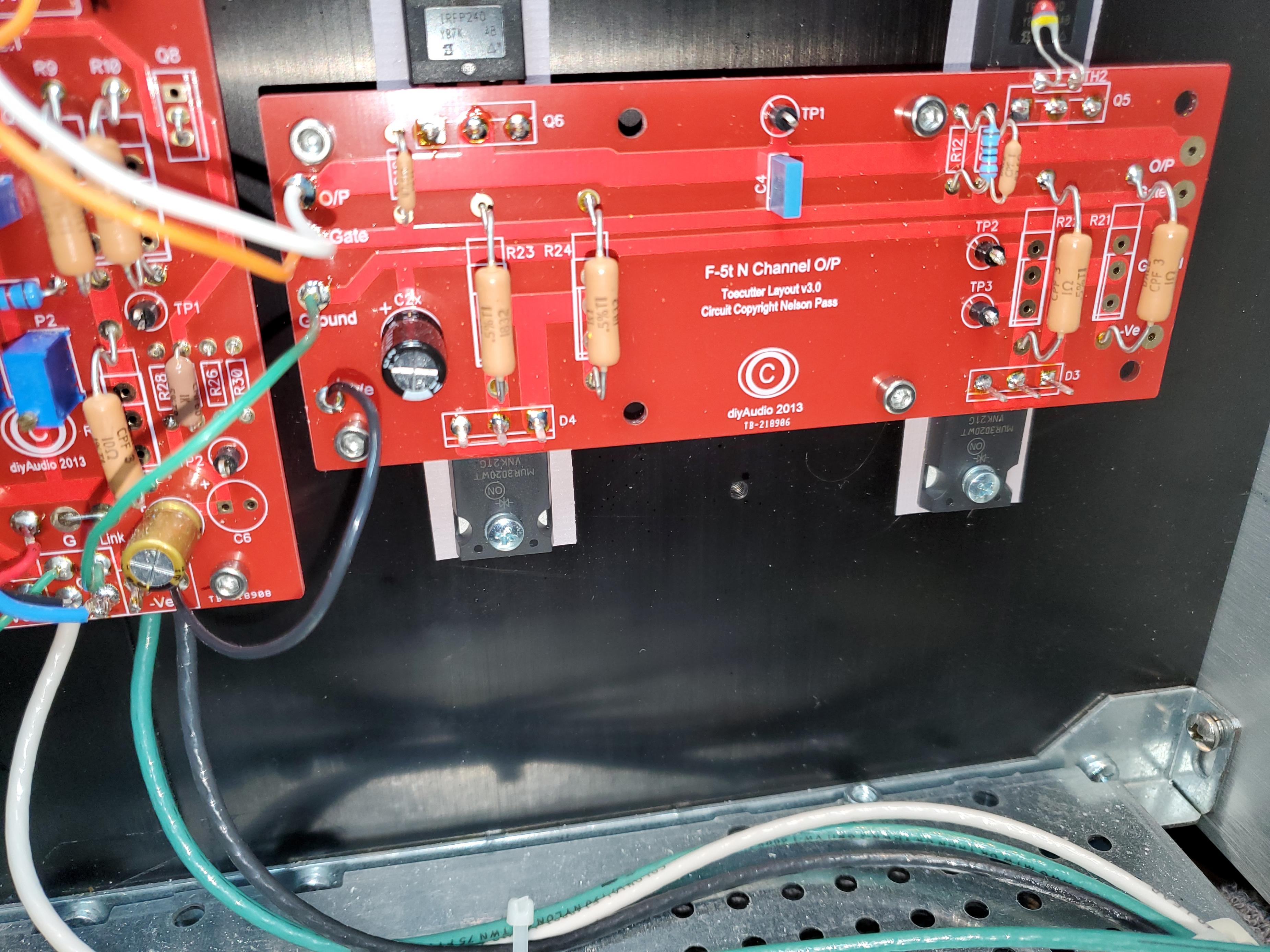

Please feel free for details, angles, part values if they aren't clear
I'm not familiar with the F5t pcb and I don't see anything obvious.
I suggest you check the soldering, in particular from R5 down to R6
(F5t v2 schematics on p9: https://firstwatt.com/pdf/art_f5_turbo.pdf )
Touch up any soldering as needed. Then make sure your rail voltages
are correct and try measuring the R3 and R4 voltages again.
Also please check the part values and placement, including the jfets.
If the R3 and R4 voltages are not good, you likely will need to pull the jfets out
and test them and there's a chance you will need replacements. 🙁
