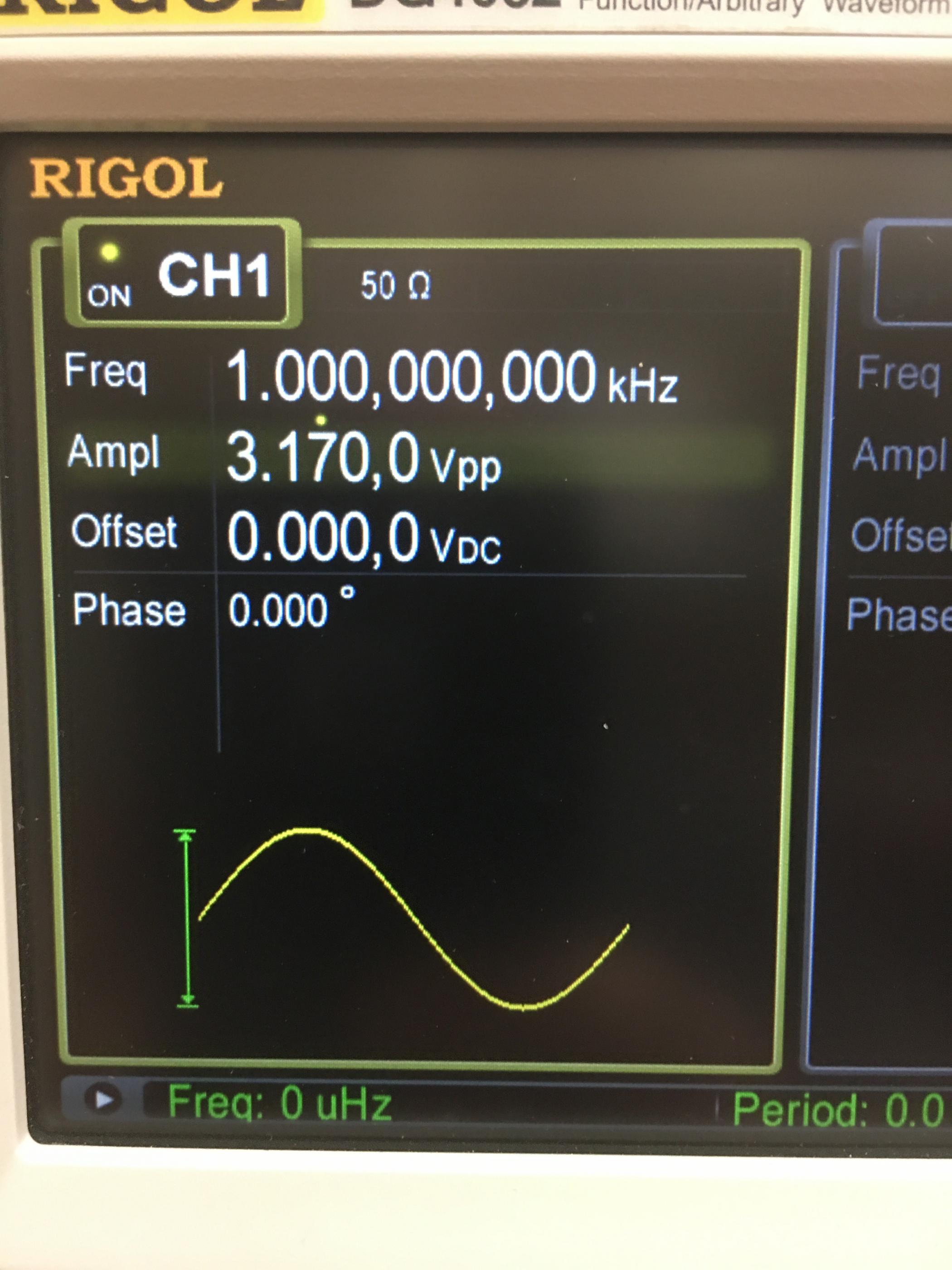

I know that’s part of it. Like 92dB at 1w/1m is about twice as loud. Previously to the F5T I was using a class D 2x100w (@4ohm) amp board with the dsp and speaks. Lots of volume. I’m not sure what the voltage gain of that amp is, but it lists gain at 30dB. The f5t ver. 2 that I built should have 20dB.
I will say that there is more bottom end and better clarity with the f5t. I’m not going to switch back, but I’m surprised, at how quiet it is. I’ll keep poking around. I’ll get some measurements soon.

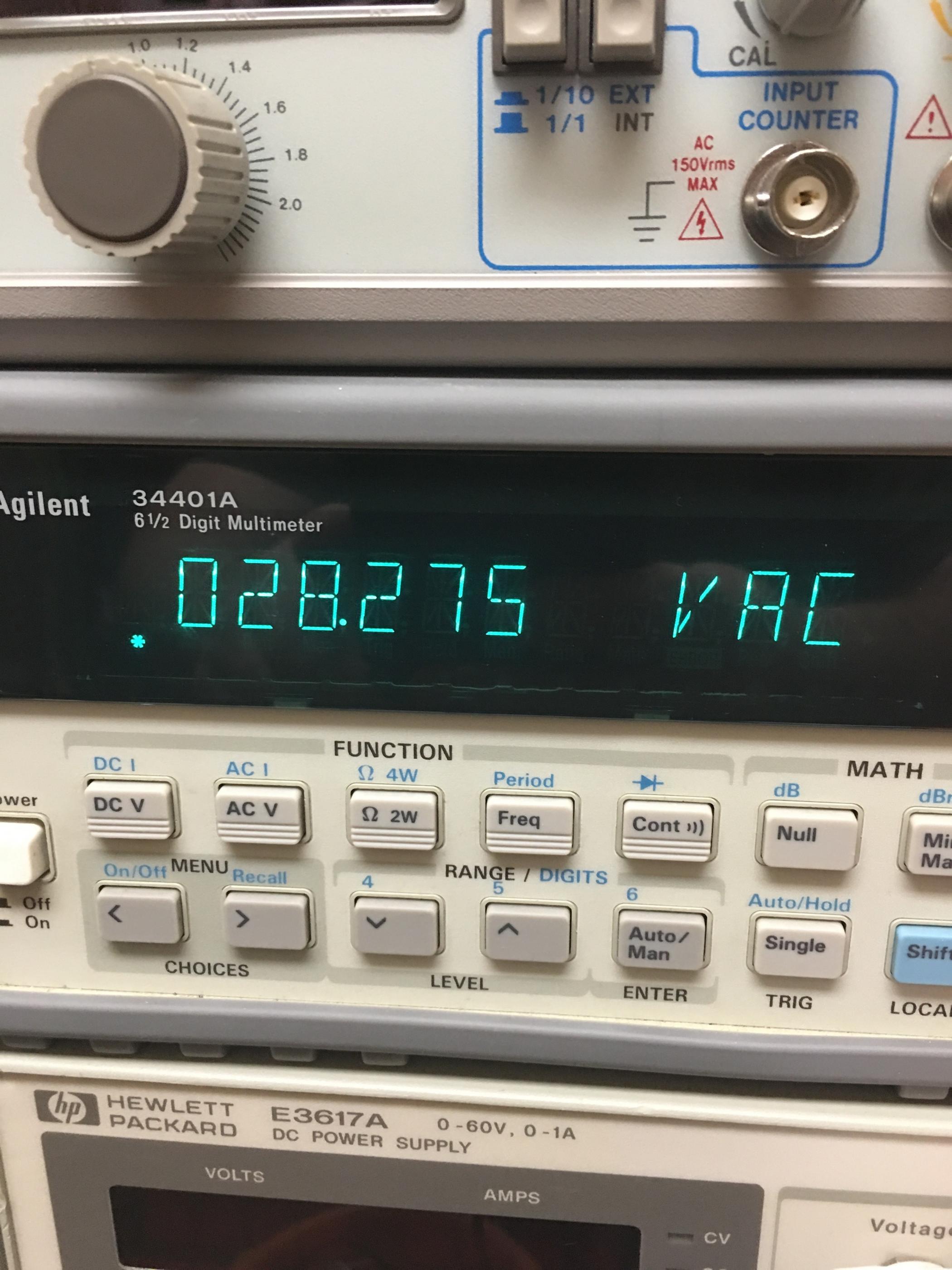

My F5T had noise measurements around -88 dB and lower, except for one channel's 120 Hz reading.
I moved a secondary circuit board to a different place, and it should have lowered it further. I will report when complete, but having some issues with one channel at the moment.
Well it’s confirmed 0.9vrms output from the dsp is not enough. I bypassed that and scrambled for the down button on my iPhone. We have enlightenment. Although I don’t know the output specs of that old iPhone 5s.

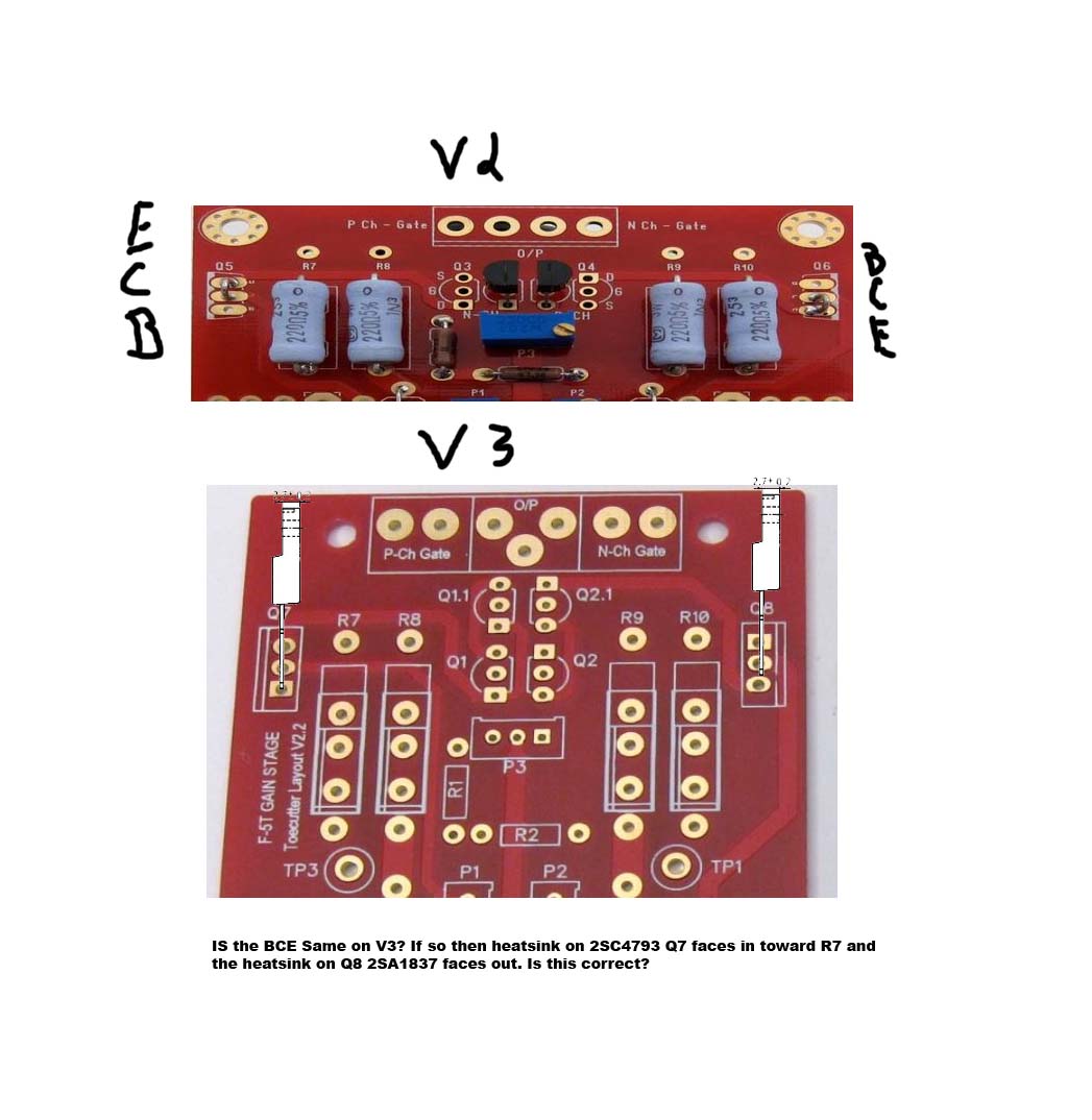

Cascode Q7-Q8 Orientation.
Take a look at the picture and see if I have my mind right, or if there was," A failure to communicate!"
I have attached the pin-outs to both chips.
Q8=2SA1837
Q7=2SC4739
https://www.mouser.com/ds/2/408/toshiba_2SA1837-1209454.pdf
https://www.mouser.com/ds/2/408/toshiba_2SC4793-1209408.pdf
Q8=2SA1837
Q7=2SC4739
Both devices are BCE
In both sides of the circuit the emitters connect to the Jfets. Look at the traces from the cascode transistors to the Jfets, luckily in this case they are on top and easy to see. Make sure the cascodes are oriented to connect emitter to Jfet. Which on this board will orientate the case back to the outside, I.E., as the silk is drawn.
Q7 is the N channel, Q8 is the P channel.

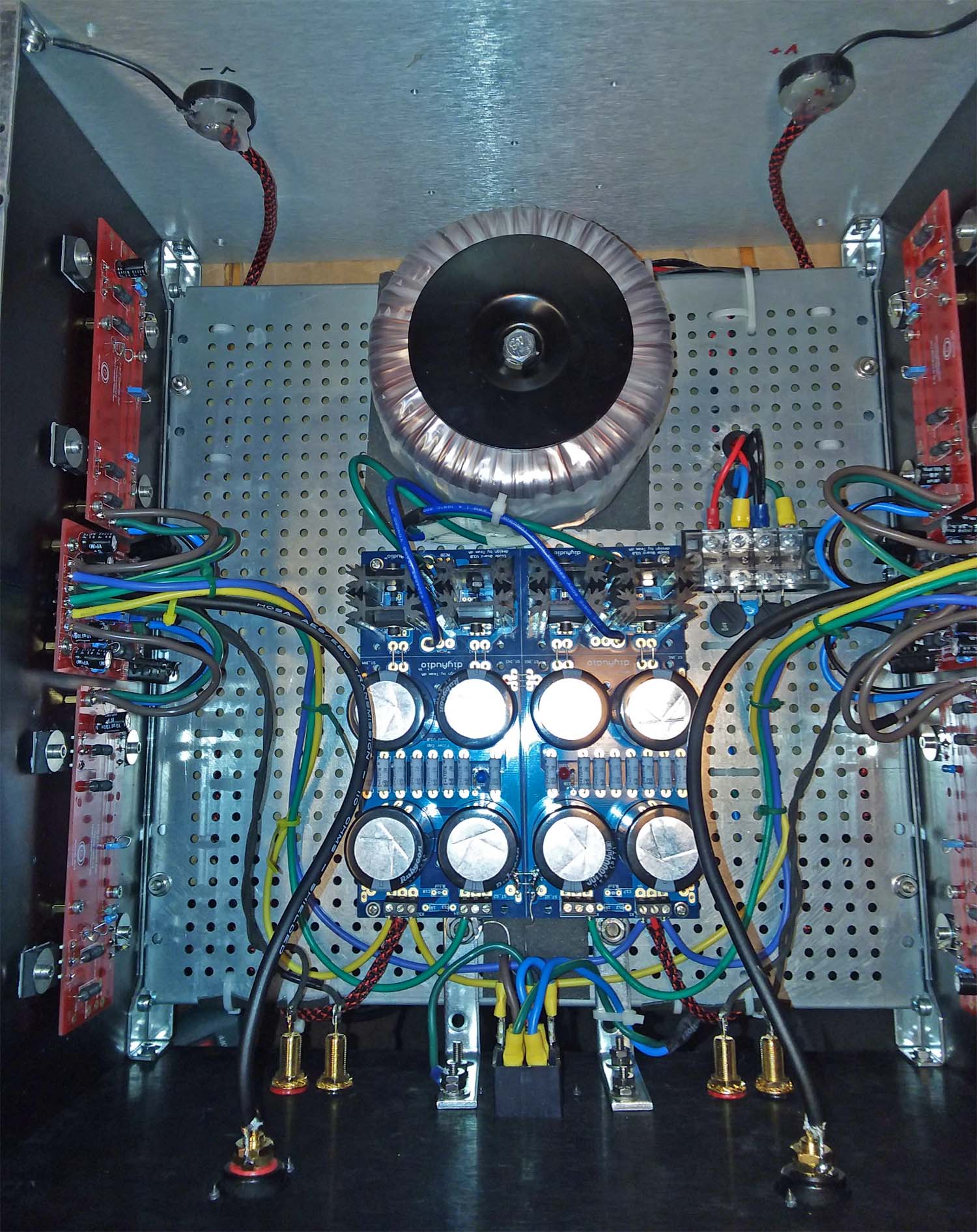

F5T V2 Done
Thanks for the guide 6, and all who chimed in with advice, she runs great, since it's a Christmas present for a friend, I biased it at .3 firmly in the, scared kitty zone. I think it looks pretty good for a first time build.
Anyway, here's a little amp porn for ya.
