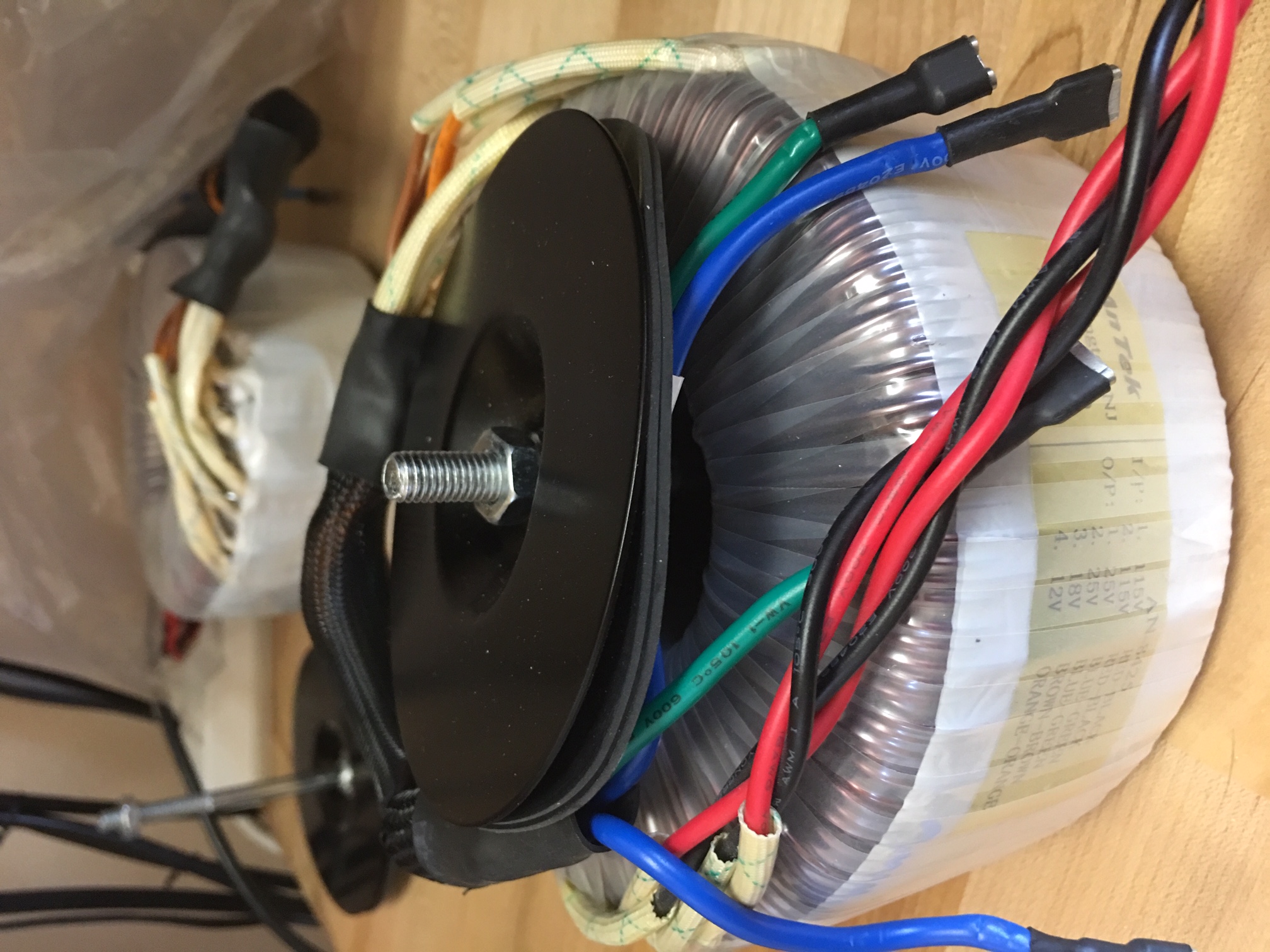

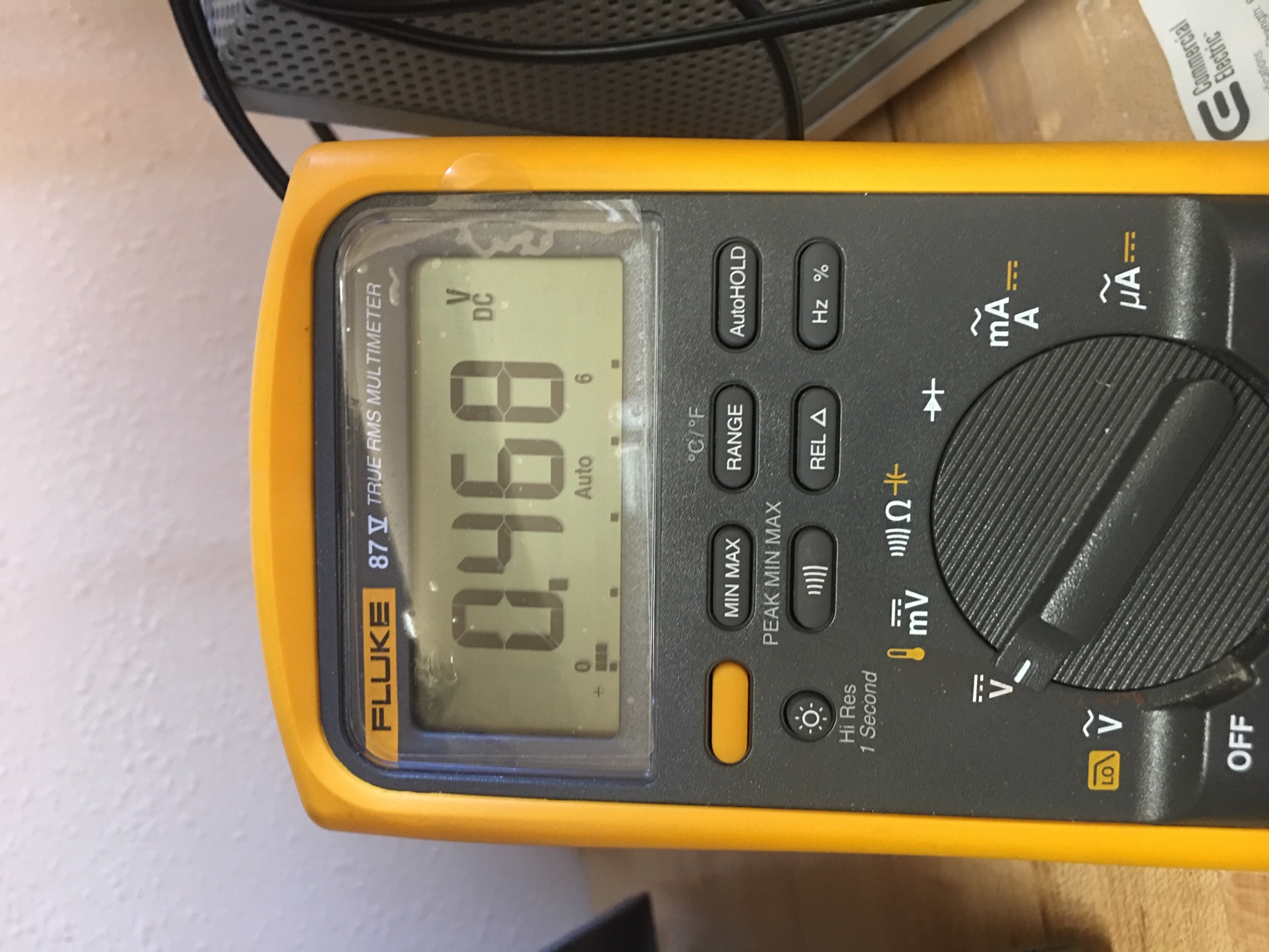

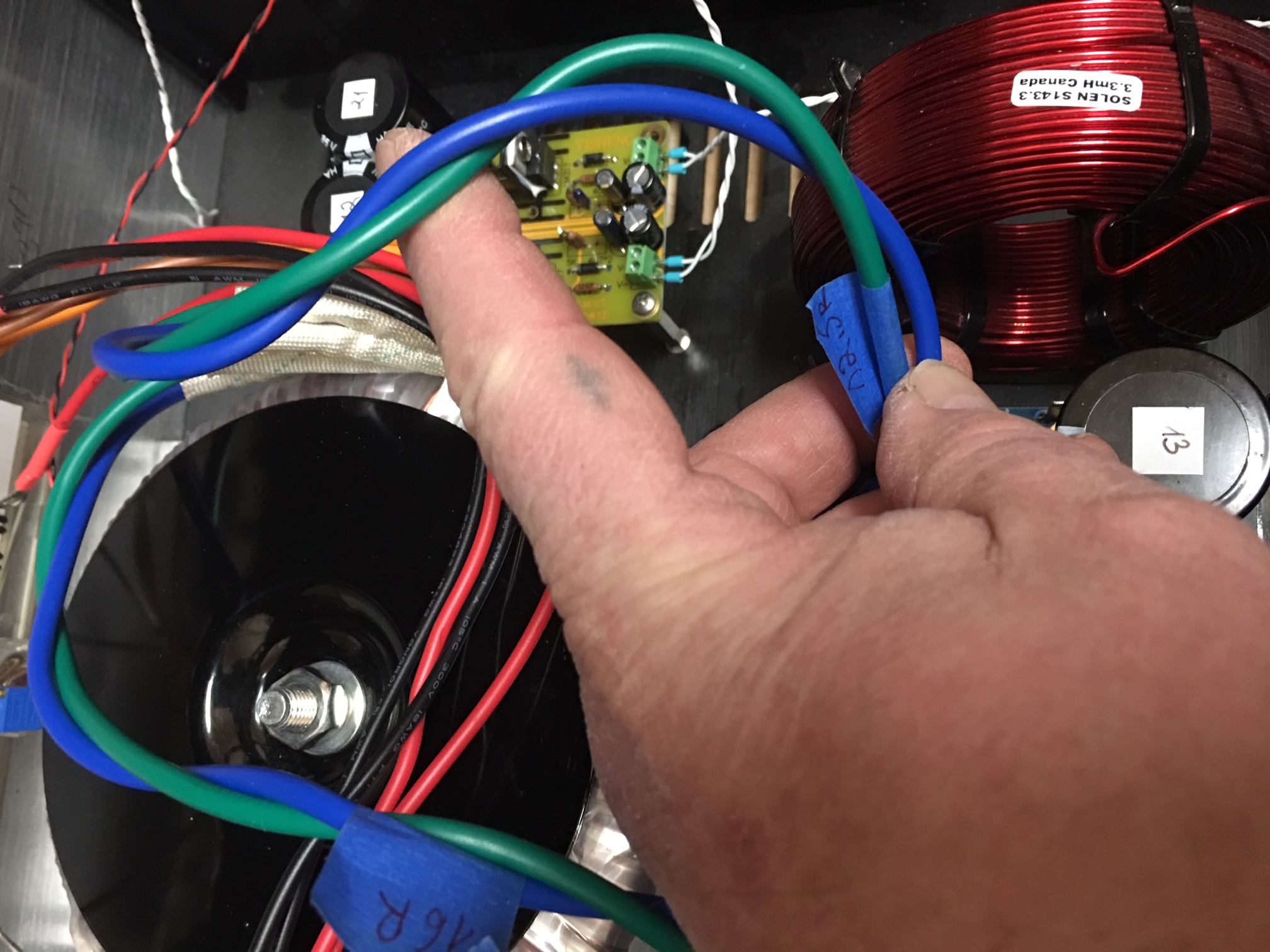

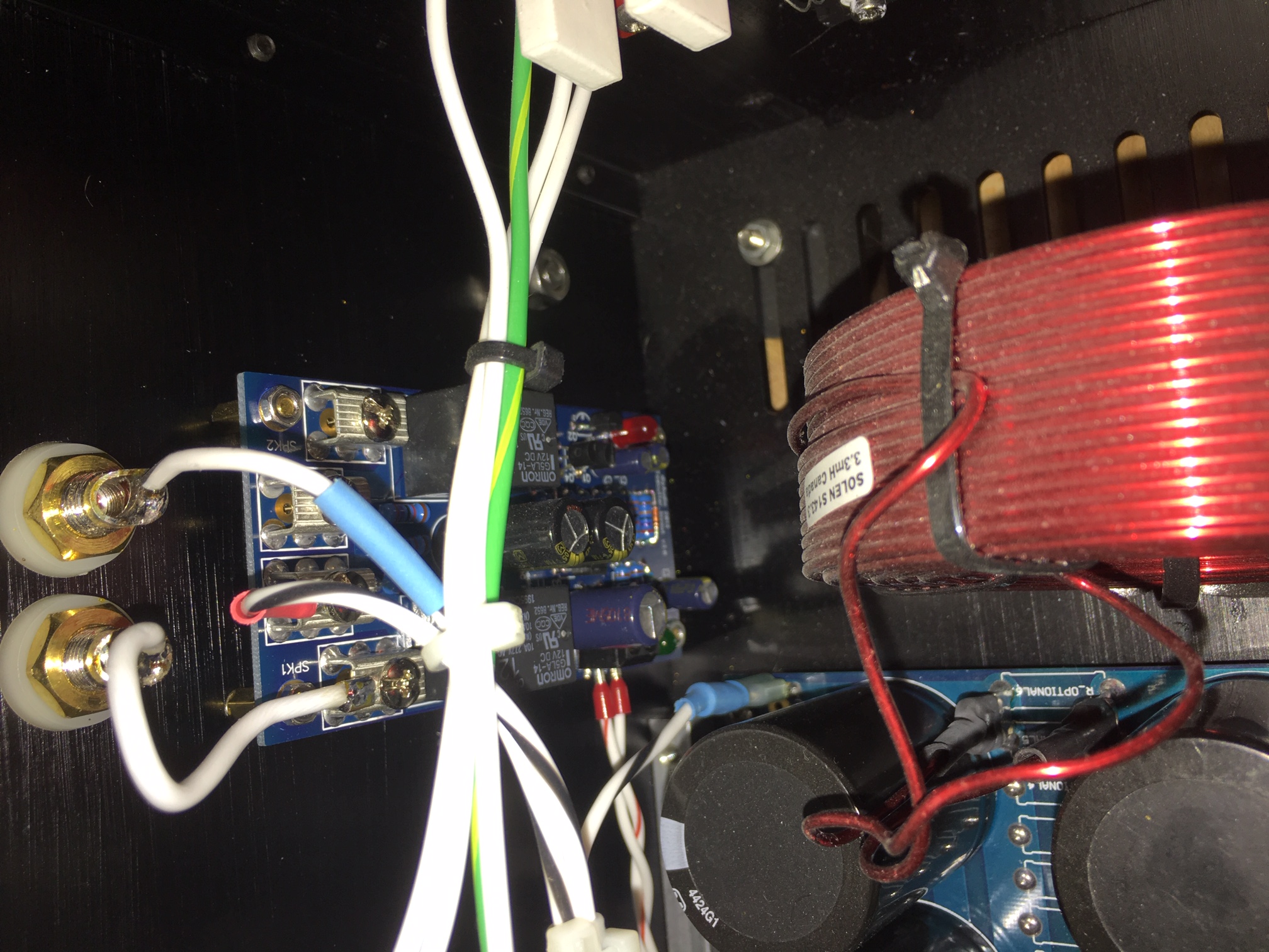

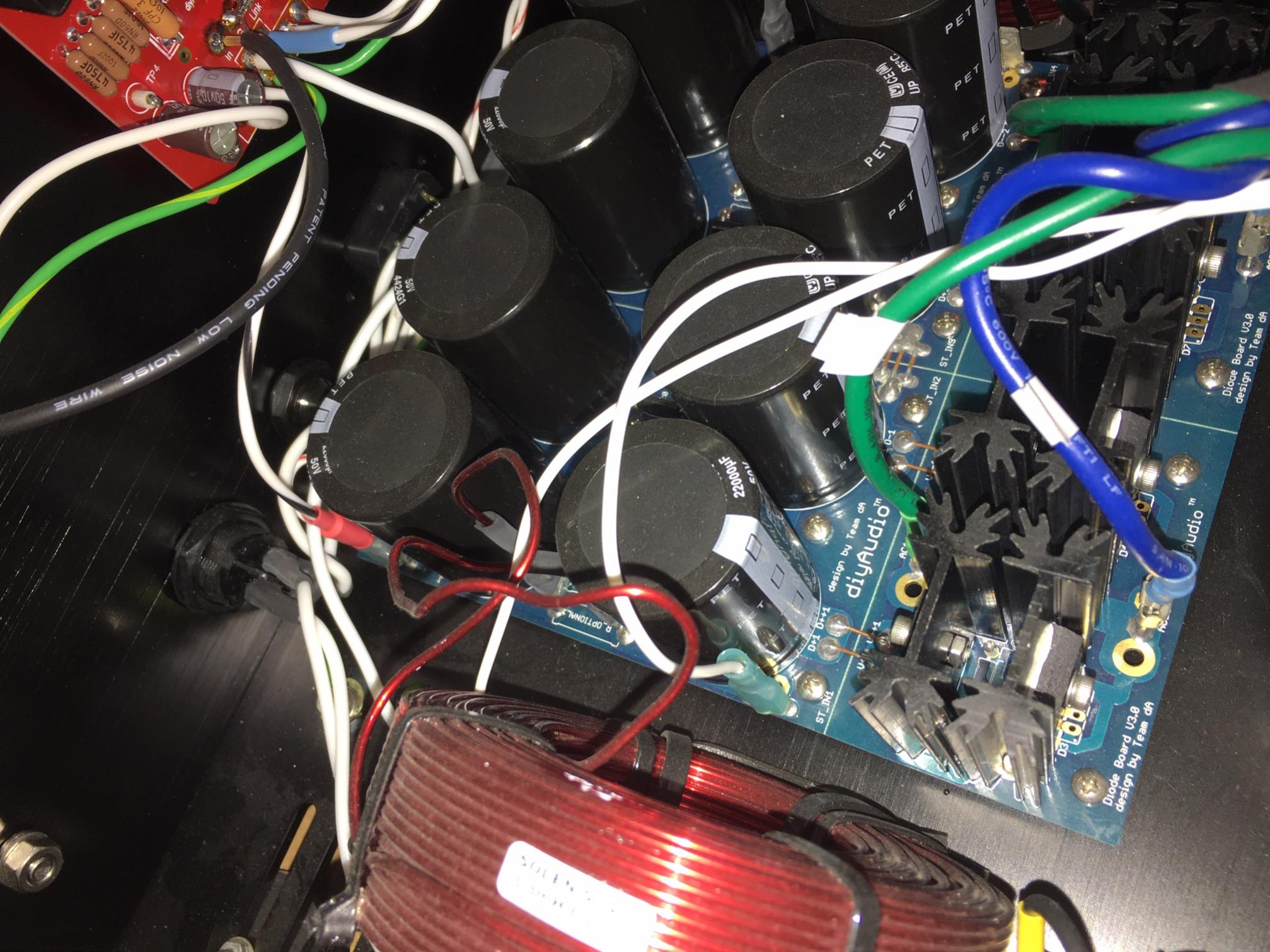

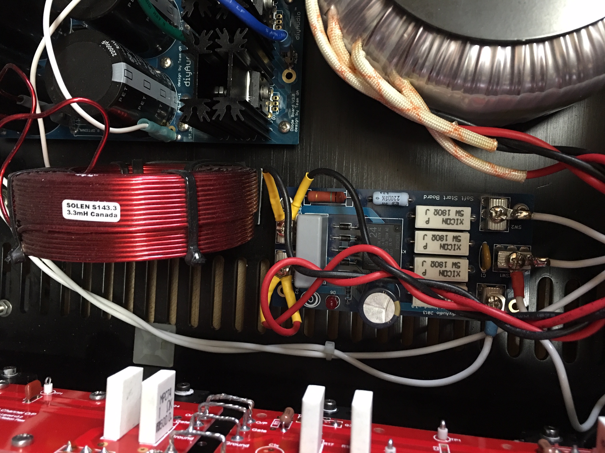

I finished upgrading my F5T monoblocks by raising PSU voltage from about 30-32VDC (depend to the time of day with mains fluctuation) to 42-43VDC. Personal thanks to 6L6 for support. The design of my speakers requires about 70W per channel to reach a full of potential of these and my 32VDC setup gave me 56W, measured. BIAS was set to 470mV and it is remained same with 42VDC PSU. I have floor standing Adagios made by Acoustic Zen and I got that info from designer-owner of that company. I didn’t measure power output yet on new setup, but volume knob of my preamp moved down by about 20% for the same loudness. Roughly, I assume I have about 85W or bit more (again, it is general feeling without measurements).

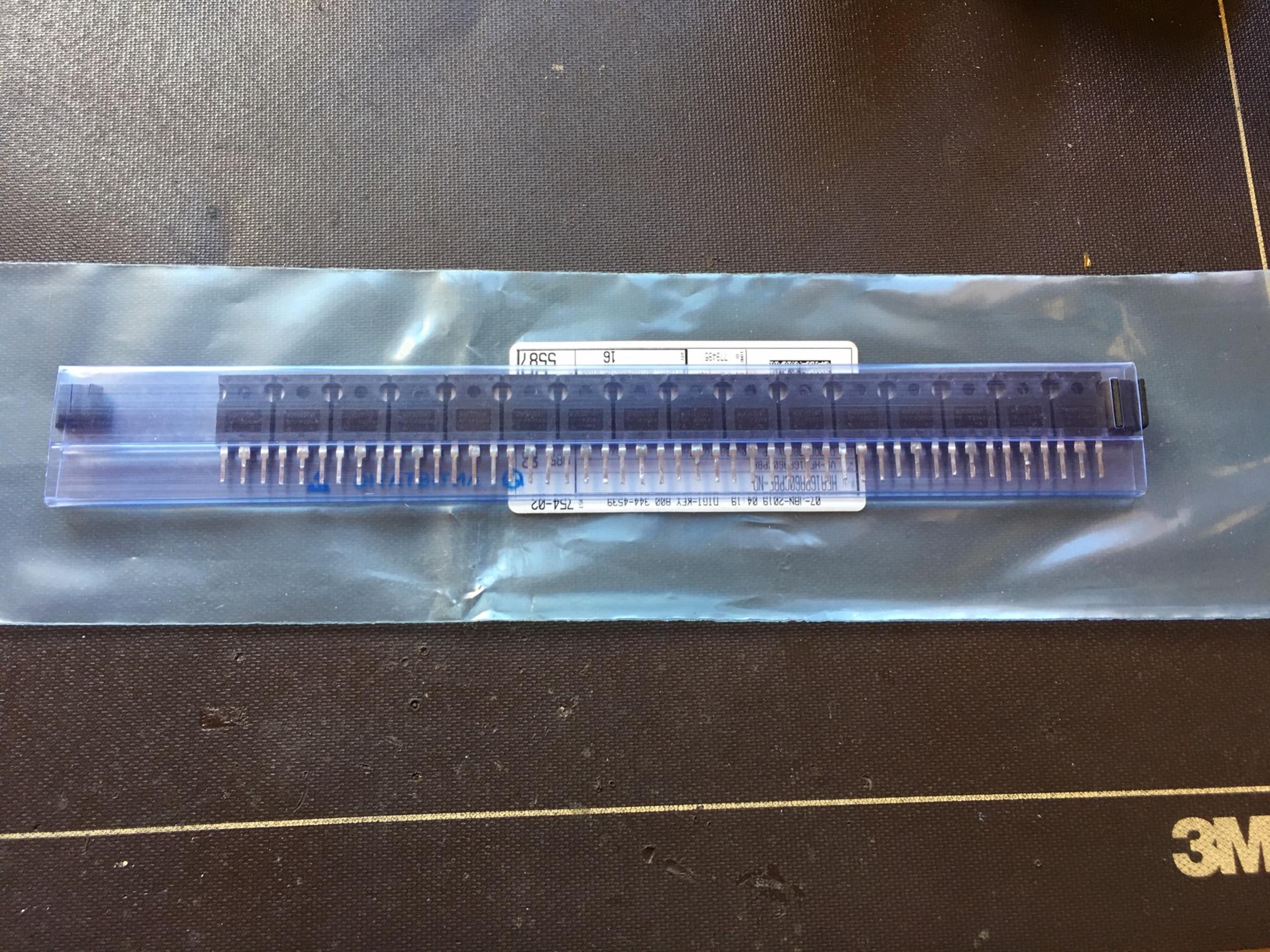

Now, I have several F5 amp parts that I don’t need any more and these might help to someone to reduce BOM. Please PM if you would be interesting to buy these.
It is about 2 years old pats. I’ll go for 35% off from original pricing plus shipping to US.

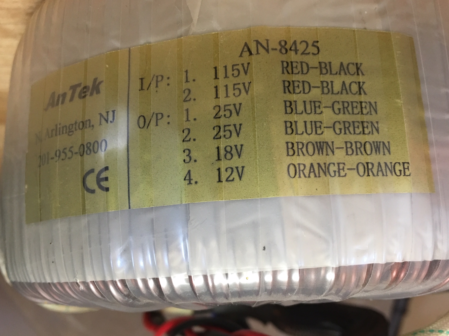

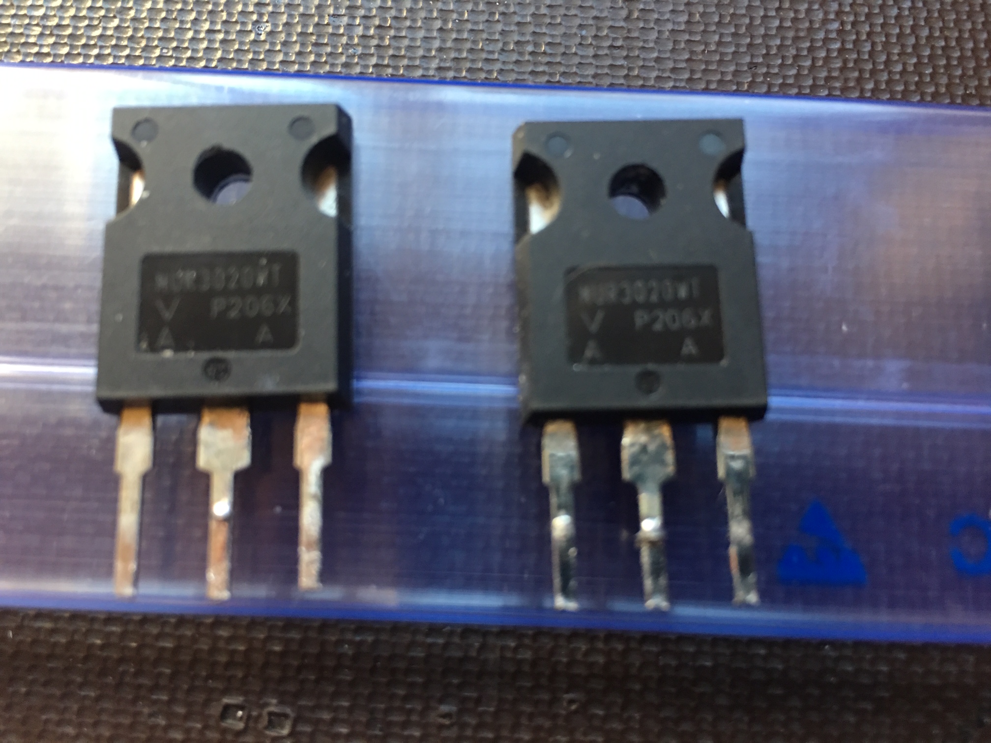

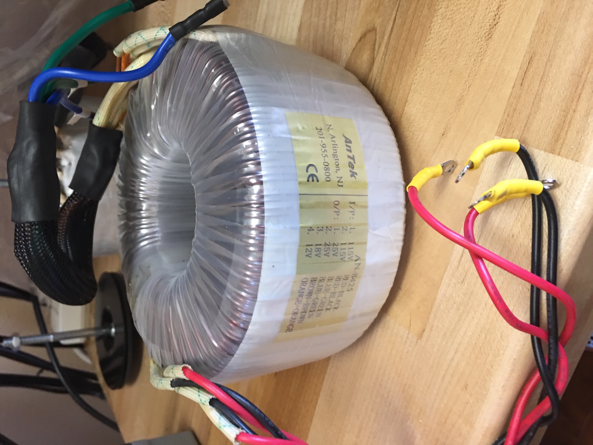

So, I have 2 transformers made and sold by AnTek AN-8425. And I have 16 MUR3020WT which I used as rectifiers. I moved to Vishay’s HEXFreds with my new setup.
Here is some images:

And here is mentioned above parts for DYI that I don't need anymore. It might help to someone to save a bit on BOM.

May I ask howyou like the hexfreds vs. the mur? I thoight about this as well...
It is hard to make “clean” comparison since I changed toroids, snubbers, P1/P2/P3 positions for BIAS/OFFSET and distortion calibration, in addition to rectifiers. Anyway, it is too early to judge since I did play it for 3 hours after upgrade. However, and I can tell you already, I like current SQ more since it is way more punchy, faster and “crescendo” in classics behaves correctly now. I had some sort of sag effect with 32V PSU. I assume it is SPL and general drivers speed related of your speakers. My speakers are required more power than 56W on 6R nominal impedance.
Another side is cost vs. SQ improvement… IDK, but if you are BOM tighten for Gross Margin pareto, then big NO. It is way too pricey. I paid about $160 just for my rectifiers from Mouser. But, I have no issue with overkill or over engineering since I’m not in audio high-end business of sales. I made it for myself only and do not care about additional 10% $ for top-notch quality parts.

I guess you could actually even try a choke-inpit configuration with your higher voltage transformers ? Typically choke input sounds much mkre detailed and refined than clc or crc...which is due to less stress for the transformer and less hf-hammerings of the diodes as current spikes are much, much lower...I willtry this myself, but need new xformers...

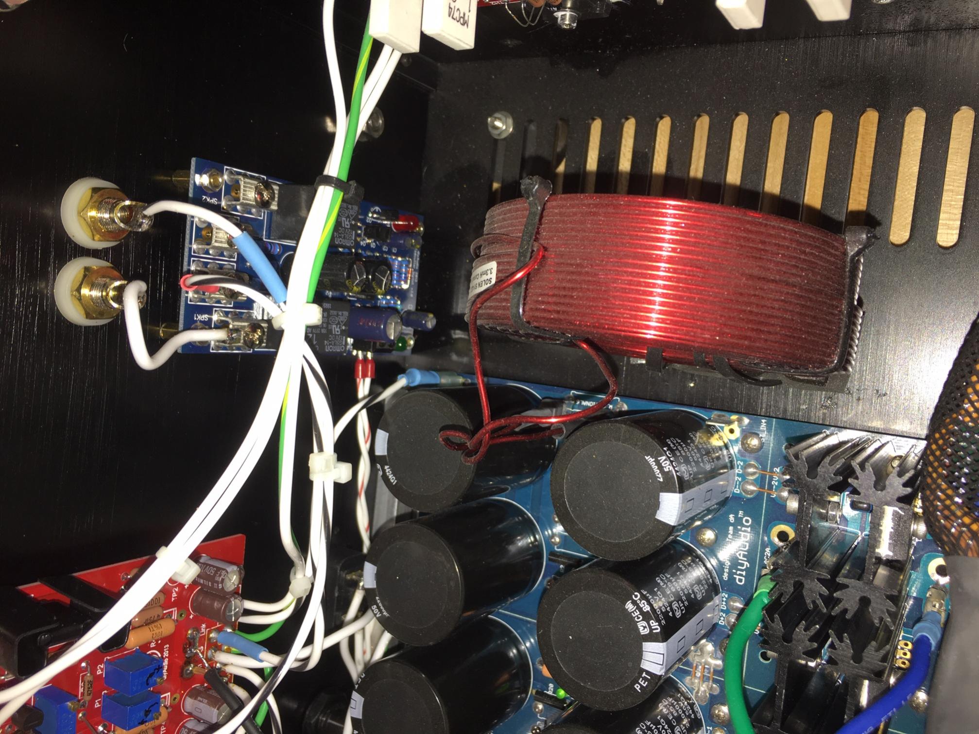

For choke-input configuration..
Do you mean to drop DC choke directly between rectifiers and first filter Cap (like LC filter)?
Yes, and it will reduce V-ripple further (can be simulated on Duncan's PSU tool). but in other hand and for something that can handle needed current, it will be relatively low inductance (otherwise, it will be heavy artillery size device) and must be also low impedance too (otherwise, it will create unnecessary and significant V-drop for DC). It also may introduce some sort of sag effect too. I know it is quite commonly seen on valves PSUs which known for sagging in high current demand too quickly…
I see your point, but I must go off from CIP mode (Continuous Improvement Process). Second, I simulated my circuit with MIN inductance choke (based on Jim Hagerman) + 100% for an extra inductance and I got 3mV V-ripple drop. Not that significant to spend on probably expansive potted chokes. My setup has less then 100mV voltage ripple, calculated (not measured, CLC architecture, 44k uF and then 3.3mH air-core L, and then another 44k uF C) and I'm not sure if I would go for more elegant solution called C-Multiplier (for example explained by Rod Elliott) to improve it. Dave also discussed it on his EEBlog on YouTube.
