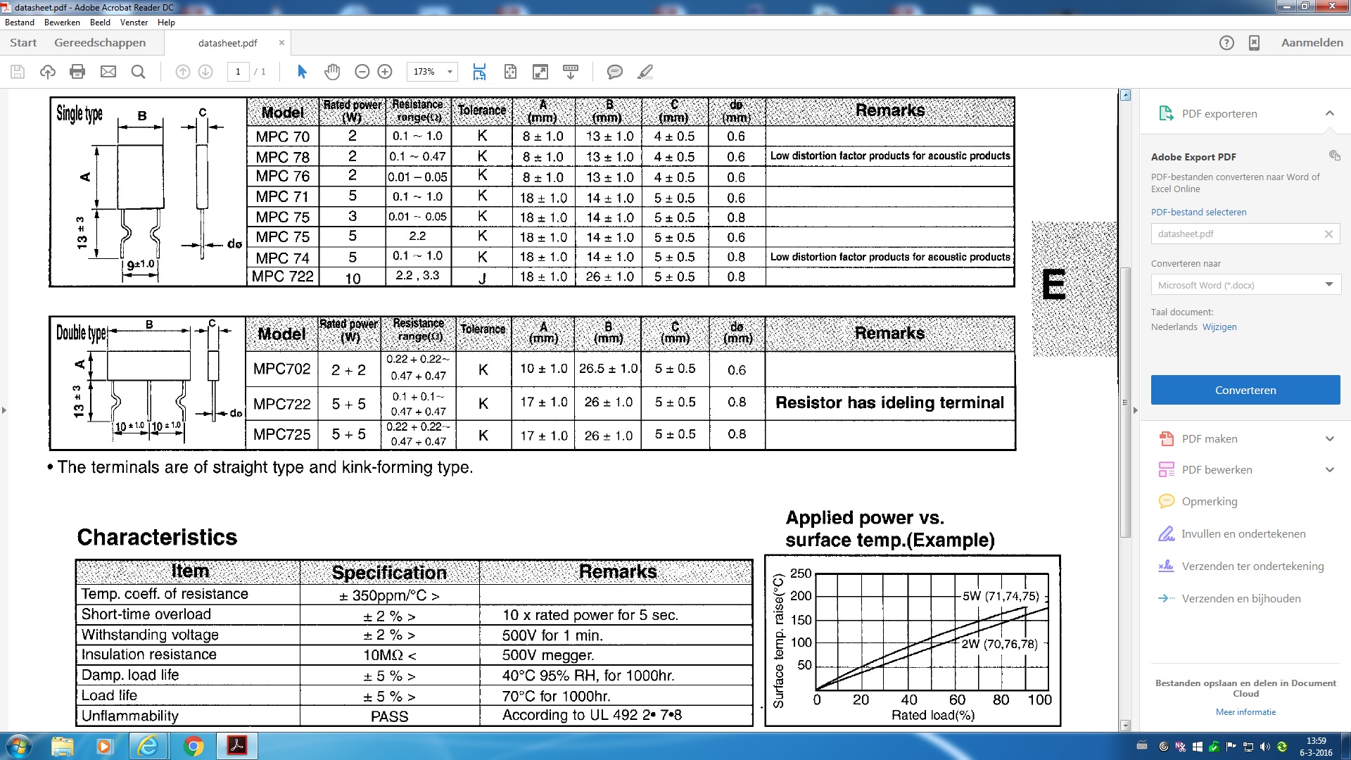

I found 32 pieces of Fukushima Futaba MPC74 1Ohm 5W 5%.
This is what I will use.

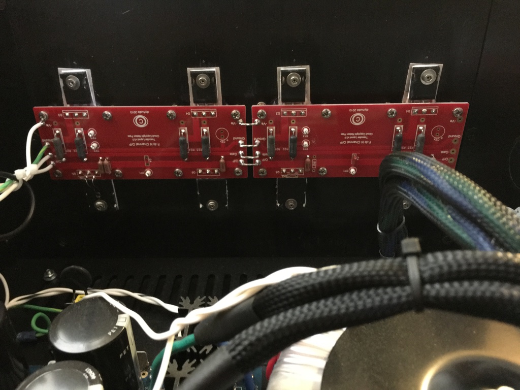

Now, it is a big question about technique how to install them nicely without damaging anything on boards. All is assembled and tighten to heat sinks with wiring. I did not pictured Air Chokes yet (this is old pictures), but now they there too and blocking assess as well.

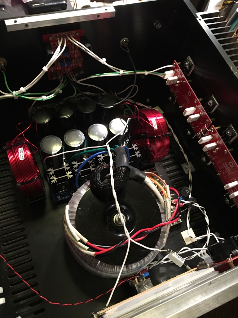

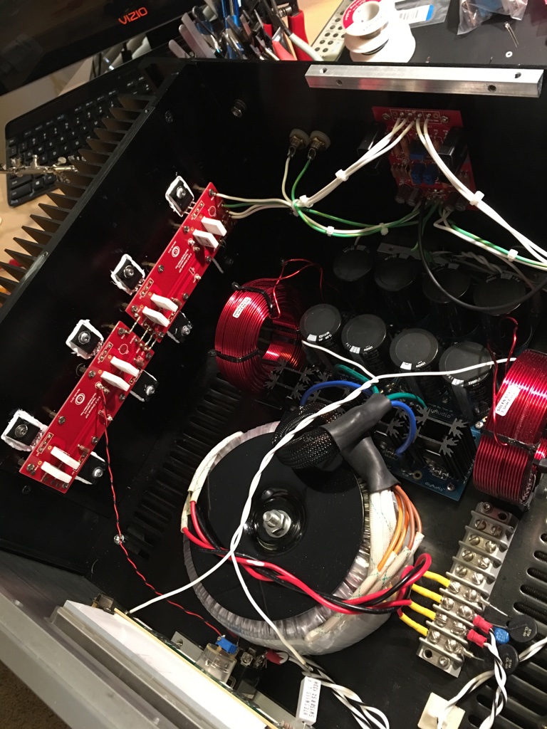

I'm done with my upgrades (air chokes and non-inductive source resistors).
You asked to post my pictures with chokes... so, please see below.
Special appreciation to Jim (6L6) for tremendous help to build and calibrate that creature.

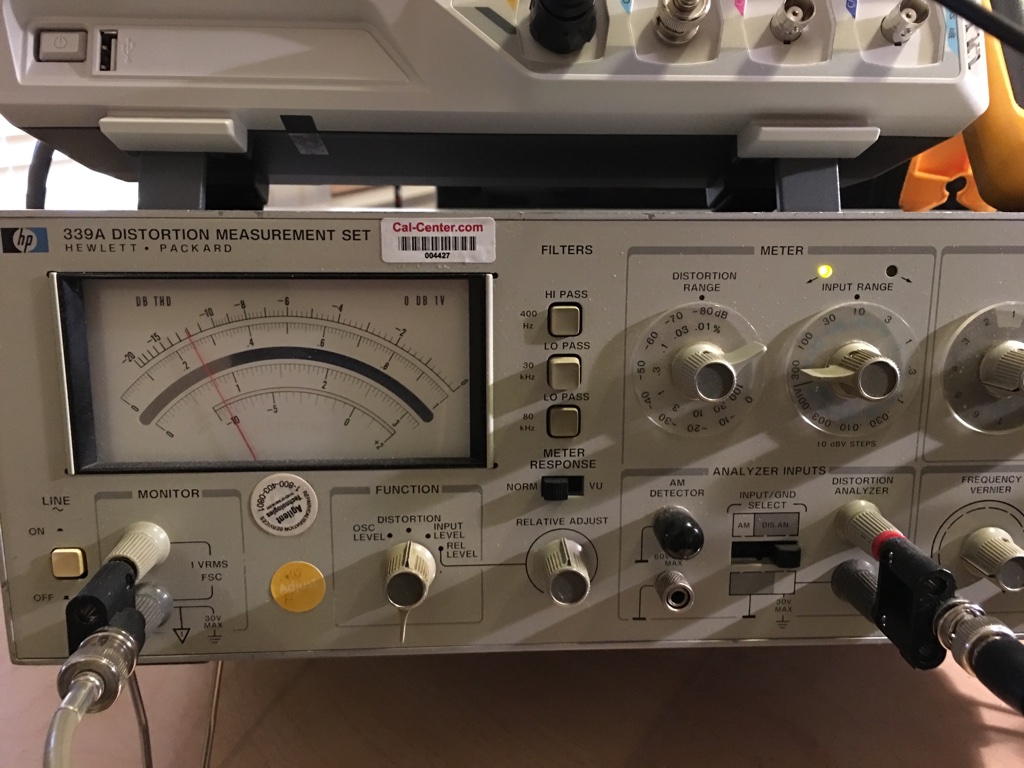

I do not like to use long and over-chewed terminology for sound test results... So, here is long story short:
A. Measurements: I see 4 small notches down on sale towards lower distortion on my analyzer vs. my previous setup with CRC on PSU and old inductive resistors.
Not much...!
B. Subjective test: listening test is introduced nice improvement. I definitely hear more little details now than before. Very dynamic and crystal-clear sound. My F5T can easily serve all my jazz and classics collection perfectly, even during very high crescendos. No noise/hum on max volume with no signal, not at all. Dead quite!

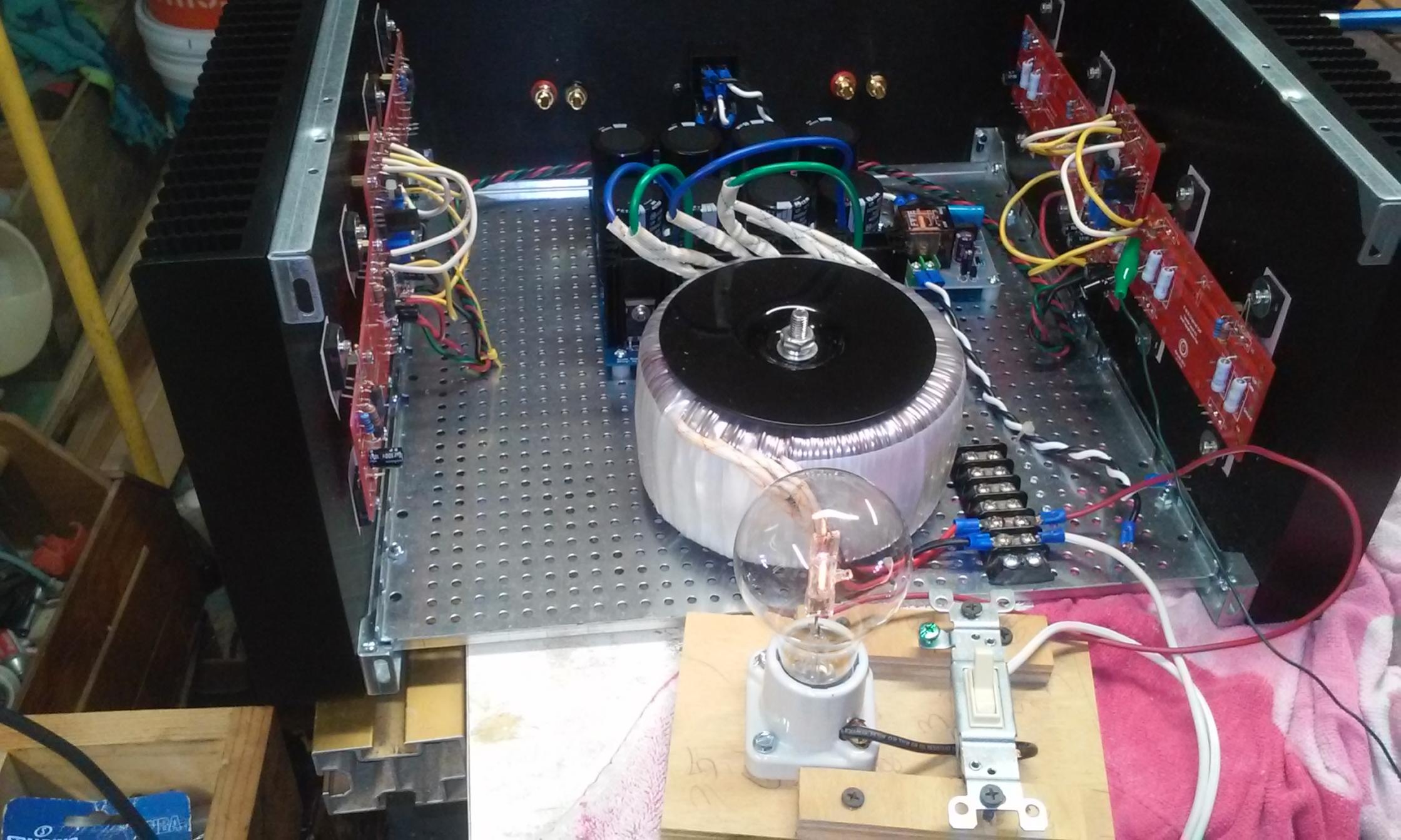

OK I am at .41 volts bias. I can hold my hand on the heat sink. Both sides the output jumps a few .001 volts. I this normal? Inputs are shorted. Heated up around an hour.
some erratic jumping of output offset isn't critical
if steady value is up to 50mV (either neg or pos) , you're good
keep on mind that final adjustments need to be with covers on - which means - measure with cover on , be quick with opening-adjusting-closing ....... then wait patiently for temp equilibrium again
